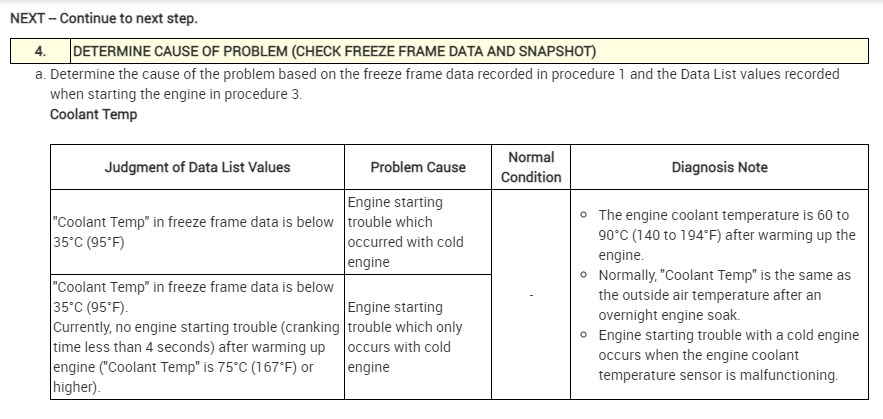

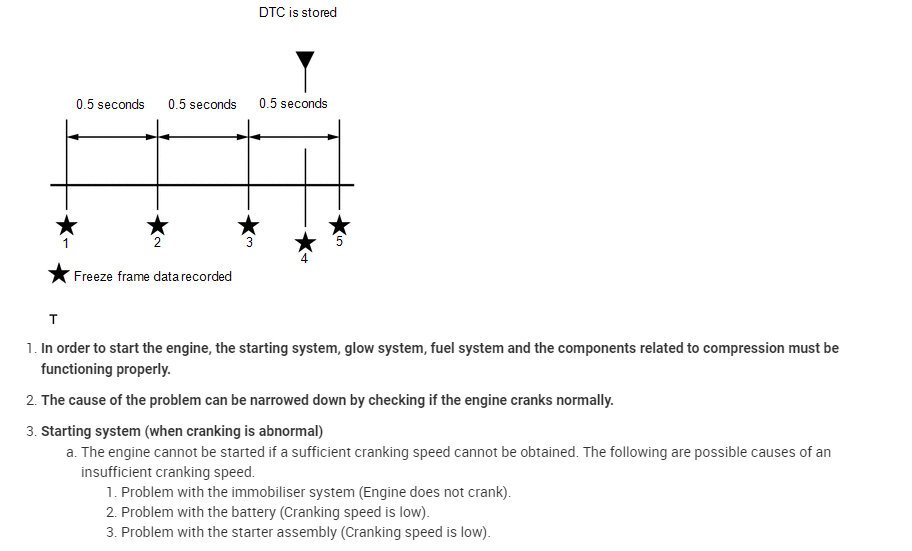

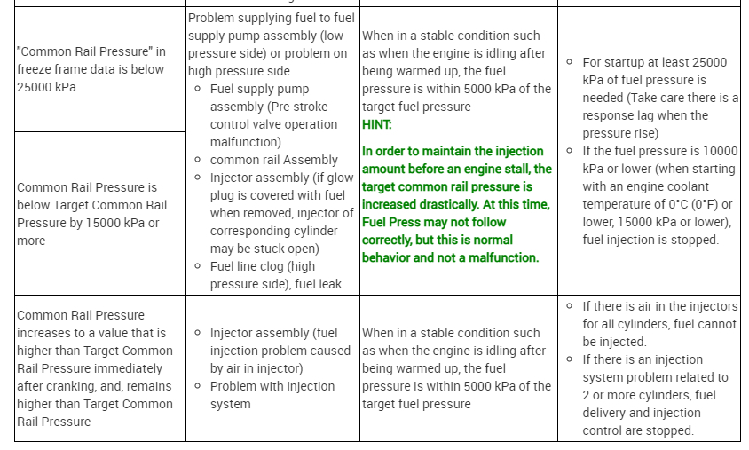

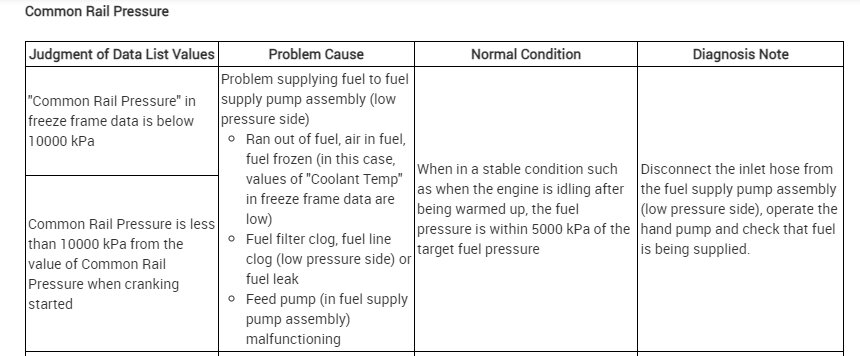

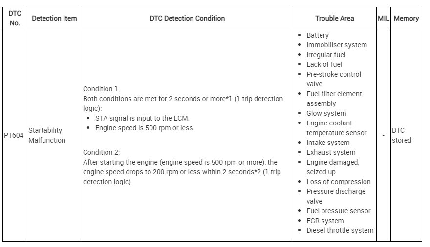

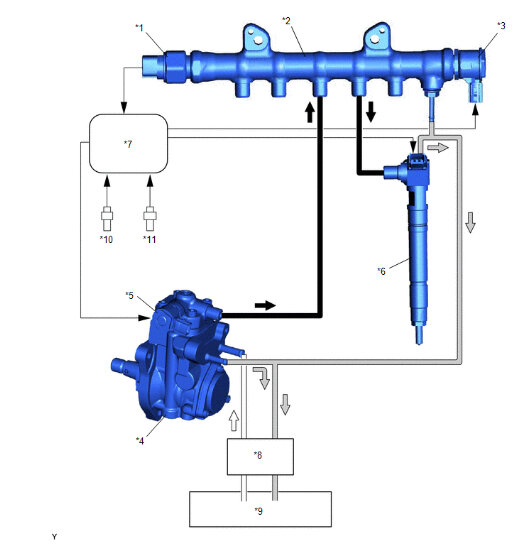

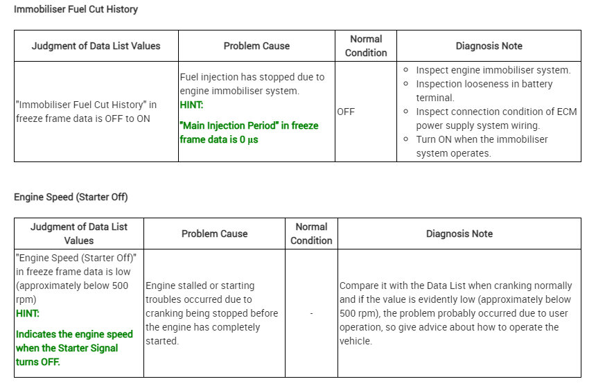

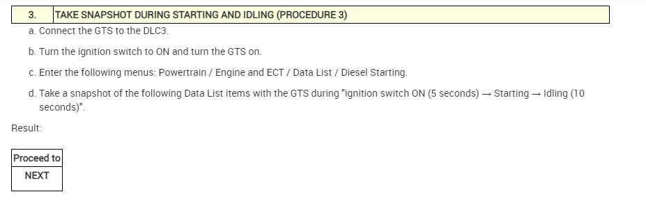

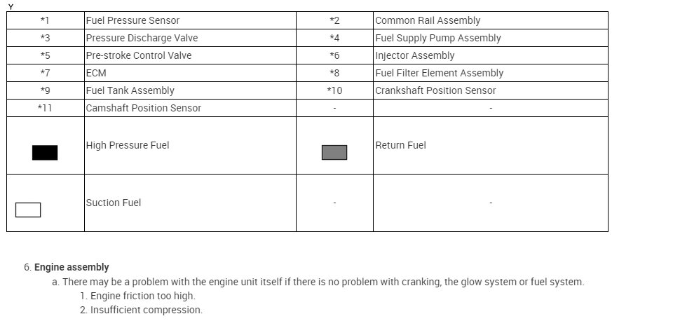

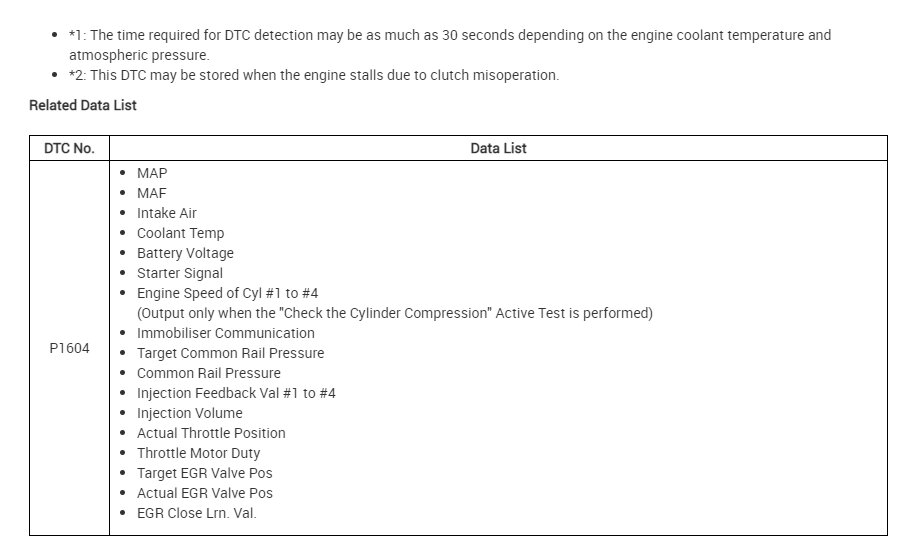

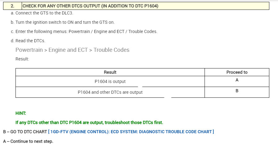

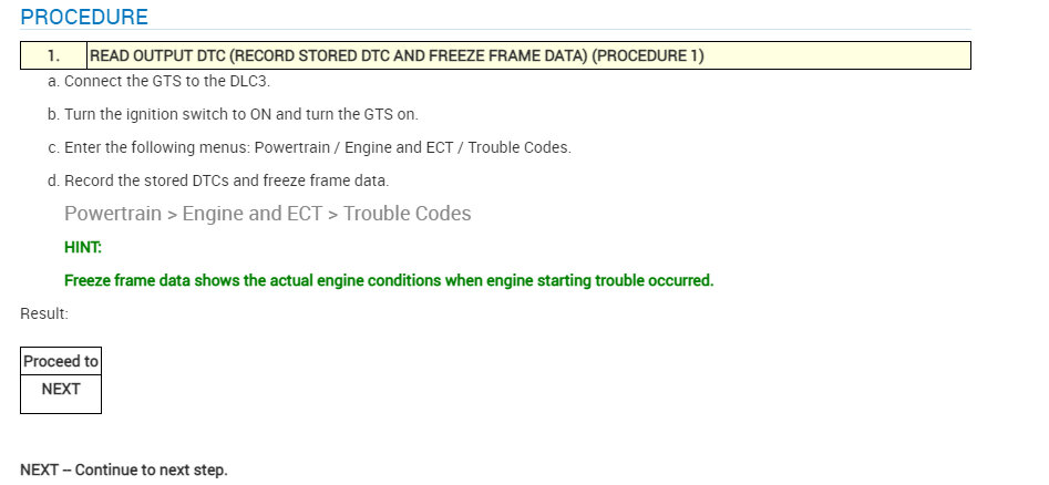

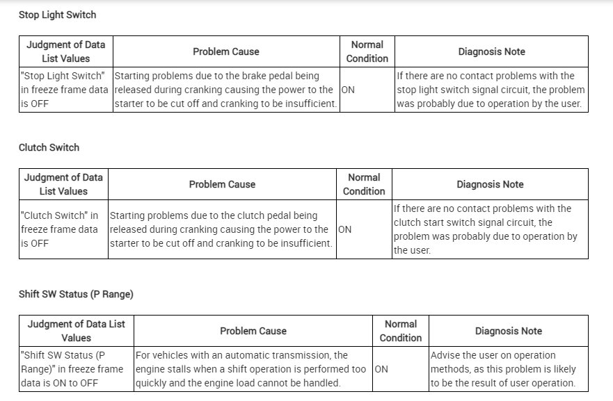

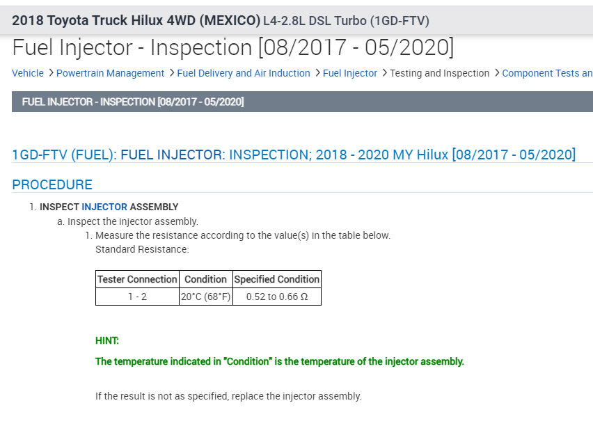

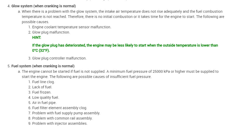

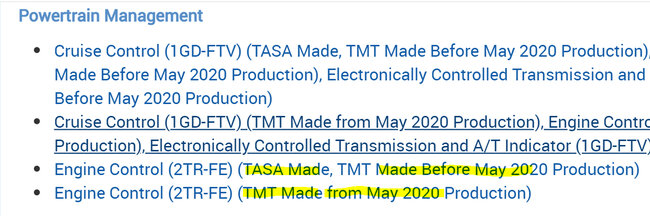

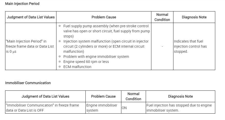

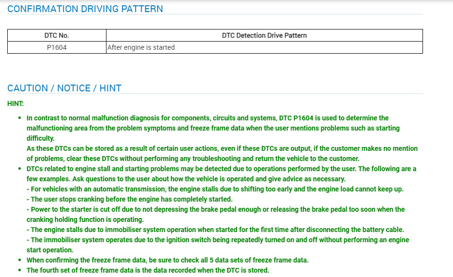

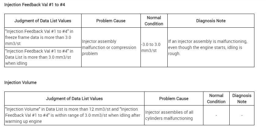

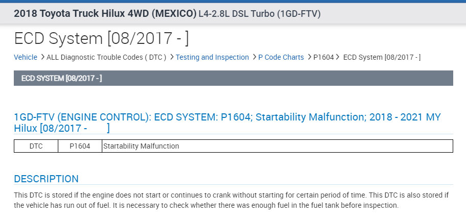

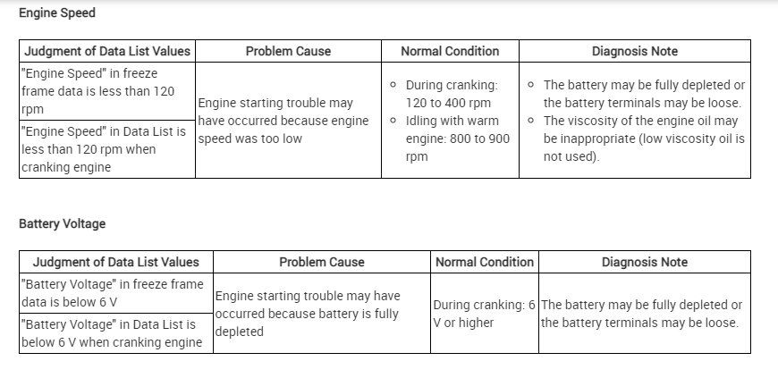

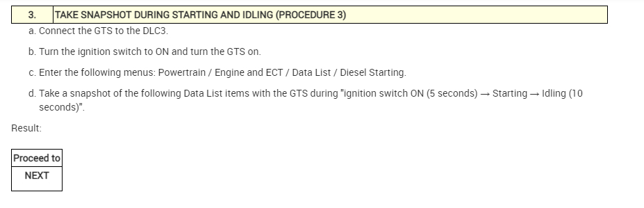

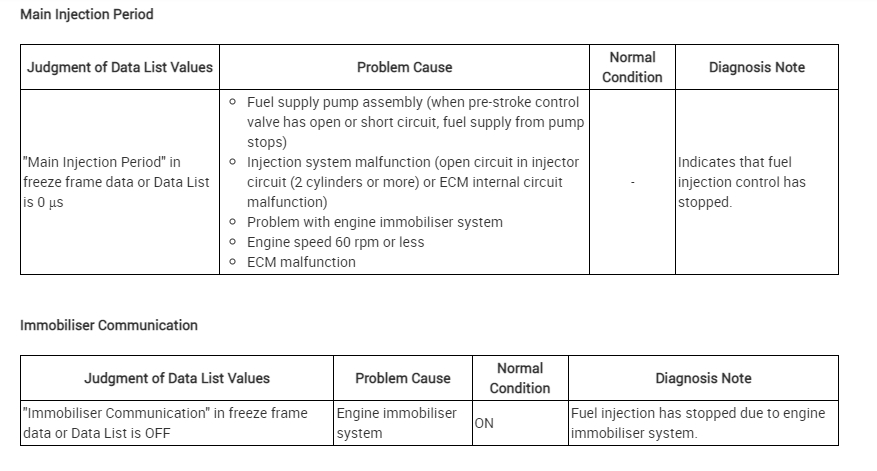

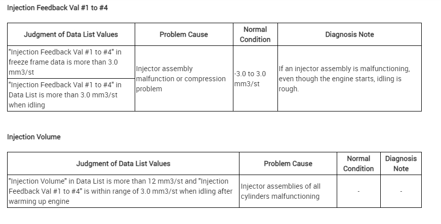

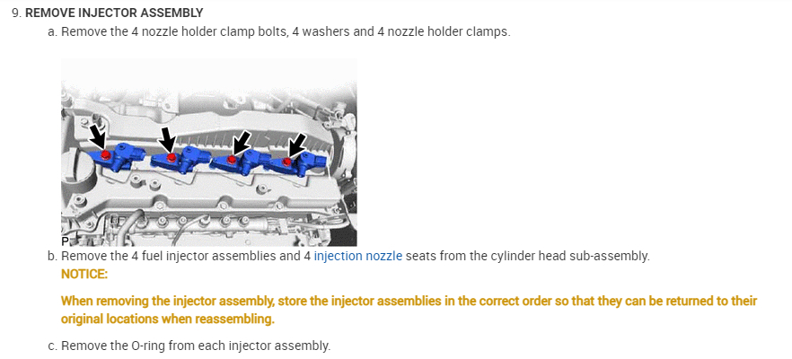

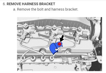

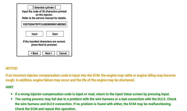

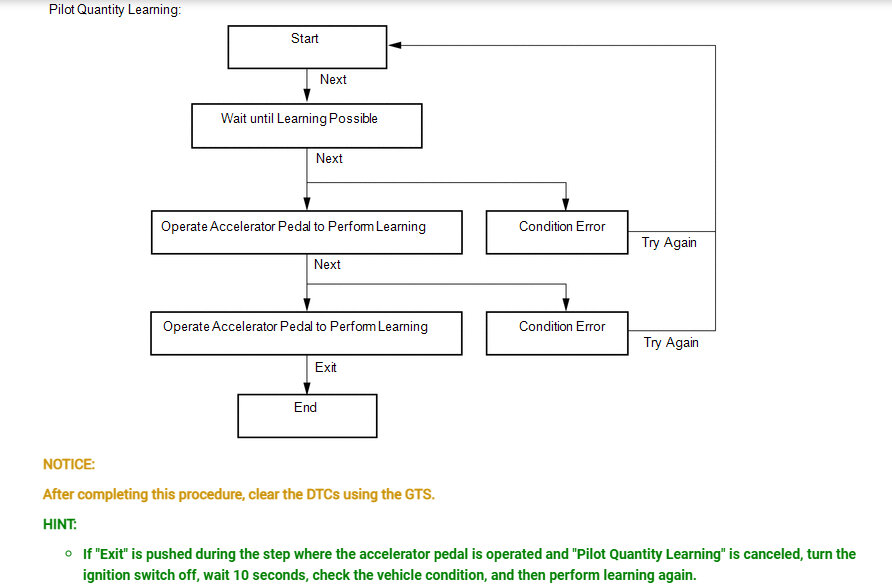

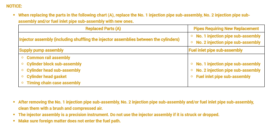

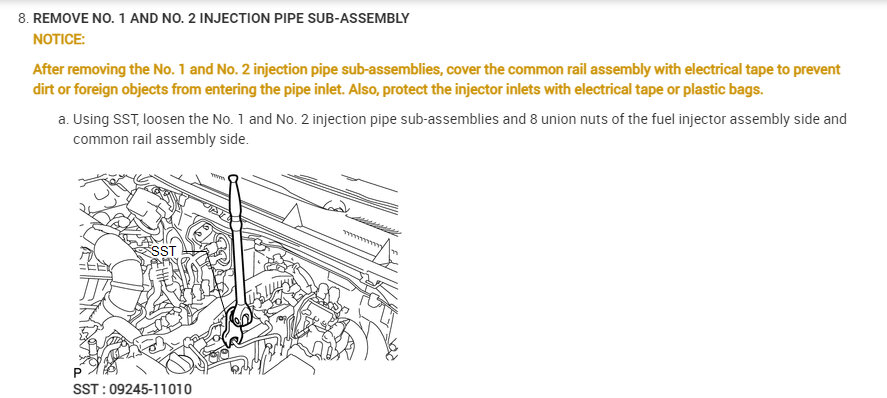

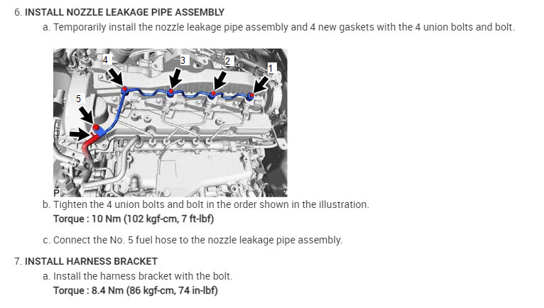

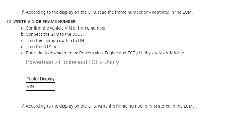

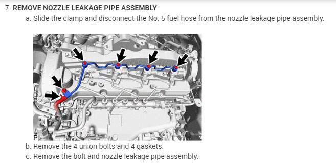

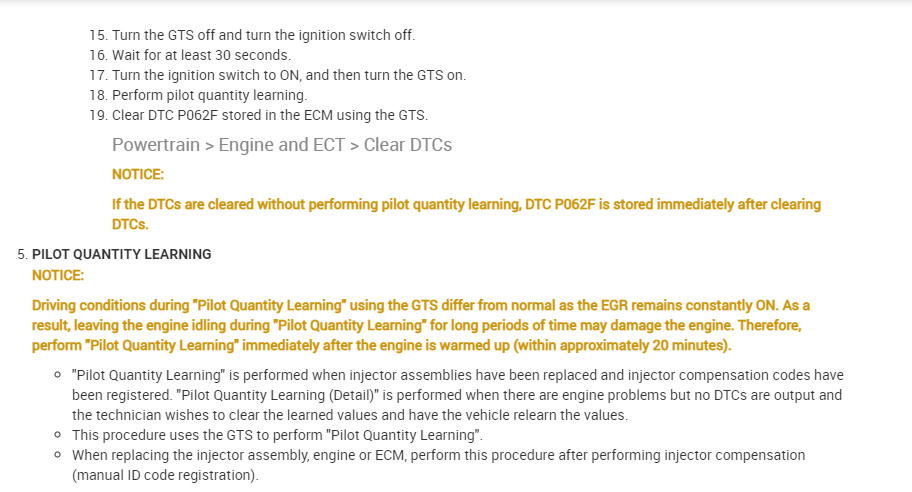

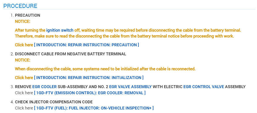

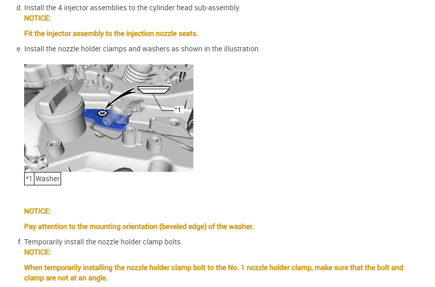

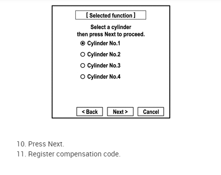

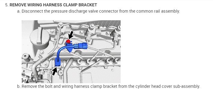

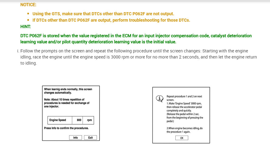

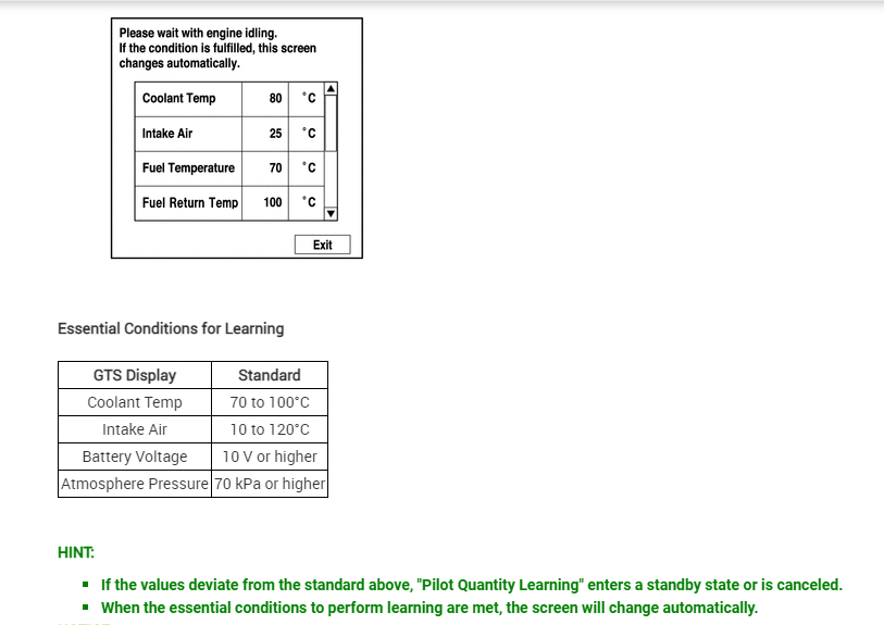

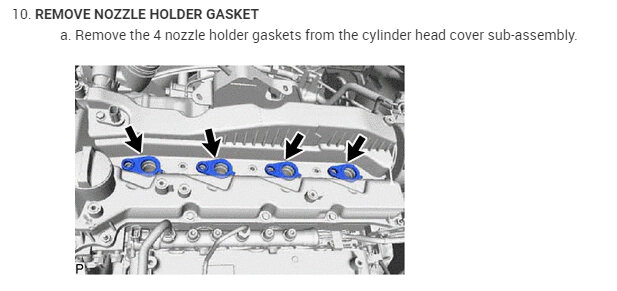

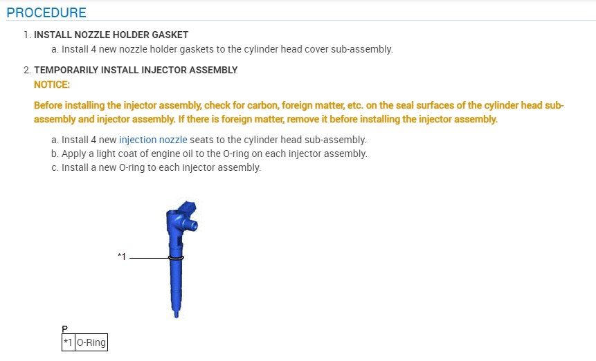

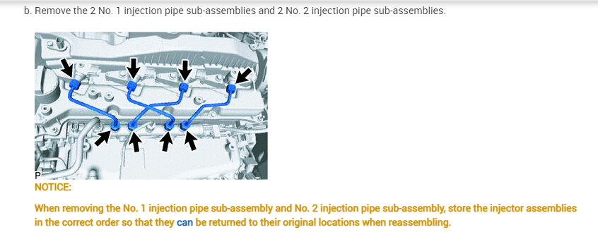

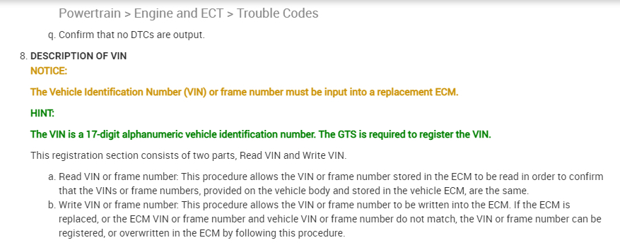

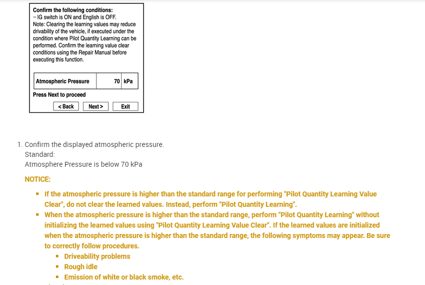

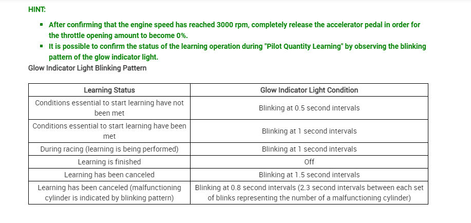

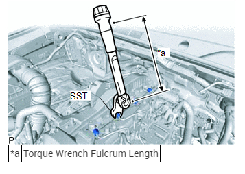

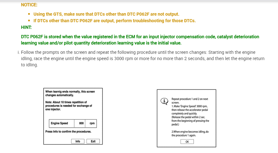

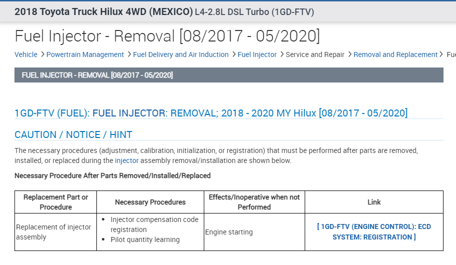

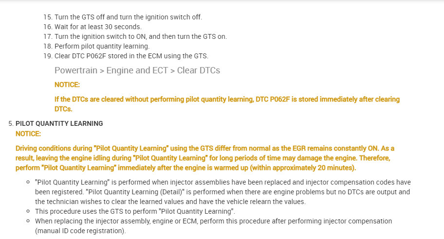

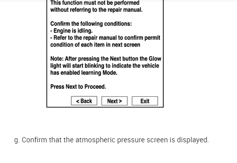

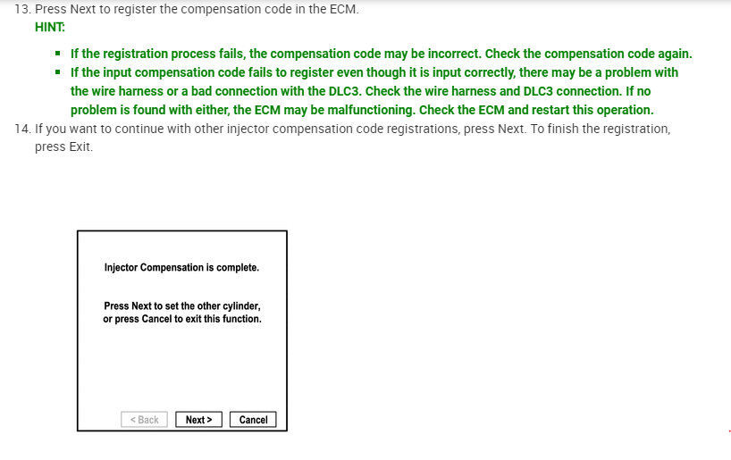

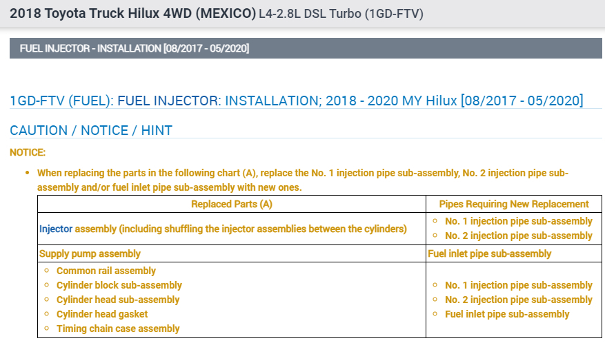

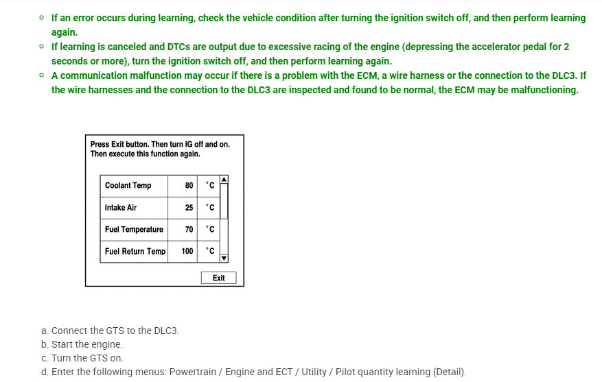

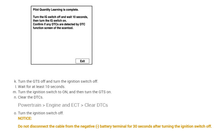

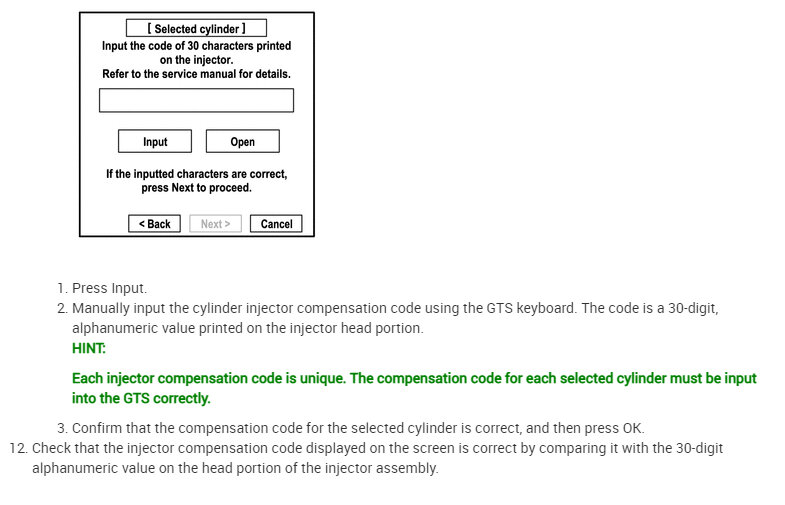

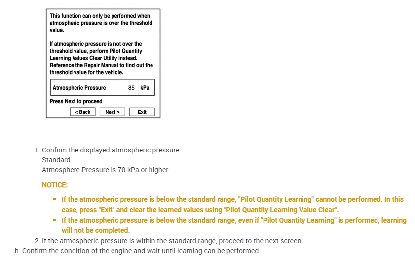

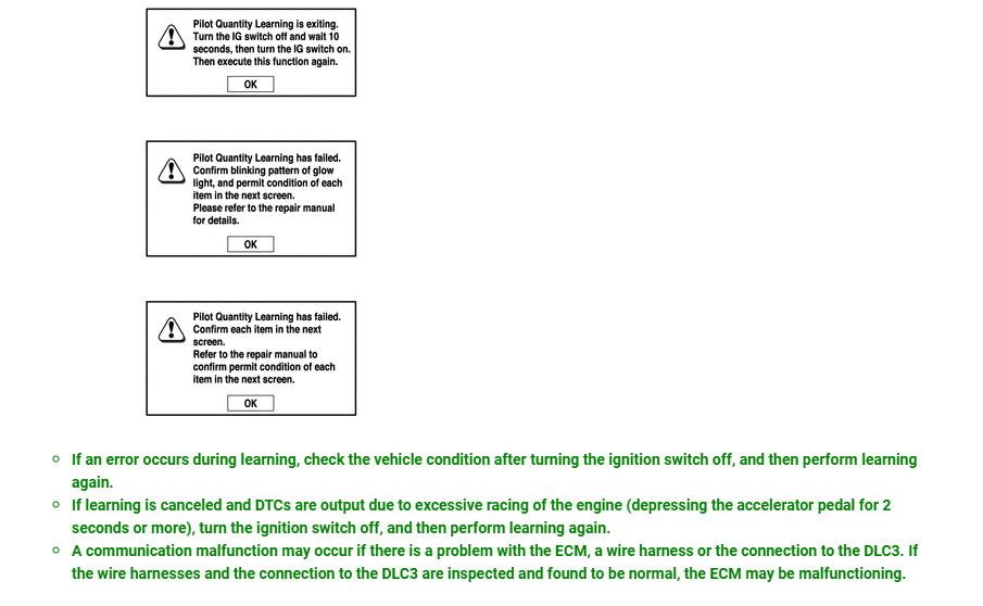

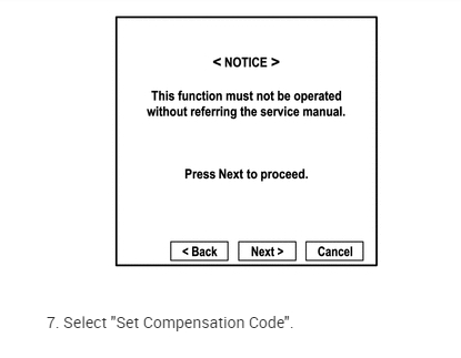

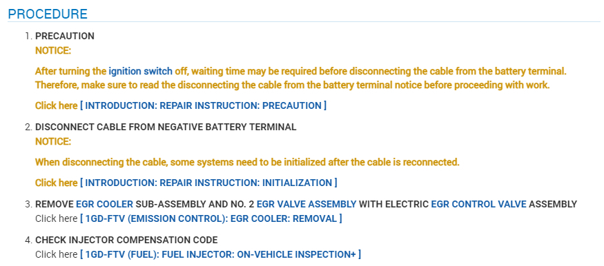

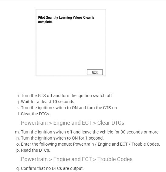

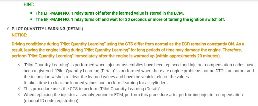

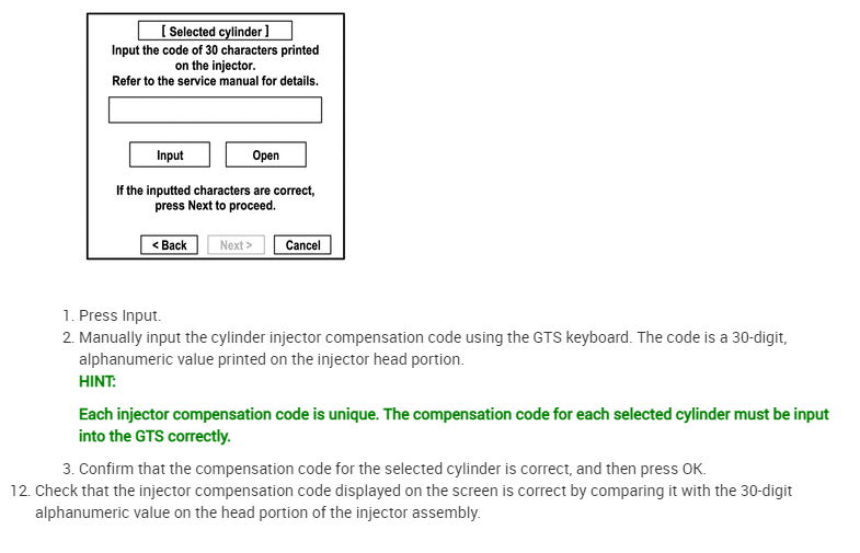

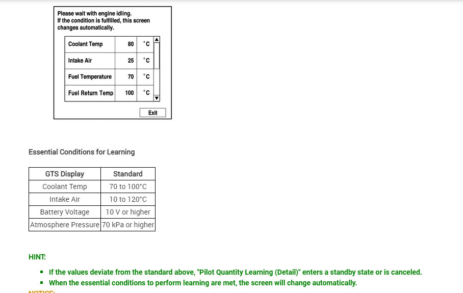

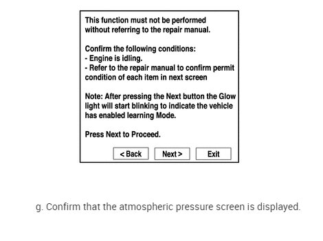

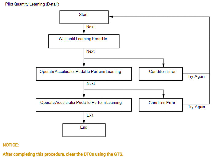

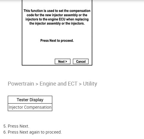

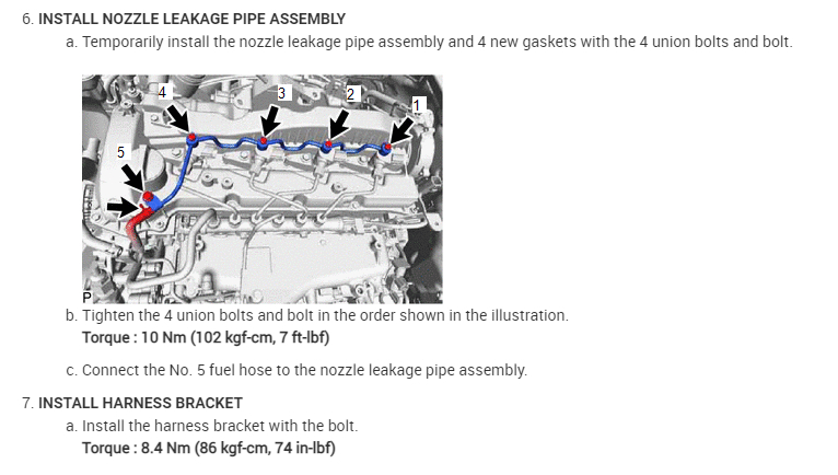

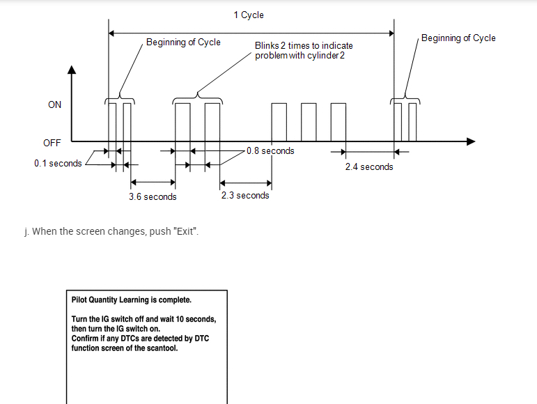

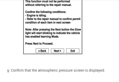

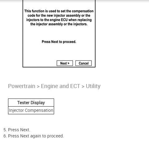

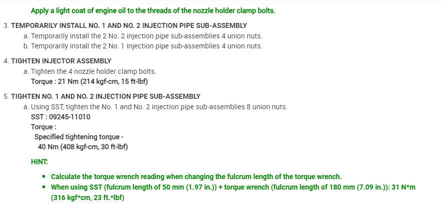

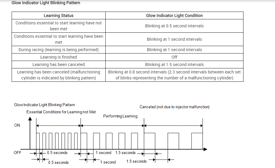

Yep, I had a feeling the resistance shouldn't have been much different. Have you replaced the injectors?

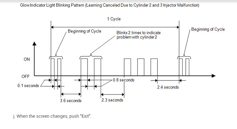

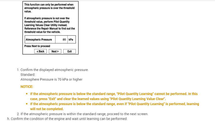

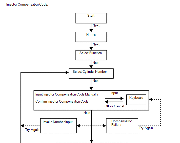

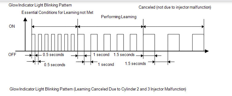

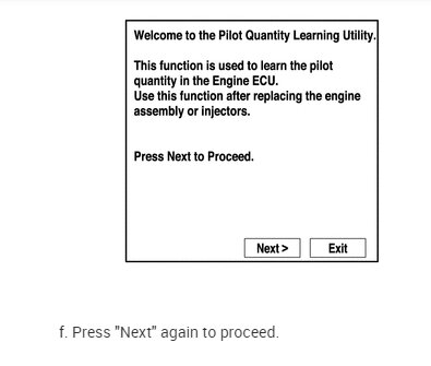

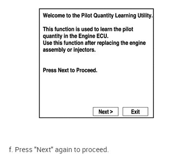

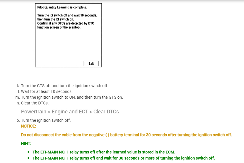

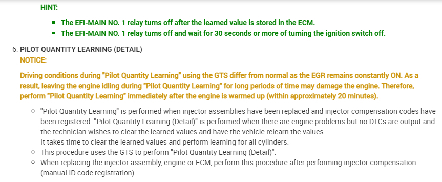

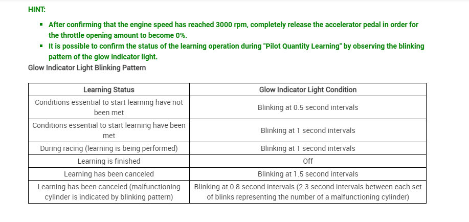

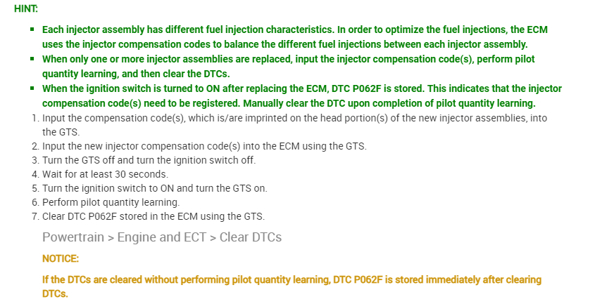

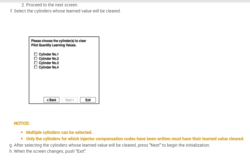

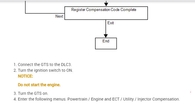

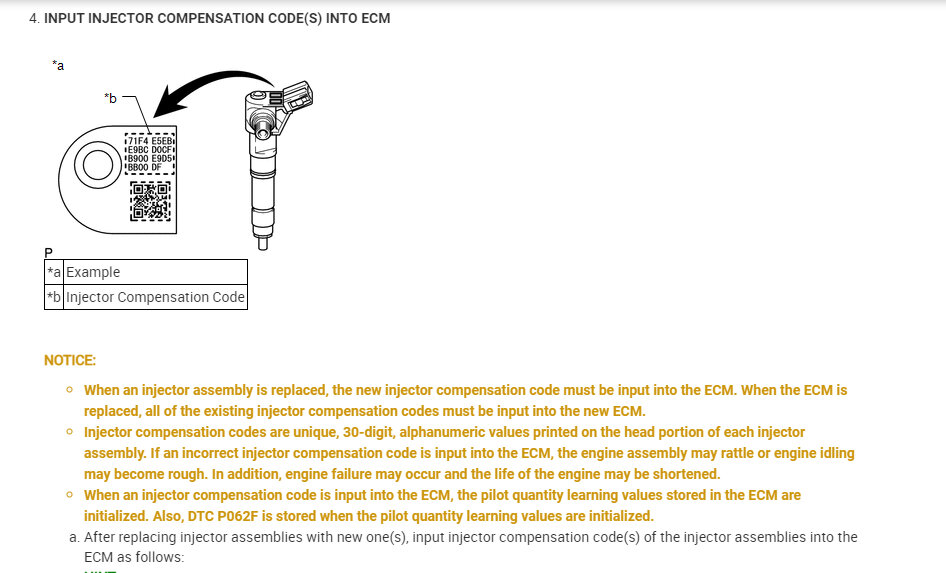

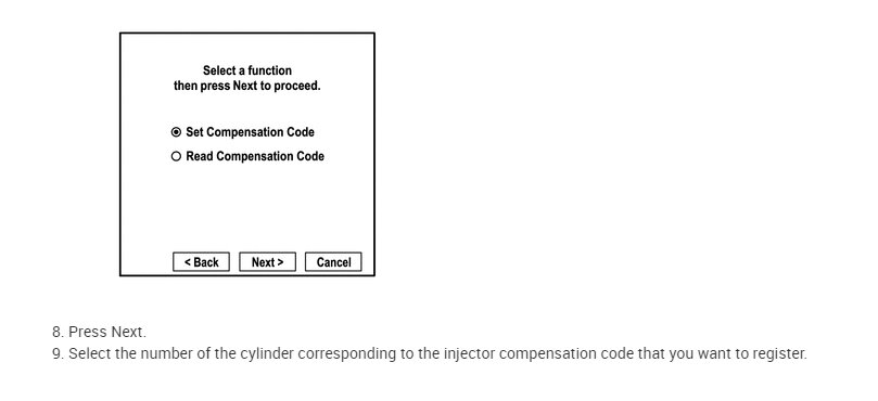

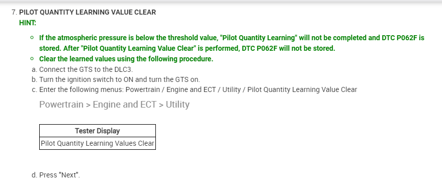

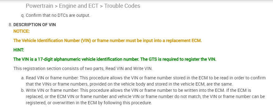

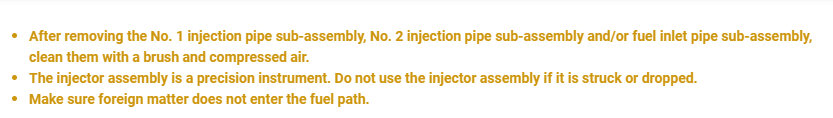

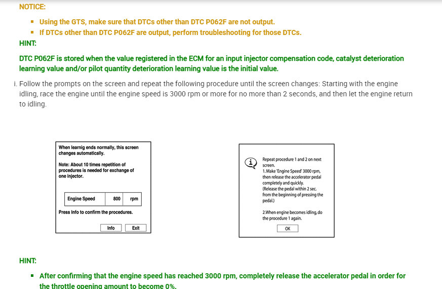

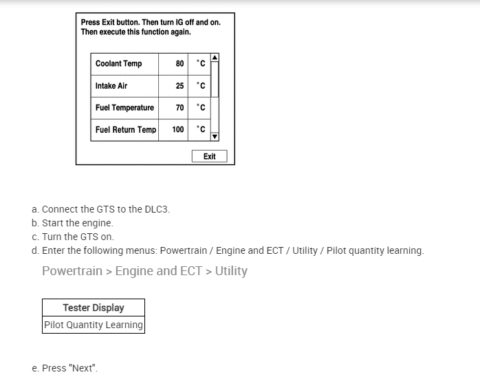

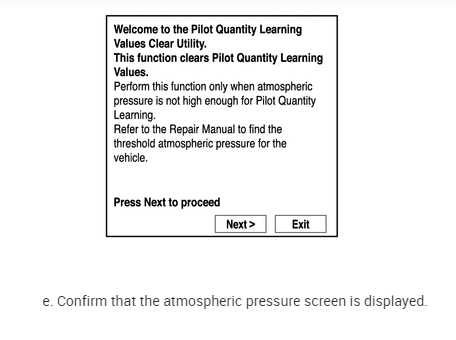

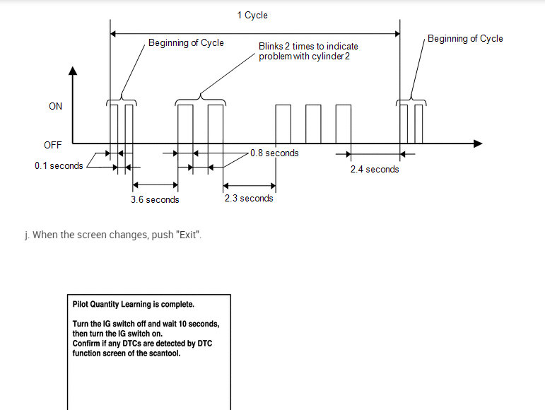

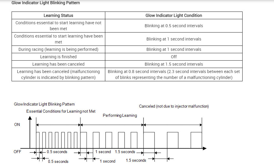

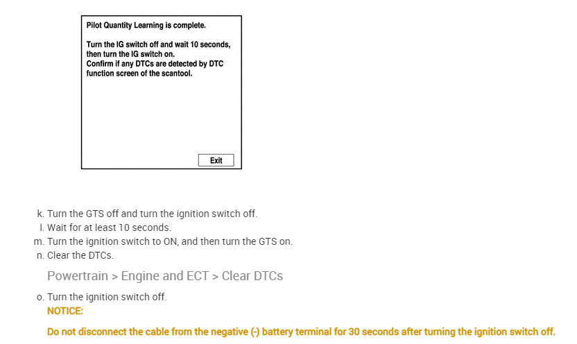

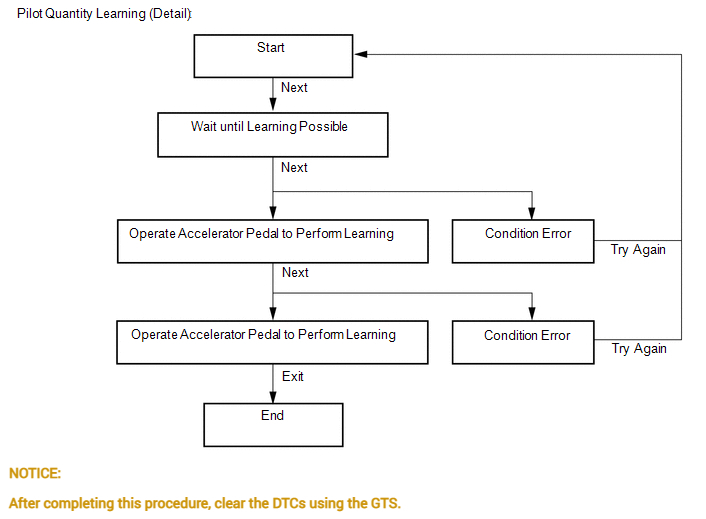

I don't know if you need them, but I attached the directions below. The first 18 pictures are the removal and replacement. The remaining pictures (41) are how to perform the registration information. I can't believe what needs to be done with this. You need to register the injector compensation codes, pilot quality learning, and so on. I attached everything that was in the manual.
The remaining pics are the registration procedures.
