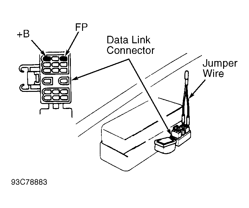

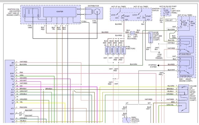

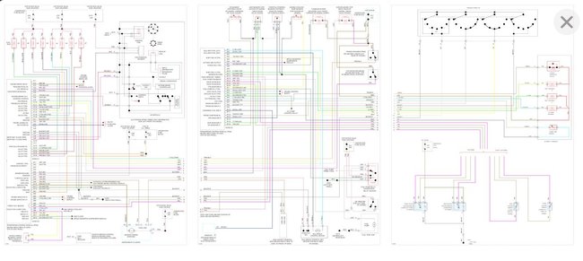

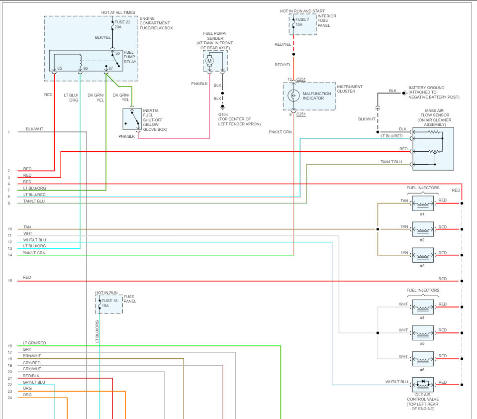

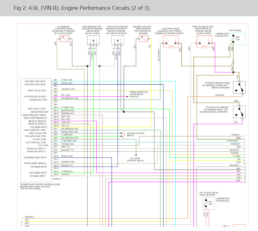

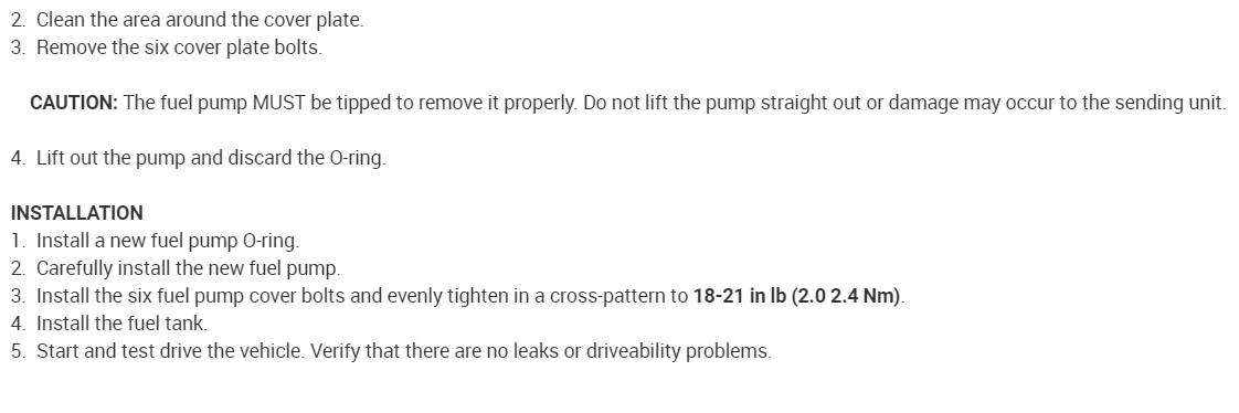

manufactured 10/1994 pickup truck. cranks but will not start. i checked for spark on one spark plug. it does have spark. when i pulled that plug it was not fouled with fuel so i suspect engine is not getting fuel. i have jumper-ed the diagnose connector under hood and there are no codes. i have checked all fuses under the hood and also under dash by drivers left foot kick panel.they are good. i am wanting to know how to approach this for checking for fuel to the engine probably the fuel pump and its associated relays which i think probably i should focus on? i am just looking for next step on what to do and possibly verify the fuel pump operation/ circuit in my opinion might be a problem.
Oct 18, 2016 at 6:04 PM
MHPAUTOS
  • 31,937 POSTS

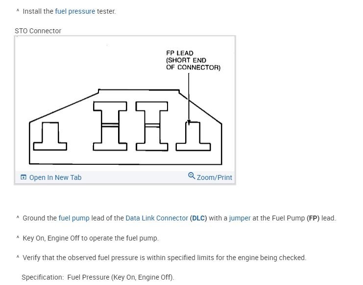

Jump power to pump at the data link terminal to see if pump is working. see picture.
Here is a guide to walk you through how to figure it out.
Please run down this guide and report back
Cheers
Oct 18, 2016 at 7:43 PM
SZALKUSKT
  • 274 POSTS
With ignition key on voltage is present at B+ terminal at data link connector. I put the jumper wire across to fuel pump as described and pump ran confirmed by pump in fuel tank noise and noticeable sound of pressure building in engine compartment fuel line. Pretty certain pump is operable. What should I do next? A relay perhaps?
Oct 19, 2016 at 1:42 PM
SZALKUSKT
  • 274 POSTS

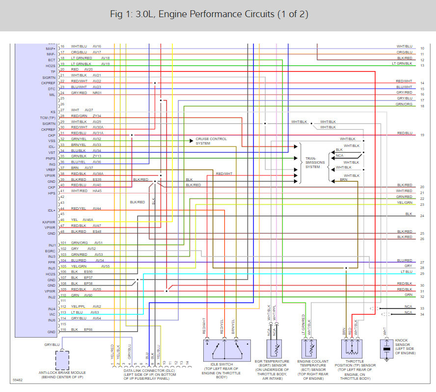

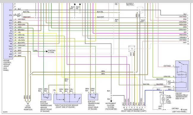

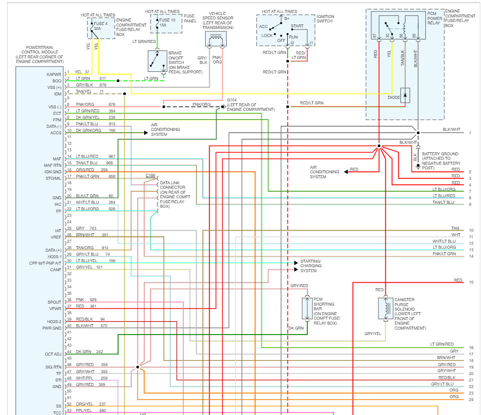

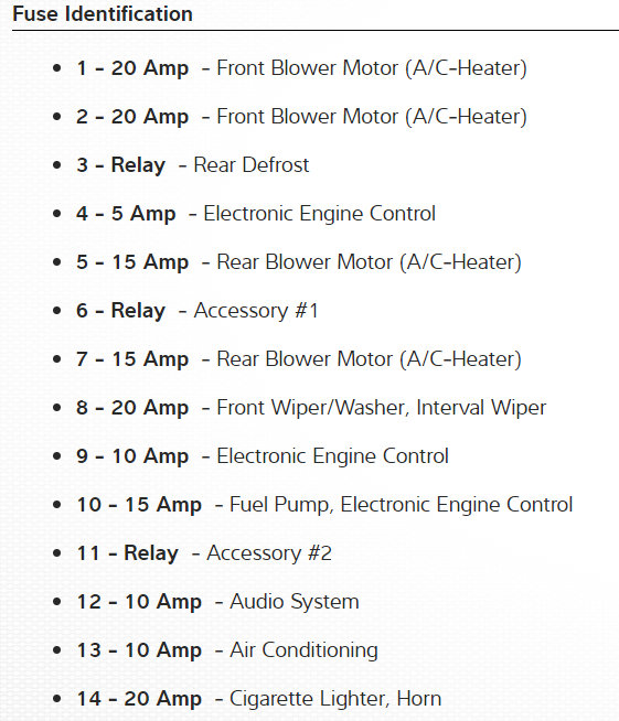

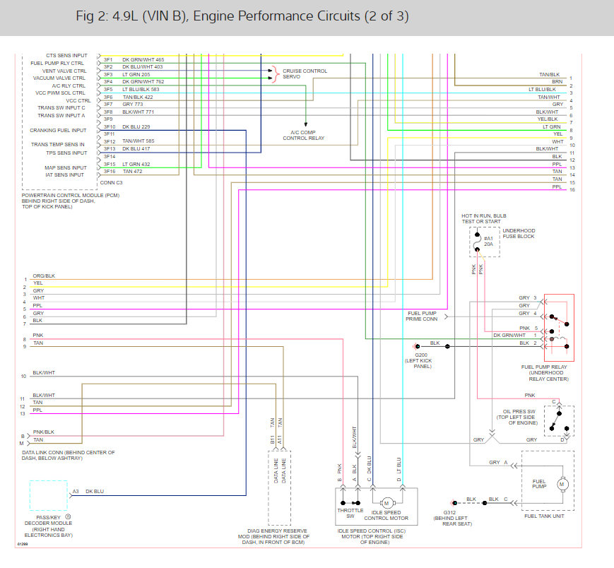

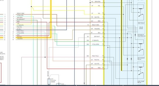

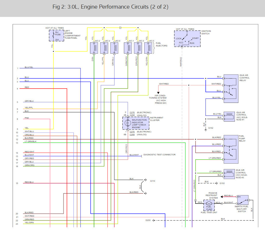

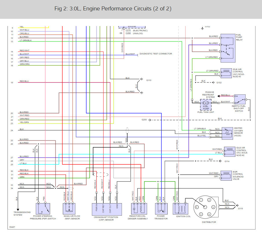

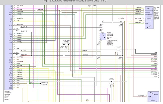

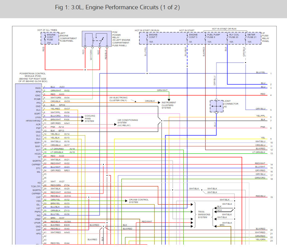

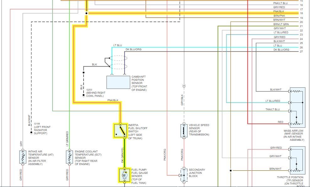

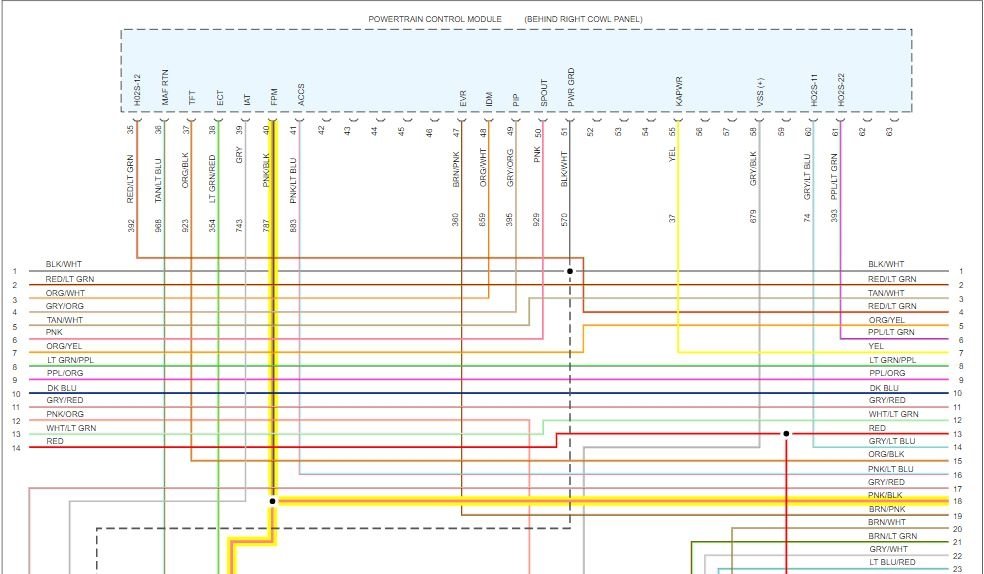

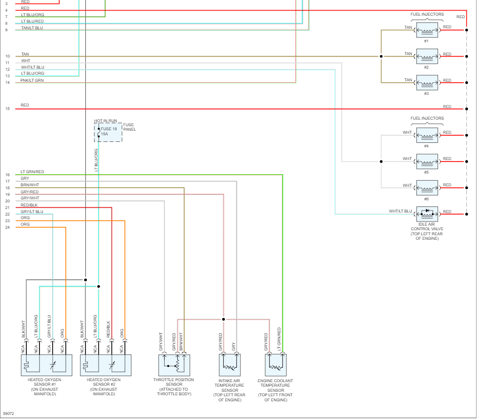

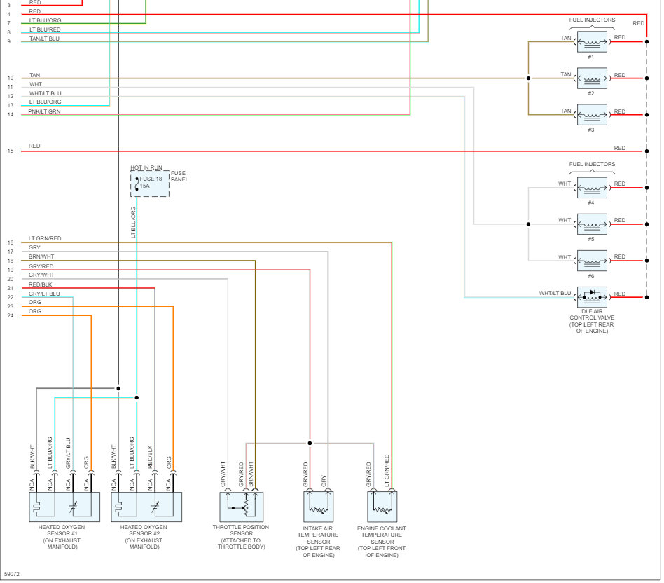

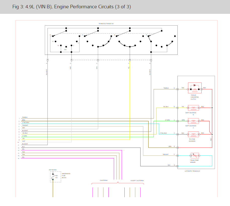

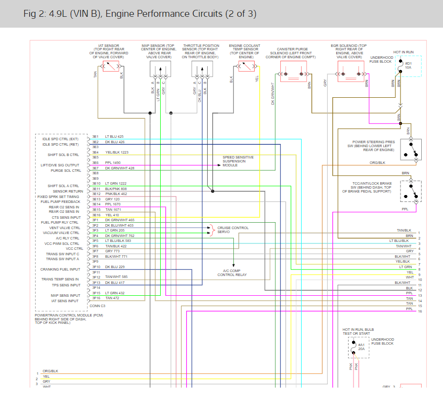

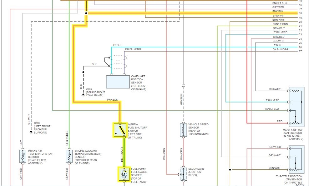

I still need help troubleshooting the fuel pump circuit
Oct 21, 2016 at 7:15 PM
  • 55,718 POSTS
No problem, here are the fuel pump wiring diagrams you requested.
Please let us know what you find so it will help others.
Best, Ken
Oct 22, 2016 at 4:55 AM
SZALKUSKT
  • 274 POSTS

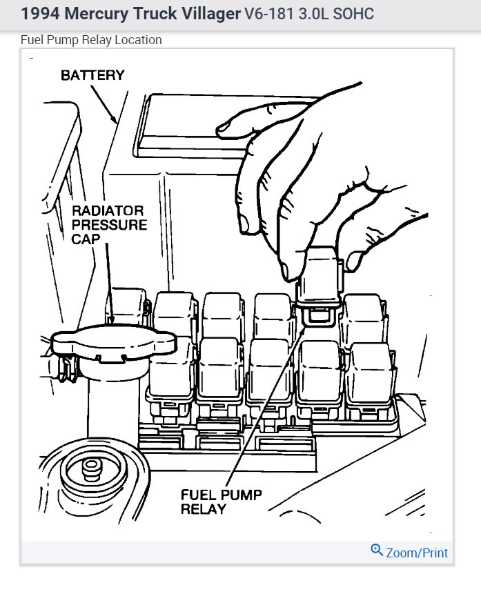

well, the diagrams helped thanks. turns out when i opened the air flow meter the truck started then died out after a few seconds. so being that i checked the efi relay under the hood and it was good, i took the glove box out and looked at the circuit opening relay bolted to the side of the truck at the kick panel area. since it was in the cavity of the body it was subjected to rain water leaking through a rusty hole in the window frame on the side of the windshield. so, since it was wet i went to Napa and bought a relay and put it in and truck is running fine now. fuel pump operates normally.mission accomplished.thanks for your guys help!

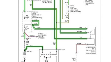

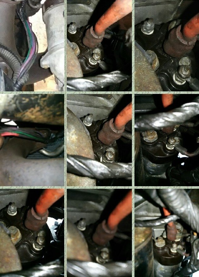

OWHYME

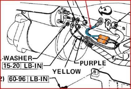

My truck will just click when you turn the key to start it up. I have replaced the battery, distributor cap and rotor and the spark plugs. Occassionally the enging will crank over (sluggishly) after you turn the key about 15-20 times but wont start. Also as I was trying to put the new spark plugs in can you tell me why they are not going in with the threads flush with the engine? They still have visible threads when you check before you put the boot cover back on. Im afraid to over turn them and crack them. HELP please. Sometimes you can get in the truck and turn the key and it will fire right up. But now you have to turn and turn the key to get about a 5 second attempt of a "crank over".
Oct 16, 2018 at 6:18 AM (Merged)
  • 75,988 POSTS
Try this hold key to start postion and bang on the starter if it kicks over-replace the starter. If not look for power at the starter solenoid black and yeloow wire-No power check the starter relay/park and neutral switch and ignition switch

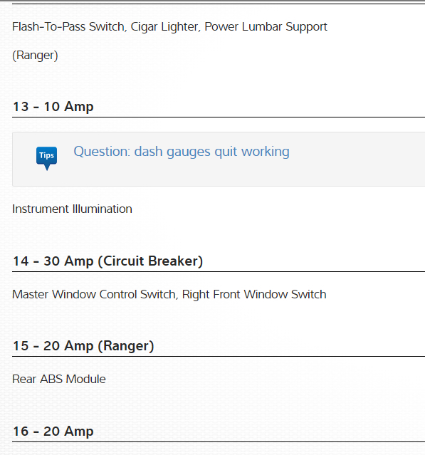

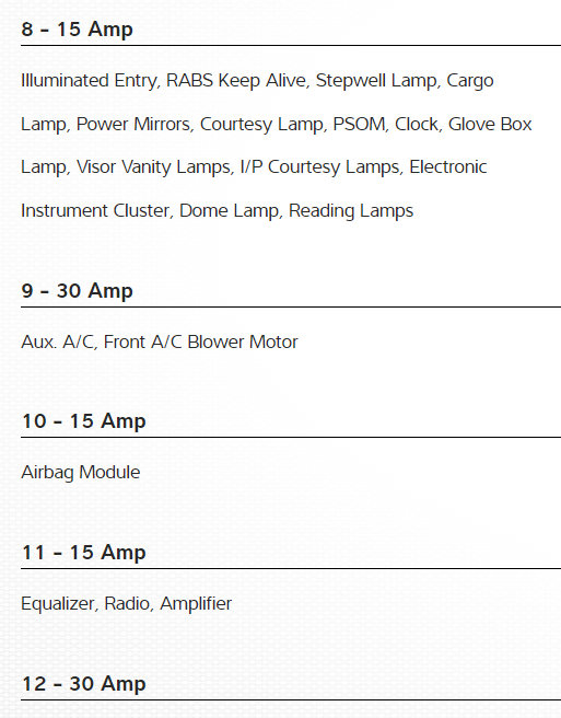

CURRYBOY

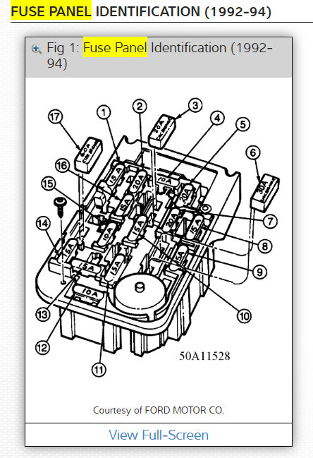

I had a similar issue with my '89. turned out to be a fuse on the inside of the cab. Headlamps worked, cab lights didn't and ignition didn't. Check your fuses. I think it's a 15 amp. It should be labeled indicating "instrument panel lighting" or such.
