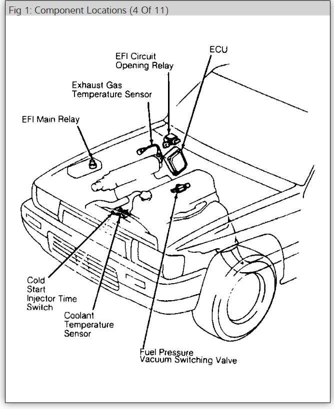

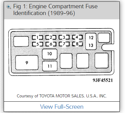

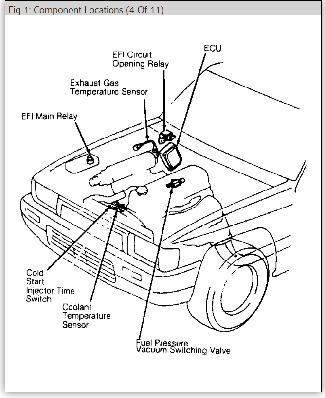

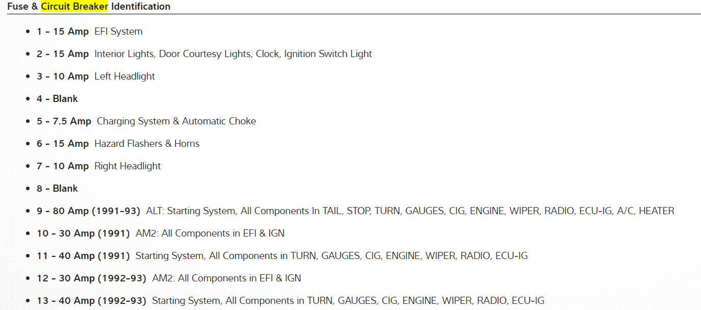

Hey Poppyjack,
It sounds like it is the EFI relay has let go which is common on these trucks. Here is a guide to help confirm the issue and the location of the relay in the diagrams below:
Check out the diagrams (below). Please run some tests and get back to us.

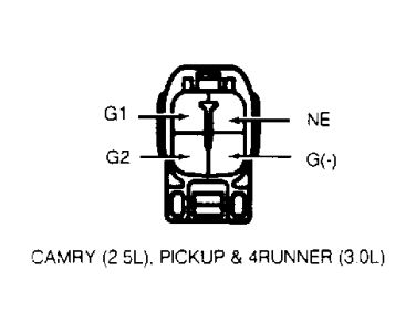

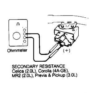

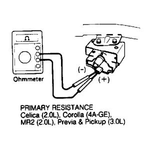

With a limited budget lets test it first if you can. If you have a digital ohm meter or can borrow one then lets check it. The primary resistance should be .4 to .5 ohms and the secondary resistance should be 10,200 to 13,800 ohms. I have included pictures below. The first is how to check the primary resistance and the second one it how to check the secondary resistance. If any of it is not as I have said it should be then replace the coil. Let me know how it goes. I also must ask do you have power to the positive side of the coil with key on? Primary test.
https://www.2carpros.com/forum/automotive_pictures/249564_Graphic_160.jpg
Secondary test.
https://www.2carpros.com/forum/automotive_pictures/249564_Graphic1_18.jpg

Tried the coil test and it was out of tolerance. Replaced coil with new one still no spark. There is power going in to new coil but none coming out.

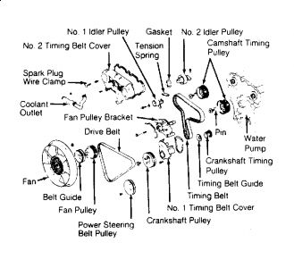

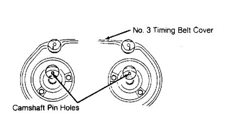

Well, while doing the tests you mentioned, we noticed that when cranking the engine, the rotor does not move, time gear belt busted?

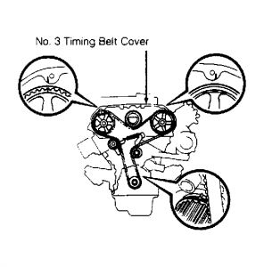

Well, I would say that if the distributor rotor does not turn that yes the timing belt is probably broken. You will have to pull the upper belt cover and check to see if the belt is turning when cranking or not. Here is a picture of what all is in there. If you find a broken belt I would plan on the belt the tension-er and idlers and water pump sense the belt drive the water pump.
https://www.2carpros.com/forum/automotive_pictures/249564_Graphic_165.jpg

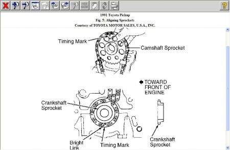

After I replace the belt what are the timing positions for the crank and drive shaft?
Jul 22, 2018 at 1:46 PM (Merged)
  • CERTIFIED EXPERT
  • 75,992 POSTS
Put the engine's number one piston on its compression stroke/TDC then align it-remove the distributor and restab it and make sure rotor is pointing to the cap number tower as indicated in the repair manual.
https://www.2carpros.com/forum/automotive_pictures/12900_timing_13.jpg

Here are the timing marks. If you need anything else just let me know. Also let me know the outcome okay.
https://www.2carpros.com/forum/automotive_pictures/249564_Graphic1_19.jpg
https://www.2carpros.com/forum/automotive_pictures/249564_Graphic_166.jpg

Where is the crank mark supposed be is the key on the crank?

The timing mark is on the crankshaft sprocket should be position six o'clock. Are you using a repair manual or just playing it by ear?
