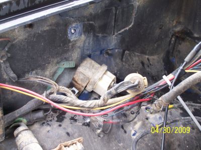

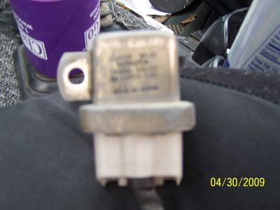

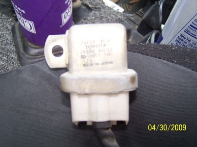

O MINE IS A DIFFERENT PROBLEM. THE STARTER RELAY THAT IS UNDER THE HOOD ON THE PASSENGER SIDE MOUNTED ON THE WHEEL WELL. I AM GOING TO POST A PIC. IT JUST CLICKS ONCE WHEN I TURN THE KEY OVER. ITS NOT THE BATT, ALT OR THE STARTER IT MIGHT BE THAT THE RELAY IS JUST BAD, BUT A NEW ON IS $180 BUCKS AND I CANT FIND A USED ONE ANYWHERE, MOST PLACES DONT EVEN KNOW WHAT I AM TALKING ABOUT. DO U HAVE ANY IDEAS FOR ME.THE PART SAYS STARTER RELAY TOYOTA 283000-35010 12V ON IT.

What year truck and motor is this? Did you jump the starter solenoid to see if it will crank? Presume you cleaned all the battery and starter connections as well. You might try this link for more info on continuity testing your relay before you replace it. Presuming you have a 4-pin relay refer to the drawing on the relay. Using an ohmmeter, check for continuity between terminals 1 and 3, and for no continuity between terminals 2 and 4. Replace the relay if continuity is not as specified. I tried uploading a component test sheet but no luck.

I ran that test u told me about, 1 and 3 terminal was bad. Found one at a junk yard for 10 bucks I put it on and it works like a charm. Thanks for all you help.
