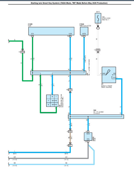

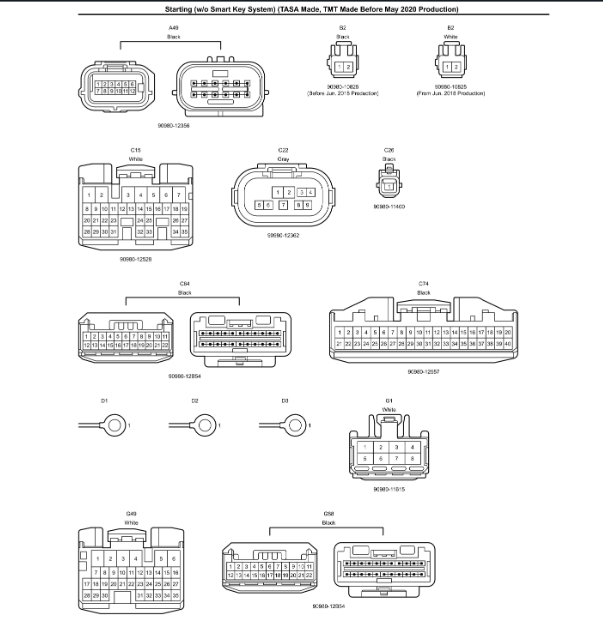

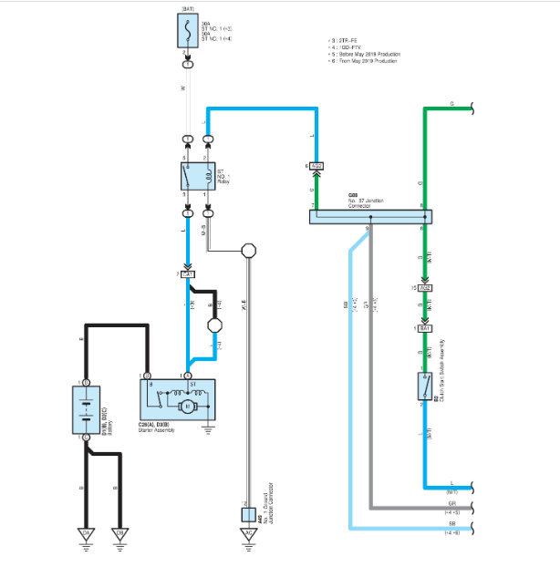

Please if I could have diagram of power and ground for kick starter. I have been getting a short circuit, 9 volts going to the kick starter instead of battery current.

I would be happy to help, but I need the model and engine size. Let me know if it is a Tacoma, a Tundra, or a Hilux. Also, which engine is in the truck?
I need that to get you the correct wiring schematic.
Sep 16, 2022 at 1:20 PM
ANDRIN ATEM
  • 414 POSTS
It's a Hilux 2018 model.
Sep 16, 2022 at 6:05 PM

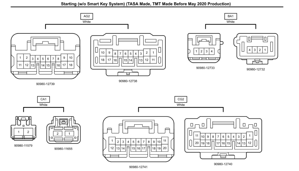

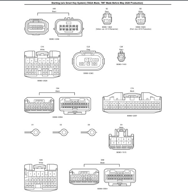

  • 110,248 POSTS
I attached the wiring schematics for the starter circuit. Note that these are for a vehicle made without a smart key. If that is incorrect, let me know.
Sep 17, 2022 at 2:32 PM
ANDRIN ATEM
  • 414 POSTS

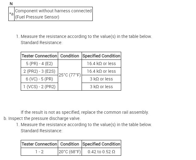

Perfect. Its correct. May I also get the pin out Diagram for the rail preasure sensor, also the resistance if testing with a multimeter. I notice I get 2.5 volts coming into the rail preasure sensor, I thought I was suppose see volts.
Sep 30, 2022 at 4:17 AM
ANDRIN ATEM
  • 414 POSTS
The rail pressure sensor is a two-wire cable. I need the input volt to the sensor and a resistance if using a multimeter to check if the part is good. Using my diagnostic tool, I notice the value remains at 0 when cranking the car on live data, but the pump works well because you can see fuel coming out from the injectors.

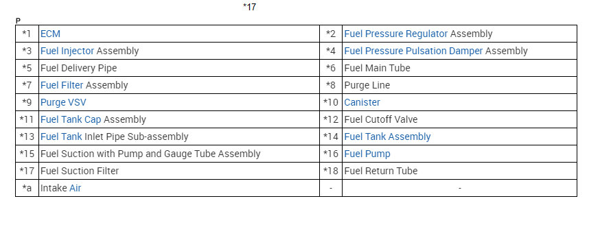

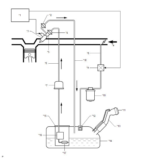

  • 110,248 POSTS
I'm looking through the wiring schematics and component identifications for the fuel system and I see no fuel rail pressure sensor. Could you be referring to something different?
Take a look below at the pics I attached. Do you see what you are checking?
Sep 30, 2022 at 3:05 PM

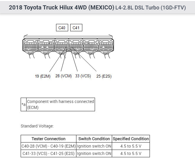

This Hilux is a Diesel engine not a gasoline. It has the rail and an Injector pump. What I need is the input voltage signals to the common rail pressure sensor. It's a 2-wire pin. What voltage I am expected to see. 5volts from the ECM or 5volts. How can I also test the fuel rail pressure sensor using a multimeter to check the resistance?

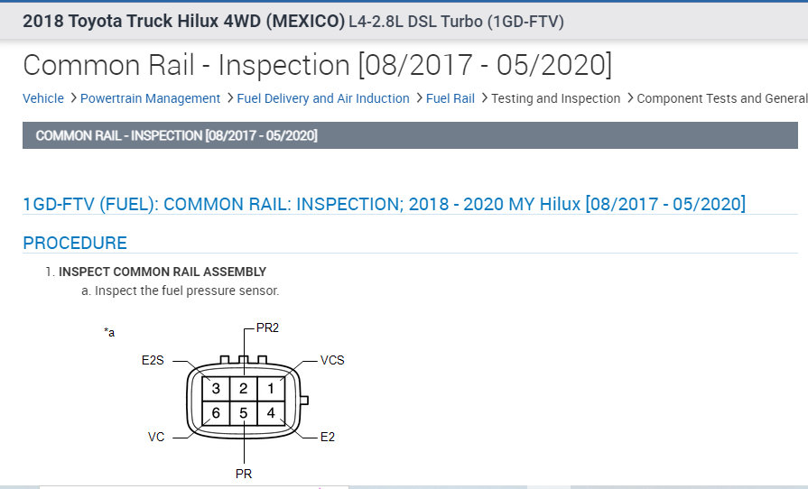

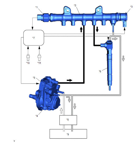

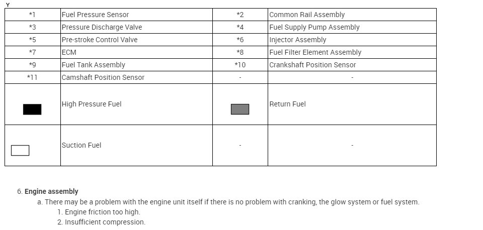

  • 110,248 POSTS
This is making sense to me now. I am struggling to find the info you are looking for and I know why. The only info I have is for a L4-2.7L (2TR-FE) gas engine. I show nothing for a diesel.
So, I went further into the manual and found a 2.8L turbo diesel available on a 4wd model. Is that what you have? You didn't indicate which you had above and when there isn't anything listed, I assume it's 2wd. LOL
As far as voltage input, it should be 5v. To test it with a multi-meter, you will be checking for Ohms of resistance. I attached the directions below.
Let me know if that helps or if you have other questions.

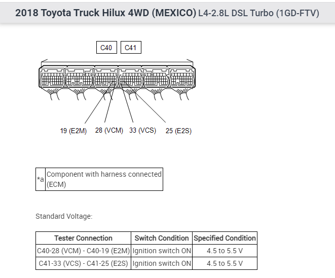

  • 110,248 POSTS
From what I am finding, 5v is correct. Voltage from the ECM should be between 4.5v and 5.5v. See attached.

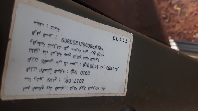

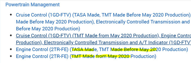

  • 110,248 POSTS

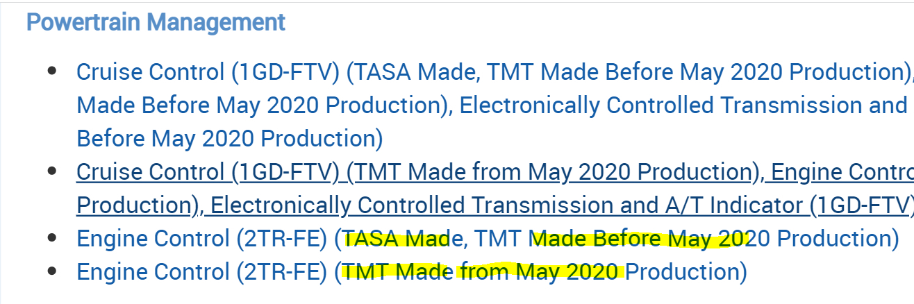

I ran into a wall when checking info. I need the production date of the vehicle. It appears there are two variations of the powertrain management circuits based on date. See pic below.
See pic below.
Oct 10, 2022 at 11:55 AM
ANDRIN ATEM
  • 414 POSTS
2018.
Oct 10, 2022 at 1:37 PM
ANDRIN ATEM
  • 414 POSTS
2018 diesel turbo 4x4 not a push button.

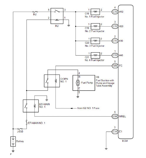

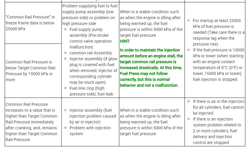

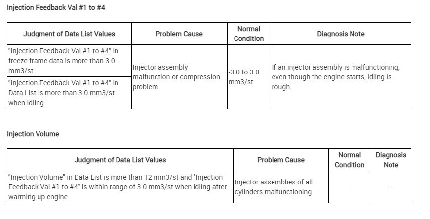

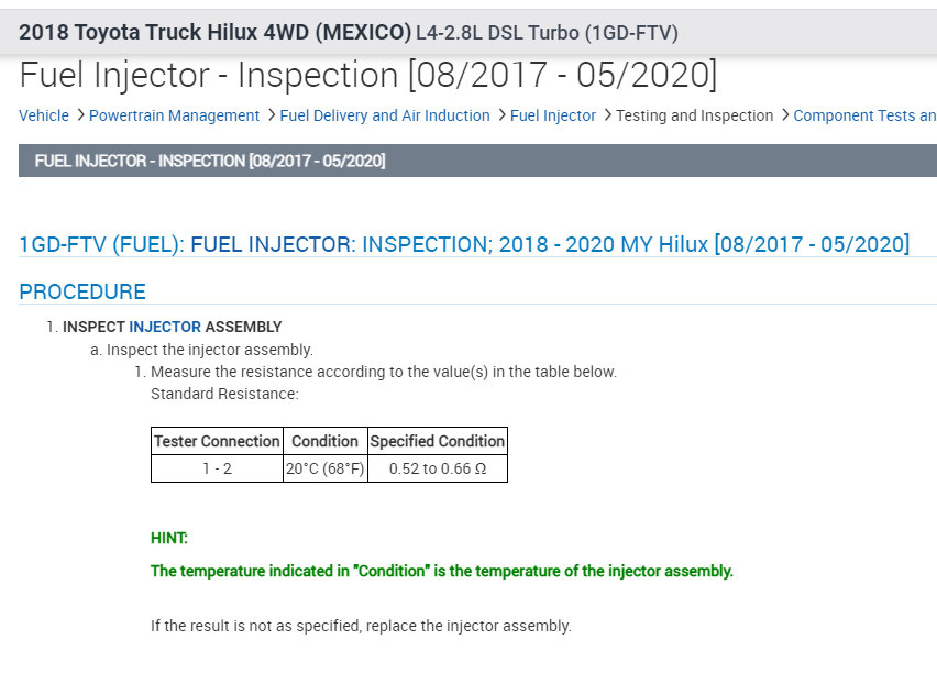

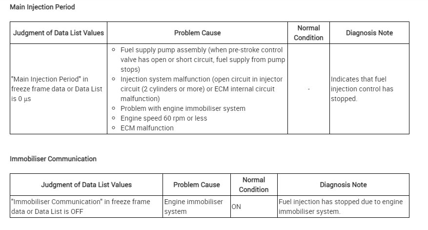

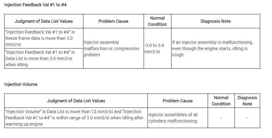

  • 110,248 POSTS
I was able to find the testing for resistance, but there is nothing I am able to find specific to voltage. I would think it would be B+ voltage but I can't confirm it. Any injector that I can think of works off 12v. They have power all the time and the ECM provides a ground path for the injector.
Take a look below and let me know if that helps.
See pic below.
Oct 11, 2022 at 11:26 AM
ANDRIN ATEM
  • 414 POSTS
Thank you. I was rather getting 0.1 ohms of resistance. Probably the value is not as specified in the table below.

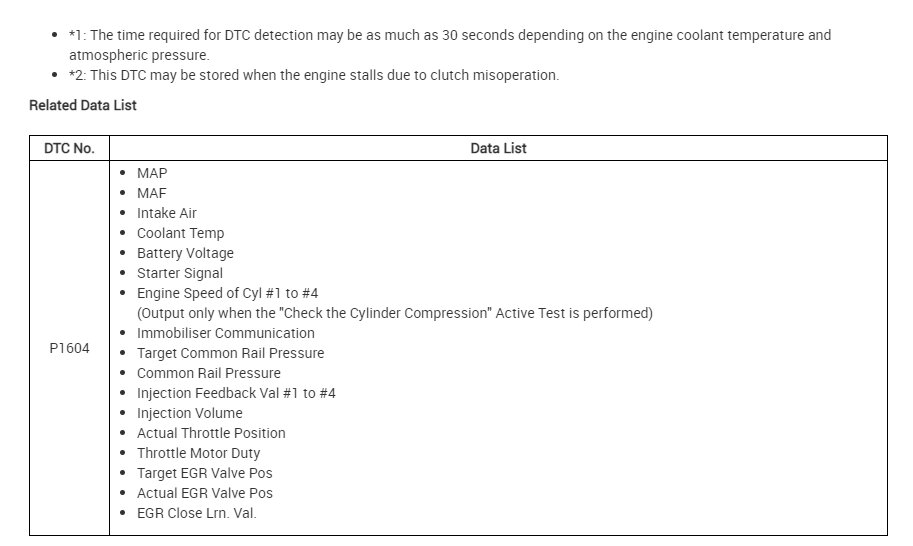

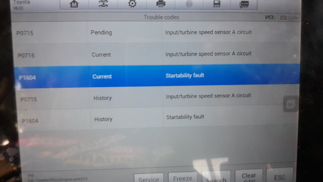

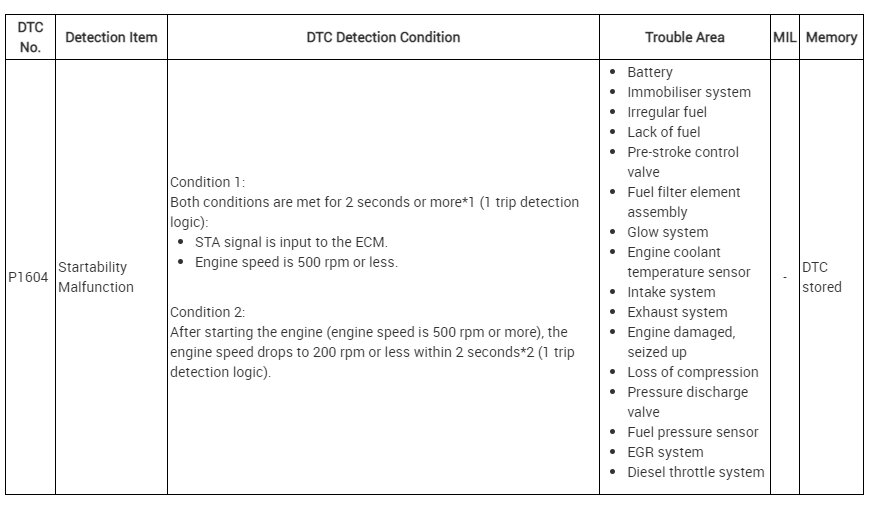

I had these two codes fault stability and turbine transmission speed sensor.
I hope the turbine speed sensor one of them is responsible for why I am not getting the 12 volts on my I injectors. Those are the only two codes I keep getting now.
Oct 11, 2022 at 12:24 PM
ANDRIN ATEM
  • 414 POSTS

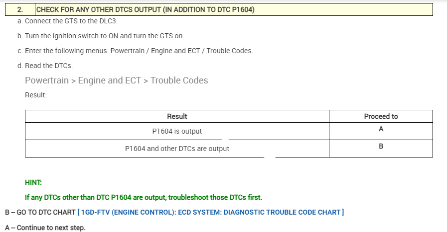

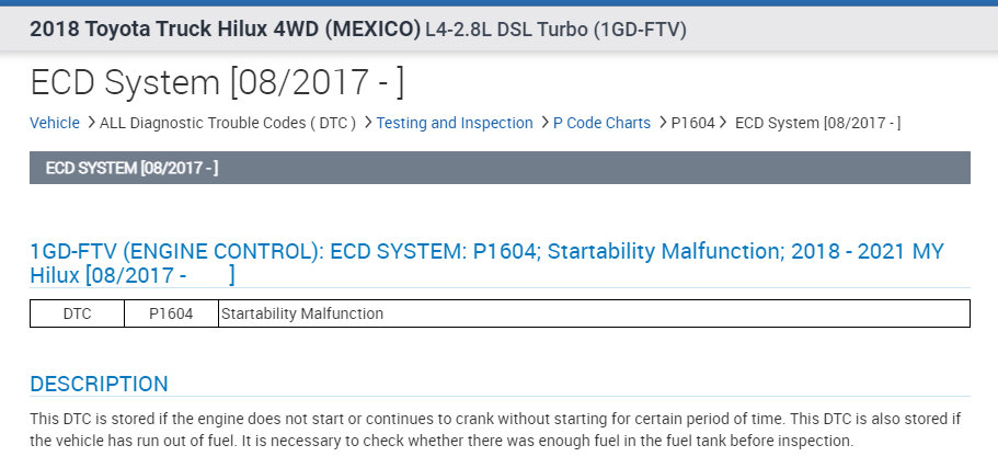

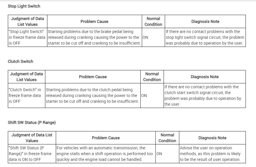

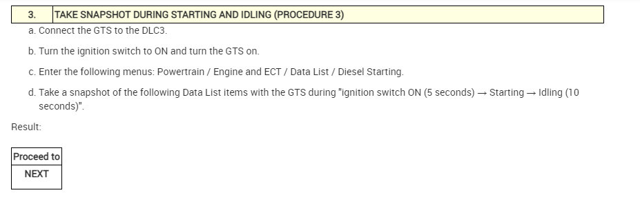

P1604 and 0715. The input turbine speed sensor and faulty stability which has to do with starting system. Maybe you can share your expertise.
Thank you Joe.
Oct 11, 2022 at 12:28 PM

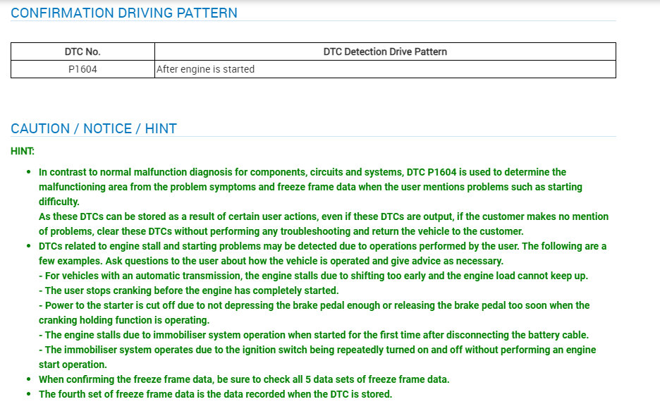

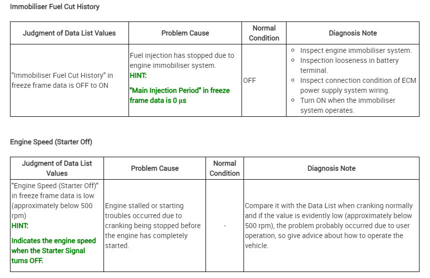

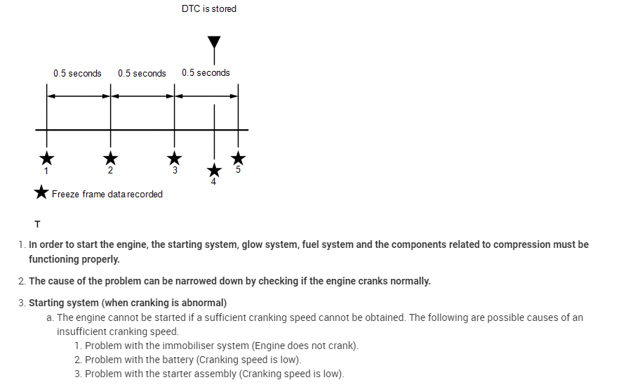

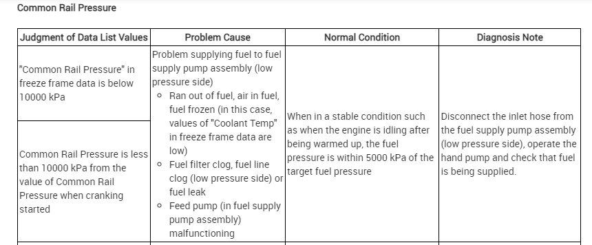

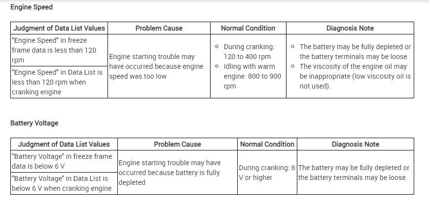

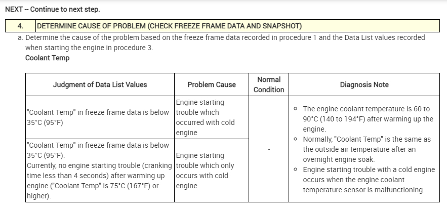

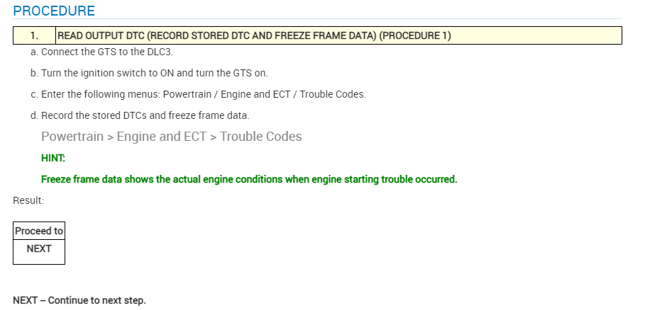

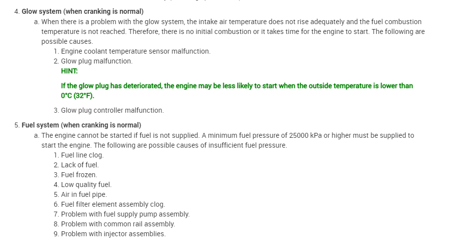

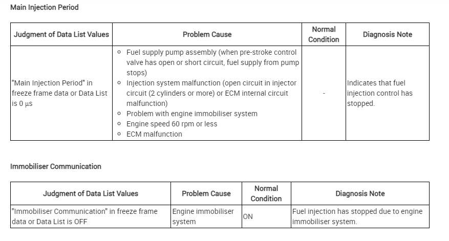

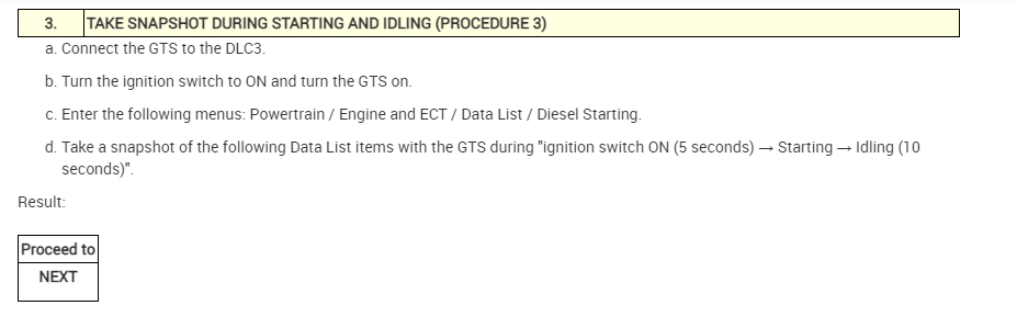

  • 110,248 POSTS
The 715 is related to the trans and I wouldn't think it's related. 1604 does seem related. I attached the diagnostics for 1604. Take a look through them and let me know if you are comfortable performing them.
Oct 11, 2022 at 1:00 PM

Thanks again. However following the values of the injectors, all 4 injectors read 0.0 ohms. I am sure those injectors are not good.
Oct 12, 2022 at 3:06 PM
  • 110,248 POSTS
If you have 0 resistance, the injector is bad. It should be between 11 and 14 Ohms. Some can reach up to 24 Ohms.
