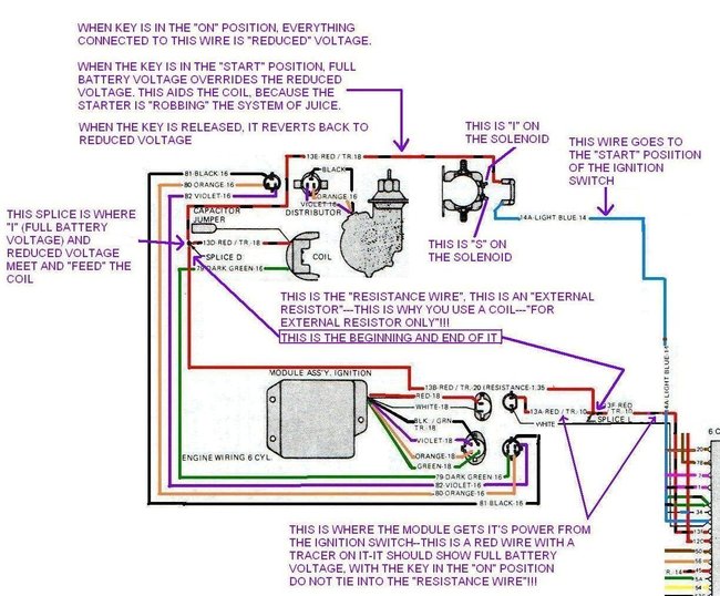

Video shows "000".
If you touch the leads together (just the meter looping back on itself) You get "000" also. This is continuity.
If you got "1" the leads are not touching each other, there is no continuity.
If the video is purple to orange getting "000". All is fine with the distributor. We will move on.
Green wire-reconnect it, most likely not an issue, unless the other end is not connected.
Better Picture of the ignition module connectors and wires? Want to see what is hooked up and is not hooked up.
Check the wiring to and from the distributor to the ignition module. Disregard other stuff.
