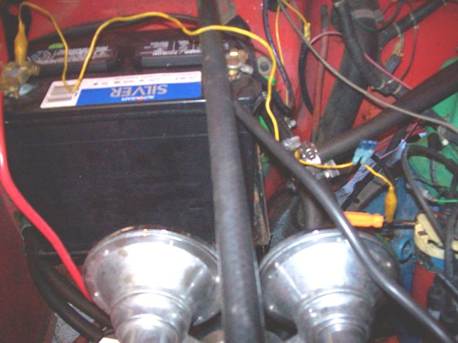

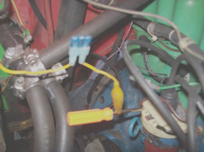

Just as a test,
Try this
Positive Battery to Positive Coil
Then attempt a start.
If it coughs into action, removing the wire should kill it.
WATCH OUT FOR THEM PESKY MOVING PARTS!
If things are scarce, you can chop up a cheap 6 foot household extension cord to do it.
Lemme know what happens!

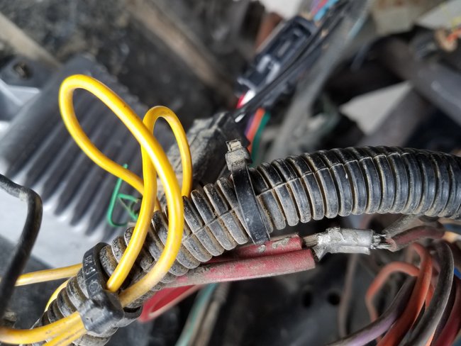

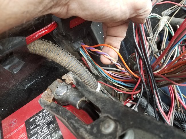

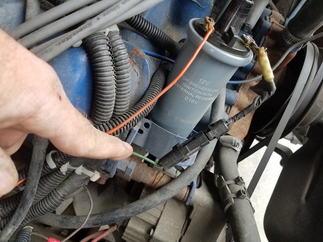

Yes as I said I replaced the distributor. I clocked the rotor and the advance pot before removal and reinstalled in the ecact same positions so the timing is close to correct. I listed everything i have done or confirmed in the previous post. I have traved all the wires now and drawn you a diagram. There are other pics too.

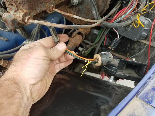

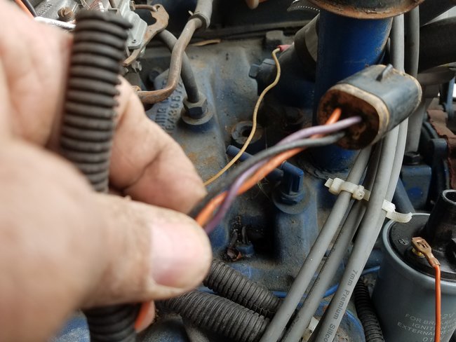

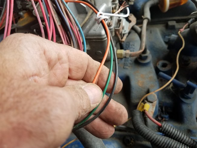

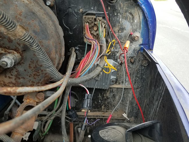

1. Diagram
2. Splice at fire wall
3. Module
4. Module connector

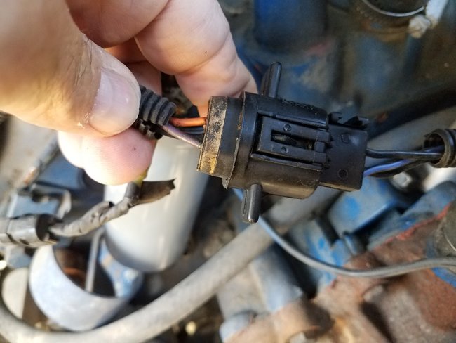

5. Wires out of loom
6. Duplicate
7. Distributor connector

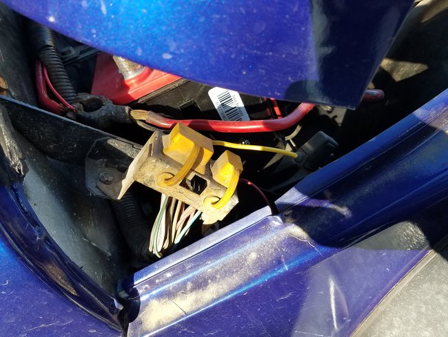

8. ? Something inline to coil-
9. 2 oranges and a purple through passenger side firewall.
Any of this helpful?

Good pics!
How 'bout some of the distributor and the ignition module. But most of all, their connectors/ connections. Definitely has some add on wiring (that may have worked in the past- maybe could be improved)

Any clue whats under the dash on the passenger side. ??? Too dark for pics now. Stand by. Agter resding many of your posts I cant figure why i have no spark while cranking. ??? I have 11v at the coil. I understand that if the timings out it won't run but it would backfire and carry on. ???? Its also odd that I get a spark when depressing the start button and when releasing it. What is that black thing in line on the green wire. I have been trying to do this systematically based on other if your posts. Do you have a procedure to follow step1 through step? I only get to work on it in spurts so it is difficult to do this one post at a time.

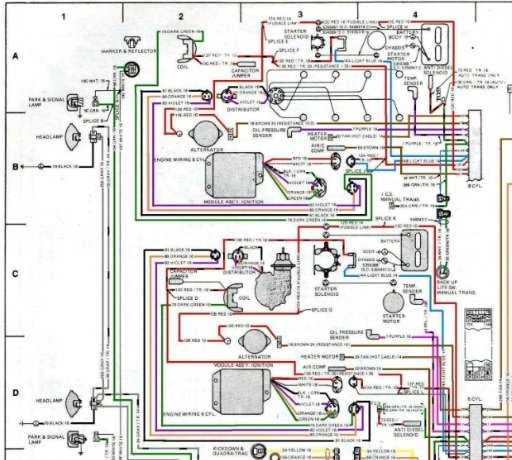

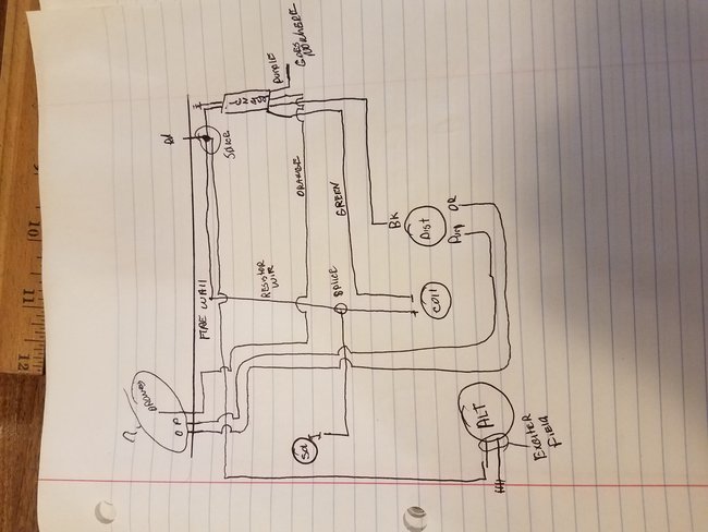

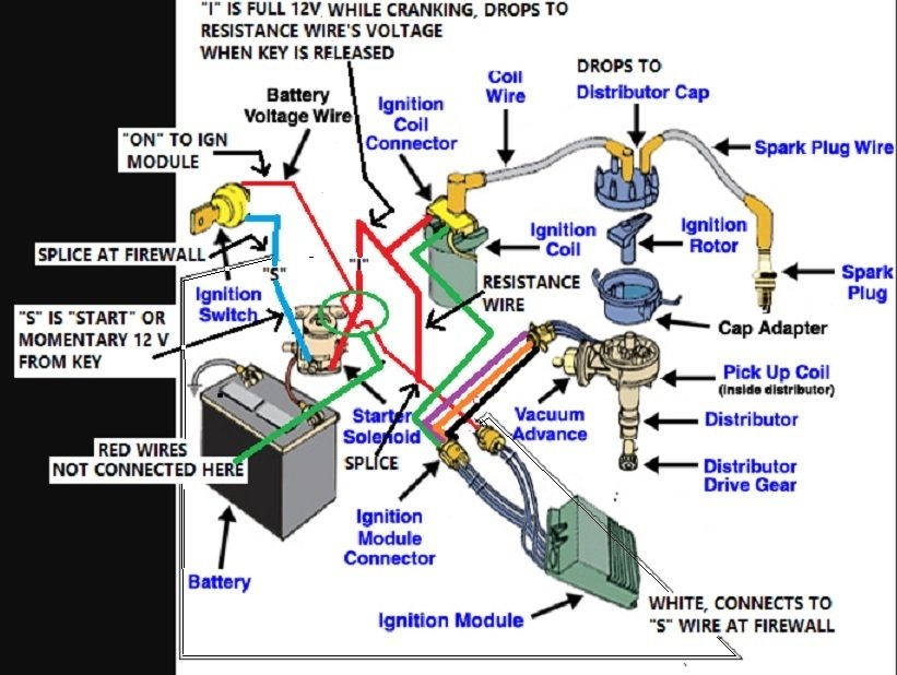

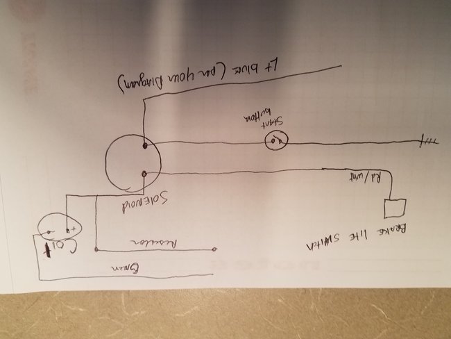

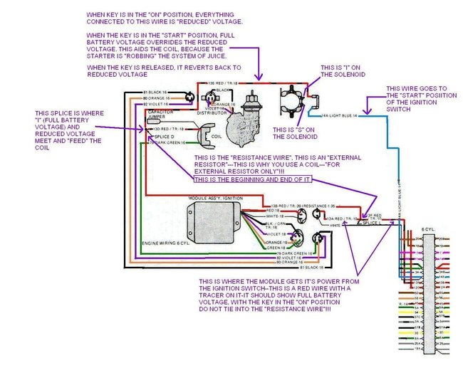

I've spent a good while making this for you.
That's why I have not responded.
Lemme know if this helps, I found the basic diagram on the net, you'll see my erasing and adding of the wires and explanations. Post any un-sure-ities!
Alternator thing is new on me! Maybe a condenser for the radio? Fusible link? Does the juice flow thru it?

IGN MODULE "WHITE WIRE" came down, then over the module, then to the bottom, ran left, then up the left side and tied into the "S" wire (BLUE- you can see that end of the white wire) These two wires connected at the firewall (look at one of my 1st diagrams from way up above).

pics of dist/ module connectors

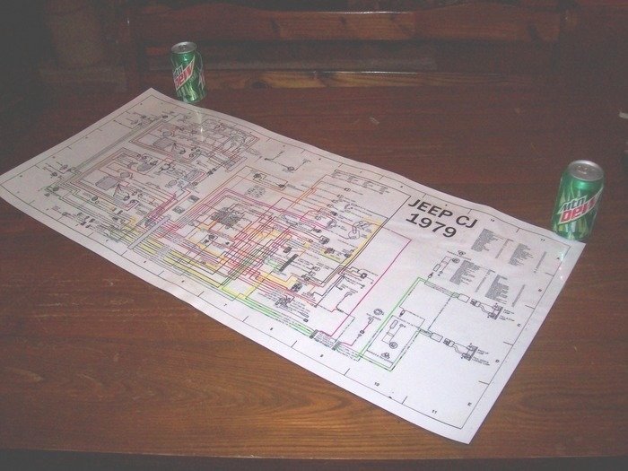

Pic below is 1979 diagram from a manual
I scanned it, colored in Microsoft Paint
I colored the wires best I could (so I could understand the ones with color tracers, color of the tracers was not given)
The 258 and 304 share the same diagram. 304 being in the upper left corner and 258 is directly below it.
You will see the Battery for both. East and West and South of the 2nd battery is mostly the 258. Sorta disregard the stuff pertaining to the 258 (it is so close to the 304 wiring).
1st pic is both engines
I cropped 2nd pic to show more 304
I feel sure the 1984 Ghost wire goes into the firewall/ thru the computer/ back out.
Need to eliminate the ghost stuff and insure the wires go directly from one part to the other with no 'goodies' in-between.
Pic 3, I also had the 2 pieces of my home-colored diagram blown up at Office Max. I overlapped them correctly, taped them in place, then Office Max laminated it for me. It's darn big/ EZ to trace wires/ fast to find stuff.

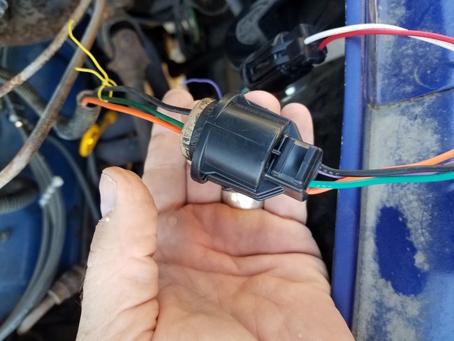

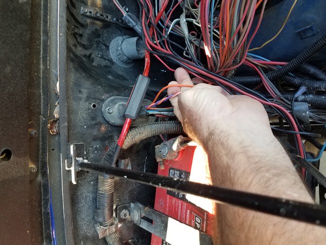

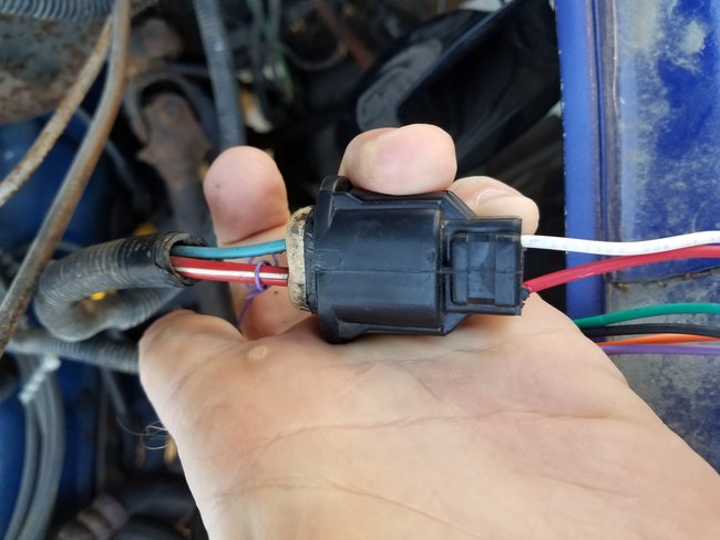

Ok.
Pic1. That appears to be spliced into the harness. Test plugs?
2. Thats where the orange from the module goes into the firewall and the orange and purple come out and go to the distributor
3. Distributor connector
4 and 5 module connectors
Apr 23, 2017 at 12:36 AM
RICKB8479
  • 21 POSTS
You'll notice the jeeps harness only has three wires on the connector to the module. No purple. Shown on my hand drawn diagram

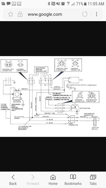

  • 21 POSTS
This is the wiring diagram for my jeep ignition. What is an mcu

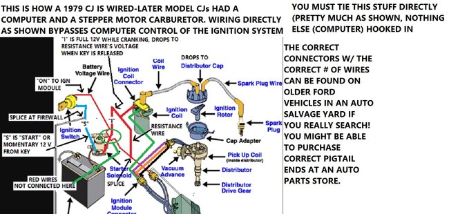

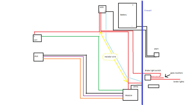

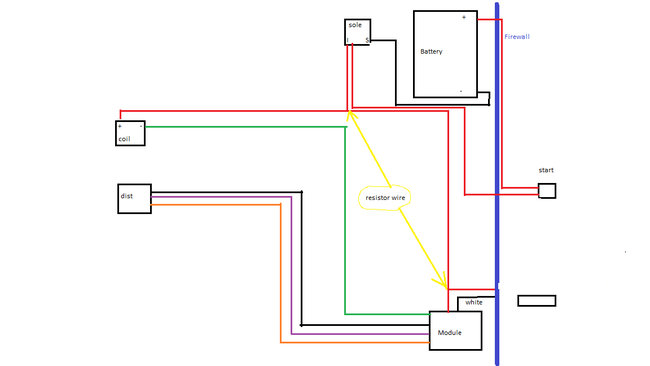

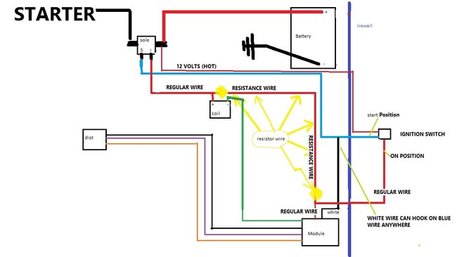

I found the pic (full pic) I left it in "MS Paint" (see pics)
Page 2 showed with your pics!
Looks as though your Baby is a '84 with a '79 engine (knew this).
It (the engine) needs to be wired like a '79 to eliminate the new crap (computer)
WE ARE NOT GONNA JUST WHACK ALL THE WIRES OFF OF IT AND SLING IT IN THE WOODS!
We need to pretty much make it look like the diagram below, Actually my 2nd diagram below (same thing as 1st)
We will eliminate the module wires going in and out of the firewall (cut and cap off/ tape off these wires)
2nd diagram- see the Blue Wire? Follow it to (My/ 6 cyl) firewall. See that the white module wire connects to it at the firewall?
Now "hands on" your Blue Wire on the Jeep at the solenoid, Follow it to the firewall (this eventually runs to the IGN switch to "START"). The WHITE WIRE to the Module will hook onto it, anywhere! before it goes into the firewall. Pick a good out of the way anti-rats nest place to tie it in!
Your MODULE has 4 wires coming out? and 2 IN?
Send me a pic of the Module including the ends same with the distributor (end included)

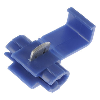

I will use those pics to show you how to make nice splices and no crappy connections in order to keep all of this wiring in the engine compartment! (not going to the computer!)
We will get the missing wires back in place to match the '79 diagram.

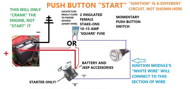

Ever use 3rd pic connectors?
Your Turn

So i wred it up like you said it started right up. Thanks.
Now a new problem. After i shut it off and cleaned up all the wiring under the hood went to start it now it wont crank. Ill send a diagram of what i have tomorrow. Thanks again.

I guess at this point maybe you can just tell me how to rewire the start cicuit. What do you think? Thanks for all the assistance with the ignition. Real bummer that I have it running but now it won't crank.
Apr 24, 2017 at 1:07 AM
RICKB8479
  • 21 POSTS
the first pic is what I have now. the second pic is what I propose for a fix. Will it work?
What does the light blue actually do?
Apr 24, 2017 at 7:32 AM
CJ MEDEVAC
  • 11,004 POSTS
More like this!
See how I modified your pic below
The big thing is, the 4 wires from the IGN Module, go to their respective spots, and no where else along the way.
If you have to splice the Purple wire into place, do it! (Reason I asked if you had ever used the 'Piggy-Back' Splices in previous answer)
Cut loose anything that is not supposed to be there!
Blue comes from switch, when turned to 'start' it activates the solenoid allowing the pos battery cable to flow thru to the starter. When the key is released, the blue wire goes dead and the solenoid quits allowing the starter to turn (in hopes that the engine has started)
At the same time "I" gets full battery voltage, it overrides the low voltage resistance wire (only during cranking) This aids in 'start-up', as the starter is robbing the power at this time.
The Medic

Trying your pic again?
The Medic
Apr 24, 2017 at 11:39 AM
CJ MEDEVAC
  • 11,004 POSTS
OK,
Here's a diagram I made for a momentary contact push button switch.
I also added on where your Ignition Module "white wire" should connect.
