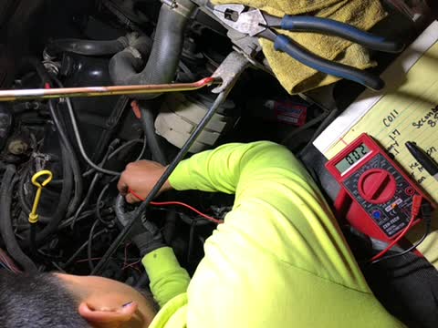

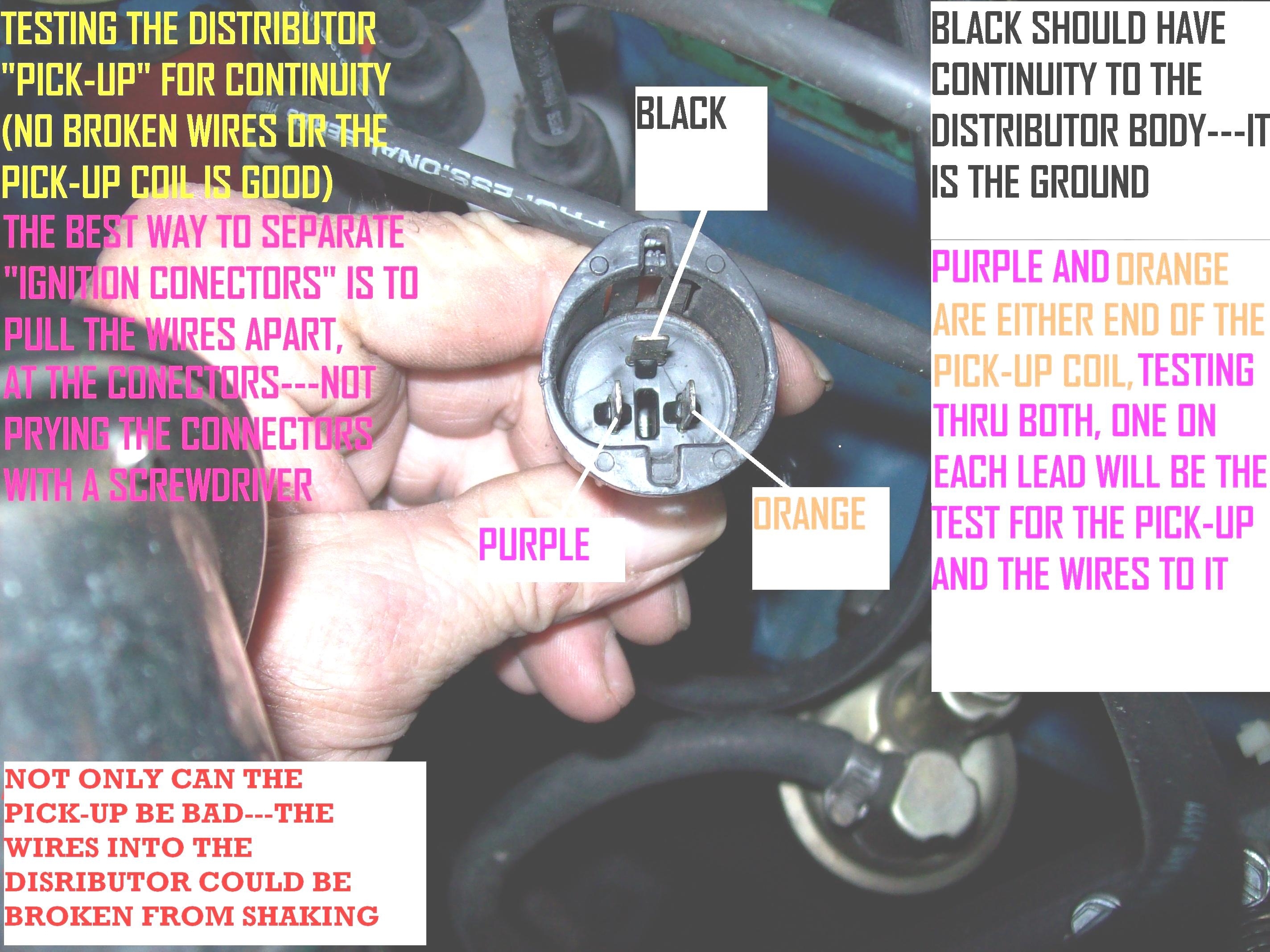

I tested this plug ground is good, but got nothing from the black and orange and also noting on the black and purple.

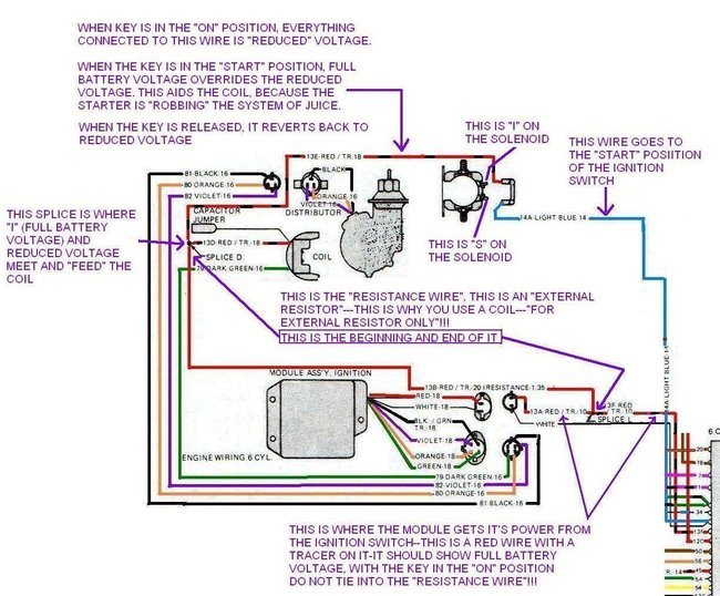

Let's turn the key to "on" voltmeter set to 20 volts DC (or whatever your scale shows above 12 volts).
Black voltmeter negative lead onto the battery negative clamp/ post.
Red lead stuck into the coil connector positive side (where red wires go in).
Do you have voltage? What did you get?

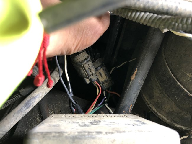

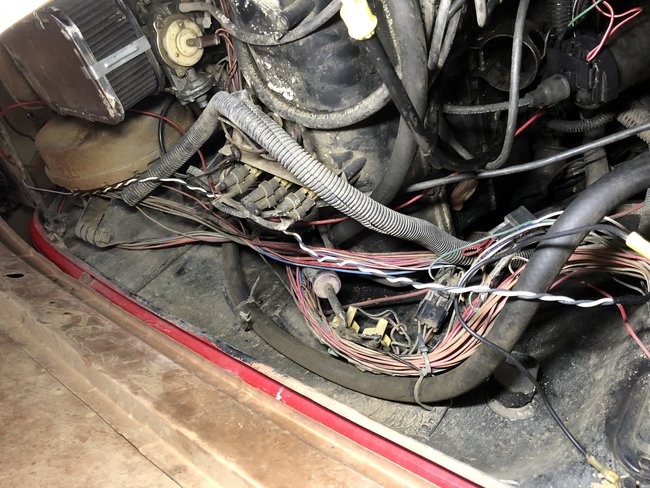

Send picture of ignition module, that I can see all of the wires connected to it.
Send picture top of the rear of the valve cover.
Jeep picture would be nice too, everyone could see what we are working on.

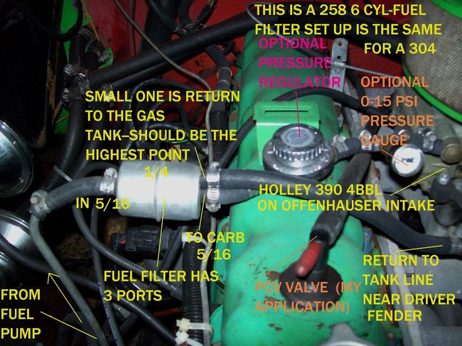

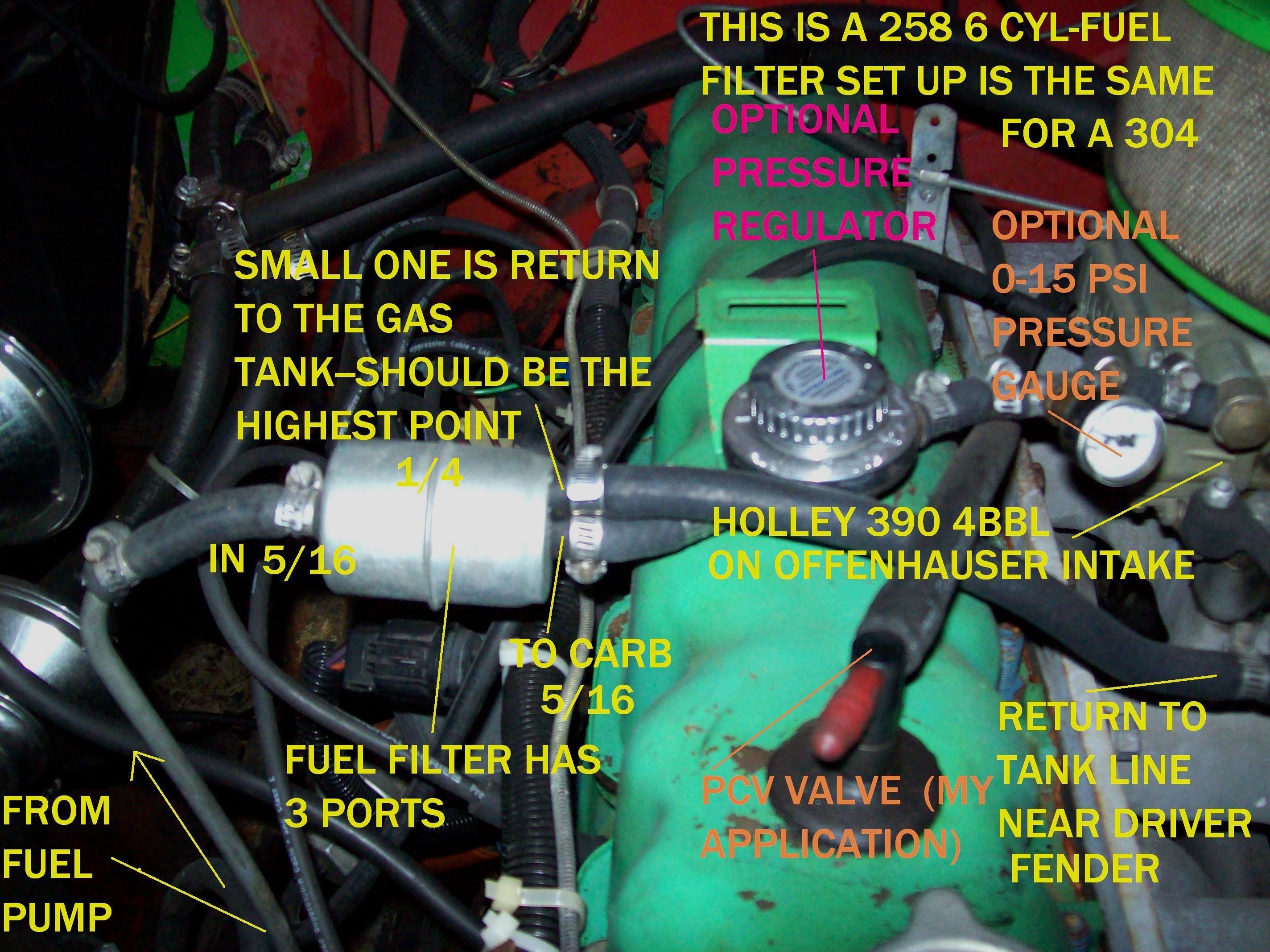

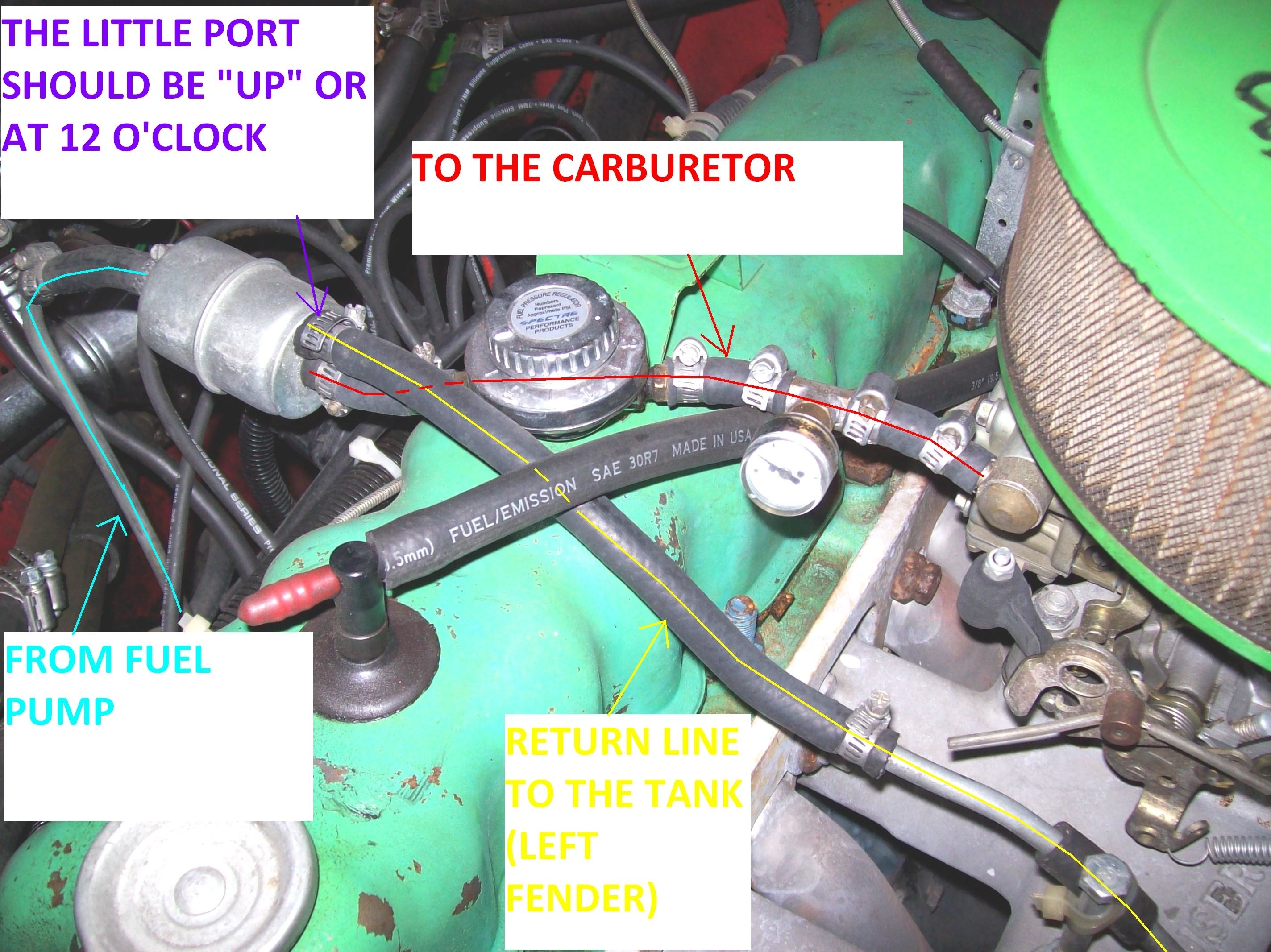

Are your fuel lines/fuel filter set up like this (disregard my regulator, pressure gauge)? See pictures below.

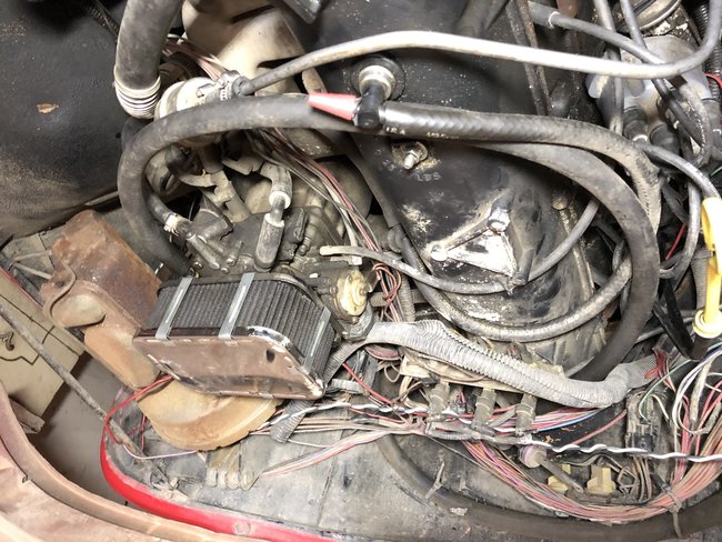

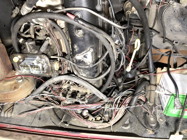

MANDOCJ7
  • 36 POSTS
Just pike up. I already try the by pass you were taking about with the fuse and wired going to positive side of battery and the other piece of wire to the coil were the resisters wire goes and nothing.
Tuesday, March 20th, 2018 AT 7:00 PM

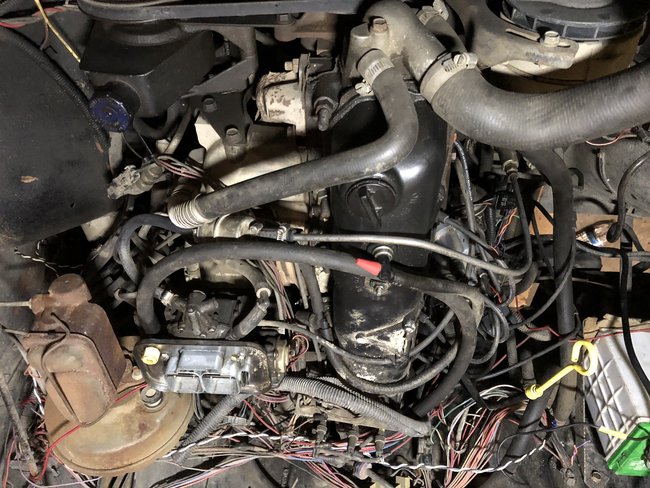

MANDOCJ7
  • 36 POSTS
Here he is lol.
Tuesday, March 20th, 2018 AT 7:06 PM
MANDOCJ7
  • 36 POSTS
Is this better?
Tuesday, March 20th, 2018 AT 7:15 PM

Wow!
He is a real Beefcake!
You have a real head turner, better take care of him.

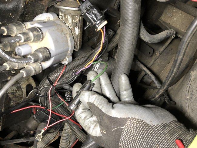

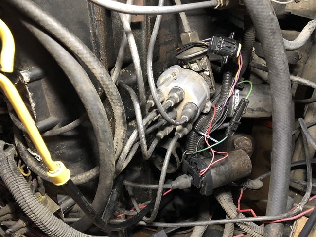

Have you messed with/moved/taken out the distributor since he ran last time?

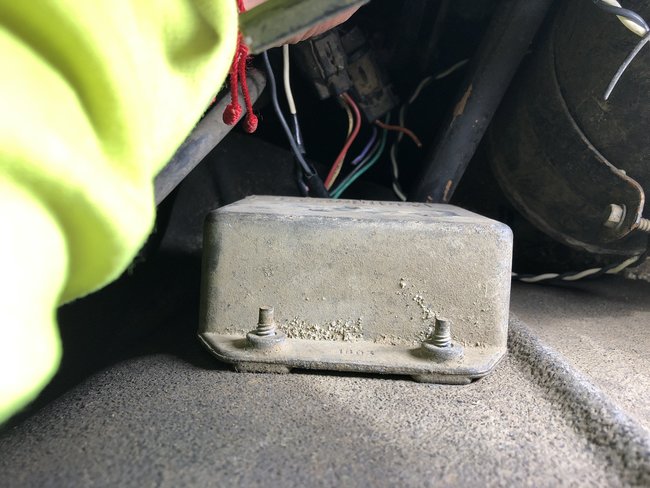

Is your ignition module bolted down (grounded well)?
Just got last pictures.

CJ MEDEVAC
  • 11,005 POSTS
Picture of ignition module and the wires to it? (Thanks)

12.27 volt on coil side.

CJ MEDEVAC
  • 11,005 POSTS

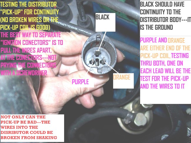

Go back to this.

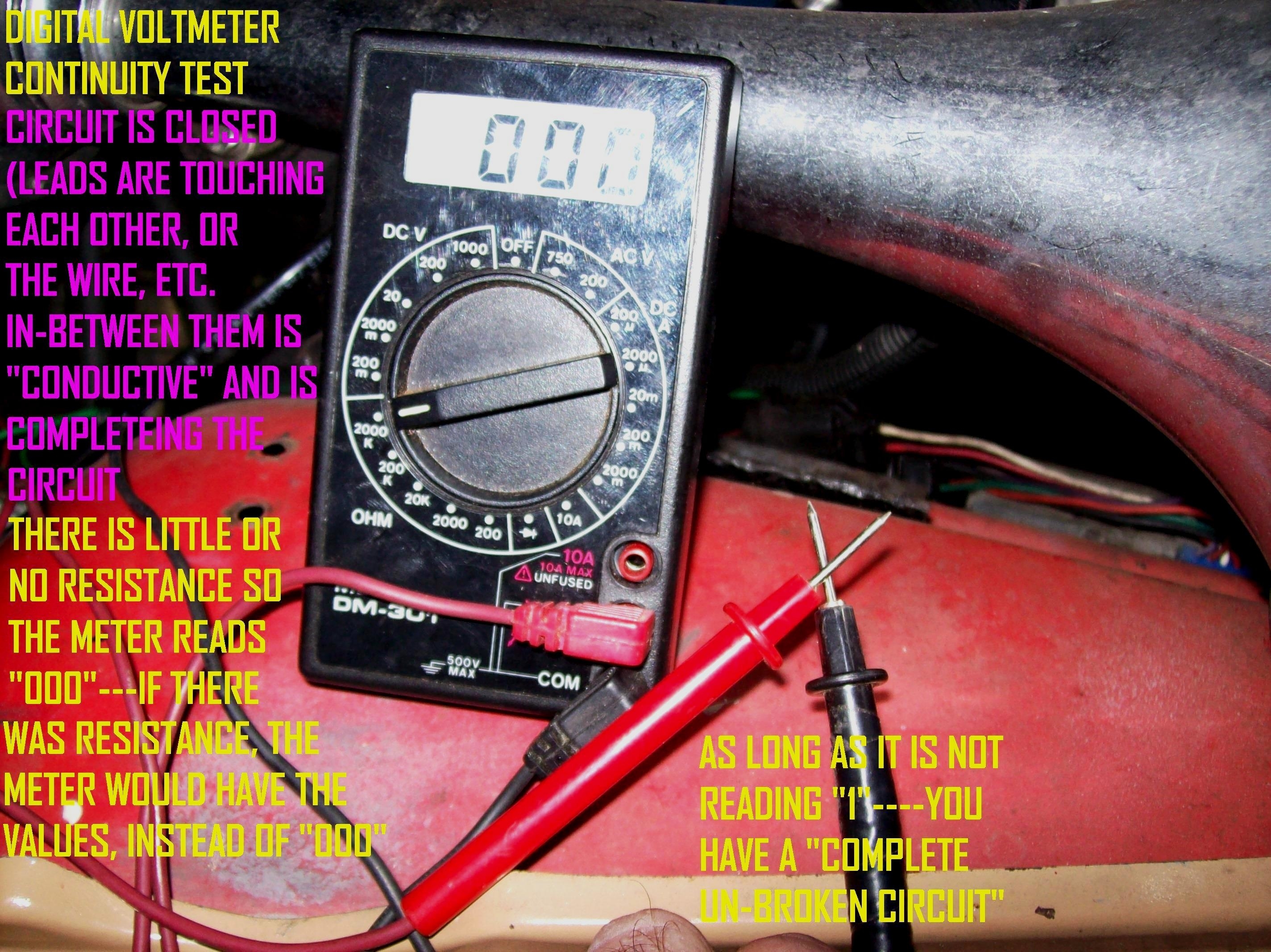

Set voltmeter to "OHMS" touch leads together, you should have continuity.
Distributor side of the connector:
Now touch purple with one lead and orange with the other.
Do we have continuity?

Should this wire have twelve volts as well?
Tuesday, March 20th, 2018 AT 7:58 PM
MANDOCJ7
  • 36 POSTS
On ground it does but the orange and purple bounce back and forth.
Tuesday, March 20th, 2018 AT 8:12 PM

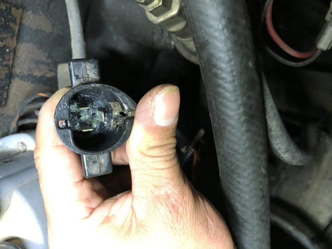

CJ MEDEVAC
  • 11,005 POSTS
Disconnected-no volts on the distributor side of the connector.
Purple and orange are connected inside the distributor (pick-up coil), if there is no continuity, the pick-up coil is probably shot. The "Halls Effect" cannot happen to tell the module when to fire. Replace pickup!
I want to make sure of parts being bad before you rush out and buy parts.
Really stupid question!
(Has happened before!)

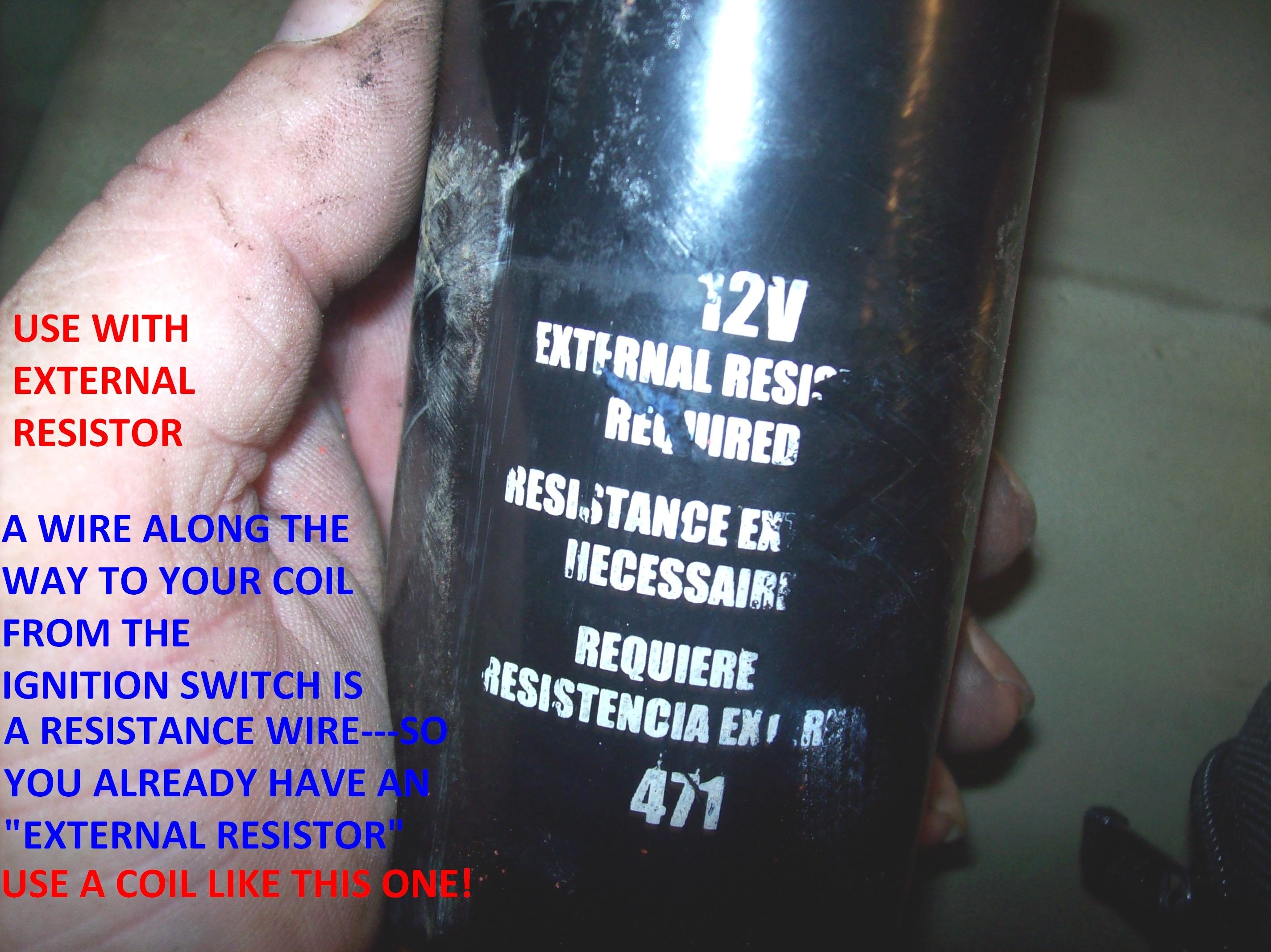

Your rotor button is inside the distributor?
Correct coil?

It was the one it came with it when I bought the car.
