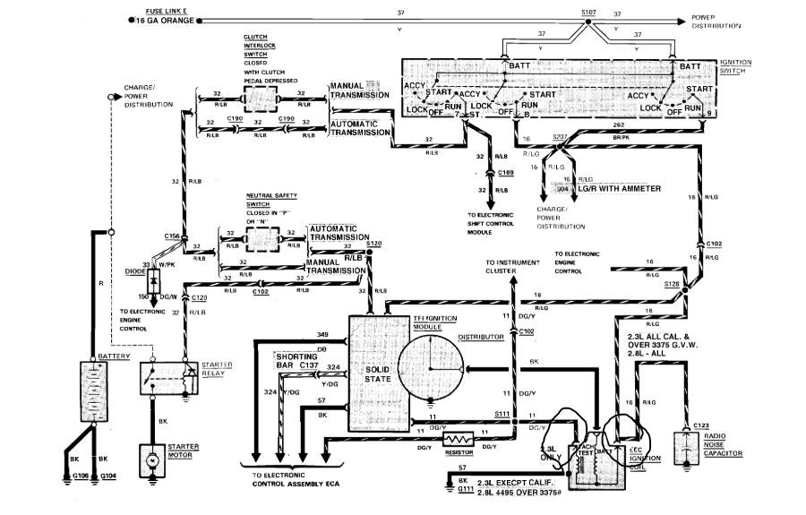

Truck cranks just fine, but won't start. Has a new starter in it. There is no spark at the plugs when cranking. If I push it, it starts right up. Drives fine and shifts fine.
Wednesday, July 29th, 2020 AT 11:49 AM (Merged)
Hi

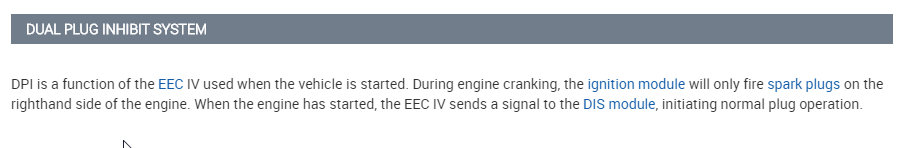

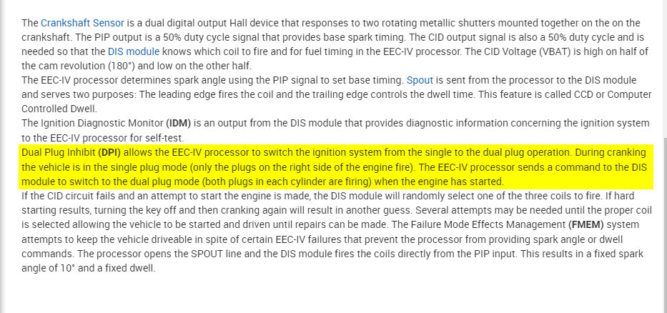

Your truck has what is called a dual plug inhibit system. What this means is during cranking the ignition module will only fire one set of plugs. Then when it is running it will fire both plugs as normal. The plugs on the right side of the engine are the ones that are to fire during starting so just make sure that you checked those plugs to ensure you truly don't have spark during cranking.
If you don't, I suspect you have an issue with the EEC IV system. Just check the plugs on the right side of the engine and let me know if you don't have spark and we can go further if needed. Otherwise we can go a different direction. Thanks

I am not getting juice to the coil so i'm not getting spark! What sould the reasons be? I turned the key on and tried a test light to the wires to the coil I checked all the fuses please give me help or ideas to check thank you

You have to check for a constant +12v at the connector with key on.
On the negative side with engine cranking you hsould be getting a -12v.
You can put a test light in those spots and crank the engine. It should flash. If not one of the two are missing.

Did you check for power to the positive side of the coil? You need battery voltage there. If you do, use a test light on the negative side and make sure you have power.
Crank the engine and see if the light flashes while cranking.

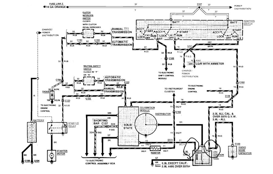

Check ballast resistor. Make sure coil is receiving power. Using a test light, verify the coil is receiving the interrupt signal. Hook clip to ground and probe the negative coil terminal. Make sure distributor stator is properly installed and gapped. And not loose.

There is a fusible link running probably off the starter relay it is a yellow wire leading to fp relay the fusible link is blue and are available at auto parts. Make sure to put correct one in.
