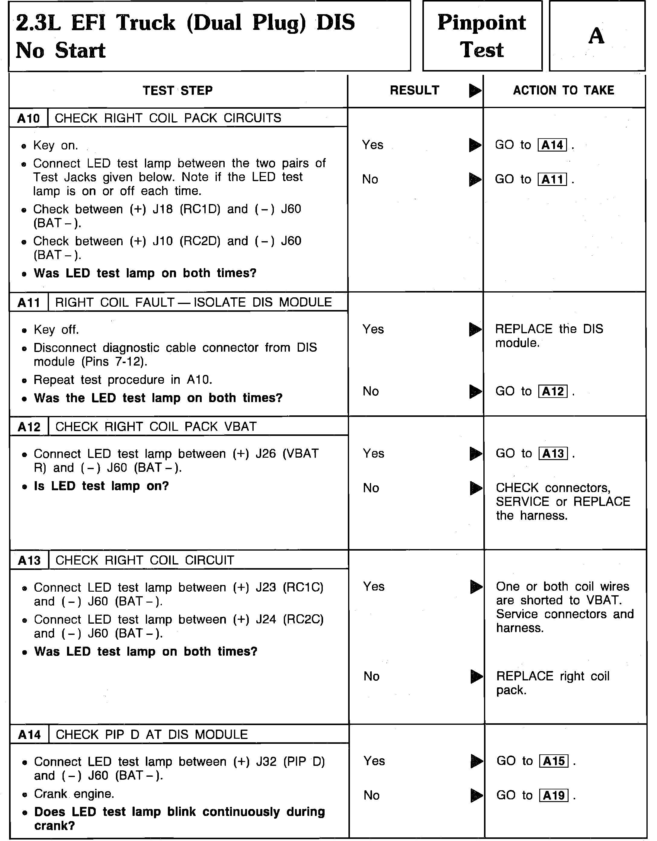

I changed the coil pack and still no spark.
Sep 3, 2019 at 10:37 AM
BMDOUBLE
  • 1,139 POSTS

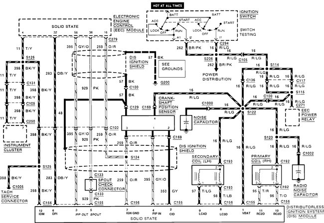

I've attached the wire diagram along with a few pinpoint tests to get started. I have replaced quite a few of the distributor-less ignition modules on these though, but a few quick tests usually can pinpoint this. Just make sure you have voltage with the key on at the red/light green wire at the coils and the module, also make sure that all of the screws are installed and tight on the distributor-less ignition module because the module grounds itself through these screws.
This guide can help test it

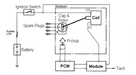

  • 75,988 POSTS
If the engine has no spark, check for voltage at the coil positive terminal when the ignition key is on. If there is voltage, the problem is on the trigger side of the coil (pickup, crank sensor, ignition module or primary wiring circuit). If there is NO voltage at the coil, the problem is on the supply side (the ignition switch or ignition wiring circuit). If the coil has voltage, the problem may be a bad high voltage output wire from the coil to the distributor, hairline cracks in the coil output tower, or cracks or carbon tracks inside the distributor cap or on the rotor. Measure the resistance of the CPS
https://images.2carpros.com/forum/automotive_pictures/12900_ignition_system_1.jpg
Jul 29, 2020 at 4:49 AM (Merged)
SHAWNSKI007
I haven't found the problem yet. the only thing new i found is when i put a code reader on the engine it gave me a code 95. the chilton manual says its a code for only a car. but the book that came with the code reader says its a secondary fuel fault. however i have excellent fuel pressure at the injectors. I guess i need to investigate this code 95 more and see if it isn't shutting off the ignition as a safety precaution
thanks for your picture. it was very clear and to the point.

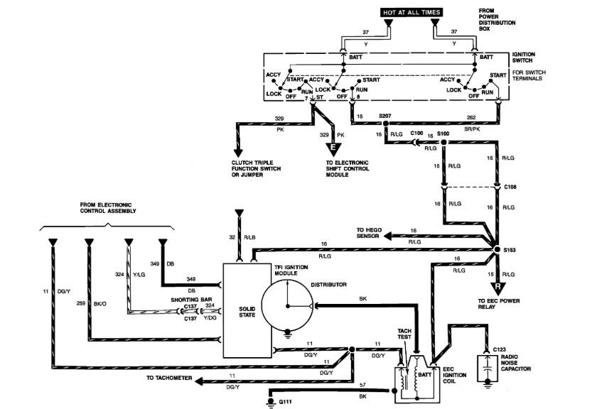

Electrical problem
1989 Ford Ranger 6 cyl Two Wheel Drive Automatic
hello my ranger will crank really strong but the is no spark. I have replaced the coil, ignition control mod, cap & rotter, plugs wires and still nothing. Can you please help I am out of money and need my truck to work. thanks in advance

Found low voltage at terminal four ignition module requires battery voltage.

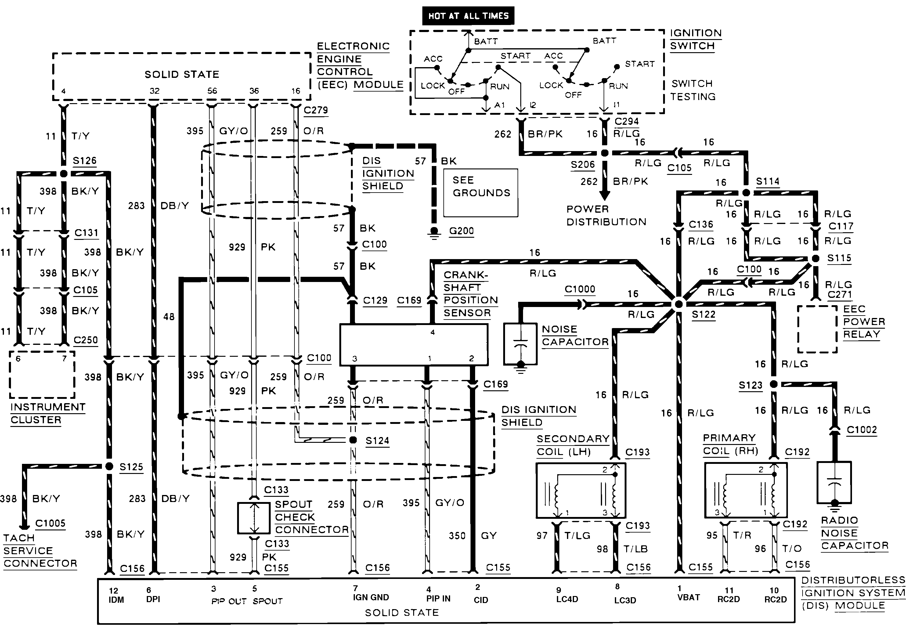

Good afternoon.
Yes, it needs battery voltage. It comes from the ignition switch.
Is there battery voltage at the positive side of the ignition coil?
CRHS56
  • 6 POSTS
Yes, battery voltage positive side coil.
Then you have a harness issue. The same wire that powers the coil powers the module. Look at the diagram and you will see the red/green wire is the feed.
CRHS56
  • 6 POSTS
Have battery voltage at coil up to resistor after have 9 volts. Cannot find wire at PCM does it change color somewhere?
If you looked at the diagram, it comes from the ignition switch, not the PCM. the module needs battery voltage to work.
Check the harness. You have a wiring harness issue.
CRHS56
  • 6 POSTS
Was chasing green/yellow wire not red/yellow. Have battery voltage up to firewall no red/yellow wire at PCM.
