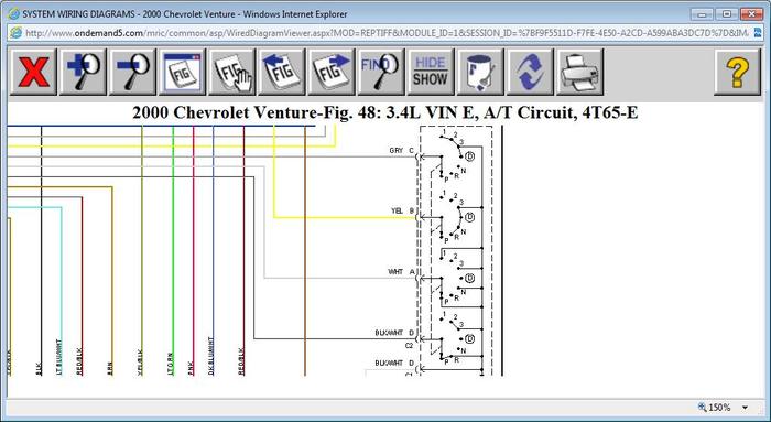

I did typo, pink has voltage at nss, does the or/blk wire go from nss to crank relay, if so it does not have voltage
Monday, January 25th, 2021 AT 9:46 AM (Merged)
SATURNTECH9
  • 30,869 POSTS
Yes the orange wire with a black stripe goes to the crqnk relay. In the park and neutral position the pink wire is connected to the orange with a black stripe thru the nss. Sounds like thats not happening. Try it in neutral just make sure the parking brake is set and works. Also chock the wheels to stop rolling.

I believe I found the problem, the wires coming from the nss were
broken ten inches from nss---problem is 2 light green wires and 2 black wires with white tracers are in the package, how do I determine what gr to gr or blk to blk, thanks
SATURNTECH9
  • 30,869 POSTS
For the start circuit the pink wire is in terminal g at the nss connector and the orange wire with the black stripe goes to terminal E at the nss connector. Is there other wires broken at the nss connector?
SATURNTECH9
  • 30,869 POSTS
There is a wire diagram for the nss connector showing what colors go to which terminals.

RICKEF
  • 12 POSTS
The needed splice is away from the connector, on the 7 wire connector to nss there are 2 lt/green wires (c&F on plug), how do I make sure I make the right connection to each other, ---also there is a blk/wht on 7 wire connector (D) and a blk/wht on a 4 wire connector-- in both cases im just guesing what wires I would splice together.
+1
SATURNTECH9
  • 30,869 POSTS
So are you just confused on which black and white wire goes where on the nss?Where does the 4 pin connector go and which wires are you trying to figure out there?I belive the wire diagram I posted shows all the nss wires.
RICKEF
  • 12 POSTS
Sorry the diagram is fuzzy and not sure what im looking at. I know where the connectors go. Its just that I have 2 blk/wht wires from a group of maybe 40 wires (blk/wtwires were cut mid point between 40 wire group & nss), what blk/wt wire goes to the 4 pin conn on nss--- what blk/wire goes to 7 pin conn on nss---one wire going back to the main 40 wiring harness looks like its going to ground(1 ohm), does it go to 7 or 4 pin conn.---7 pin conn on nss has a blk wire with letter "D" on it
--the other blk/Wht wire going to main 40 harness has 3.7ohms on it
SATURNTECH9
  • 30,869 POSTS
The connector C1 terminal D that black wire with a white stripe goes to a ground left side of engine. So once you narrow that down the other black wire with a white stripe goes to connector C2 and that wire goes back to the pcm computer.
