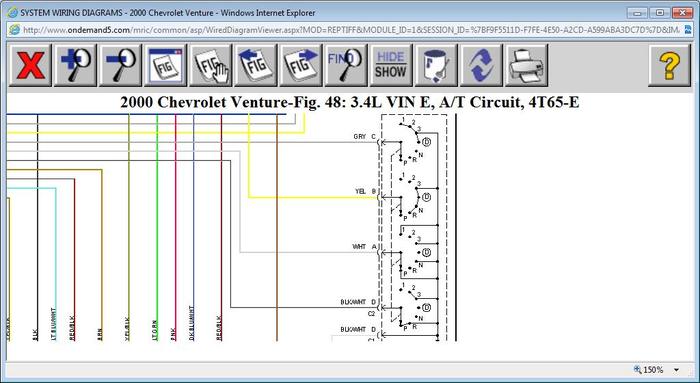

hi, i have a 2000 chevy venture that wont turn over, shorted the red- ppl wires in crank relay & starter turns over,relay, did not solve problem. no obd errors- checked fuses all ok, did the 10 min drill 3 times, any suggestions, thanks

i believe i found the problem, the wires coming from the nss were
broken ten inches from nss---problem is 2 light green wires and 2 black wires with white tracers are in the package, how do i determine what gr to gr or blk to blk, thanks
Jan 25, 2021 at 1:46 AM (Merged)
SATURNTECH9
  • 30,869 POSTS
For the start circuit the pink wire is in terminal g at the nss connector and the orange wire with the black stripe goes to terminal E at the nss connector.Is there other wires broken at the nss connector?
SATURNTECH9
  • 30,869 POSTS
There is a wire diagram for the nss connector showing what colors go to which terminals.
RICKEF
  • 12 POSTS
the needed splice is away from the connector, on the 7 wire connector to nss there are 2 lt/green wires (c&F on plug), how do i make sure i make the right connection to each other,---also there is a blk/wht on 7 wire connector (D) and a blk/wht on a 4 wire connector-- in both cases im just guesing what wires i would splice together,
SATURNTECH9
  • 30,869 POSTS
So are you just confused on which black and white wire goes where on the nss?Where does the 4 pin connector go and which wires are you trying to figure out there?I belive the wire diagram i posted shows all the nss wires.
RICKEF
  • 12 POSTS
sorry the diagram is fuzzy and not sure what im looking at. i know where the connectors go. its just that i have 2 blk/wht wires from a group of maybe 40 wires (blk/wtwires were cut mid point between 40 wire group & nss), what blk/wt wire goes to the 4 pin conn on nss--- what blk/wire goes to 7 pin conn on nss---one wire going back to the main 40 wiring harness looks like its going to ground(1 ohm), does it go to 7 or 4 pin conn.---7 pin conn on nss has a blk wire with letter "D" on it
--the other blk/Wht wire going to main 40 harness has 3.7ohms on it
SATURNTECH9
  • 30,869 POSTS
The connector C1 terminal D that black wire with a white stripe goes to a ground left side of engine.So once you narrow that down the other black wire with a white stripe goes to connector C2 and that wire goes back to the pcm computer.
