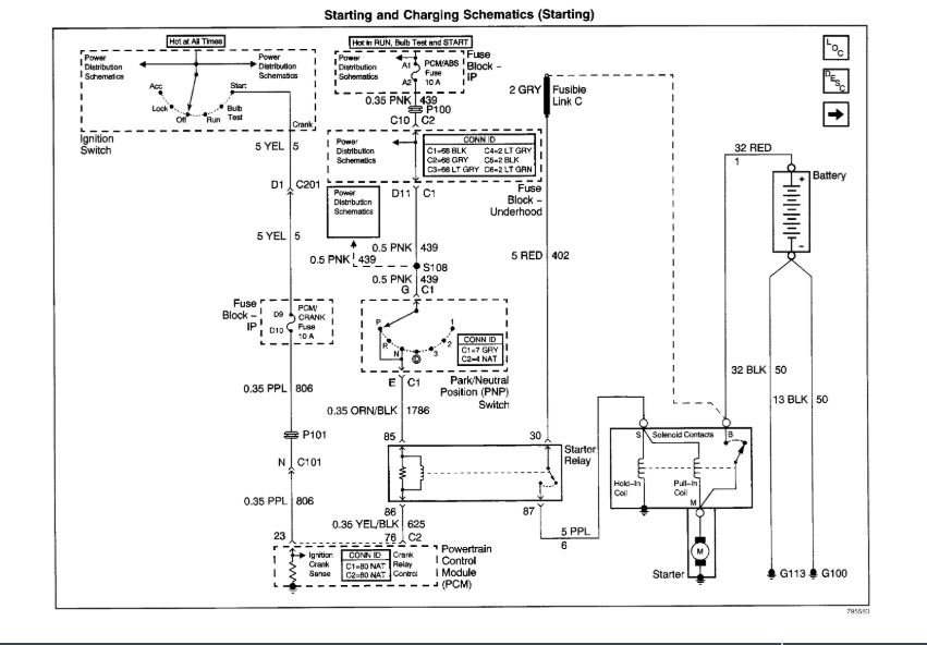

All dash lights and headlights come on no start at all. had new ignition switch installed last summer at time it was done mechanic disarmed it. didn't hear it come on drove car up until now and last night up until today it won't start. Any suggestions on what shall I do? I live too far from town need vehicle badly.
Jan 25, 2021 at 1:43 AM (Merged)
Good evening,
I will attach a wire diagram for you to view.
You need to do some voltage checks to see why it will not start.
The fuse block is under the hood by the battery and you need to check all those fuses.

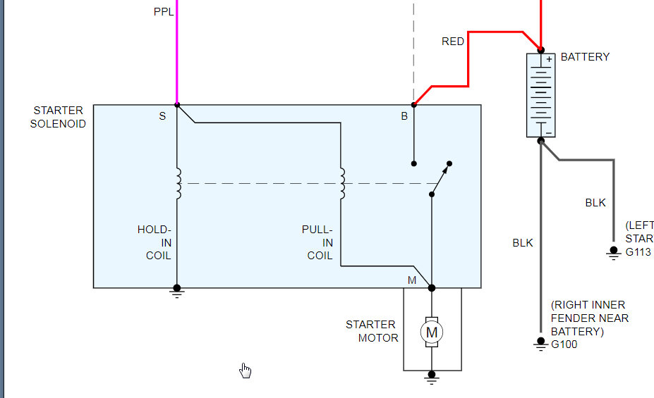

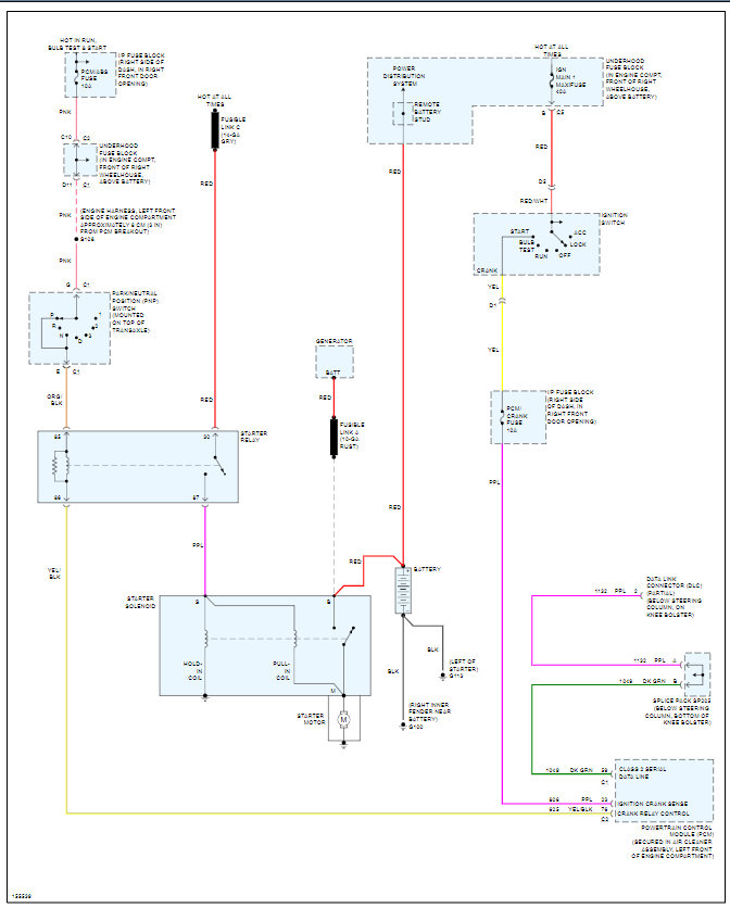

DAVESPRINGS
when you turn switch to on position lights work...radio works...clicks when u turn key but wont start...u can bump from starter silenoid and it will start...put differnt starter on but that didnt fix the problem...put new ignition switch in but that didnt fix either. any ideas would be appreciated. it wont start even in neautral...so its not the nutreal safety switch. had ignition coil tested...said it was fine.
Feb 1, 2021 at 2:15 AM (Merged)
If this is clicking and not starting then that is either the starter, battery, or the connections of either one. Basically you are loosing voltage and do not have enough to turn it over.
So we need to test the battery using this guide.
Here is guide that will give more info on this issue.
The last thing we need to do is check the voltage at the starter and find out what the voltage is at the starter. I attached below the complete diagram and a close view of the starter. Let us know what you find with this and we can go from there.
