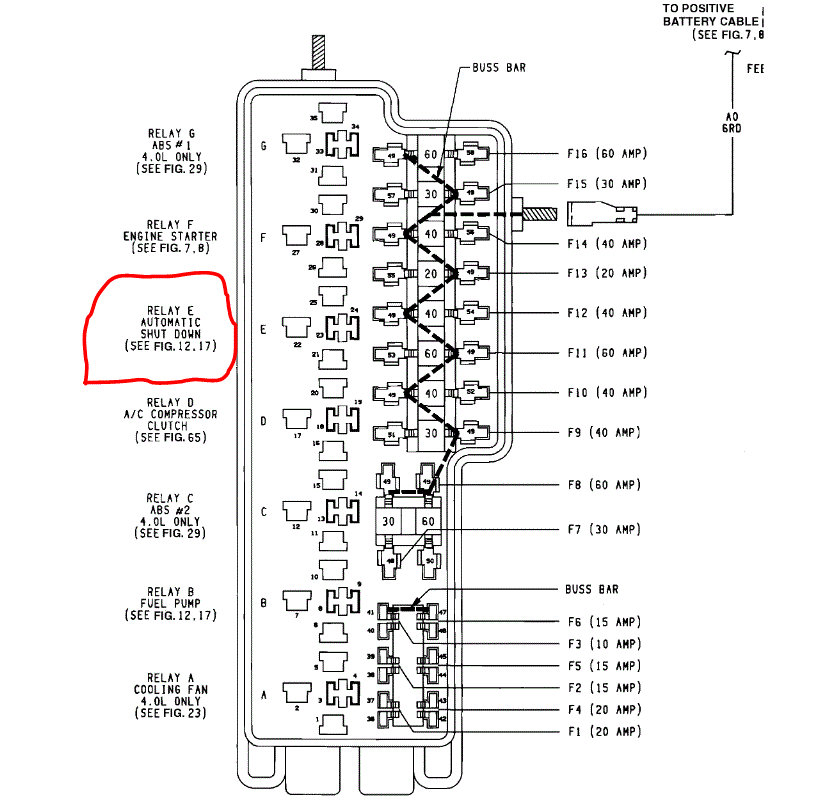

Before I suggest what I think may be the issue, first confirm the rotor is turning in the distributor when cranking the engine.
If that is good, then we need to confirm the ASD relay is also good. The relay is mounted in the power distribution center. This relay supplies battery voltage to fuel pump relay, fuel injectors, ignition coil, and O2 sensor heating element when energized by Powertrain Control Module (PCM). Basically, when the key is in the start or run position, the PCM provides a ground to the relay but the PCM has to receive a signal from the distributor to work. If there is no ignition reference to the PCM, the ground is removed and fuel pump and components are shut down.
Now, regardless of replacement of the crank sensor, the fuel pump should be powered for a couple seconds when the key is first turned on, so if it isn't, that leads me to this relay.

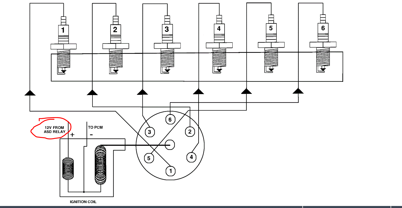

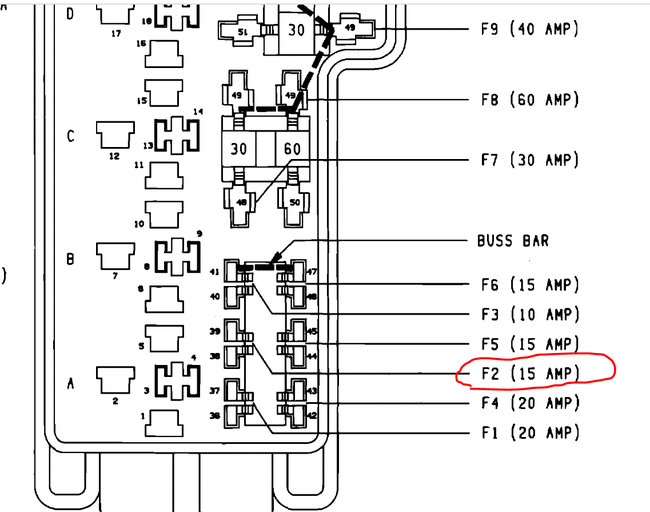

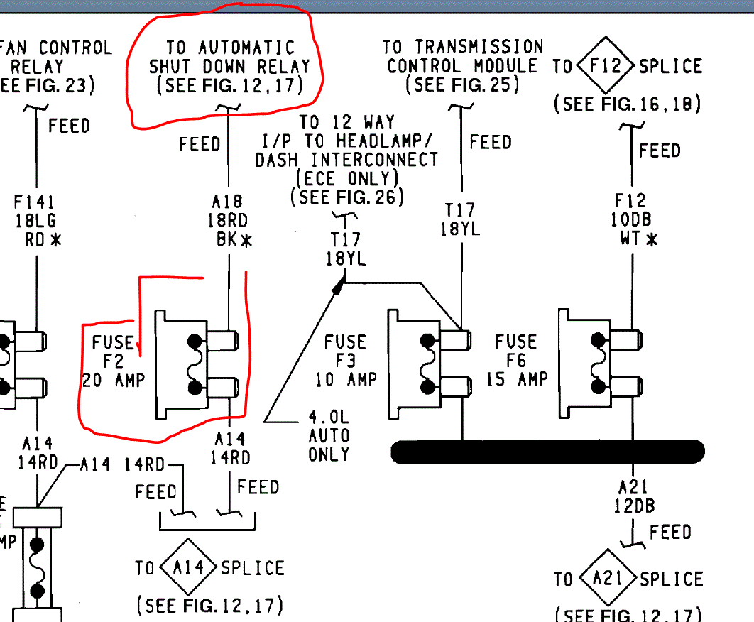

Okay, I attached three pics. The first shows the ASD relay location, the second is from the schematic showing a fuse for the ASD, and the third shows the ASD fues. Interestingly, the schematic says it's a 20 amp and the location (pic 3) shows it as a 15 amp. Stay with what is there if it is bad.

Did it start working after you replaced the ASD? If it did, recheck to see if there is corrosion, a damaged pin (pushed in), pull the ASD out and put it back in and see if it changes.

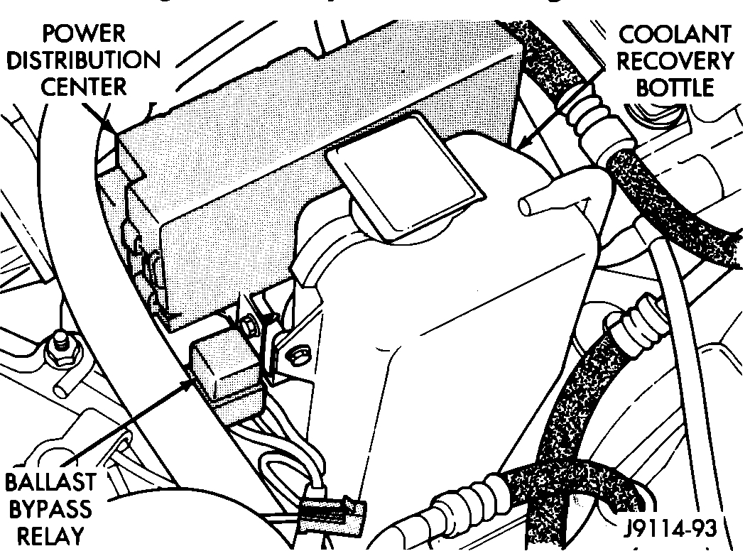

Also, there is an ignition ballast resistor relay. Check it as well. It is located under the hood on the outside of the power distribution box. See pic 1 You can use the aforementioned link to test a relay for this one as well.

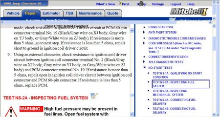

The PCM controls ignition timing and coil dwell by controlling the ground path to the ignition coil. So the idea that you have power to the coil on one wire is normal. See pic 2 For power to flow, the PCM needs to provide ground.
Have you checked for diagnostic trouble codes? I have a feeling that if the ballast relay is good it may be related to the crankshaft position sensor. Follow this link and let me know if anything is stored. You can get codes without a scanner on this vehicle.

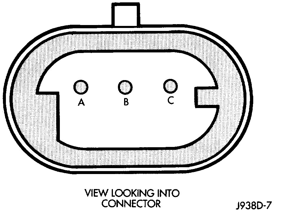

Here are the directions for testing your crankshaft position sensor. Basically, you are making sure there is no resistance between terminals B and C. See pic 3
PROCEDURE
1. Near the rear of intake manifold, disconnect sensor pigtail harness connector from main wiring harness.
See pic 3
2. Place an ohmmeter across terminals B and C (Fig. 5). Ohmmeter should be set to 1K-to-lOK scale for this test. The meter reading should be open (no resistance). Replace sensor if a low resistance is indicated.

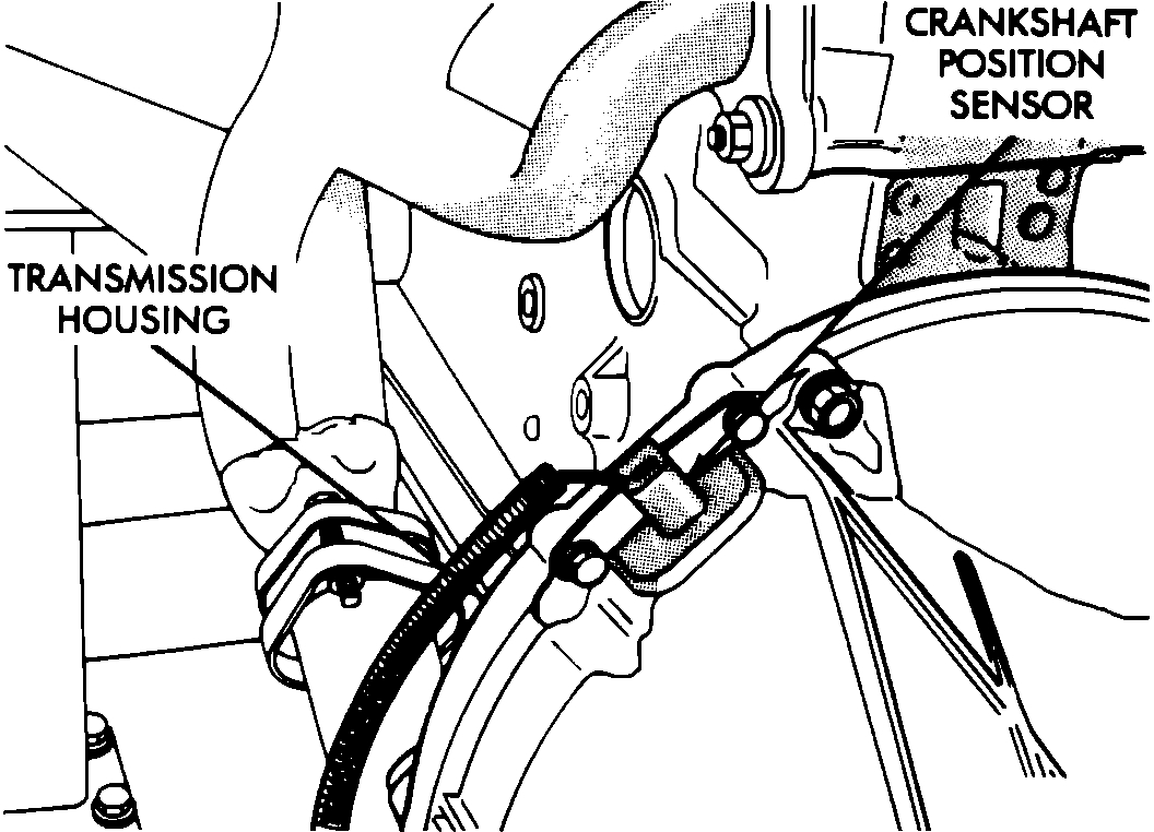

If you determine the sensor is bad, here are the directions specific to your vehicle for replacement.
I1993 Jeep Truck Cherokee 4WD L6-242 4.0L VIN S MFI
Procedures
Vehicle Powertrain Management Sensors and Switches - Powertrain Management Sensors and Switches - Computers and Control Systems Crankshaft Position Sensor Service and Repair Procedures
PROCEDURES
Crankshaft Position (CKP) Sensor 4.0L
See pic 4
REMOVAL
1. Disconnect negative battery cable.
2. Disconnect sensor electrical connector, located near rear of intake manifold
3. Remove nut holding sensor wiring clip to fuel rail.
4. Remove sensor mounting bolt(s) or nuts.
5. Remove the sensor from vehicle.
6. Remove clip from sensor wiring harness.
INSTALLATION
1. Position camshaft position sensor flush against the opening in transmission housing.
2. Install sensor mounting bolts or nuts and torque to 19 Nm (14 ft-lbs).
CAUTION: On some models, two bolts are used to secure sensor to transmission. These bolts are specially machined to correctly space the sensor to flywheel. Do not attempt to install any other bolts.
3. Connect the electrical connector to the sensor.
4. Install clip on sensor wire.
5. Install clip over fuel rail stud and tighten mounting nut.

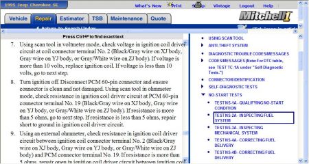

  • 75,988 POSTS

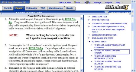

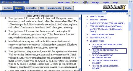

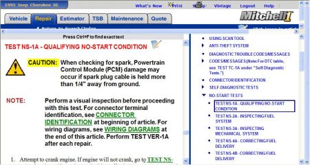

Perform the no start tests below
https://images.2carpros.com/forum/automotive_pictures/12900_ns1_2.jpg
https://images.2carpros.com/forum/automotive_pictures/12900_ns2_2.jpg
https://images.2carpros.com/forum/automotive_pictures/12900_ns3_2.jpg
https://images.2carpros.com/forum/automotive_pictures/12900_ns4_2.jpg
https://images.2carpros.com/forum/automotive_pictures/12900_ns5_2.jpg

ALLAN456321
It was the crankshaft positing sencer. Boy thanks a lot fir your help it really means a lot to me. It rubs great and lives agian. So thanks again. And have great new year!!!
