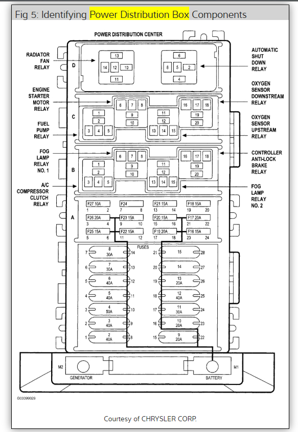

I have seen the ASD relay cause this here is a guide that can help with the relay location in the diagrams below.
Jul 23, 2010 at 2:19 PM

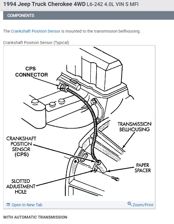

FREEMBA
  • 1,152 POSTS

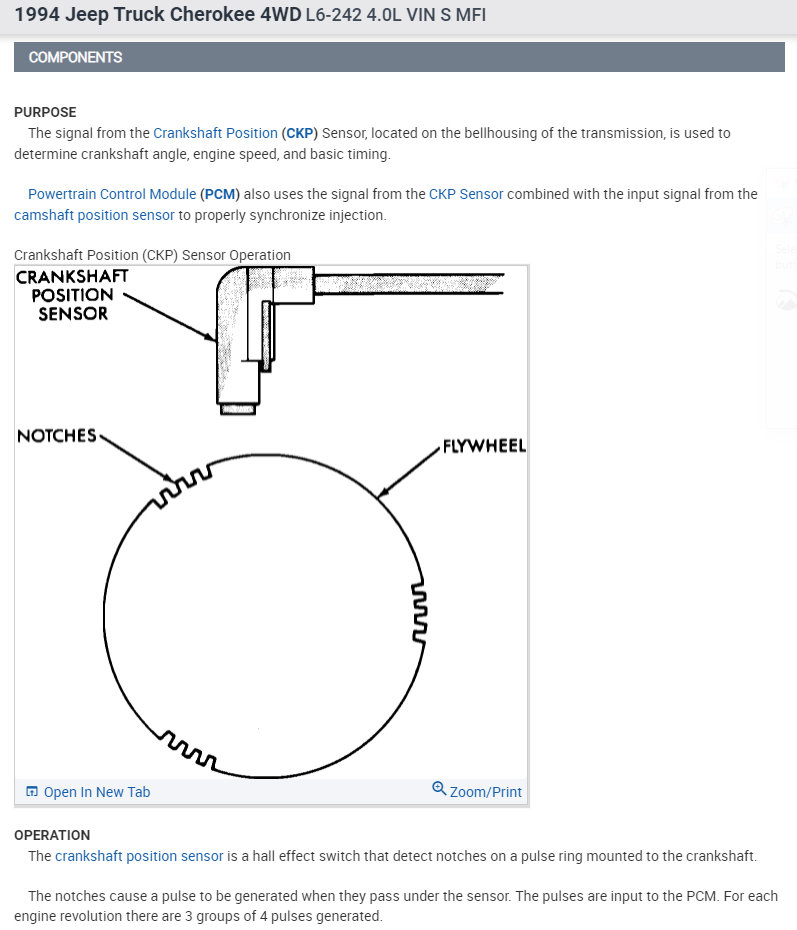

This is likely a faulty Crankshaft Position Sensor (CPS)

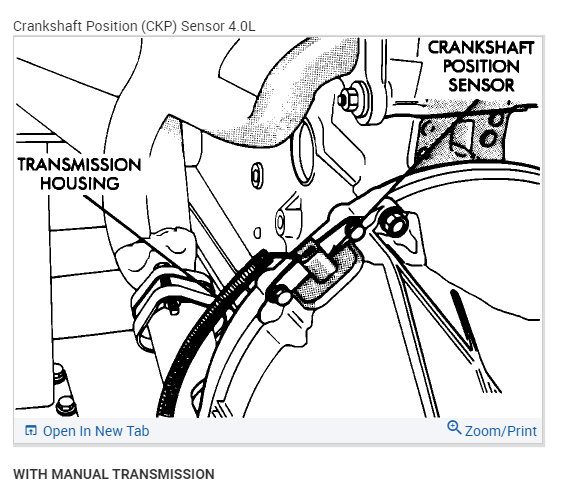

Test the Crankshaft Position Sensor. It is located on the transmission bell housing at about the 2 O’clock position [if you are standing in front of the vehicle. Follow its wire up to the top of the intake manifold [this is where its connector is].

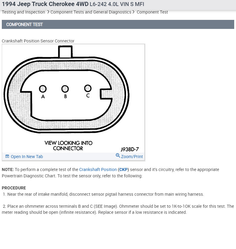

Disconnect the connector and use a digital ohmmeter to check the resistance at the “B” and “C” pins of the connector (the lead that goes to the sensor). It should show infinite resistance or “0”. Anything other than this reading means that the sensor is bad.
Another little “trick” to help narrow it down is to unplug the crankshaft position sensor for about 30 minutes, plug it back up and then try to start the engine. If it now starts, this means that the crankshaft position sensor is going bad and has an intermittent faulty. Replace it.

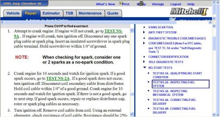

  • 75,992 POSTS
NS

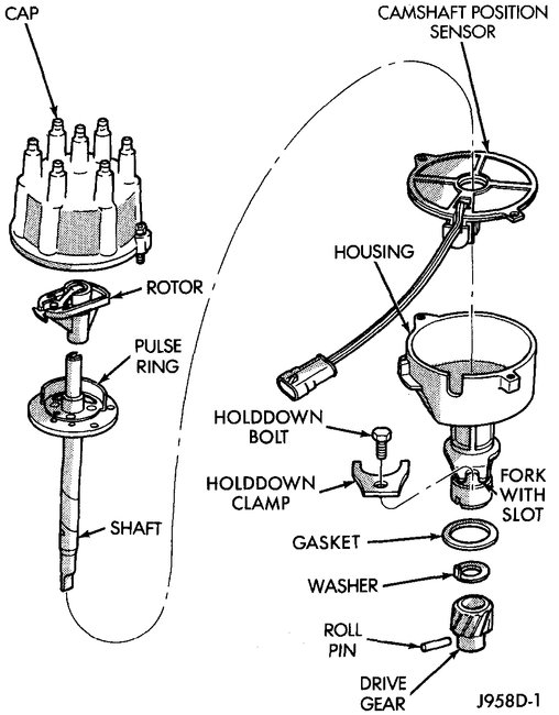

JOHN CANNING
So I have changed the CPS sensor on the bell housing, and I have changed the Ignition pick-up sensor. The engine did start the night I put it in. The next day it started right up went for a quick drive came home parked it, and then it would not start. So checked the pick-up sensor and it cracked and the metal came out. Went and got another one put it in and it started right up. Came out next day and took it for ride came home parked it and it won't start again checked sensor and it was not damaged this time. Help please
Dec 7, 2020 at 4:22 AM (Merged)
  • 110,244 POSTS
Welcome to 2CarPros.
When you say pick up sensor, are you referring to the camshaft sensor in the distributor? If so, check the shaft for excessive wear or play. It sounds like the it may be moving around enough to hit the sensor.
Take a look at picture 1. It shows an exploded view of the distributor. Let me know if the cam sensor is what you are referring to.

Welcome back. I will try the picture again. Since the first sensor was damaged, make sure there is not play in the shaft which could cause it to damage the sensor.
JOHN CANNING
Thank you, it was the distributor that had vertical play, and it was vibrating and damaging the p/u sensor.
  • 110,244 POSTS
Welcome back:
That will do it. I had a feeling it was something like that because of the damage done to the fist sensor you replaced. Is it running good now?
Let me know,

KAH420DOPEY
I have a 1994 Jeep Cherokee and had the same issue. After reviewing 10 or more forums I came to the conclusion of the Crank Shaft Position Sensor. I took it in to a shop to do the repair since it was a difficult part to replace.

SQM
  • 6,383 POSTS
I appreciate you sharing the solution to your issue.

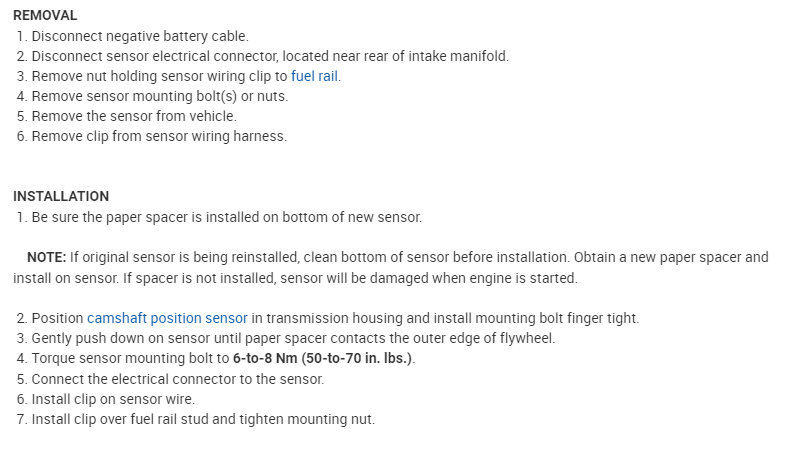

Here are a couple of helpful articles:
I have attached the diagrams for replacement procedure below for anyone else who might be looking for this information.
