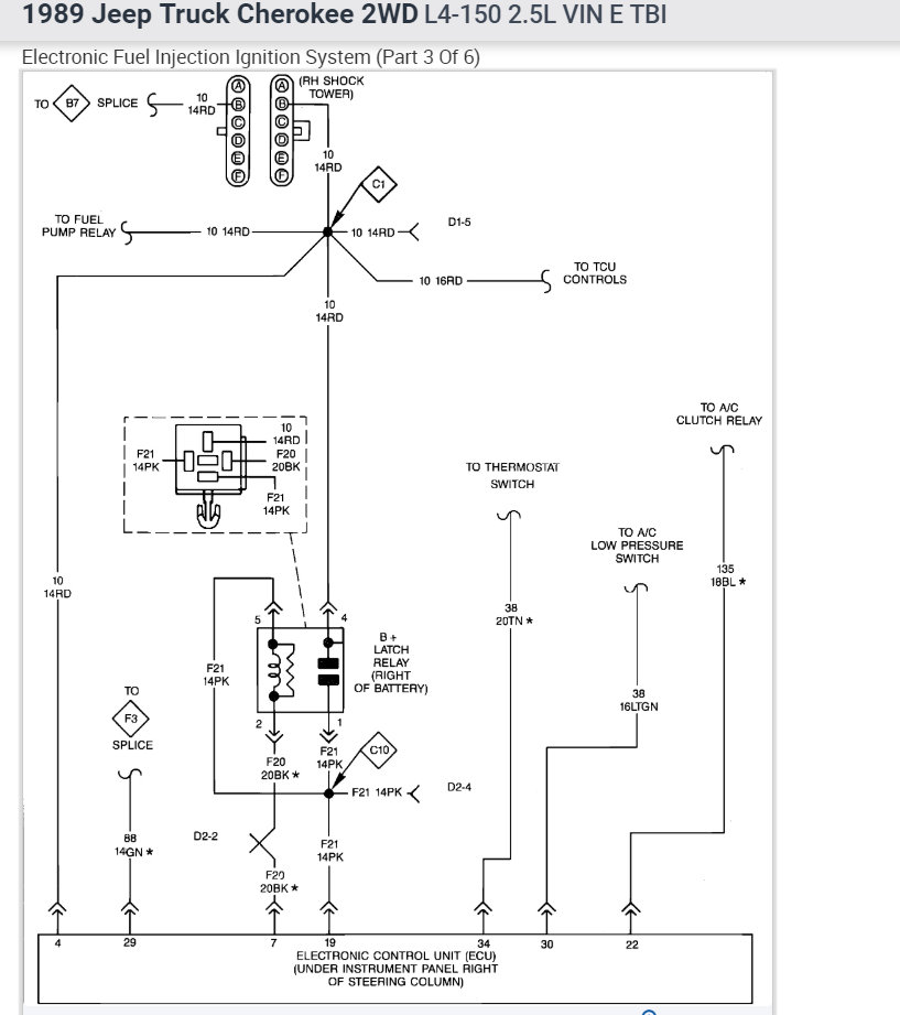

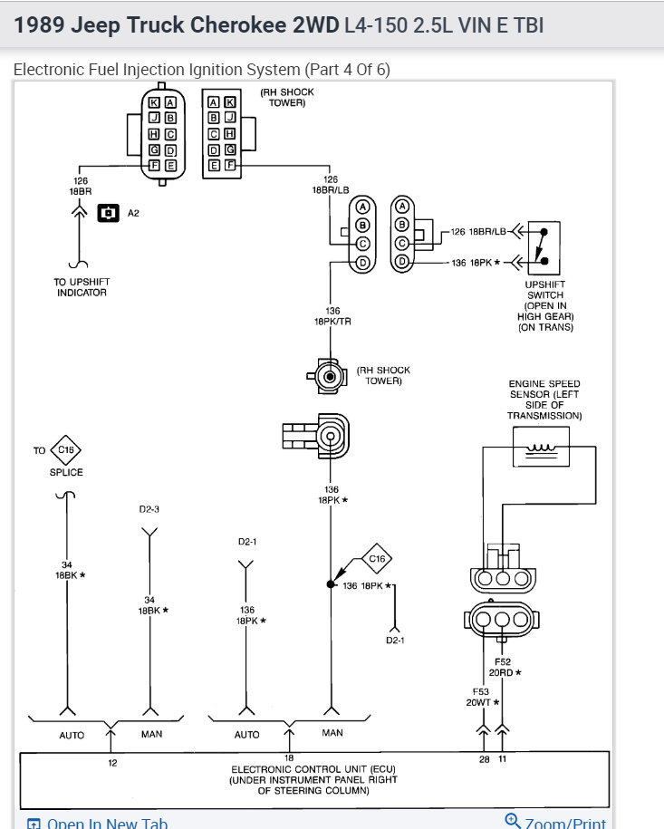

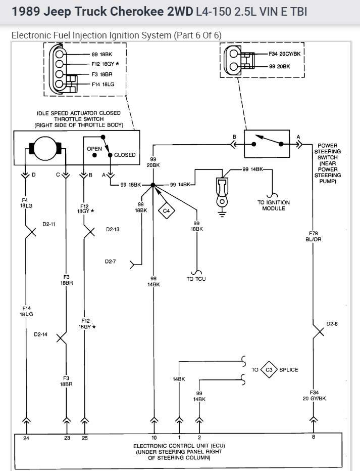

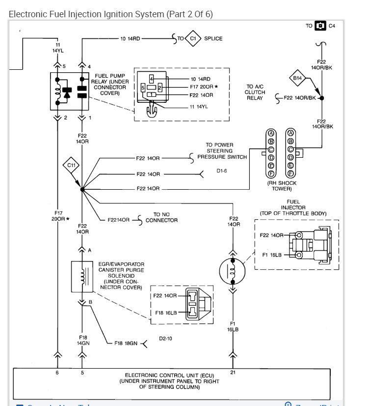

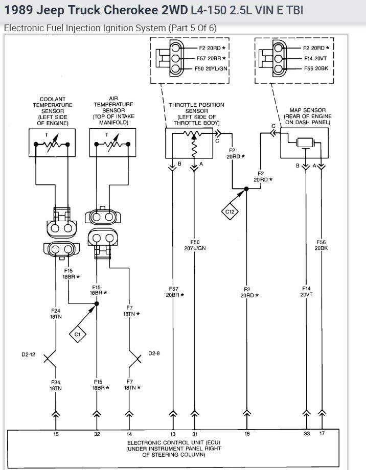

KEN L
  • MASTER CERTIFIED MECHANIC
  • 48,363 POSTS
It sounds like you lost power or ground somewhere or the ignition module has gone out. here are engine wiring diagrams and a guide to help you test the system so we can confirm the ignition module failure:
+1
Thursday, May 30th, 2019 AT 12:08 PM
ARON DANIEL
Ken, mine is a 4.0 renix. The pictures are for a 2.5 engine. Are they the same?
Sunday, June 2nd, 2019 AT 10:00 AM
KEN L
  • 48,363 POSTS
Very similar.

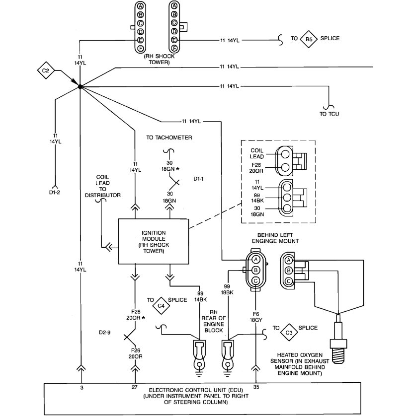

89 jeep 4.0l, jeep died no spark, 12 volts on coil & mod. Had coil tested, coil and mod tested okay. Tested crank sensor reads 220 ohms. Tried testing cam sensor jeep started, it's rough, have 5 volt on the blue and gray striped wires, how to finish testing and checking the cam sensor? It also dies, but will restart. If I pull crank sensor jeep dies, plug it back in it will start. Pull plug on cam sensor still runs? Is this normal? I need some help on how to finish testing cam sensor.
Monday, December 7th, 2020 AT 12:26 PM (Merged)

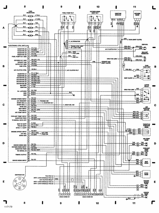

RIVERMIKERAT
  • 6,110 POSTS
Our reference doesn't show your vehicle having a cam sensor.
RIVERMIKERAT
  • 6,110 POSTS
Engine controls schematic attached.
