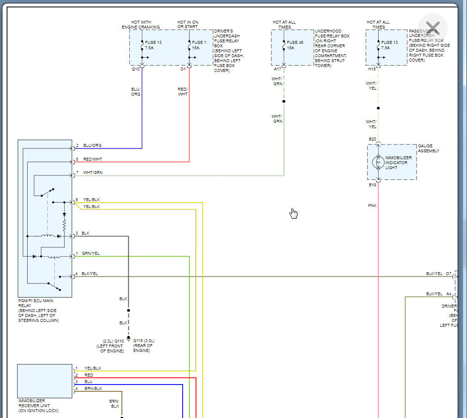

MINDYC
It was a year between the first and second time this happened but over last 6-9 months is now happening more frequently. It happens most often after short trips but after 15-30 minutes most times it will start. The engine cranks but doesn't start and if it does it will die when gas applied. Fuel pump was checked before it started happening more fequently. Sounds like something fuel related but what other possibilities can you suggest. How about the EGR valve?
Sep 28, 2020 at 9:33 AM (Merged)

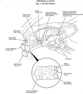

KHLOW2008
  • 41,812 POSTS
Hi mindyc, Not the EGR valve. I would suggest checking the PGM-FI main relay.
https://images.2carpros.com/forum/automotive_pictures/192750_PGMFIRelay99Accordpix_1.jpg

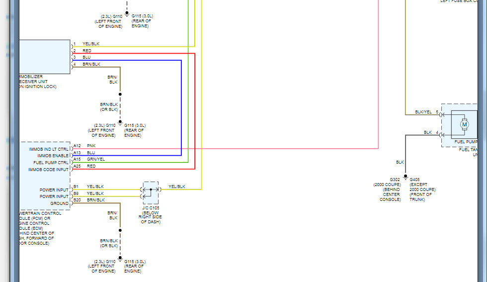

BLESSING EWOBOR
  • 753 POSTS
Hello, the car listed above's engine is cranking but refused to start. I observed that the security light (key symbol) is not displaying on the combination meter, then I realized that the problem is the immobilizer system. After leaving the vehicle for some hours I came back to the vehicle, turned the ignition switch to on position, the security light was "on" on the combination meter, I cranked the engine and it started. I was some how confused. Backing the door the security light went off again, I decided to shake the vehicle the light came on, shaking it again the light went off. Then I knew that there is open circuit, short to voltage, or ground some where. I have been searching for that but I have not seen it. How can I fix the problem?
Sep 28, 2020 at 9:35 AM (Merged)
DJCL
  • 767 POSTS
Ome other thing you can try is. Cranking the engine with your foot on the gas held down to the floor for about 15 second and see if the engine starts to clear out. Let me know how it works out.
How are you searching for it? I agree that it would have to be rubbed through wire but I would start at the immobilizer and hook up your meter to test each wire for a short to power, ground and another circuit. Clearly this is going to take a little bit of time but now that you know how to get it to act up, when you shake the vehicle, clearly the voltage should not change. If you can back probe the connector that would be best because the system will need to remain intact.
Does that make sense?
