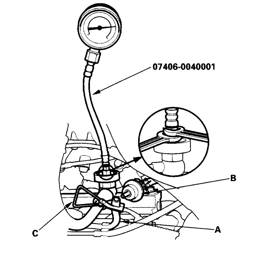

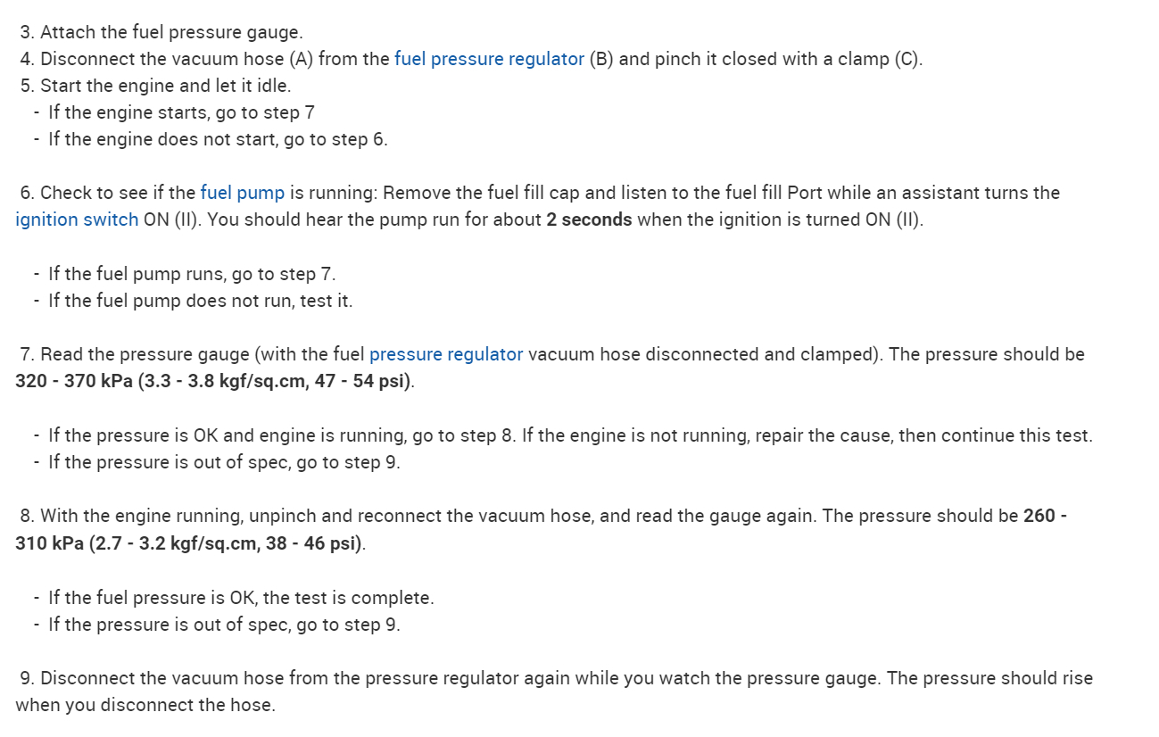

Turns over but won’t start. Tried both steps and they are both good. Have fire and gas but still won’t start. Just keeps turning over. It’s has good compression checked numerous things still no luck. any help would be appreciated for me anyone to try to figure out thanks.
Jun 12, 2019 at 5:59 AM
SCGRANTURISMO
  • CERTIFIED EXPERT
  • 4,897 POSTS

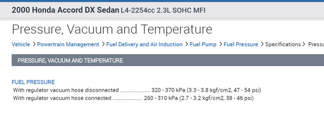

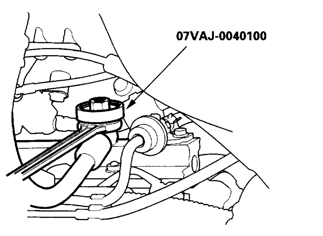

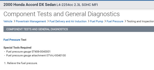

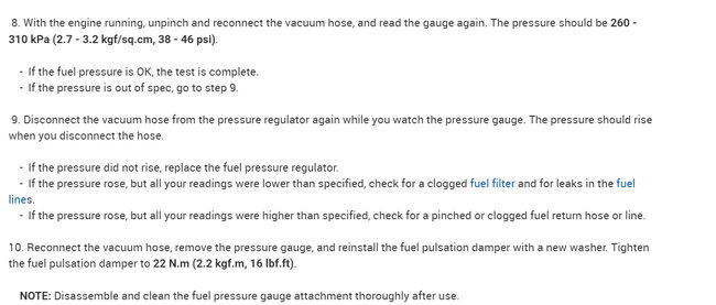

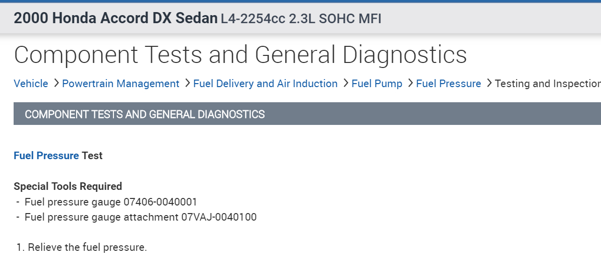

This one's puzzling, if you have spark, fuel, and compression then your vehicle should start. When you turn the key to the on position without cranking the engine over can you hear the fuel pump run in the tank for 5 seconds?
Your vehicle might be getting fuel, but not enough pressure for the injectors to run properly. I have included the fuel pressure specs and testing procedures for your vehicle in the diagrams down below. Please go through these guides and get back to us with what you are able to find out. We can go from there.

This really sounds like a fuel pressure issue. What did you get when you checked the fuel pressure?
