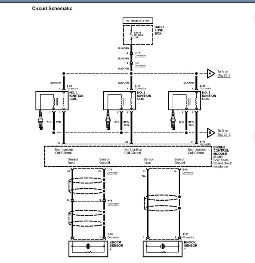

I used the exhaust manifold and one of the studs. No spark. Just to confirm, I put the plug into the coil, held it to the ground and turned the engine over. Correct procedure?
Saturday, November 13th, 2021 AT 8:34 AM

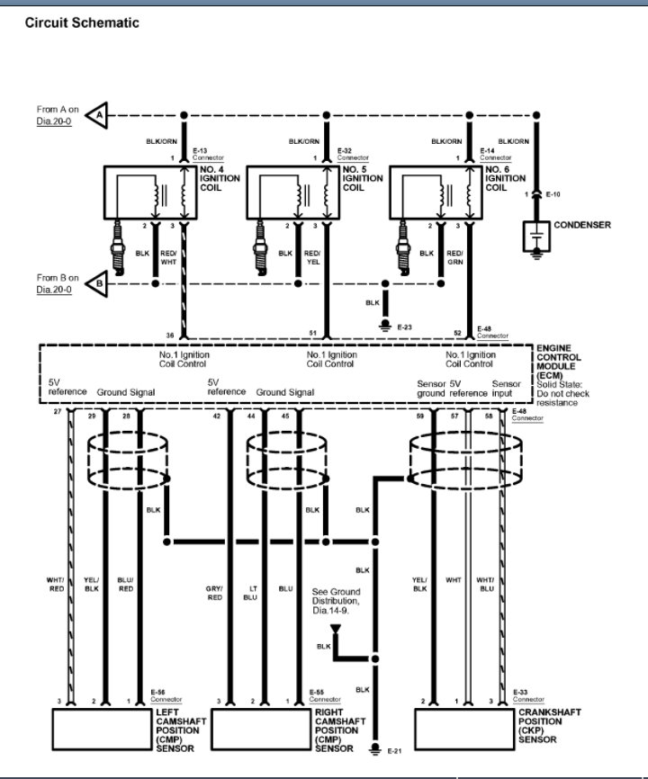

Correct. So, we need to use the wiring diagrams I attached previously and start going through the system. Basically, there is either something that is telling the ECM to not fire the plugs, or the ECM is the issue.
Again, if all you did was change the fuel filter and the vehicle was running prior to that then we are missing something. It would be a pretty big coincidence that an ECM failed at the same time of you changed the filter. So, I suspect you unhooked something, or the ignition system fuse is blown. Please run through that wiring diagram that I attached again here and let us know what you find. Thanks

Hey Ken, I may have some good news, or at least something that will make a difference. I checked the fuses inside the car and found the ignition coil fuse was blown. ECM and ECM back up fuses are okay.
I'm going to AutoZone shortly to pick up the fuse.

No. If this fuse was blown then the plugs would not fire and that is the issue and not my theory of the fuel filter issue. Basically, all we had to work on was that you changed the filter and it stopped running. So that was my thought based on that info.
However, now that we have this fuse blown then that is the issue.
If the engine does not start, then check the fuse again. If it blew again then you have a short in the circuit and you will have to track that down.

Thank you again for all your help! It took me - finally- studying the diagrams you sent that helped me find the fuse issue. Just in the nick of time.
