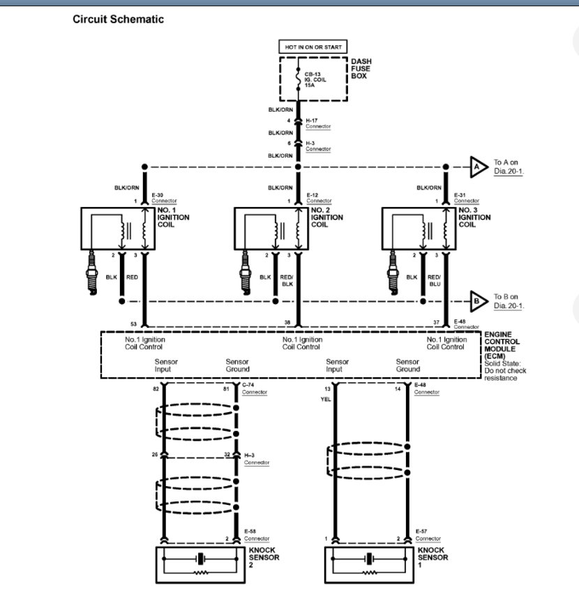

Will not start after replacing the fuel filter
Any good ground. So, if the exhaust manifold is available then just use one of the studs as those are great grounds.
I used the exhaust manifold and one of the studs. No spark. Just to confirm, I put the plug into the coil, held it to the ground and turned the engine over. Correct procedure?

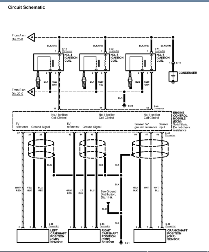

Correct. So, we need to use the wiring diagrams I attached previously and start going through the system. Basically, there is either something that is telling the ECM to not fire the plugs, or the ECM is the issue.
Again, if all you did was change the fuel filter and the vehicle was running prior to that then we are missing something. It would be a pretty big coincidence that an ECM failed at the same time of you changed the filter. So, I suspect you unhooked something, or the ignition system fuse is blown. Please run through that wiring diagram that I attached again here and let us know what you find. Thanks

Okay, will do. The only thing I unhooked when replacing the fuel filter was the fuel pump fuse and the fuel lines to the filter. I still wonder about the fuse issue. Seems unlikely but could letting the engine run out of fuel because the fuse was pulled have caused an imbalance. like with the ECM?
Nov 13, 2021 at 12:48 AM
Hey Ken, I may have some good news, or at least something that will make a difference. I checked the fuses inside the car and found the ignition coil fuse was blown. ECM and ECM back up fuses are okay.

No. If this fuse was blown then the plugs would not fire and that is the issue and not my theory of the fuel filter issue. Basically, all we had to work on was that you changed the filter and it stopped running. So that was my thought based on that info.
However, now that we have this fuse blown then that is the issue.
If the engine does not start, then check the fuse again. If it blew again then you have a short in the circuit and you will have to track that down.

Hey Ken, great news! It's running!!
