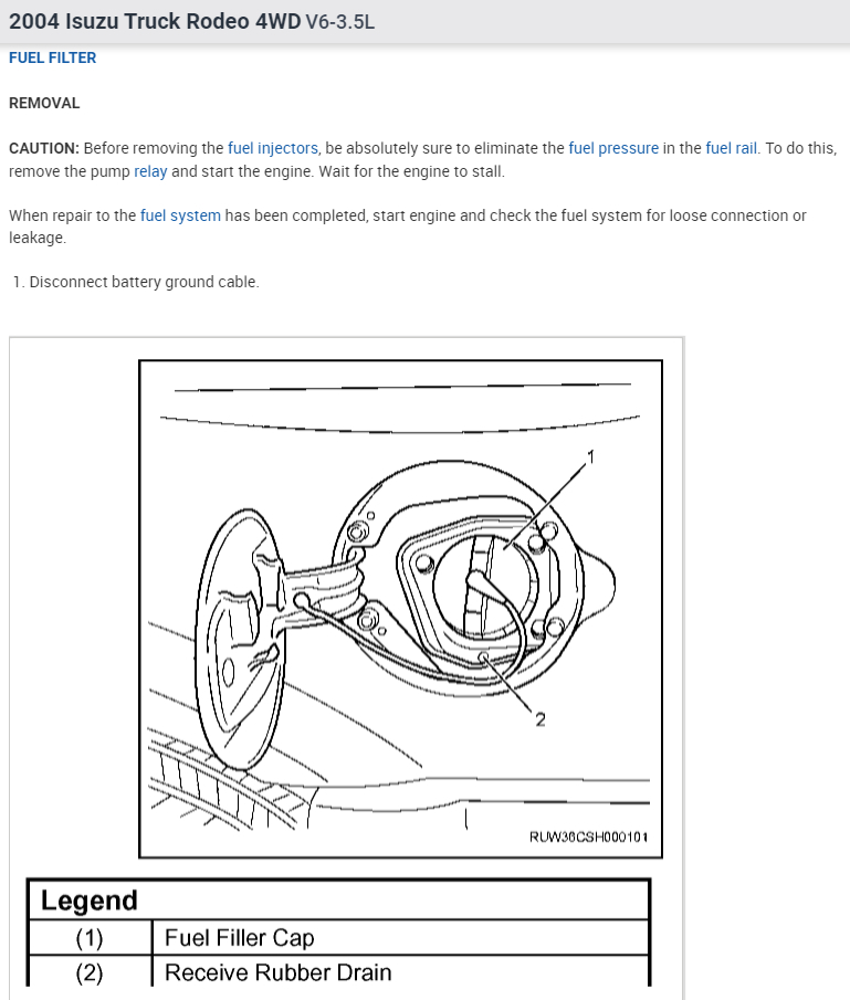

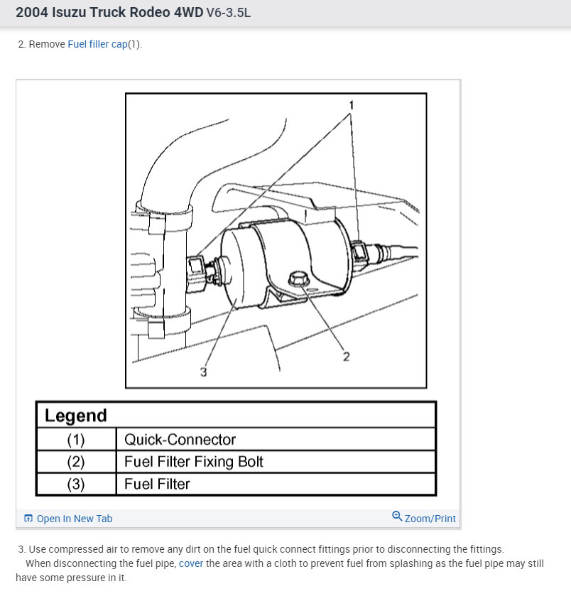

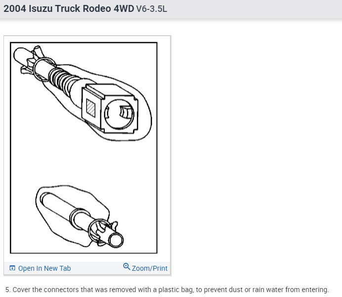

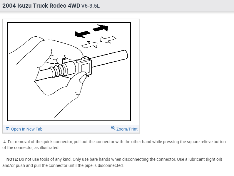

I have attached the fuel filter replacement procedure below, take a look at it, just in case you have missed something.
Let me know of any questions.
https://www.2carpros.com/articles/how-to-change-a-fuel-filter

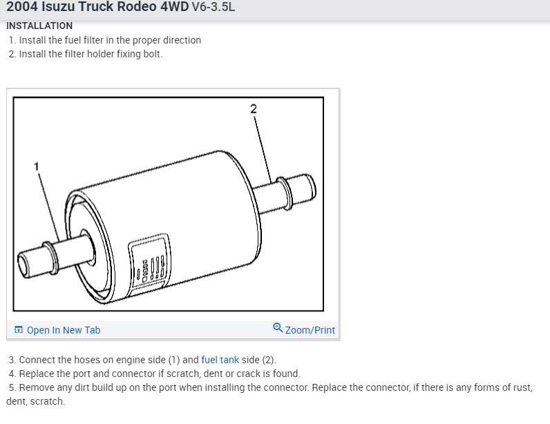

And yes, I checked again to make sure the filter is installed in the proper position for correct flow.

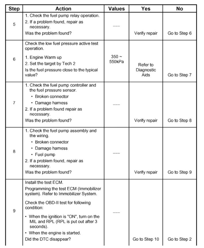

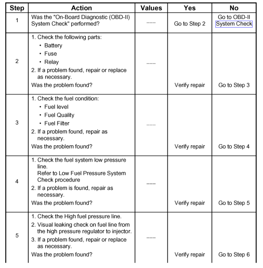

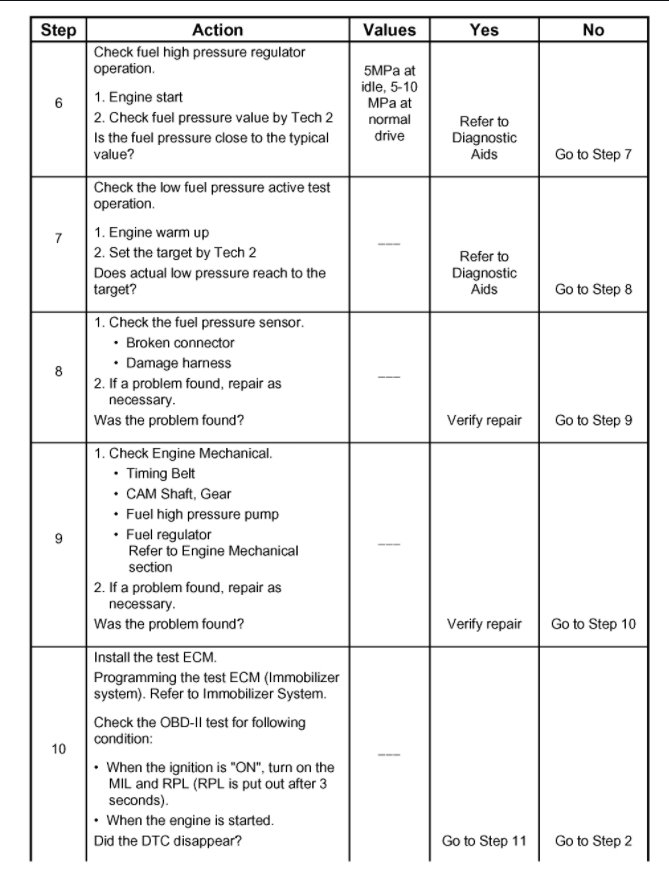

It might be a good idea to check the fuel pressure. You might be getting too much fuel due to an issue with the regulator.
Did you have any issues before the filter change?

I've had an ongoing misfire of cylinder #3 for months. I was told compression was less than half of normal. At first, it would idle down at stop lights, etc., and sometimes stall. I replaced plugs, ignition coils and cleaned the throttle body. The misfire was still there, but no longer had problems with stalling...RPMs at idle in drive were at 600-700. The car ran well considering the misfire. At higher speeds it seemed to even out and was even "peppy". It was like that just before I replaced the fuel filter.

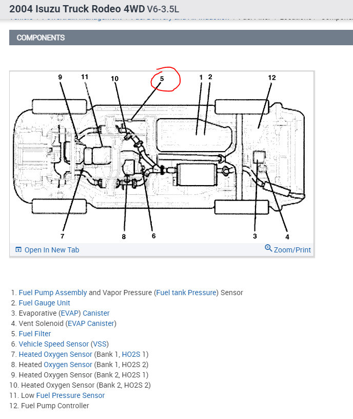

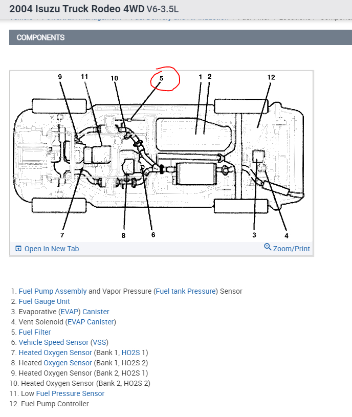

The filter change is very simple. It's accessible easily right under the driver's side door. Simple as it is, I consulted a few YouTube videos for the procedure. Both instructed to start the engine, pull the fuel pump fuse and wait till the engine stops, thus releasing pressure in the line. I did all that, changed the filter (the old one rattled) replaced the fuse and the engine wouldn't start. In both videos it only took the normal loading of the fuel line (key to on and wait for the fuel pump to stop) to start the engine.
One thing I noticed was that each vehicle in the videos stopped running within just a few seconds of pulling the fuse. Mine kept running for maybe up to 15 seconds before it stopped. This made me think the line wasn't primed enough and needed more fuel. I probably flooded it myself trying to prime the system.
I did remove the line from the fuel filter to the engine and there was decent pressure. While the line was off, I also turned the key to "on" so the fuel pump would run...which it did, again with decent pressure...fuel came squirting out of the filter.
My difficulty with checking fuel pressure is I haven't been able to locate the valve. Given the engine has direct injection, I think the fuel rail is under the cylinder head with the fuel injectors. ???

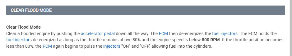

What I would do is start with trying a clear flood start. This info is attached below which is where you just hold the accelerator to the floor and start the engine. This will cut 80% of the fuel delivered and the engine may start. More than likely, it will take a long crank before it does because it is far less fuel then normal but if it does, then you need to change the plugs.
Even if this doesn't get the engine to start, you will most likely need to change the plugs because they may be so fouled at this point that they have completely failed.
You can test this by pulling one out and hold it against the block and see how bright and blue the spark is.
However, assuming this happened immediately after changing the filter and the engine was running prior, the only way I can explain it is you had a restricted filter and the plugs had worn to the point that they had weak spark already. Then you remove the restriction in the filter that a full load of fuel just wipes out the weak spark.
if this theory is correct, then you should see some positive results with the clear flood start and/or replacing the plugs.

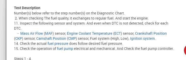

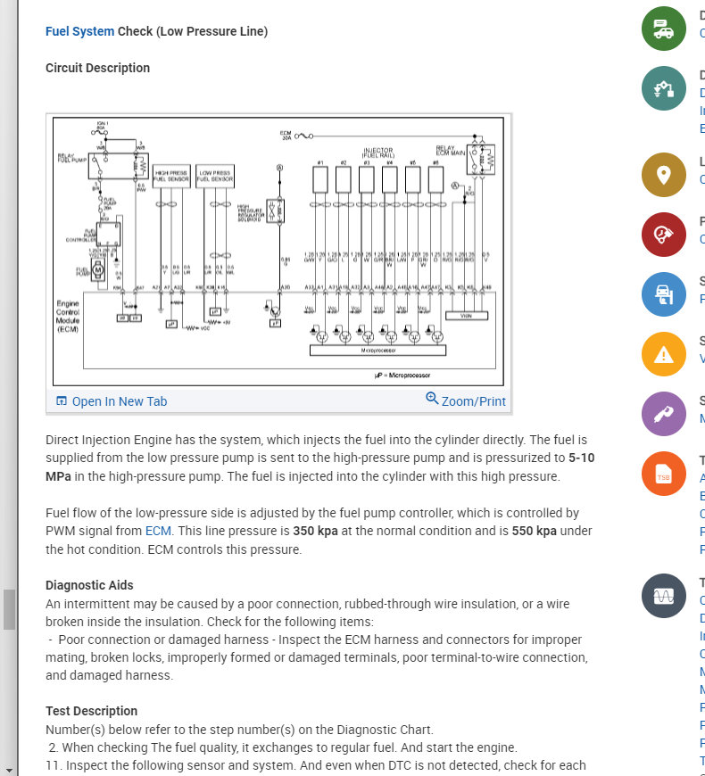

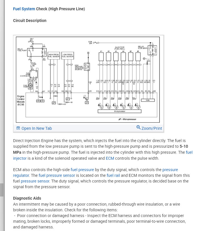

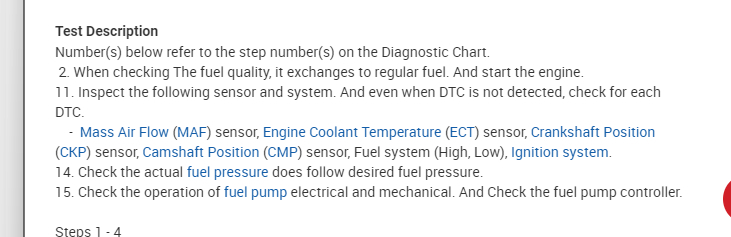

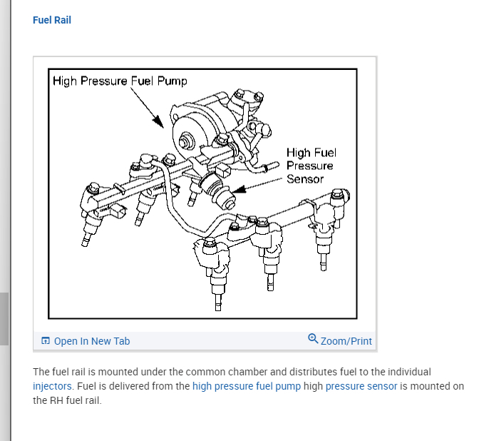

However, your system being direct injected means you have a low side pressure and a high side.
Basically, the low side supplies the proper amount of fuel to the high-pressure pump for it to be injected into the cylinder.
If all this checks out, my bet is we will find the high-pressure pump is not building enough pressure which means it supplies fuel to the cylinder at a low pressure and the engine will not start and act like it is flooded.

This was not incorrect. They say to remove the fuel pump relay/fuse only when you are working on the high-pressure side because that can be harmful if you have high pressure releasing a line.
On the low side they just say to remove the fuel filler cap, but I can't imagine that this was related to the fuse removal.
I think you had an issue with that filter, and it was masking the issue that you are having now. So now that you have a free-flowing filter, you are seeing this issue. Again, that is a theory but if that is not it, this is a pure coincidence.

Yeah. I would. If you haven't installed them all yet. Just leave them out for a few minutes and that fuel will evaporate if there is fuel in the combustion chamber.
However, if you have them installed already then try the clear flood start first and see what happens.

Already installed them. Gave it a try with the clear flood method, no luck. tried it well over a dozen times. Battery is getting low. I'll have to get a charger and charge it.

Just read a blurb about checking fuel pressure on my vehicle. Says there is no port for checking pressure. The way to do it is to disconnect the fuel line and jump the terminals. It says there should be about .38 liters (almost half a quart) after 15 seconds. Without doing that, I know from when I did check to see if the fuel pump was working, it put out an amount of gas after only a few seconds that I believe would be the right amount if held for 15 seconds.
I don't think it's the problem, but then again, I'm certainly no expert.

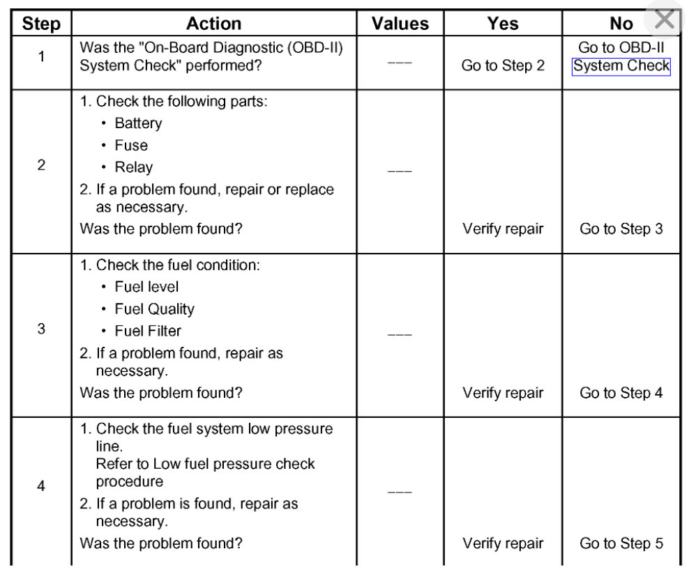

Got it. So now we are onto confirming spark as you mentioned. Then we are going to need to check the high-pressure side because you are correct that the low side is basically just a volume check.
The high-pressure pump is on the rail, but you have a sensor that can be monitored with a scan tool. Do you have a scan tool that can monitor PCM data? If so we need to see what it is saying for the high side PSI.

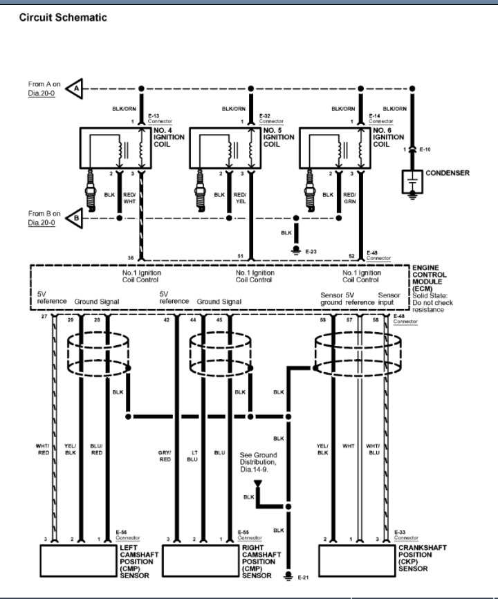

Well, I finally got the battery charged and just did a spark check, no spark. I tested the number one plug first, because I had it out and dried it overnight. Then I tested number 4 and got the same results. Number 4 was again wet with gas. I dried it off, but it wasn't as dry as number one. These are the new plugs I just put in. I tested number 4 in case it was the coil not working on number one. So, I will go ahead and put the old fuel filter back on and will see if I get spark from an old (but not much used) spark plug from before when the vehicle was still running and before I had any gas flooding issues.
Just so you know, my test procedure was to pull the plug, attach it back to the coil, and hold it against the intake manifold (aluminum - I think). Is that a proper test?
If it still doesn't spark, what's my next step?

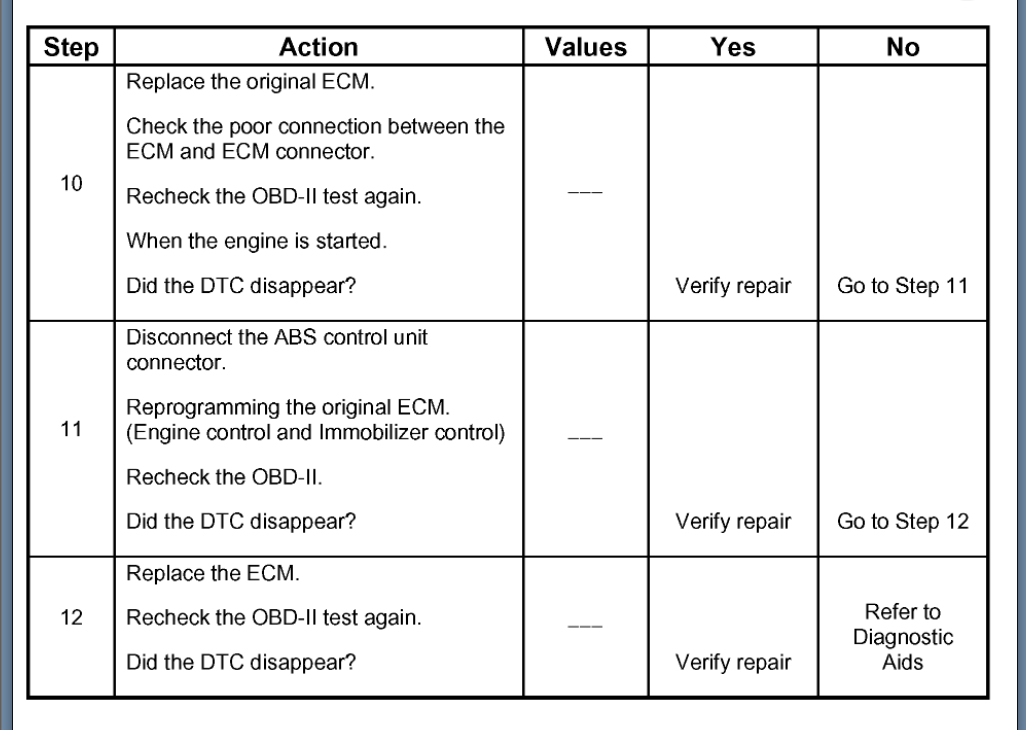

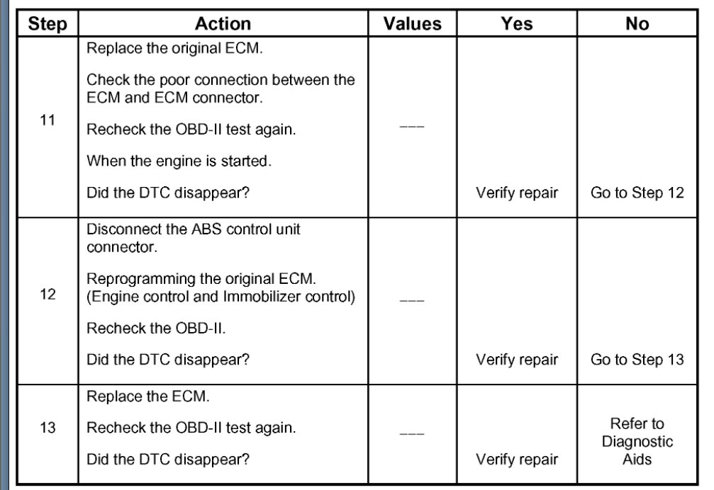

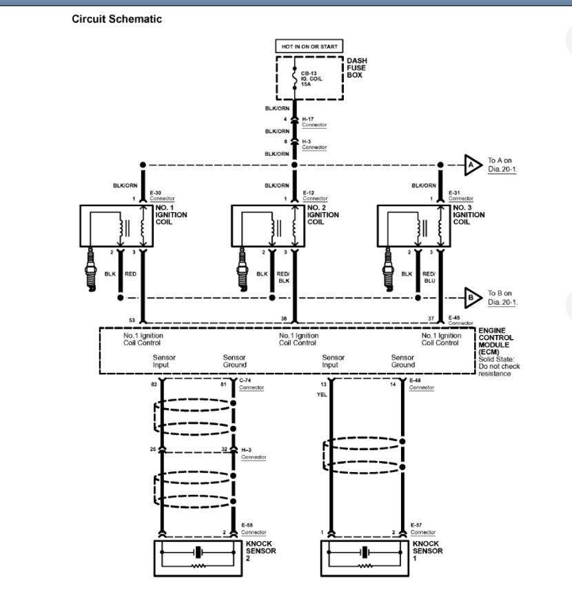

Okay. If you are not checking the spark with the plug against the block or a known good ground, then that is not going to work. The manifold is not going to be good enough so let's do the same test on the block and see if there is spark.
If there is no spark, then we have either an ECM issue or the cranks sensor has failed.
What needs to happen is we need to check the ECM to find out if it is grounding the coil so that it commands the plug on.
You do this by putting your test light clamp on battery positive and then checking the terminal from the ECM to the coil and crank the engine. The test light should flash when it is commanding the coil to fire the plug.
I attached the wiring diagram below. If this is the case, then this has nothing to do with changing the filter as that would not disable the ignition.
What I would recommend is go back over everything you did and make sure you didn't remove a fuse or the fuse for the coils, shown below, is not blown and then check the coil as described above.
