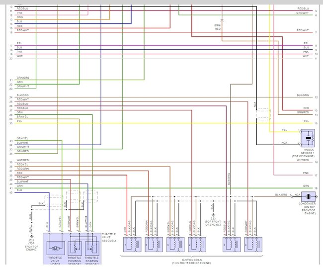

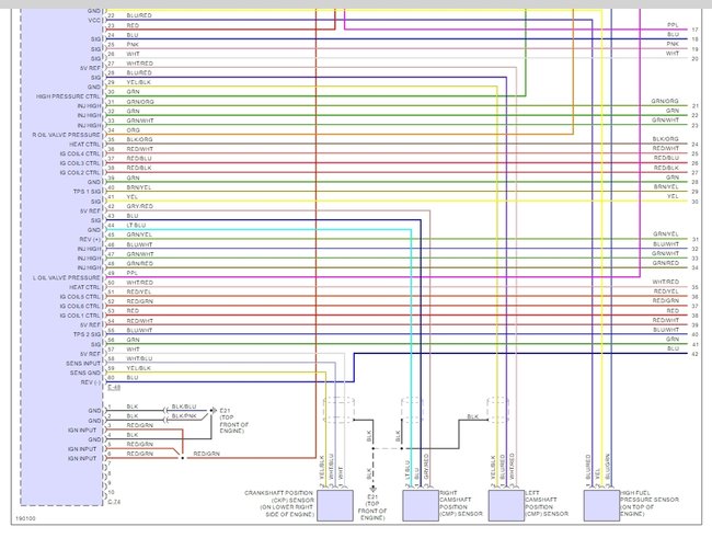

Ok compression is good. And i am getting about 280 to 300 rpm while engine is turning over. But i am still getting no spark from any of the coils
Sep 17, 2016 at 2:40 AM
  • 55,421 POSTS

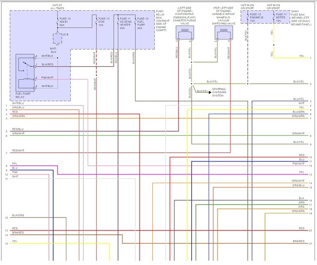

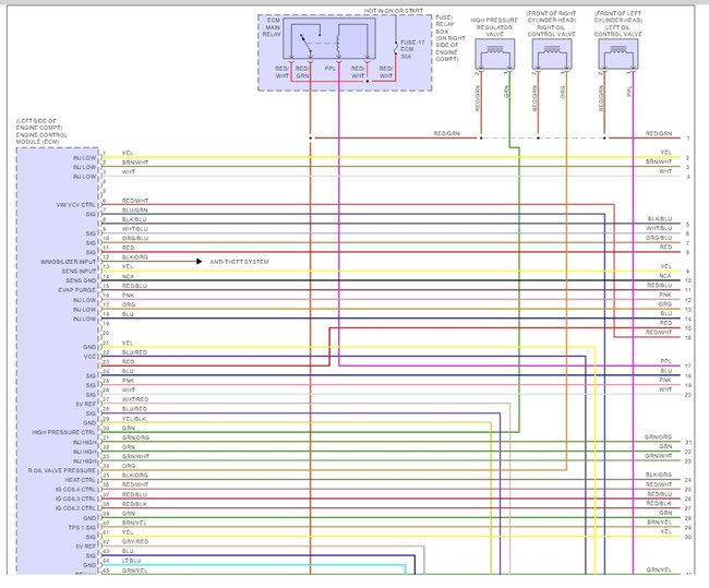

It looks like its time to do a pin to pin check of the wring harness, must be a shorted/broken wiring somewhere plus you can check the power and grounds, here is a guide that will help you
Please let us know what you find so it will help others.

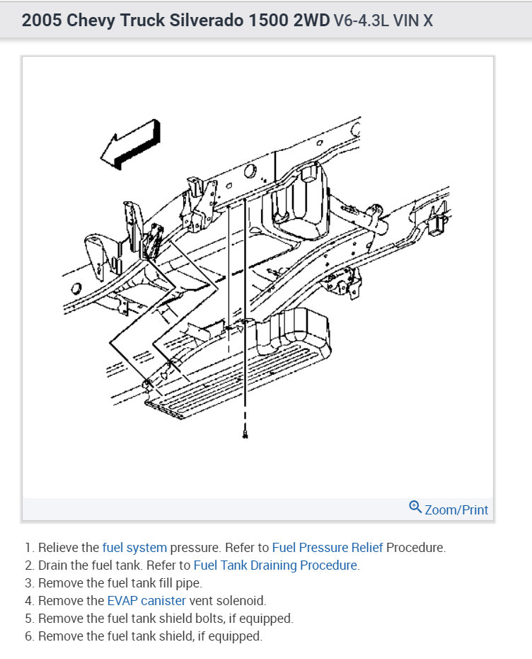

  • 55,421 POSTS

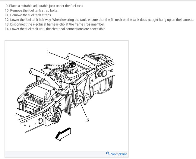

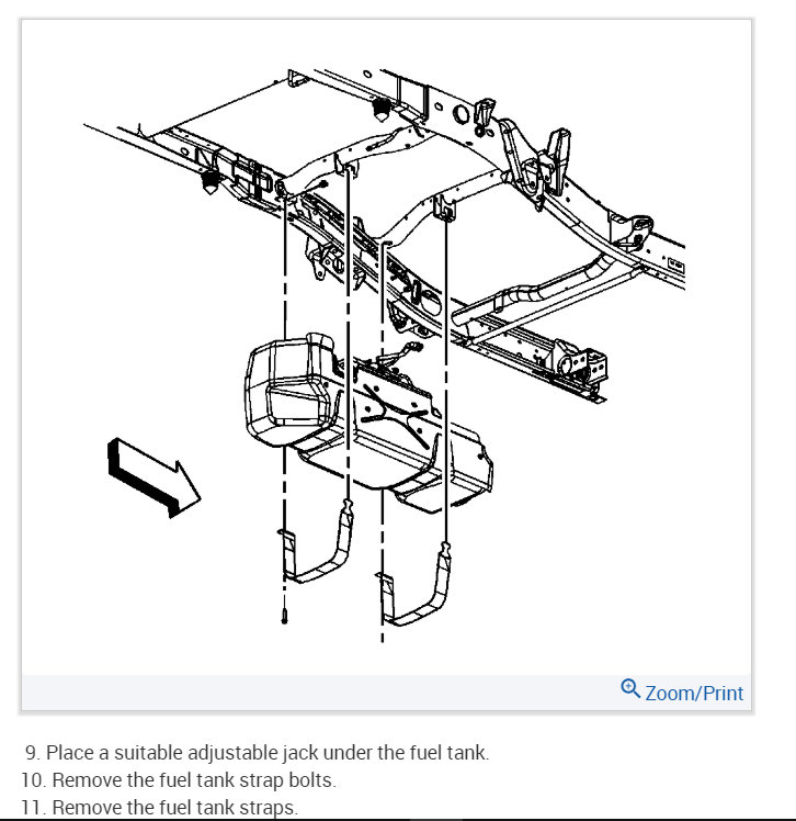

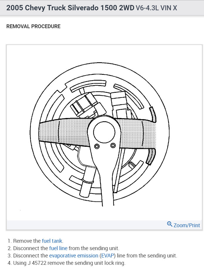

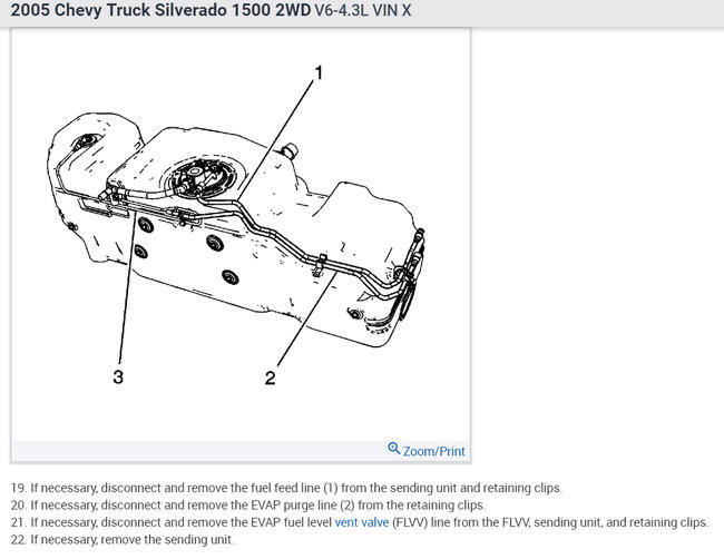

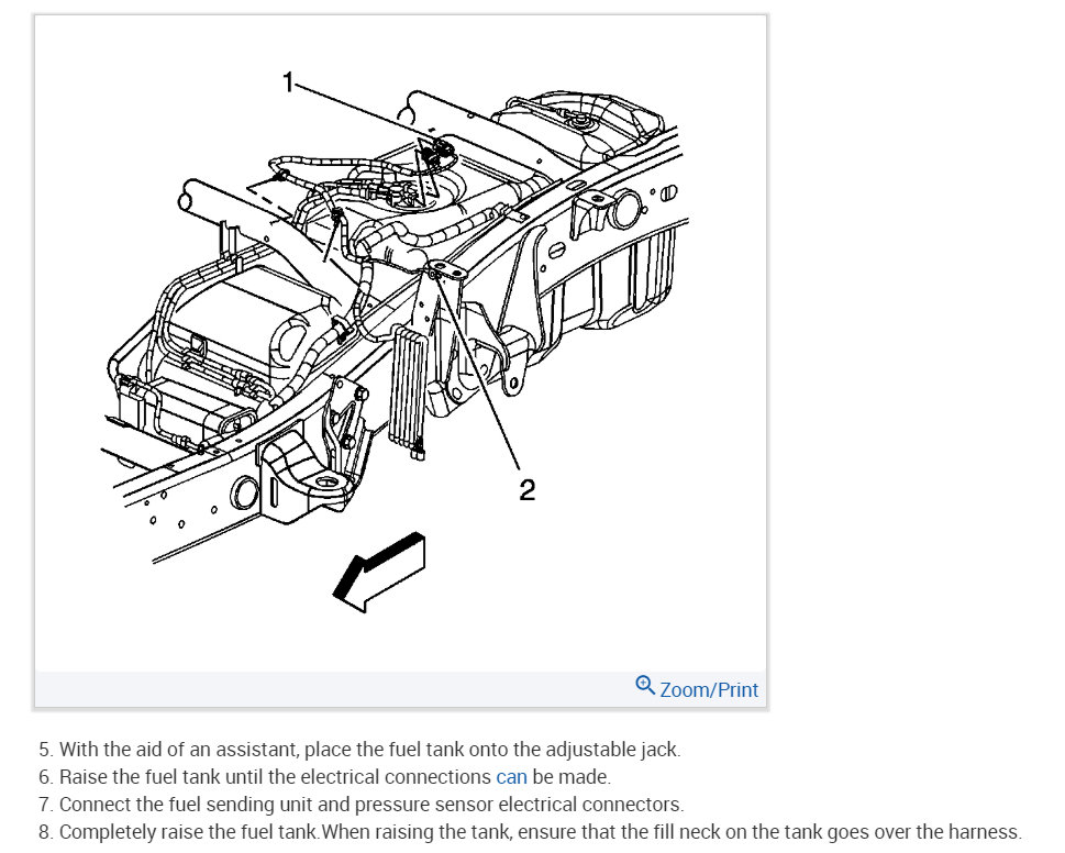

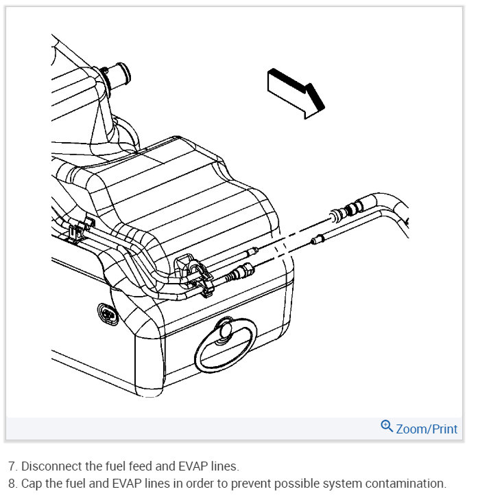

you will need to start a new question for the Holden, if you have power to the pump but no pressure you will need to change the pump out here are the instructions. Check out the diagrams (below). Let us know what happens and please upload pictures or videos of the problem.
Feb 3, 2021 at 3:01 AM

Thanks Ken. I have replaced the fuel pump and the engine starts with no problem at all. By the way, I didn't take the tank out, I just undid a couple of the nuts and bolts holding the tray on and then jacked up the tray which gave me ample room to remove and replace the pump assembly.
