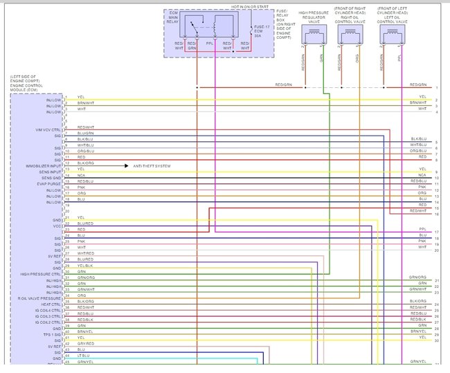

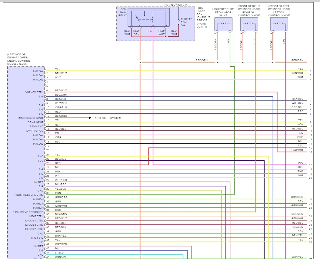

No. There are no codes in the computer. I have checked all fuses everything. New cam sensors new crank sensor new computer.

Does the engine have compression?

Ok compression is good. And I am getting about 280 to 300 rpm while engine is turning over. But I am still getting no spark from any of the coils

It looks like its time to do a pin to pin check of the wring harness, must be a shorted/broken wiring somewhere plus you can check the power and grounds, here is a guide that will help you

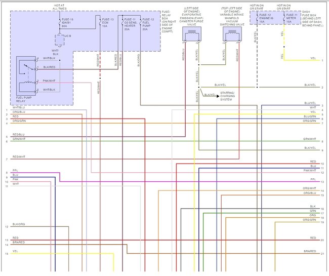

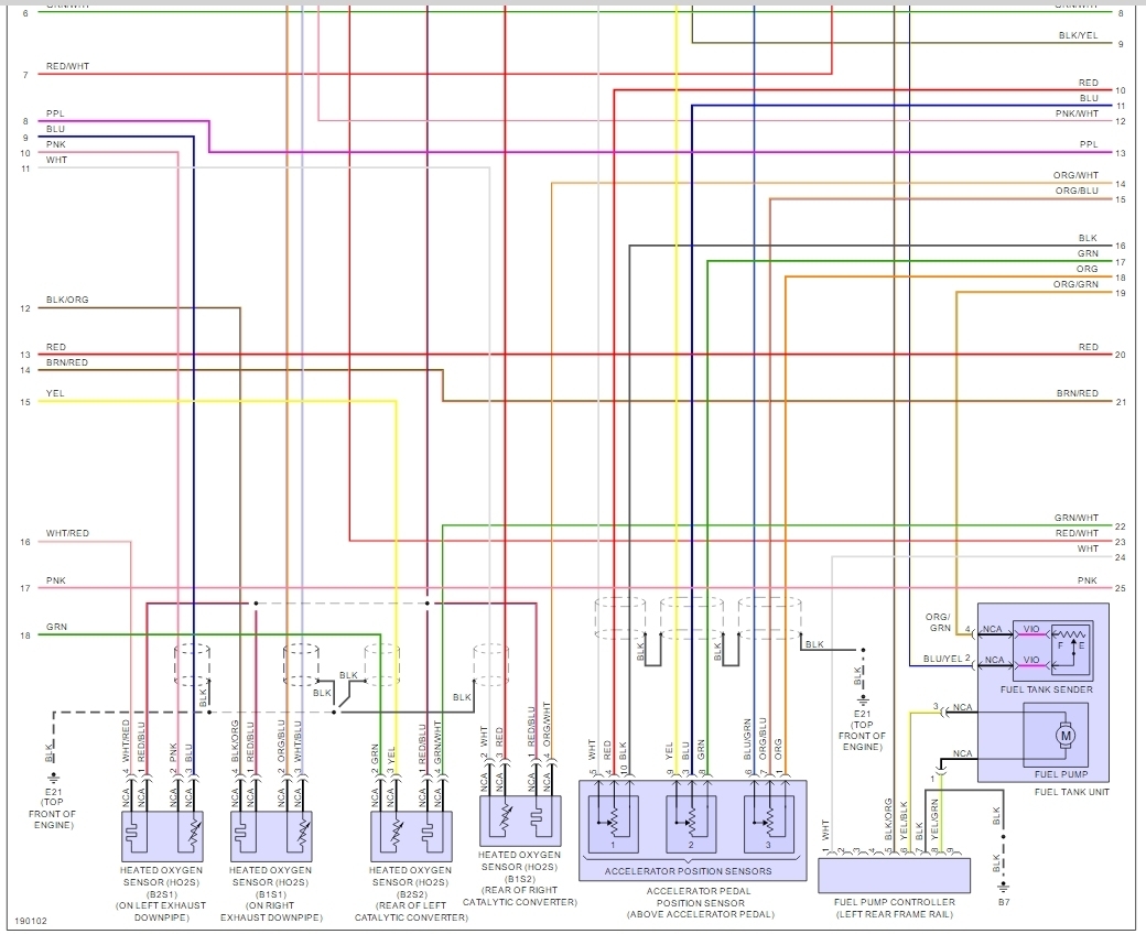

Hello everyone, I realise this is an oldish post. But, I have a 2004 3.5liter V6 petrol 5 speed rodeo. I have been having an issue where the engine will crank but not start. The problem was intermittent at first but became progressively worse until the engine would not starter all. I have now worked out that the problem is either the fuel pump or the fuel pump relay. I swapped the fuel pump relay with the horn relay and the engine started. Just have to see if the problem occurs again now to test the pump. And yes the horn still works. Hope this helps.

This sounds like a fuel pump or the crankshaft angle sensor has gone out. When you turn the key to the on position without cranking the engine over can you hear the fuel pump run in the tank for 5 seconds?

Hi Ken,
No can’t hear the pump. It did the same thing yesterday so I shorted out the two large terminals for the relay and there was no difference. Also when cranking there is no fuel pressure at the valve on the left side fuel rail. I will be pulling the old pump out tomorrow and replacing with new one.

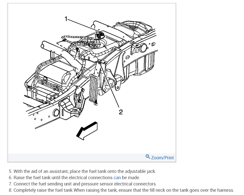

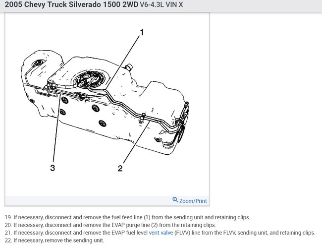

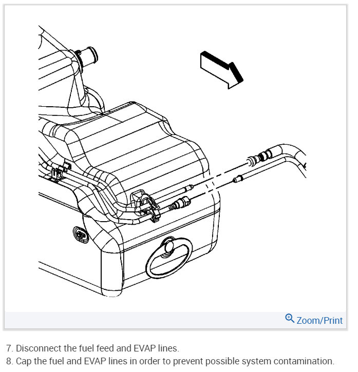

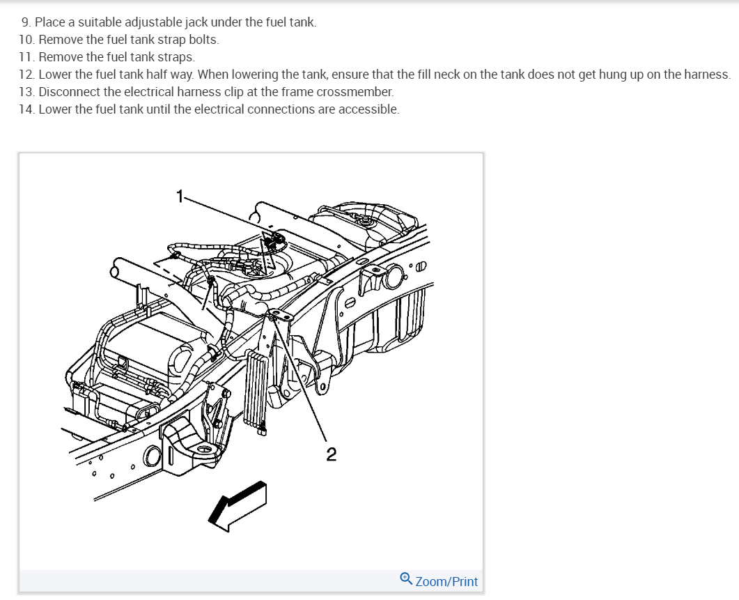

You will need to start a new question for the Holden, if you have power to the pump but no pressure you will need to change the pump out here are the instructions. Check out the diagrams (below). Let us know what happens and please upload pictures or videos of the problem.
Wednesday, February 3rd, 2021 AT 11:01 AM
BUDDIE95
  • 5 POSTS
Thanks Ken. I have replaced the fuel pump and the engine starts with no problem at all. By the way, I didn't take the tank out, I just undid a couple of the nuts and bolts holding the tray on and then jacked up the tray which gave me ample room to remove and replace the pump assembly.
