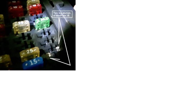

Joe, I cannot see the pins from my vantage point when I insert the MiniFuse.
How to view them?

Would you be able to use a mechanic's mirror to see? That is what I would try. If that doesn't work, things need to be taken apart to see it.

The MiniFuse panel has very small openings at rear for insertion of circuit wires, and the front exposes only the tips of the two panel-to-fuse contacts-- the two bright metal reflections in the photo I attached.
Every socket, when its MiniFuse is removed, reveals the same two metal contacts, but with no more access to socket housing.
The eBay photos provided do not seem relevant to the Buick 98 LeSabre.
Although I have an extensible, small mirror, I do not have the option to take apart the MiniFuse panel, itself, so even a junkyard panel would not improve the situation.
The MiniFuse panel appears glued to the left dash''s lower shroud, but I have tried the "wiggle test" to see whether I can find any seam or "snap-to" channel.
Thanks for the ideas, but the best approach may be to make sure all MiniFuse spares and those in use are of the thick conductor metal, which seem much more securely grasped by the socket fingers.
And to keep the panel access door closed at all times. Maybe the GM engineers understood the problem, already.

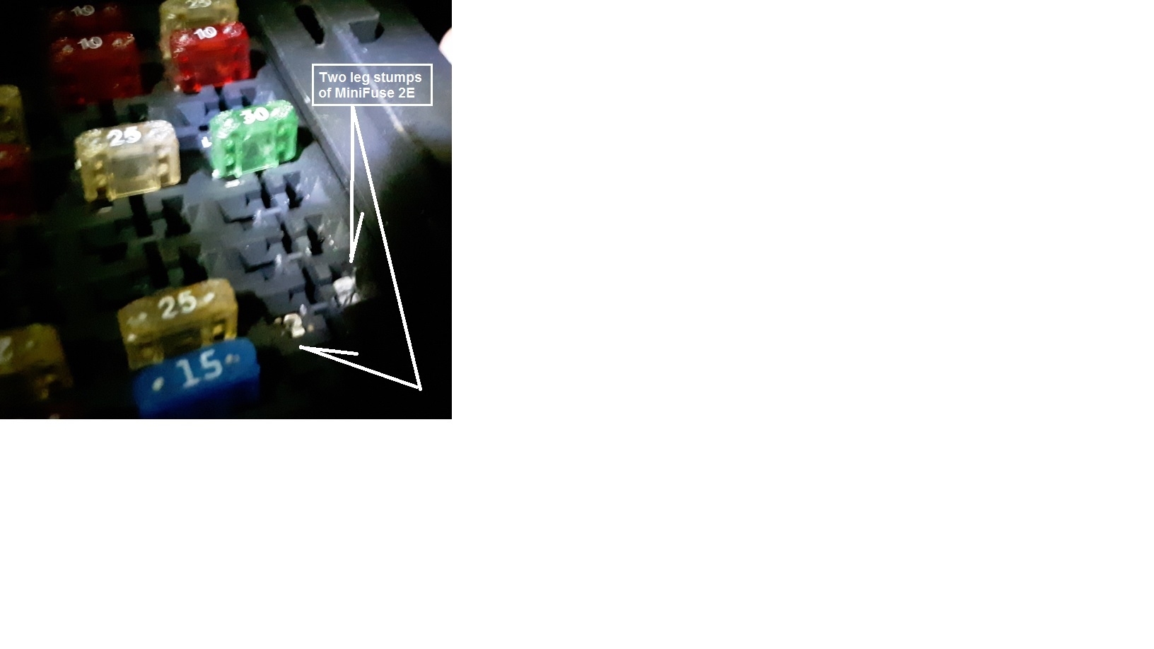

Chances are you are correct. As far as pics, did you attach pictures of the box or something you got online? I ask because nothing is showing.

Sorry, Joe, I did not realize you would read my "attached" comment as referring to this post. I should have written, "attached to a previous post".
The actual photo is re-attached, below.

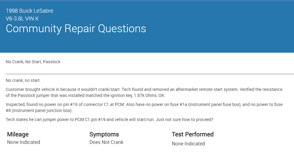

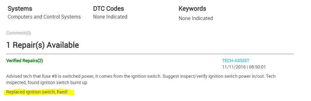

No problem whatsoever. I found something that may be of interest to you. Read through the pics I attached. I'm attaching them because it sounds very similar to what you are dealing with.

Similar, yes, in that the ignition key Ohm value was correct.
But different when my PCM suddenly no longer recognized the key resistor, which prevented me from testing any of the ignition pins. (Presuming the PCM stopped power to all pins)
That required me to bypass the entire VATS security circuit (orange-jacketed cable of two smaller, white wires) between PCM and ignition.
In the case you mention, the ignition switch no longer switched reliably on multiple pins, but in my case, the ignition continues to switch as it should with all pins but the PassLock2 security circuit.
However, every ignition switch eventually fails, so this will be instructive.
