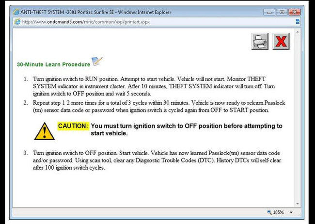

try resetting security system may be the cause. When you turn the key to the on position without cranking the engine over can you hear the fuel pump run in the tank for 5 seconds?
Aug 6, 2020 at 2:26 AM (Merged)
FORK JOAQUIN
  • 7 POSTS
Thank you so much. For the fast reply I will check that today.
FORK JOAQUIN
  • 7 POSTS
That is for a Pontiac though. will it work?
SATURNTECH9
  • 30,869 POSTS
The newer GM cars 2000 and up disable the fuel injector pulse for anti theft not the starter like the older GM cars. I looked at this one and do not see a tie in for the starter through the anti theft. With the key in the start position see if you have power to the small purple wire at the starter?

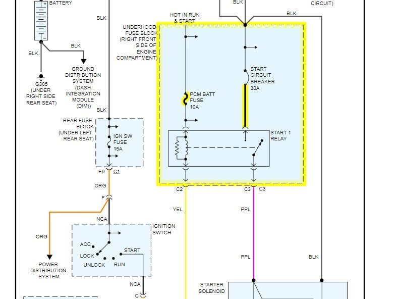

GTO5150
I replaced the battery, no help. I had the starter tested. It was fine. When the key is turned, I just get clicking (not rapid). Any ideas?
  • 75,992 POSTS
Battery and connections a okay-check and test the ignition PCM fuse 10amp, start circuit breaker, starter relay and ignition switch

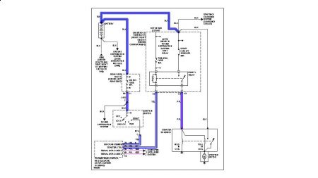

KAKULLAS
I couldn't start my car. So i figured my battery was dead because the lights were acting weird. I charged the battery that didn't help I tried a jump that didn't work. I charged it overnight and in the morning I turn the key and there is nothing at all complete darkness all across the dash. Please help if you can.
INTERNETMECHANIC
  • 700 POSTS
My first thought was to check feed to and from the ignition switch. The orange is voltage feed to the switch, hot all the time. The wire colors along bottom of switch in diagram, goes hot depending on the key position. You could track voltage from battery to fuse blocks? Use a voltage tester.
