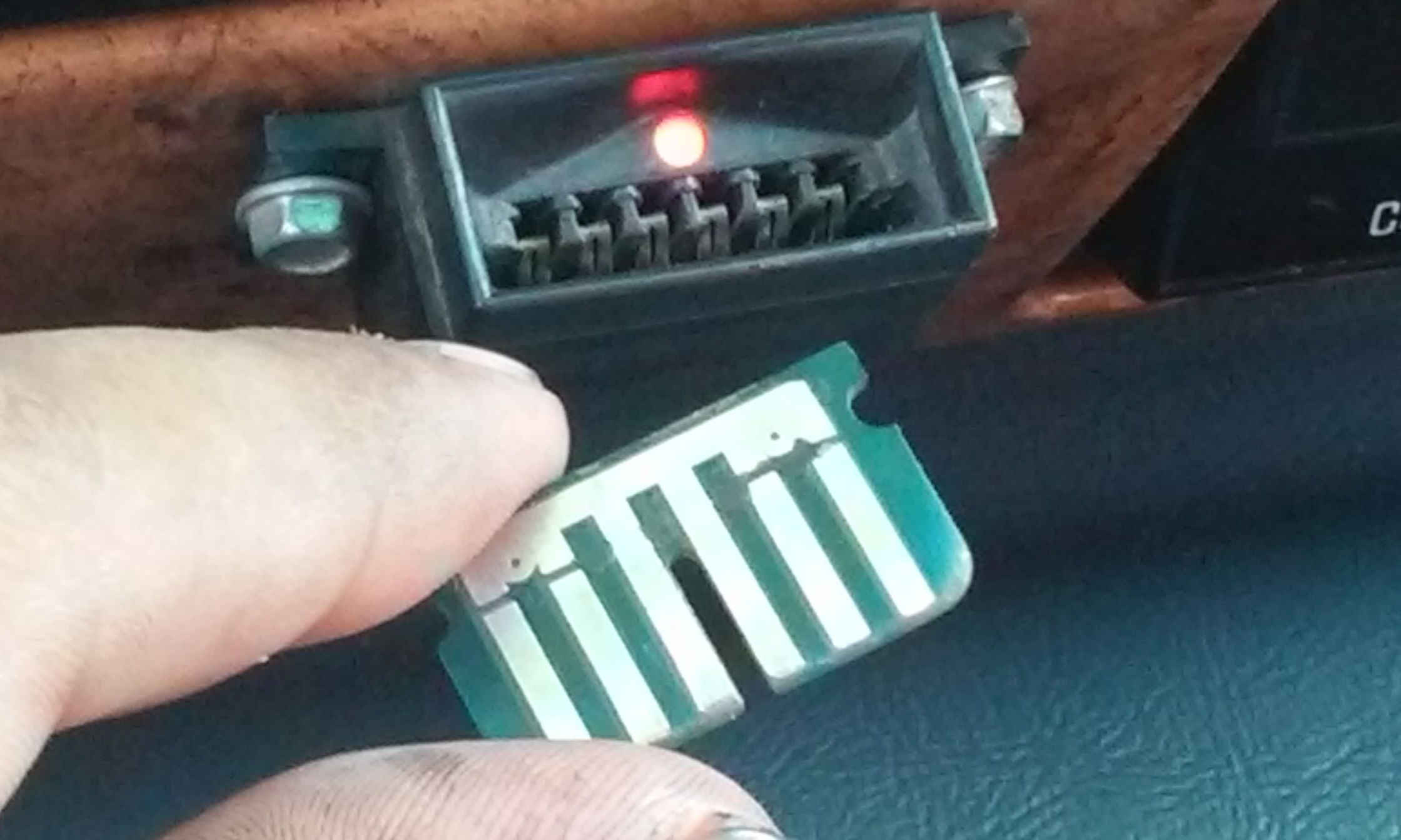

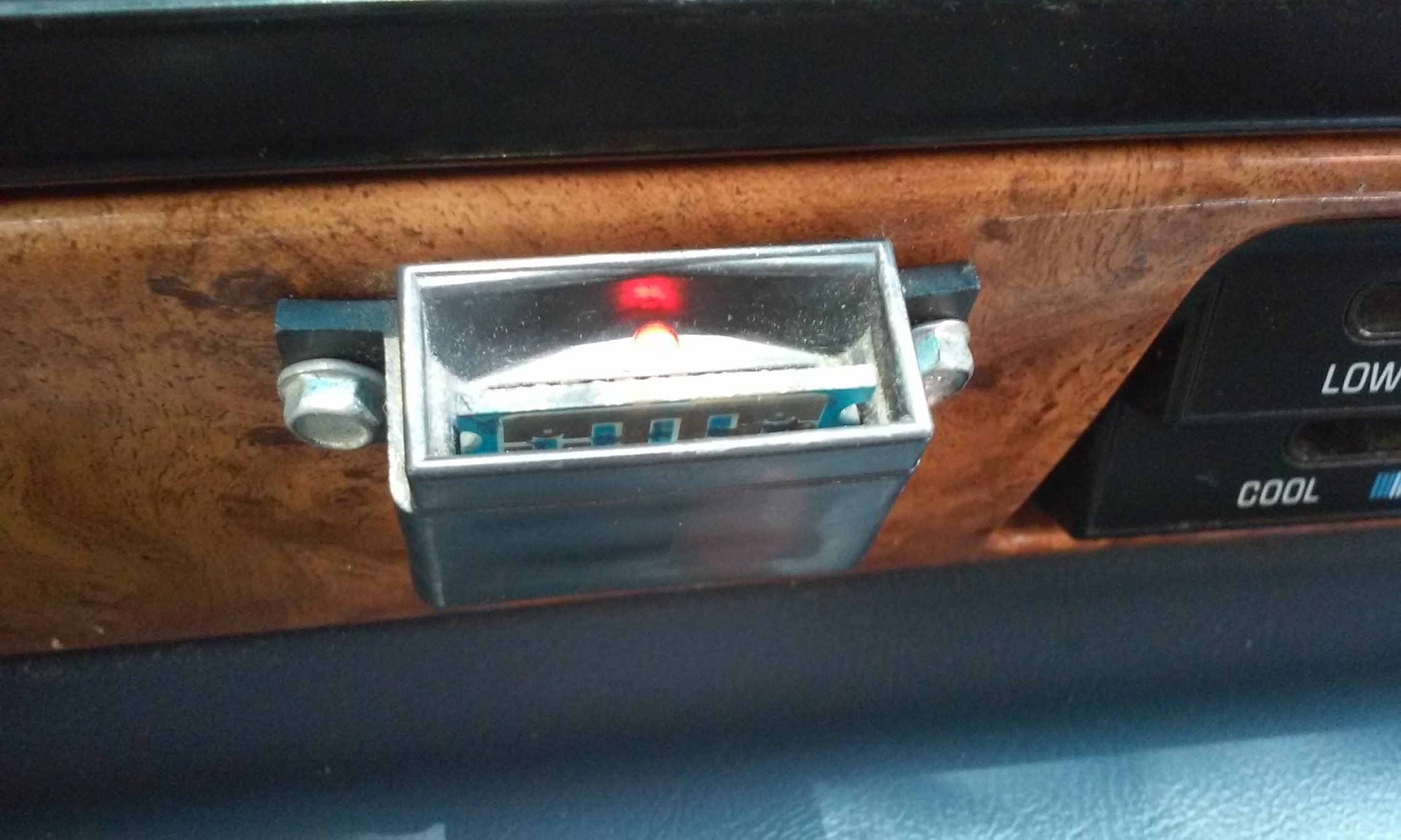

Ok one other thing i might add is that my car has a little square slot that was installed before i bought the car, which contains a little metal looking memory card which when you take it out, the car doesn't start or crank, the same thing its doing right now. And i did notice that even though its inserted, its kind of loose. Before it would go in kind of tight, but now it kinda goes in without any effort. Could this have something to do with it?
May 21, 2016 at 10:10 AM

Can you post a picture of what you are talking about?
May 21, 2016 at 10:16 AM

Its not letting me upload it. Can i send to you to an email address?
May 21, 2016 at 10:39 AM
JUANEMMANUEL
  • 63 POSTS
Here it is.
May 21, 2016 at 10:44 AM
  • CERTIFIED EXPERT
  • 53,872 POSTS
That is an old fashion alarm thing, I would take the out first thing, follow the wires back and just connect the wires the way they were originally made.

Im sorry i didnt understand. What thing do i take off? The whole slot?
May 21, 2016 at 12:00 PM
  • CERTIFIED EXPERT
  • 53,872 POSTS
Yes take the whole thing off, follow the wires to were they go and hook them up directly. you will see its easy.

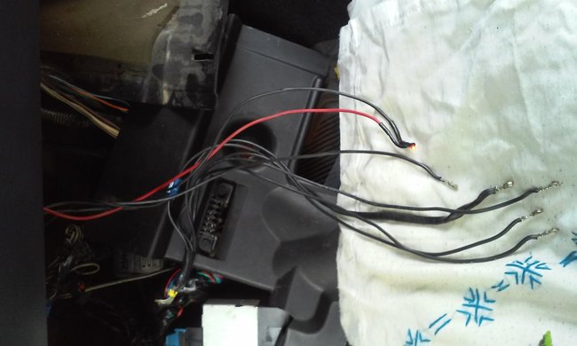

JUANEMMANUEL
  • 63 POSTS
Ok i have a dilema. I disconnected the six little wires going into the slot box you saw in the picture, and they come down under the dash. But i have no idea how they were originally connected. This is what it looks like right now. Any ideas?

JUANEMMANUEL
  • 63 POSTS
Here

  • CERTIFIED EXPERT
  • 53,872 POSTS
You must follow the black wires back to where they connect to the harness and look for the same colors, connect the same color wires together, the car should start. I cant remember if they go to a box or not, the idea is to just remove the whole thing and put the harness back to the way it was.

JUANEMMANUEL
  • 63 POSTS
Sorry for the late reply. Problem fixed!! I didn't actually end up doing anything with those wires that go into that kill switch. This guy came over with a test light (as you originally suggested) and he traced the lack of power all the way to the crazy jungle of wires under the dash. He told me to cut the two big wires that plugged into the aftermarket alarm system/box and splice them together (the way they were originally). I did and she fired right up! However he also found another problem that might've been affecting it too. The negative cable to the battery wasn't grounded properly. When he contacted the big and small terminals on the starter with a screwdriver, he noticed a spark where the negative cable is grounded with a nut to a stud on the ignition control module bracket. It was pretty loose but we tightened it, then i spliced those two cables under the dash, and she lived again. The only downside is that now the alarm doesn't work, but after 3 weeks without my car i couldn't care less. Thanks a lot for all your help. Keep up the good work.
