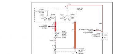

I dont have a schematic for the relay center could u post a diagram showing me the location of the starter relay, maybe I could switch the relay with another and check it.

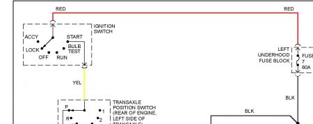

Before you do that have a helper to hold key at starting position and check for power at the yellow wire on the park and neutral switch at rear of engine left side of transaxle-no power here replace the ignition switch its gone

Also check fuse no.7 at underhood fuse block
http://www.2carpros.com/forum/automotive_pictures/12900_ss1_2.jpg
http://www.2carpros.com/forum/automotive_pictures/12900_ss2_2.jpg
Tuesday, October 12th, 2010 AT 8:19 PM
88VETTE88
  • 13 POSTS
Is this the schematic for a 1992 buick lesabre, sorry for the mixup just checked the year it is a 92.
+1
Tuesday, October 12th, 2010 AT 8:41 PM
  • 75,992 POSTS

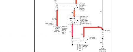

No its not the same-see below and Good LUck

Does a 92 lesabre have a relay that could cause it not to crank over?
Friday, October 15th, 2010 AT 2:16 PM
  • 75,992 POSTS
Did you check the theft deterrent relay if so and its good the problem is coming from the computer-look at the diagram I gave earlier on the starting system
