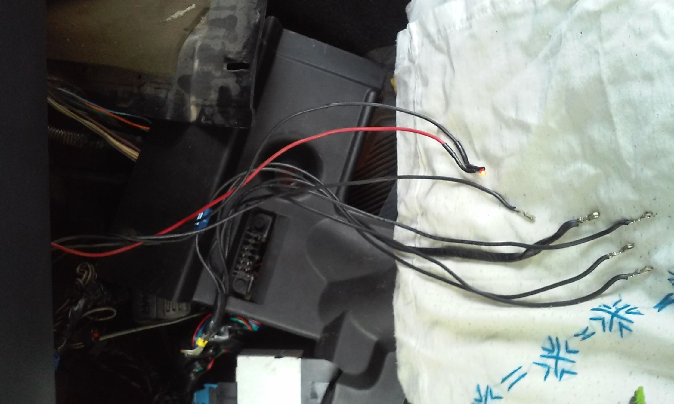

Ok I have a dilema. I disconnected the six little wires going into the slot box you saw in the picture, and they come down under the dash. But I have no idea how they were originally connected. This is what it looks like right now. Any ideas?

Here

You must follow the black wires back to where they connect to the harness and look for the same colors, connect the same color wires together, the car should start. I cant remember if they go to a box or not, the idea is to just remove the whole thing and put the harness back to the way it was.

Sorry for the late reply. Problem fixed! I didn't actually end up doing anything with those wires that go into that kill switch. This guy came over with a test light (as you originally suggested) and he traced the lack of power all the way to the crazy jungle of wires under the dash. He told me to cut the two big wires that plugged into the aftermarket alarm system/box and splice them together (the way they were originally). I did and she fired right up! However he also found another problem that might've been affecting it too. The negative cable to the battery wasn't grounded properly. When he contacted the big and small terminals on the starter with a screwdriver, he noticed a spark where the negative cable is grounded with a nut to a stud on the ignition control module bracket. It was pretty loose but we tightened it, then I spliced those two cables under the dash, and she lived again. The only downside is that now the alarm doesn't work, but after 3 weeks without my car I couldn't care less. Thanks a lot for all your help. Keep up the good work.

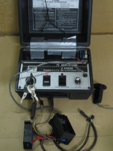

Unfortunately there are no shortcuts to your problem. The chip in the key is a resistor that drops a voltage signal down as it passes through and is then verified as correct before allowing your car to start.
A VATS key interrogator is used to determine if your key or ignition switch (w/anti theft), is at fault. Here is a picture of one.
https://www.2carpros.com/forum/automotive_pictures/435113_vatsInterrogator_1.jpg
It is however likely that your vehicle has the same problem 95% of these vehicles exhibit, that is simply the ignition lock cylinder (w/anti theft) has a broken wire from turning so many times. I do not recommend this for the amateur mechanic and a variety tools, puller lock plate depressor, are required for service.
Have a shop skilled at dismantling steering column take a look at it. It may also be a good idea to check for shops that own this old key test tool also.
