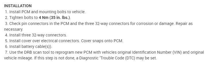

I purchased a new ECM plug it up and my vehicle still shows no BUS and all the little ABS brakes and dash lights are on, gauges not working.
Saturday, October 3rd, 2020 AT 1:39 PM (Merged)
DANNY L
  • 5,648 POSTS
Hello, I'm Danny.
Quick question first. After installation did you you use or have a factory Dodge DRM scan tool used to initiate the module? Otherwise truck with have a code or no start. I've attached a picture below. Hope this helps and thanks for using 2CarPros.

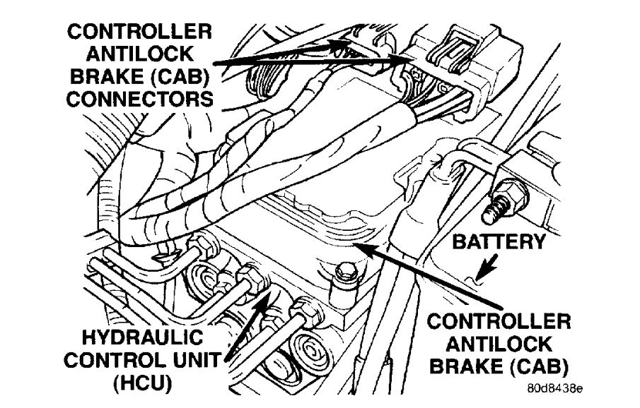

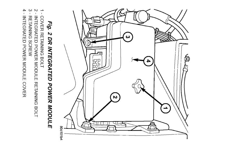

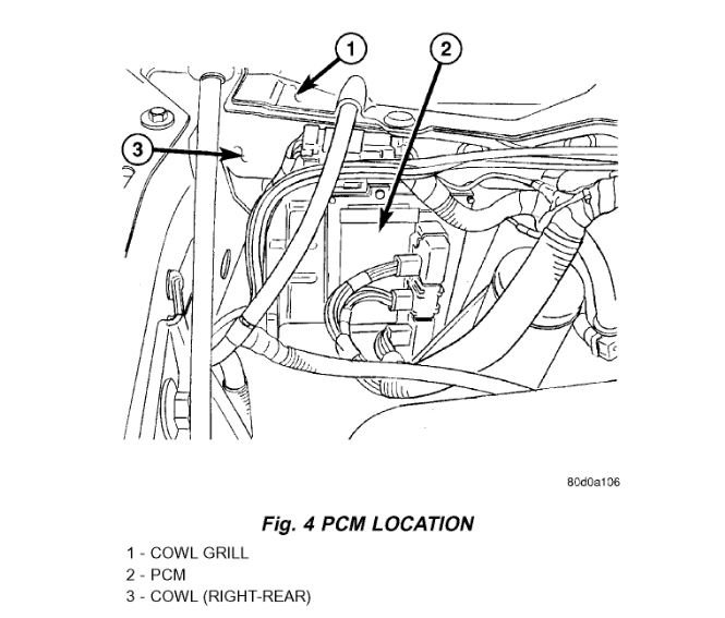

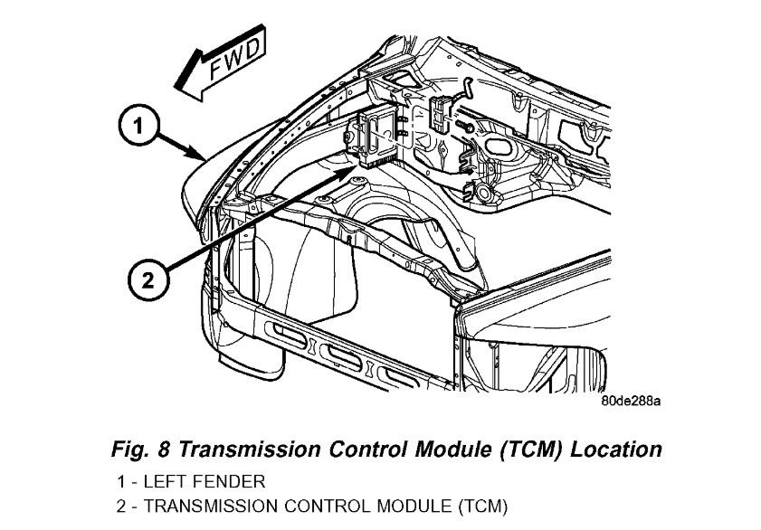

I need to know where the different modules are to try to correct a NO BUS issue.
Wednesday, June 9th, 2021 AT 1:30 PM (Merged)
  • 52,797 POSTS
Good afternoon,
I attached locations of the PCM, TIPM, TCM and the ABS module for you.
+1
