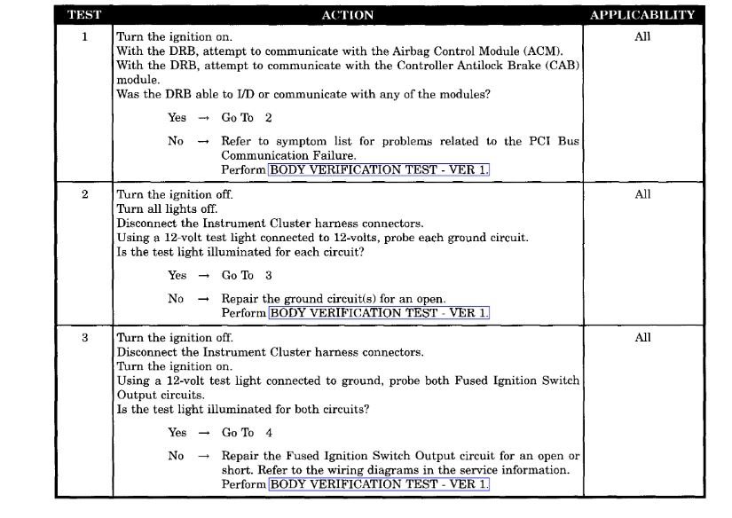

Hi Roy, checked the ones that you suggested all okay. Did self check on dash and it okay. Still have no bu5 showing, no gauges on dash, no brake lights or signal lights. When I check with scanner I can get a tachometer and speedometer but not a good way to drive. Am thinking broken wire but where?
Wednesday, June 9th, 2021 AT 1:30 PM (Merged)
  • 52,797 POSTS

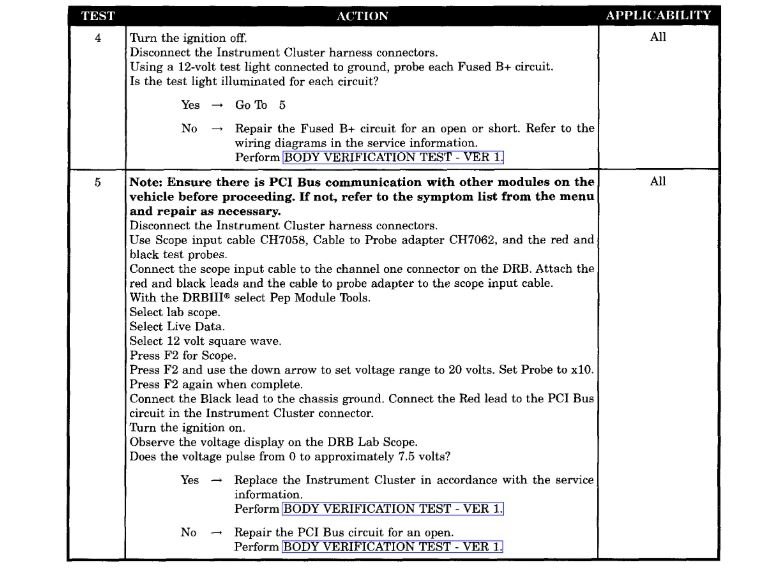

Okay, no BUS possibilities are below and I attached a flow chart for you as well.
SYMPTOM
BUS (+/-) SIGNALS OPEN OR NO RESPONSE FROM INSTRUMENT CLUSTER
POSSIBLE CAUSES
- Attempt to communicate with another module
- Open ground circuit(s)
- Open fused ignition switch output circuits
- Open fused B+ circuit(s)
- Open PCI bus circuit
- Instrument cluster
