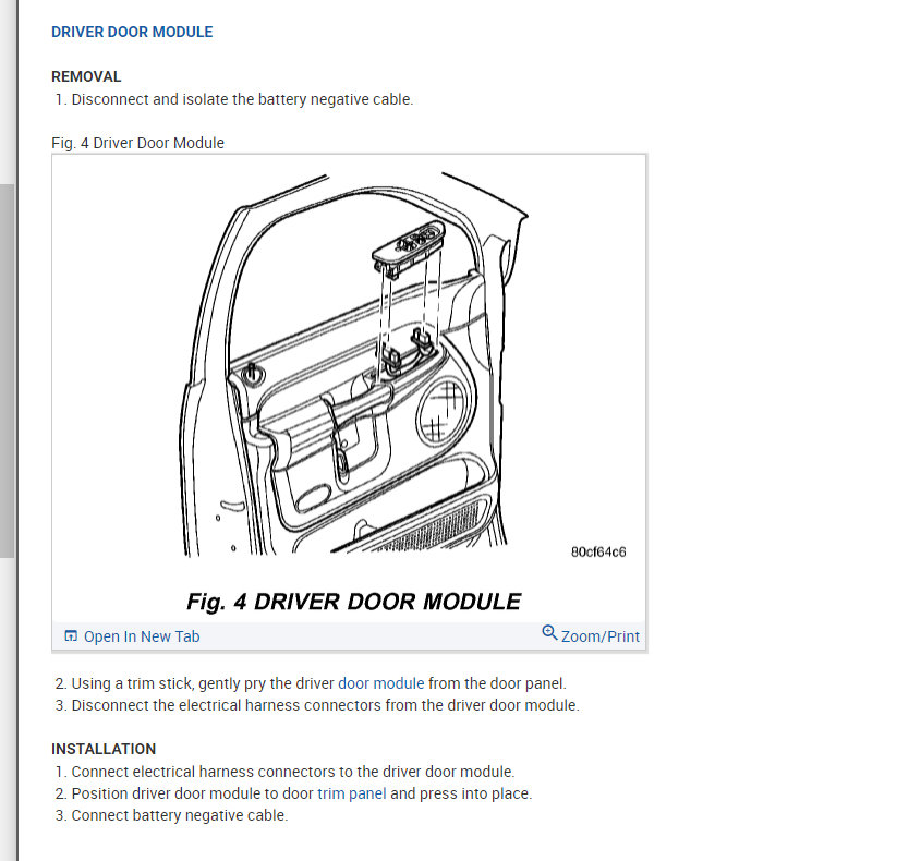

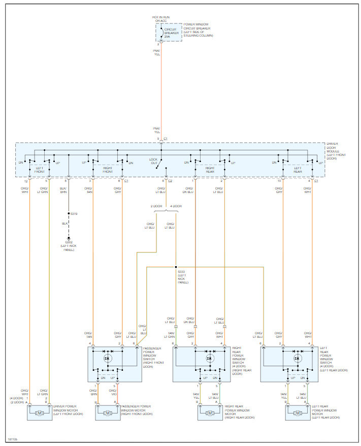

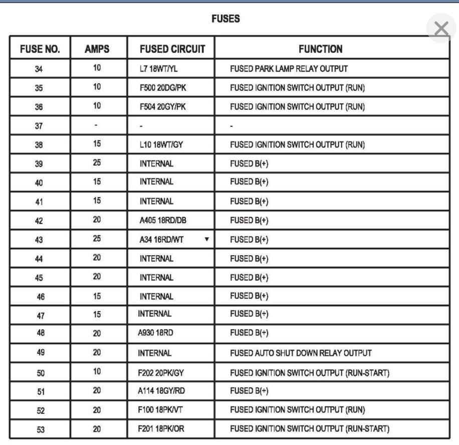

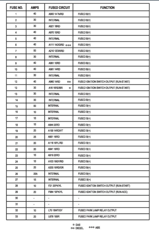

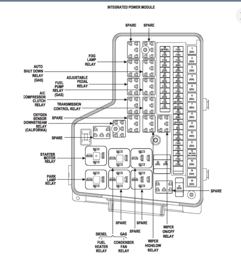

This could be the fuse on the side of the steering column but it could also be the Driver Door module. So check the fuse using this guide:
If that checks out then I would replace the module which is basically just the master window switch bank.
Please run though this material and let us know if you have other questions. Thanks
