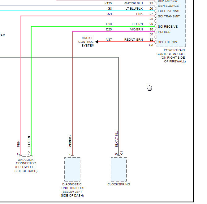

Here is the wiring diagram for the PCI and SCI bus for the PCM. However, just checking for voltage is not going to tell you anything other than the modules have the voltage. What you need is the scan tool to plug into the vehicle and see if you can actually communicate with the modules because this is where the fault is. They are saying they can't communicate so you need to see which module cannot and then start testing. Just testing voltage on this type of BUS is not going to result in much more than frustration. Sorry to not have better information.

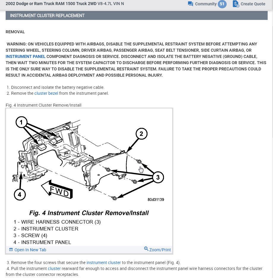

PWBCKTFTII
  • 6 POSTS
Howdy, , I have a similar issue as others I have read here with a twist. When starting the truck when cold I get the no BUS message in the instrument cluster. I understand it mean there's no comm in the CAN BUS. Now here's my twist, if I drive five miles to my local gas station and put gas in the truck and restart it my gauges will work. Though I have the ABS and brake light still on. Different issue I believe. The truck doesn't stall or run poorly. I swapped out what I thought was the PCM and it didn't change anything. The module I changed was the one on the passenger fender with one large connector on it. Is this the PCM? Or is it the TCM? I have and other Module at the same height as the one described but it's on the passenger firewall with three wire connectors on it. What is this module? I replaced the VSS in the rear end and still have the ABS and brake lights on in the dash. It has been suggested I replace the ABS control module, but I want to get the no bus error fixed first. It was also suggested I may have a ground issue. I cleaned the negative cable connections and replaced the braided engine ground with no effect. All connections inspected so far have been clean and tight. Ram 1500 SLT Quad cab if it makes a difference.
Oct 3, 2020 at 1:37 PM (Merged)
  • 54,837 POSTS
We had this problem in the shop a while back and we had to get a rebuilt cluster for it to fix it. here is a video of the job being done in a similar car which diagrams below to show you how on your car:
https://youtu.be/_HEC44xENxw
I doubt that will get the gauges back because that is just the communication wire from the DLC to the module. More than likely you have an issue on one of the harnesses or a connector is not seated or has water intrusion. As you are inspecting the harness, just disconnect the connectors and see if there are signs of water or any green or discolorations in it.

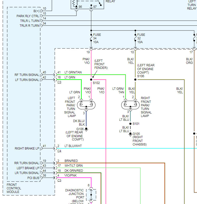

Okay, I noticed that the third brake light is working, as are the reverse lights. The turn signal lights work on dash but not on the front or back lights.
We need to try to stick to one issue per post because if others are having this issue, they will not find it under the heading of No BUS.

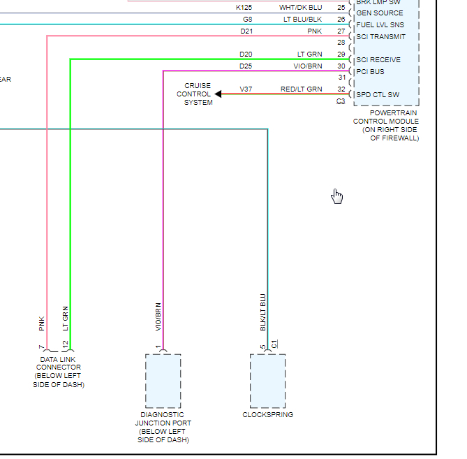

I attached a wiring diagram. If all 4 turn signals are the only thing not working but they work on the indicators, I suspect you have a Front Control Module issue. Unfortunately, there is nothing in common between all 4 lights other than this.

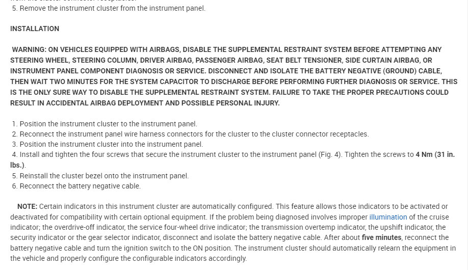

update: replaced Front Control Module and still shows No BU5. Guess I have got to now try replacing the module on the firewall (it is the one with 3 plugs) as I do not know where other modules are or where to go next. Any ideas would be helpful.
Unfortunately, without a scan tool to see if you can communicate with these modules we are just guessing.

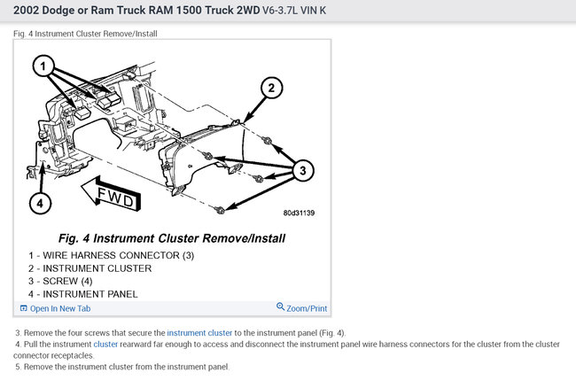

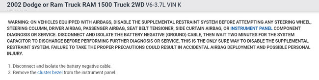

One of the most common causes of this issue is the cluster itself. However, there could be something causing the cluster to be offline like a ground wire or a power wire so I don't want to tell you to just replace the cluster. Not only are they a little pricey but they are not the easiest thing to put in.
If it were me, I would go after the cluster next to try and verify power and ground or replace it before you replace anything else.
Note - Do not get a used cluster because they are programmed when they are plugged in with the VIN. So you can't swap them between vehicles.

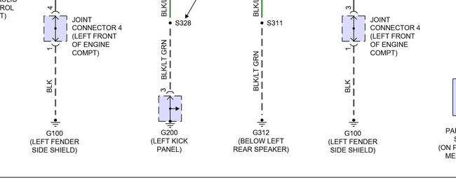

BKAEMPFE1989
  • 36 POSTS
So my problem is in the odometer spot it reads no bus and my check engine light is on I have had 3 different code readers read it and pulls no codes but check engine light is still on I have heard the no bus will make it do that. The truck seems to run fine gauges work it doesn't die randomly nothing out of the normal but I have no clue what to do my tags are out and I can't get inspection with the light on I would appreciate help I am a younger guy with not enough money to take it to I dealership
Oct 3, 2020 at 1:38 PM (Merged)
HMAC300
  • 48,601 POSTS
the code readers you are using are probably form an auto parts and won't read that you need this video. https://youtu.be/InIlnsjOVFA
BKAEMPFE1989
  • 36 POSTS
I had auto zone read it and 2 mechanics and one of them had the really big nice snap on one said it was a high dollar code reader he didn't know why it wouldn't pull anything up but for me to have them run through my truck and have them run test it is 100 dollars just to diagnose
HMAC300
  • 48,601 POSTS
I really don't know what to tell you however check the grounds in the pic plus the one at center of dash and front of engine, that means making sure they are clean and not corroded. also take the cluster out smack it a few times with your hand and then put it back in some guys have had luck with that because cluster controls bus voltage also check battery for condition including load test
BKAEMPFE1989
  • 36 POSTS
Ok thank you anyways for trying and could you send pics one more time they didn't show up on last message
HMAC300
  • 48,601 POSTS
I forgot to send it sorry it's only one. but try smacking the cluster first like I said only thing you'll have to remove it.
