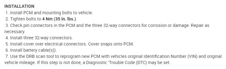

CHARLES OLDEN
I purchased a new ECM plug it up and my vehicle still shows no BUS and all the little ABS brakes and dash lights are on, gauges not working.
Oct 3, 2020 at 6:39 AM (Merged)

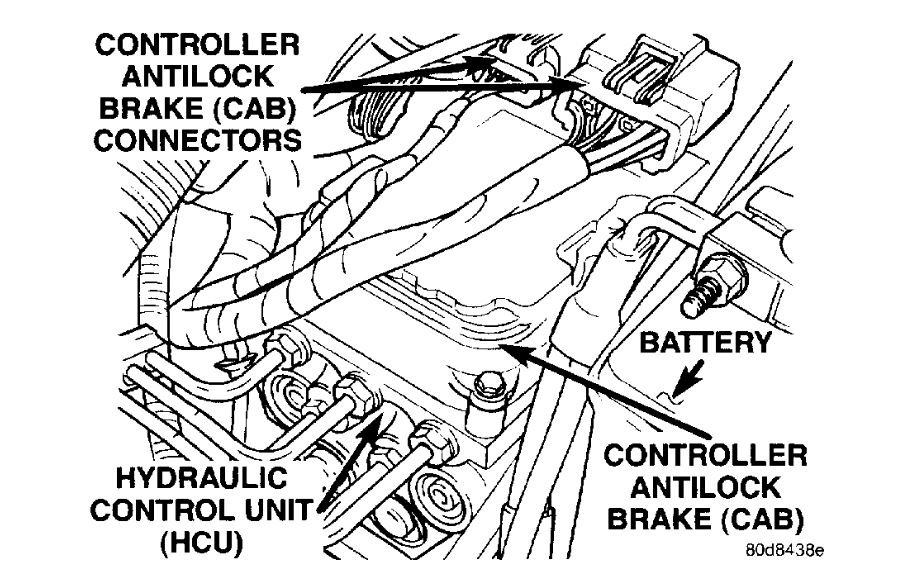

DANNY L
  • 5,648 POSTS
Hello, I'm Danny.

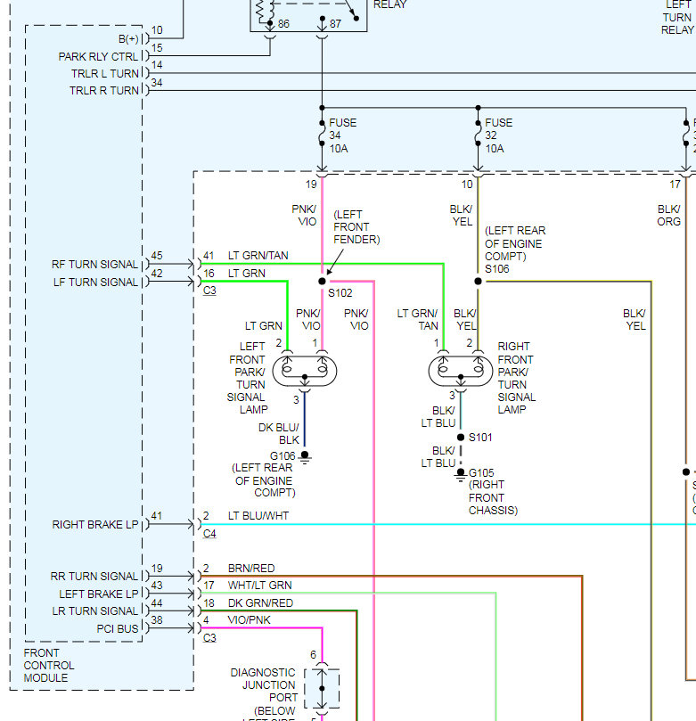

Quick question first. After installation did you you use or have a factory Dodge DRM scan tool used to initiate the module? Otherwise truck with have a code or no start. I've attached a picture below.Hope this helps and thanks for using 2CarPros.

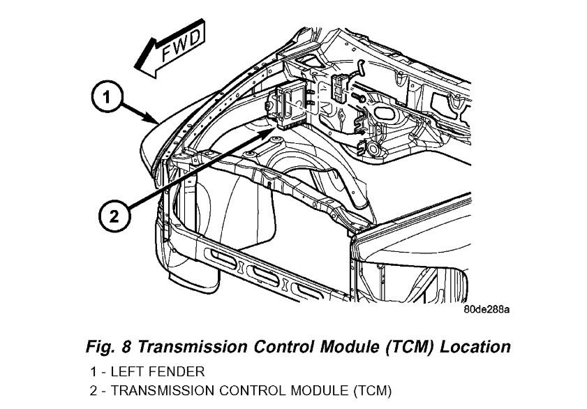

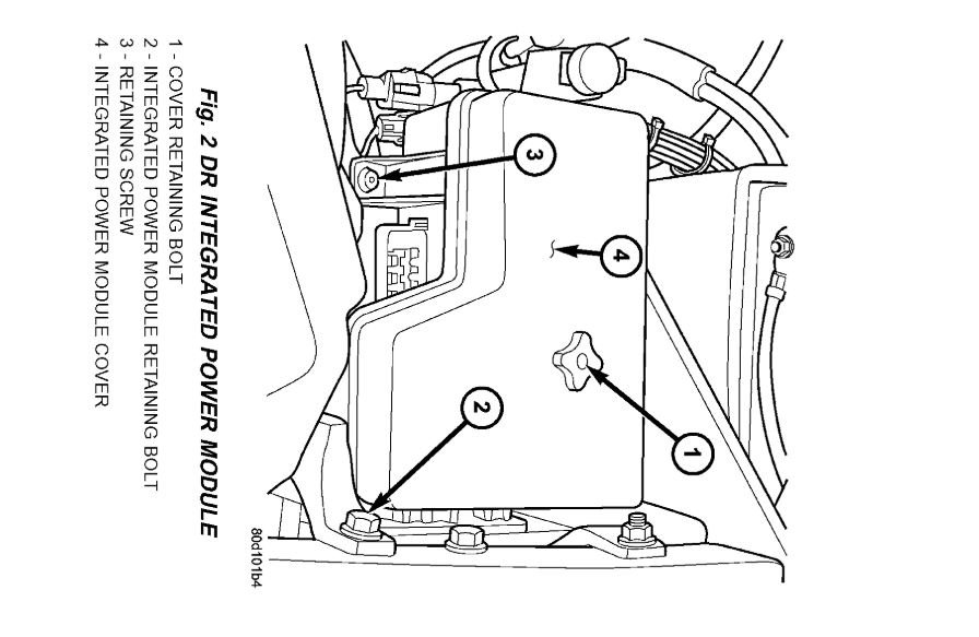

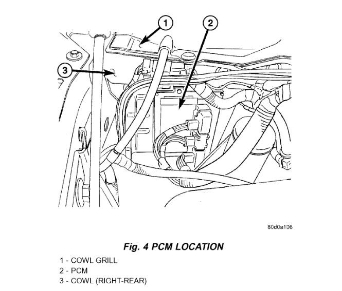

I need to know where the different modules are to try to correct a NO BUS issue.
Jun 9, 2021 at 6:30 AM (Merged)
Good afternoon,
I attached locations of the PCM, TIPM, TCM and the ABS module for you.

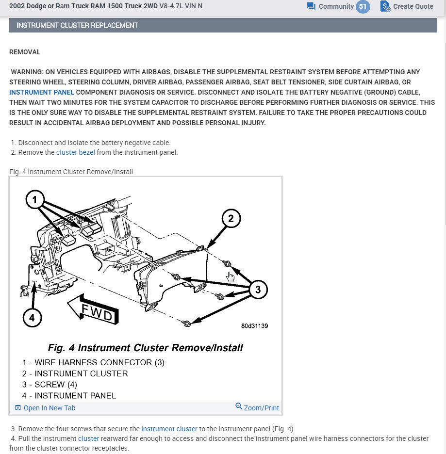

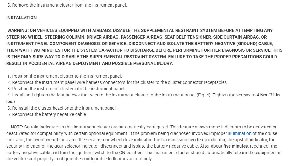

The instrument cluster is a module but if it was an issue, you would have functions in the cluster that would not work.
Start with the ones I listed.

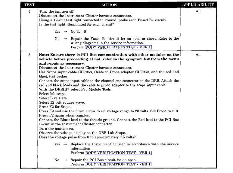

Hi Roy, checked the ones that you suggested all okay. did self check on dash and it okay. Still have no bu5 showing, no gauges on dash, no brake lights or signal lights. when I check with scanner I can get a tachometer and speedometer but not a good way to drive. Am thinking broken wire but where?

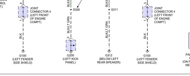

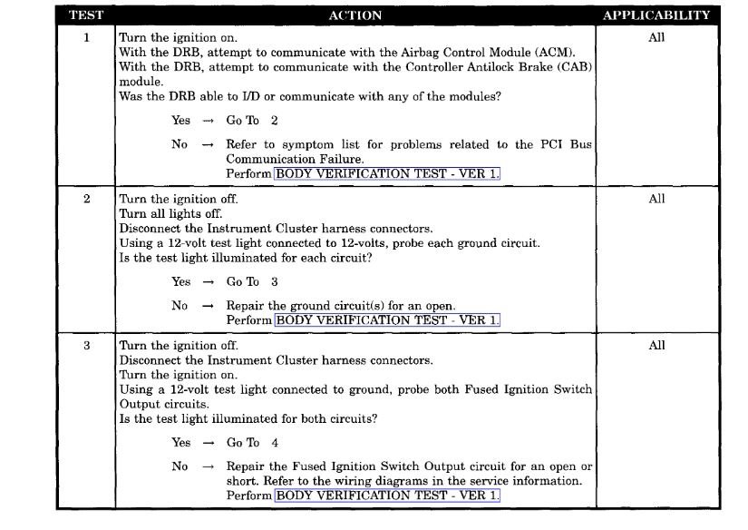

Okay, no BUS possibilities are below and I attached a flow chart for you as well.
SYMPTOM
BUS (+/-) SIGNALS OPEN OR NO RESPONSE FROM INSTRUMENT CLUSTER
POSSIBLE CAUSES
- Attempt to communicate with another module
- Open ground circuit(s)
- Open fused ignition switch output circuits
- Open fused B+ circuit(s)
- Open PCI bus circuit
- Instrument cluster
