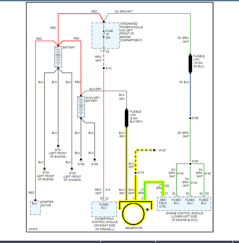

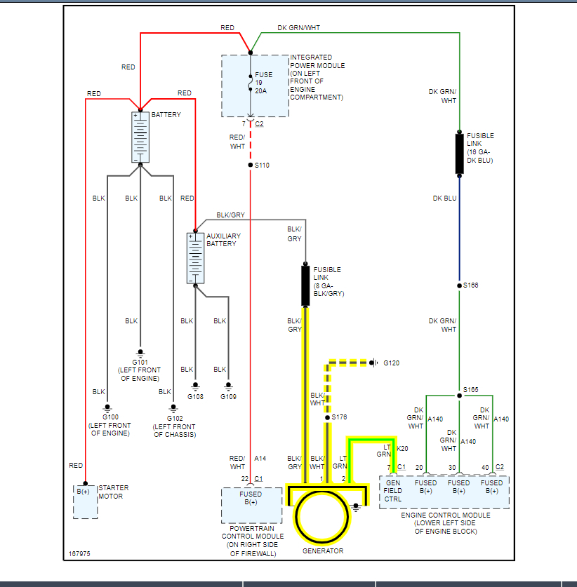

Good morning,
The first thing I would check is the battery. Make sure they have 12.6 volts in each battery. If not, then charge them up.
https://www.2carpros.com/articles/how-to-charge-your-car-battery
Check the charging system as well. It should be 14 to 14.5 volts running. If you do not have that, the alternator may be the issue.
https://www.2carpros.com/articles/how-to-replace-an-alternator
I also attached a wiring diagram of the alternator as well for you to view.

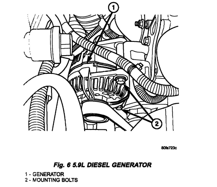

REMOVAL
Warning: disconnect both negative cables from both battery before removing battery output wire (b+ wire) from generator. Failure to do so can result in injury or damage to electrical system.
1. Disconnect both negative battery cables at both batteries.
2. Remove generator drive belt.
3. Unsnap plastic insulator cap from B+ output terminal.

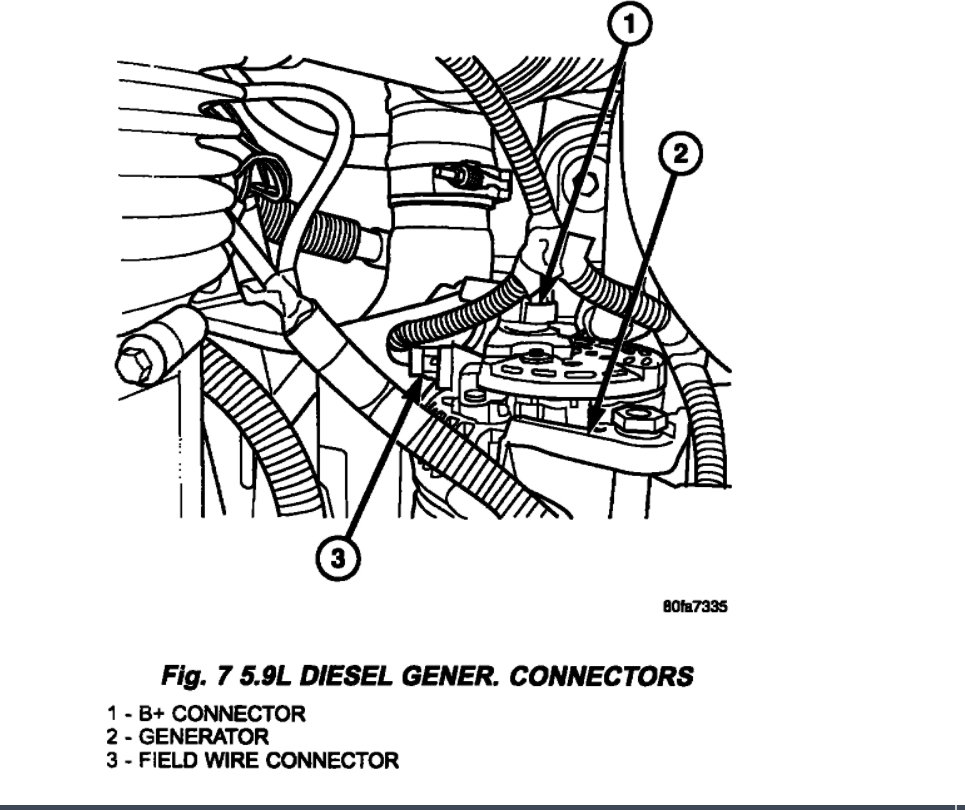

Fig. 7 Diesel Generator Connectors
4. Remove B+ terminal mounting nut at rear of generator. Disconnect terminal from generator.
5. Disconnect field wire connector at rear of generator by pushing on connector tab.
Fig. 6 5.9L Diesel Generator
6. Remove upper mounting bracket bolt.
7. Remove lower mounting bracket bolt and nut.
8. Remove generator from vehicle.
INSTALLATION
1. Position generator to upper and lower mounting brackets and install upper bolt and lower bolt / nut.
2. Tighten all bolts / nut to 41 Nm (30 ft. lbs.).
3. Snap field wire connector into rear of generator.
4. Install B+ terminal eyelet to generator output stud. Tighten mounting nut to 12 Nm (108 in. lbs.) torque.
CAUTION: Never force a belt over a pulley rim using a screwdriver. The synthetic fiber of the belt can be damaged.
CAUTION: When installing a serpentine accessory drive belt, the belt MUST be routed correctly. The water pump will be rotating in the wrong direction if the belt is installed incorrectly, causing the engine to overheat.
5. Install generator drive belt.
6. Install both negative battery cables to both batteries.

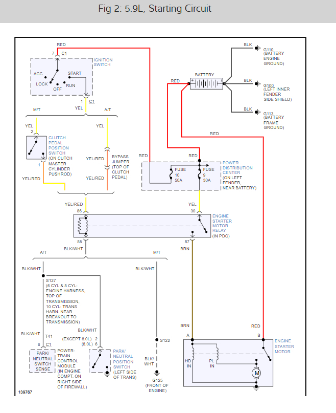

RUSTY0080

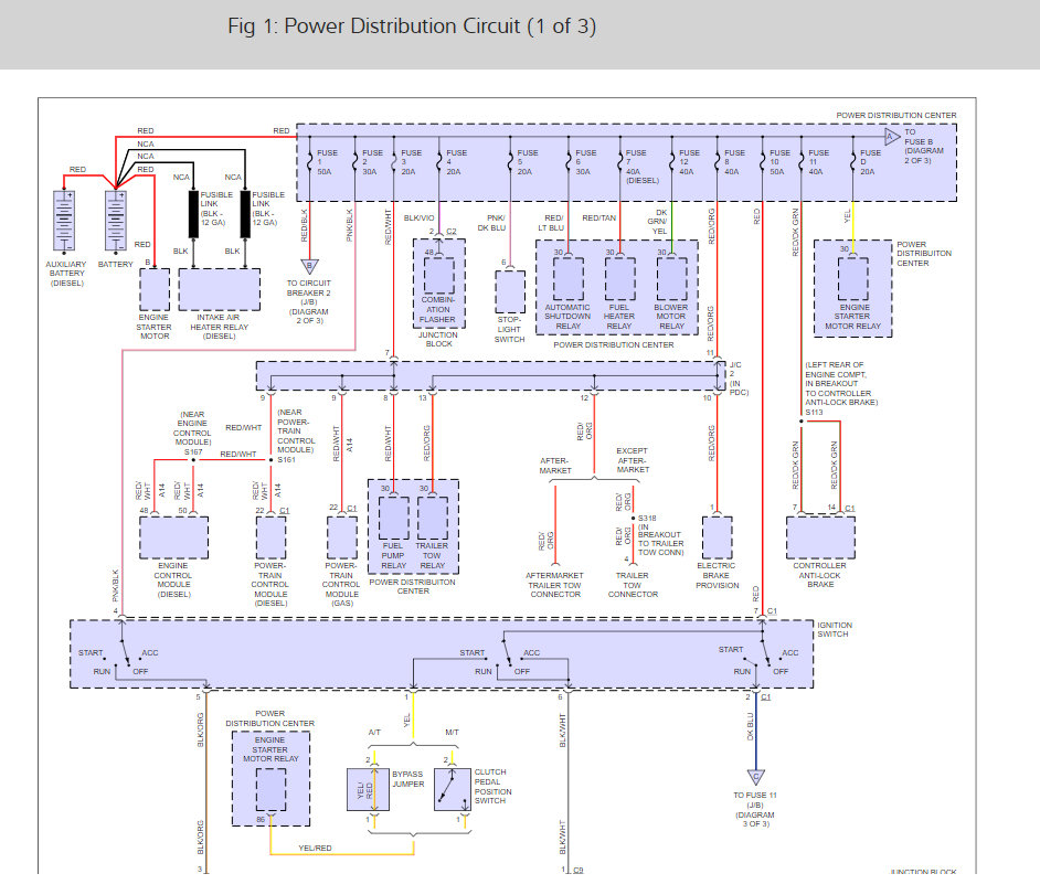

went to start my truck the other day and everything seemed normal for about a second or two then everything cut off. I turned the key again and got nothing. Battery is reading fine, the starter and solenoid tested fine, and the ignition switch is fine (replaced with new). I checked all fuses and they are fine. When I turn the key to any position, there is no power to windows, locks, radio, and no readings on any gauges. There are also no warning chimes(door ajar, headlights, etc...) When i turn the key back to off and pull the key out, there is a clicking sound at the CTM under the steering column. Could this be the culprit? Is there any chance it could be something simpler like a relay? Im suspecting either CTM or PCM but I really don't have a clue except for what I have read. Is this a dealership only fix?
Jun 23, 2021 at 12:07 PM (Merged)
HMAC300
  • 48,601 POSTS
the wiring is the same on both engines. I'm including a picture as it could be a fuse or relay in the power distribution center on the lh fender well. the diagram will show what i mean. Check out the diagrams (Below). Please let us know what happens.

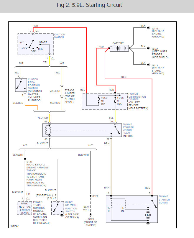

MANDMTIPTON
Battery is good (12.51Volts), and truck will not start or jump start. When I turn the key, no power turns on. no dash lights, no headlights, no buzzer. No power. I guess there is a main fuse? but cant find one on the motor side fuse panel. Where is the main fuse? or what other part may have died?

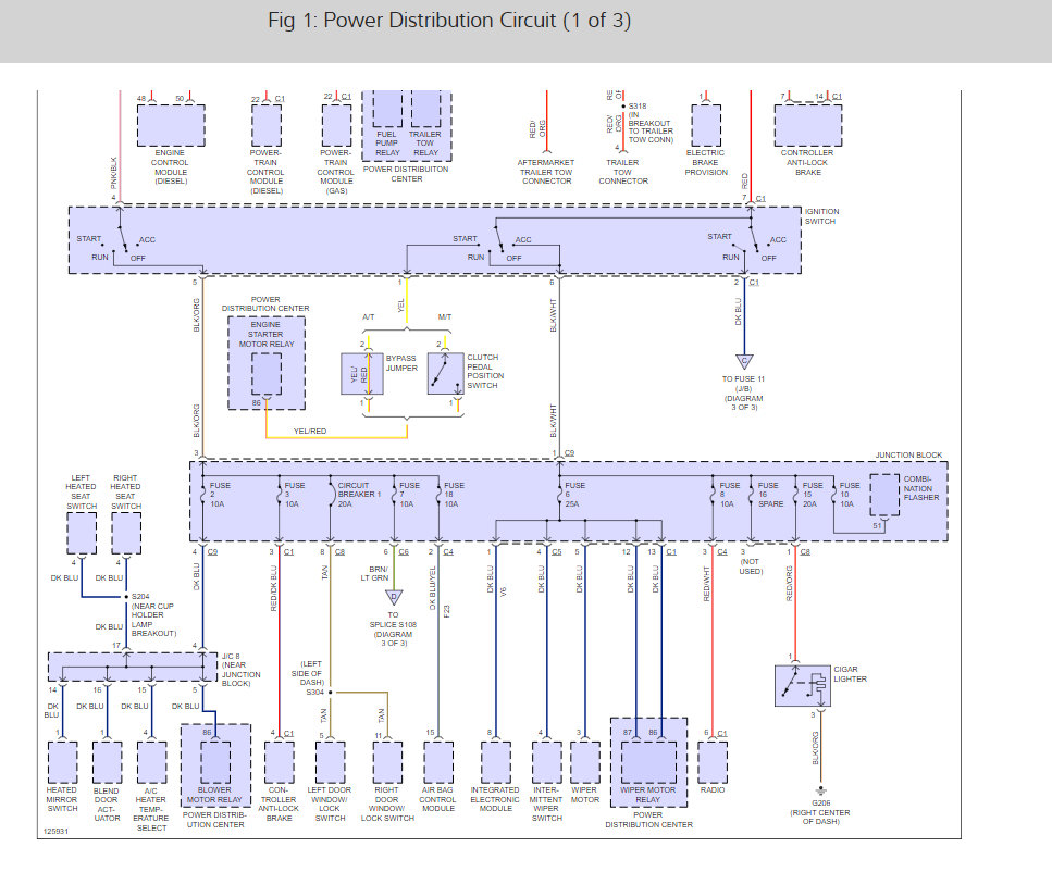

  • 110,241 POSTS
First, make sure the battery terminals are both clean and tight. Make sure there is a good ground to the engine block. Make sure the power supply to the power distribution box isn't damaged. Here is are two guides to help us find the problem with diagrams below on the fuses that need to be checked.
and
Test through the ignition switch as well
Check out the diagrams (Below). Please let us know what you find. We are interested to see what it is.
