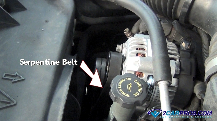

2. The serpentine belt will need to be removed. Locate the belt tensioner and hold reverse tension against it using a wrench, socket or breaker bar. This will allow the belt to be removed from the alternator pulley. Once the belt has been removed inspect it for cracks and glazing because now would be a good time to replace it with a new one.

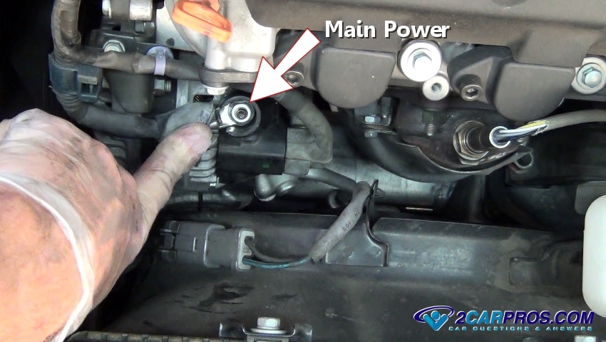

1. Begin by removing the dust boot from the main power terminal to expose the main power wire. If the wiring is difficult to access you will be able to disconnect it once the alternator is loose from the engine. All alternators are designed with a main power cable (large gauge) that is connected directly to the battery or the under hood fuse panel for main charging purposes.
alternator main power

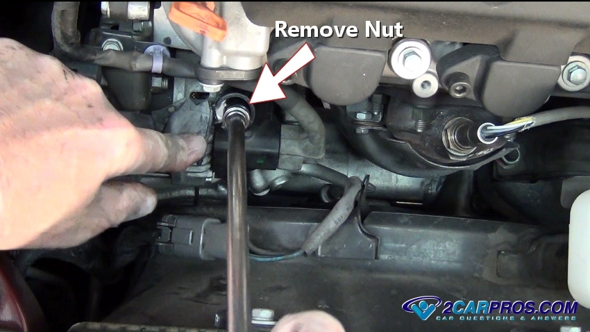

2. Use a socket or wrench to remove the nut by turning it counterclockwise. After the nut has been removed grasp the main power cable and lift it from the alternator charge terminal.
remove nut mian power alternator

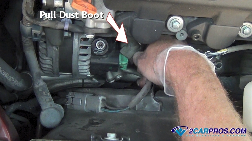

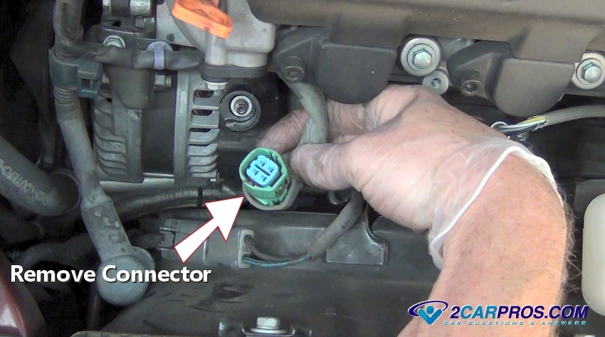

3. Locate the control and monitoring wiring harness connector. Grasp the dust boot and pull it back enough to access the connector safety clip. Some vehicles do not have a dust boot.
pull dust boot back

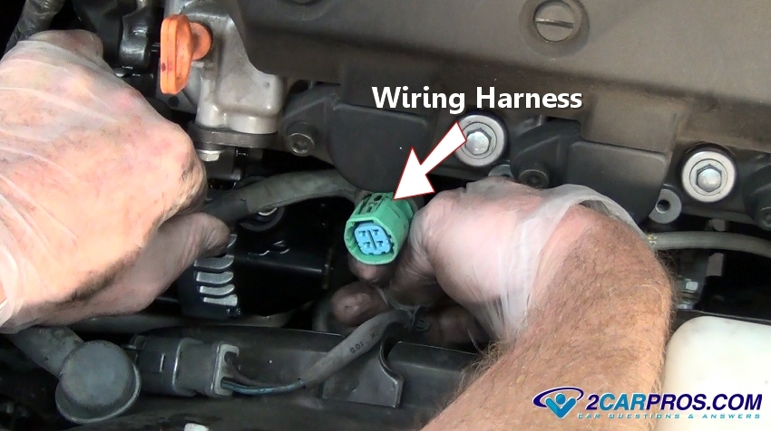

4. While releasing the safety clip on the side of the connector gently pull to outward to remove the wiring harness. These connectors can be a little stuck because of the weather seal which you might need to wiggle to help remove it.
remove wiring harness alternator

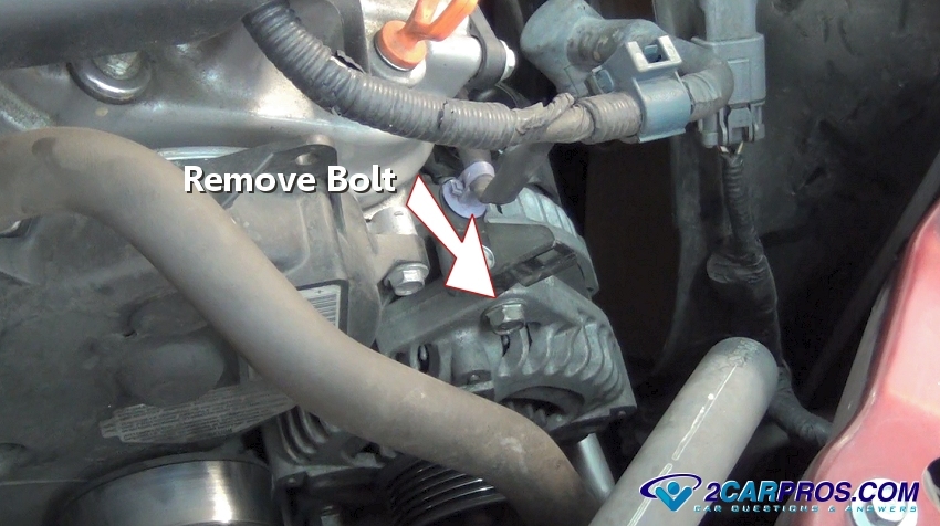

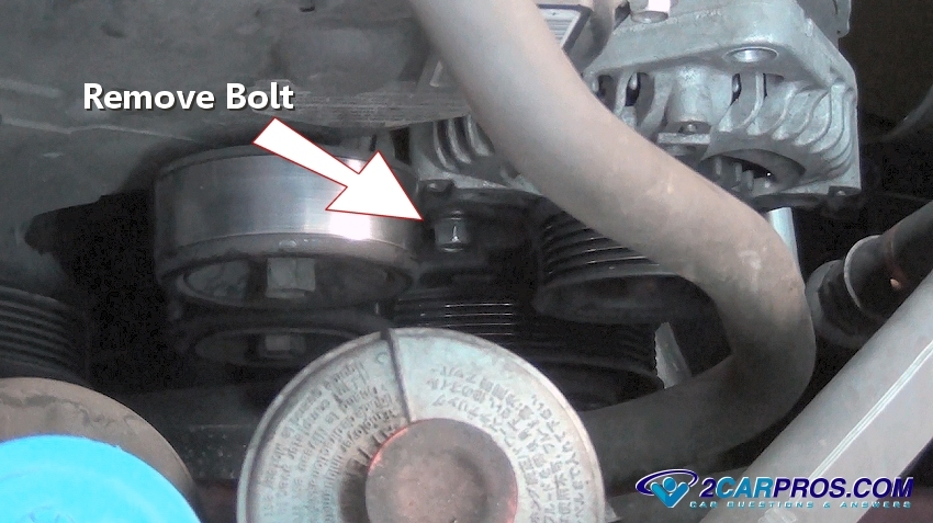

5. Clear any hoses or wiring by removing mounting bolts or screws. Once completed use a wrench or socket to remove the upper mounting bolt and bracket.
remove alternator pivot bolt

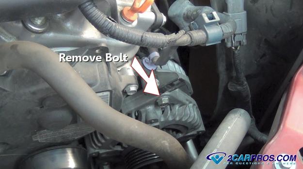

6. Locate and remove the lower alternator mounting bolt. This bolt can be tight so keep a good grip on the wrench or socket while placing the wrench or socket firmly on the head of the bolt to avoid rounding the bolt head.
remove alternator mounting bolt

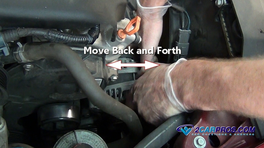

7. After the mounting bolt has been removed grasp the unit and move it back and forth while pulling upward. This will help release the press fit (lower mounting bracket) used to hold the alternator in place.
move alternator back forth

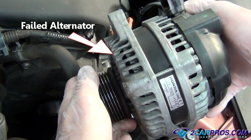

8. Once the old unit becomes loose in the engine bay get a good grip in on it to gently lift and remove it, this step can take some trial and error while rotating the unit. Also, you may need to loosening a fan shroud or radiator hose to finish the removal.
failed alternator

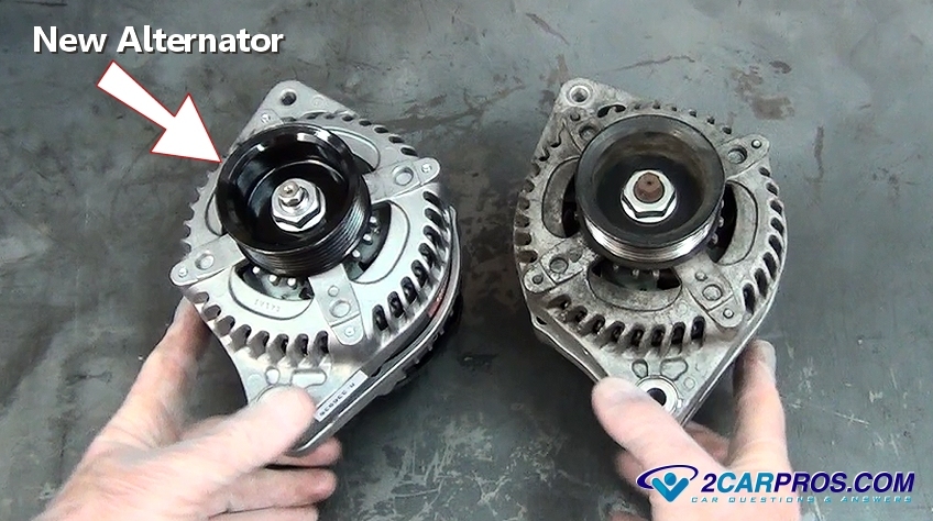

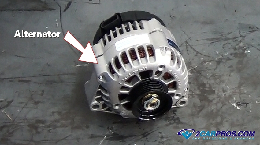

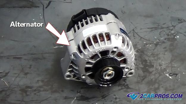

9. Once removed, check the old assembly to the replacement unit. Compare the electrical plug, mounting bolt locations and pulley size to ensure a proper installation. Also count the serpentine belt grooves on each of the pulleys, they should be the same.
new alternator

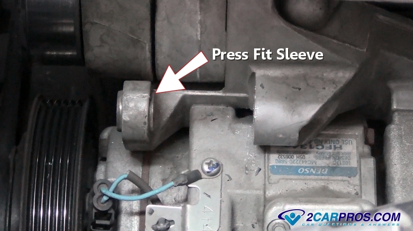

1. The lower mounting brackets include a press fit sleeve that must be forced slightly outward to make room for the replacement unit. This step is important because installing the new unit would be very difficult if not impossible without this step.
press fit sleeve

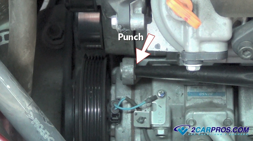

2. Use a large punch or metal bar to gently hammer the sleeve outward. This can take a little finesse, stay with it because it only needs to be moved a little bit to get new alternator installed.
punch alternator bracket

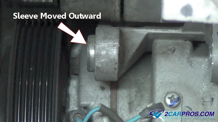

Here is a close up shot of what the job should look like when completed. Now the lower boss of the alternator housing will slip onto position easily.
sleeve moved outward

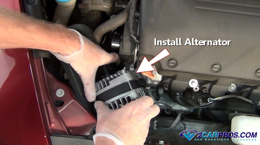

3. Gently lower the replacement alternator into the engine bay while being carefully not the damage any of the surrounding components such as the radiator. The radiator core is made of thin aluminum and it can be easily damaged which would take the fun out of the job if you cause a leak.
install alternator

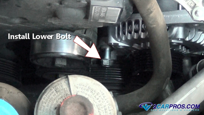

4. Once the alternator is in its lower mount, reinstall the lower mounting bolt. Leave the bolt hand tight until the installation of the upper bolt. If you tighten the lower bolt first the upper bolt might be difficult to install or it can bind which will cause the bolt to strip out.
install lower bolt

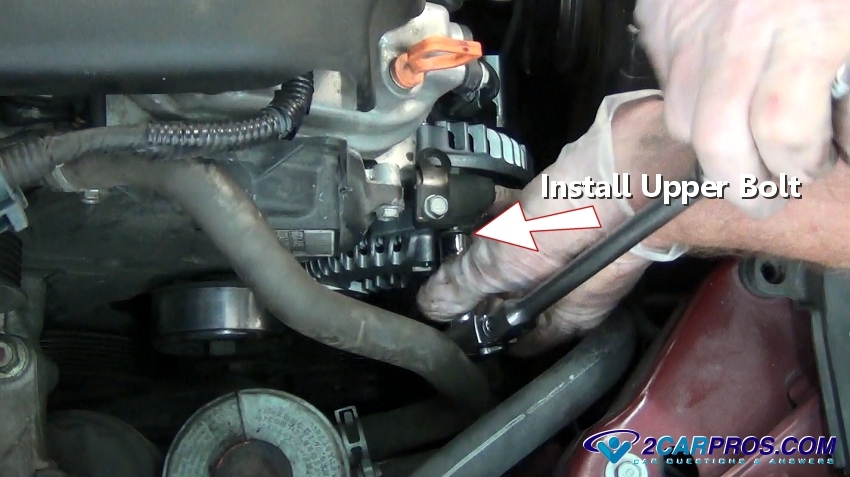

5. Hand thread in the upper mounting bolt and tighten, next tighten the lower bolt as well. These bolts need to be snug, but don't over tighten which can cause the bolts to strip out especially the upper mounting bolt because of its smaller size. Usually the lower bolt torque specification is 22-24 pounds while the upper bolt torque specification is 13-15 pounds.
reinstall upper alternator bolt

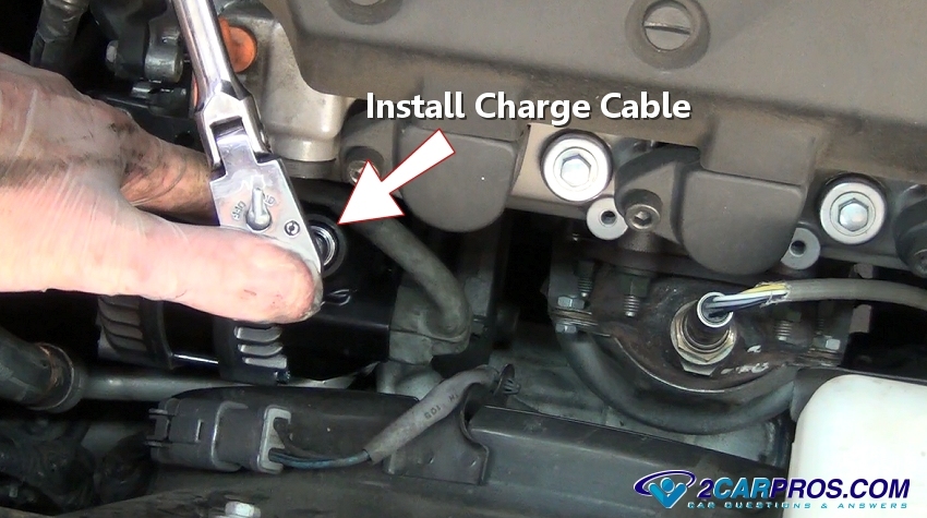

7. Reinstall the main charge cable and mounting nut, gently tighten the cable into place and do not over tighten. This electrical terminal this made of a hard plastic and is used as an insulator which can break causing an internal short hindering the charging operation. Reinstall the rubber weather boot to keep any moisture from entering the connection which will cause corrosion and more problems further down the line. If the wring harness has mounting clip reinstall them to keep the harness from wearing through and eventually connecting to ground which will blow the charging system fuse and possibly damage the new alternator.
install alternator charge cable

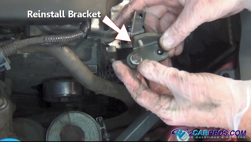

8. Reinstall any hoses or brackets removed in the replacement process.
reinstall alternator bracket
