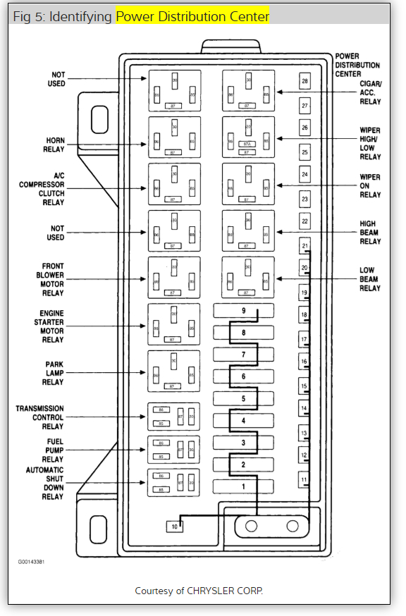

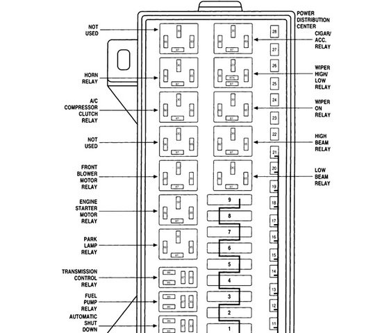

DOCFIXIT
  • 18,828 POSTS
At coil is there 12v+ on Dark green/orange at the coil, I would check the ASD relay which are common to go out. Here is a guide and the relay location below.
Check out the diagrams (Below). Please let us know what you find. We are interested to see what it is.

DOCFIXIT
  • 18,828 POSTS
In engine compartment box find ASD relay also fuel pump relay. Swap relays if you get spark then replace ASD relay.

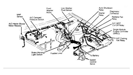

asd relay where is it located on vehicle thanks
Oct 22, 2018 at 11:08 AM (Merged)
BMRFIXIT
  • 19,053 POSTS
Auto shutdown relay is at the fender left side
https://images.2carpros.com/forum/automotive_pictures/99387_asd_88_1.jpg
check /replace the crank sensor
