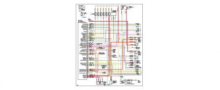

Replaced cam sensor--crank sensor--coil pack and still no spark. The dark green/orange wire to coil pack has power momentarily when key is turned on (11.4 volts) but no power after key is on for a second and left on (put my meter on MAX reading to capture the voltage.
Anyone have any idea of why no spark?

Hi rudysalazar, Welcome to 2carpros and TY for the donation
Inspect and test the ASD relay it powers the colis thru the dark green and orange wire

Where can I find this relay? And how can I see the schmatic better that you attached to last message?
Thursday, June 10th, 2010 AT 8:01 PM
  • 75,992 POSTS
Its in the power distribution box and give me your email addy for the EWD
