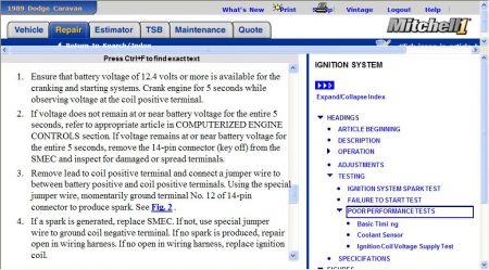

No snapping blue spark continue to troubleshoot the ignition system-power input to the coil/coil packs, coil's resistances, cap and rotor, distributor pick-up coil, ignition control module, cam and crank sensors and computer Note: If it doesn't apply disregard it and keep testing

As far as spark, do you have primary voltage at the coil, engine cranking, probable dark green wire with orange tracer. Same wire at the fuel injectors. That voltage comes from asd relay, the relay may not be faulty, maybe no ground for some reason? Any applicable mil codes?

U NEED A TEST LIGHT OR VOLT METER
key on u shuold have battery power on the coil wire s
place the test light clip on battery + and have a helper crank for u whill u testing the coil if light flash coil no good if no flash its not the coil
check relay s
also crank sensor
good luck

Engine cranking, check primary voltage at the coil and fuel injectors. If no voltage, look for an rpm signal.
Check for applicable trouble codes. You should be able to check mil codes yourself. You cycle the on--off, on--off, on, then the mil starts flashing, you count the flashes to get the codes. Your looking for two digit codes.

Check fuses and ASD relay
check and suspect crank sensor located at the bell housing
check timing
