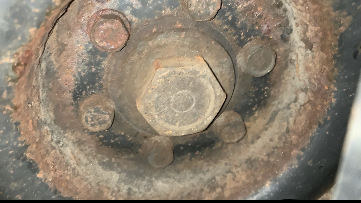

Hey, what size is this?

Image is for the above question.

It looks like one inch, but it is tough from a picture. Did you get the engine running?

I did not. It ended up being a 1 1/4 (32mm). Me and my dad are doing the timing today when I get off of work. I pray she starts up, thank you for all your help. I’ll let you know how it goes.
