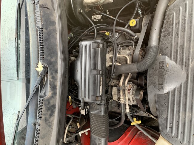

Hey! I got an old Ram and I recently did a tune up. My dad hasn’t done it for 7-8+ years and the plugs were shot. Surprised, it even ran as long as it did. Two wires were burned, and the distributor has marks everywhere. Terrible condition really. Anyway, the truck doesn’t run. It cranks perfectly. Fuel pump turns on. The tachometer moves so I don’t think it’s a sensor or anything. I double and triple checked the firing order and distributor rotor.
18436572 and clockwise rotation rotor. Button on wire 1. I really have no idea why it’s not starting. I’ve read things about TDC and like the timing chain but I’m not sure. Truck ran before doing this tune up.

This is the video of it cranking. I’ll start looking at those guides, and by the way I don’t have any testing tools for sparks or electricity. That was my next purchase, I’m still relatively new to the DIY mechanic stuff, lol.

No problem and thanks for the video, we can walk you through this repair. I would do a compression test because the engine sounds like it might be damaged, like the timing chain could be bad.

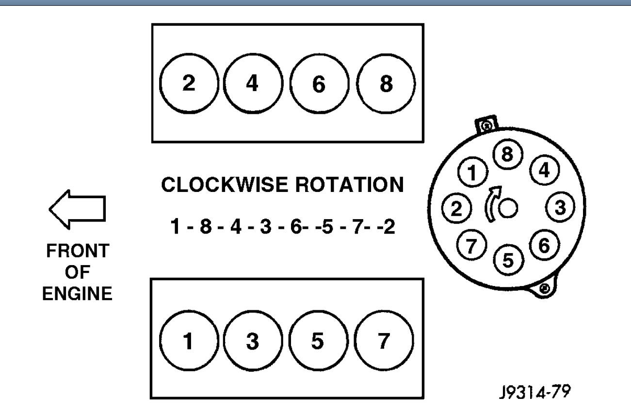

I’m about to do the tests but just to clarify the firing order, just in case. Using the photo here…
The 4 cylinders on the right side of the engine where the battery is, is 1357.
And the 4 cylinders on the left side of the engine where the intake is, is 2468.

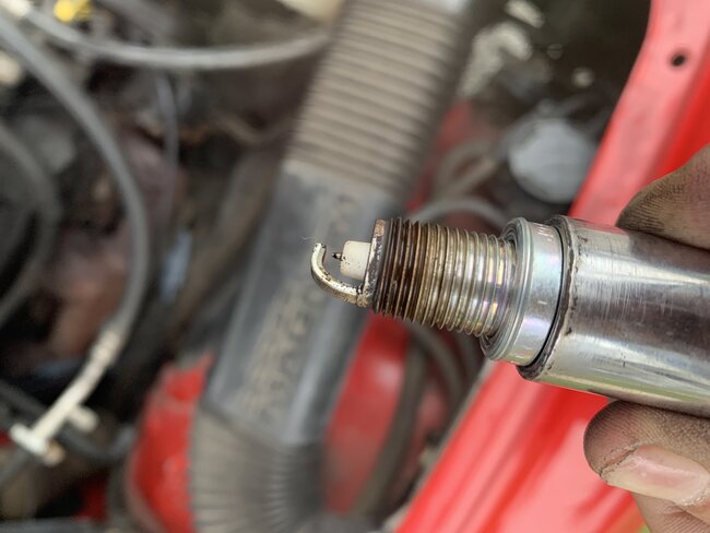

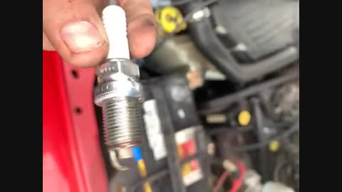

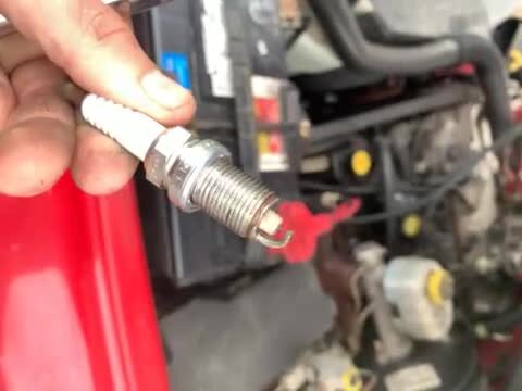

Okay, so, while preparing my compression test undoing all of the plugs, all of them have this look to them, I guess from cranking it to get it started?? Note that these are brand new NGL platinum plugs.

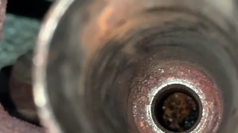

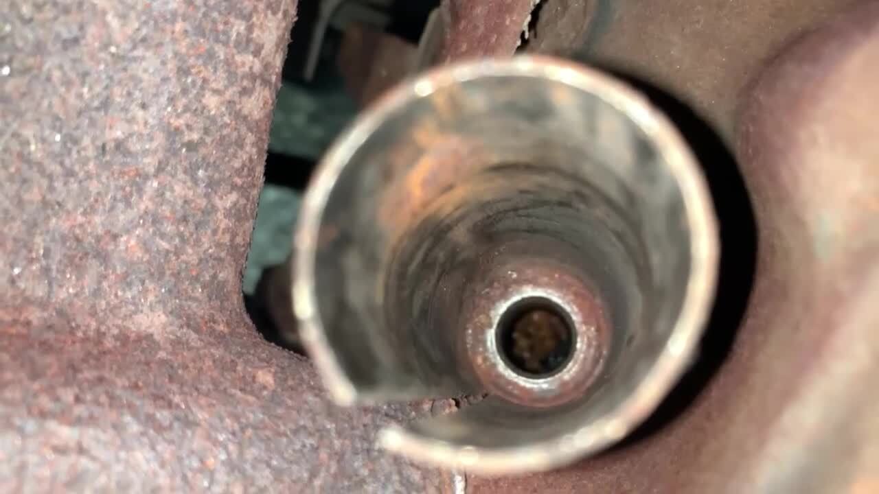

Put my camera in my cylinders. Here’s cylinder 2.

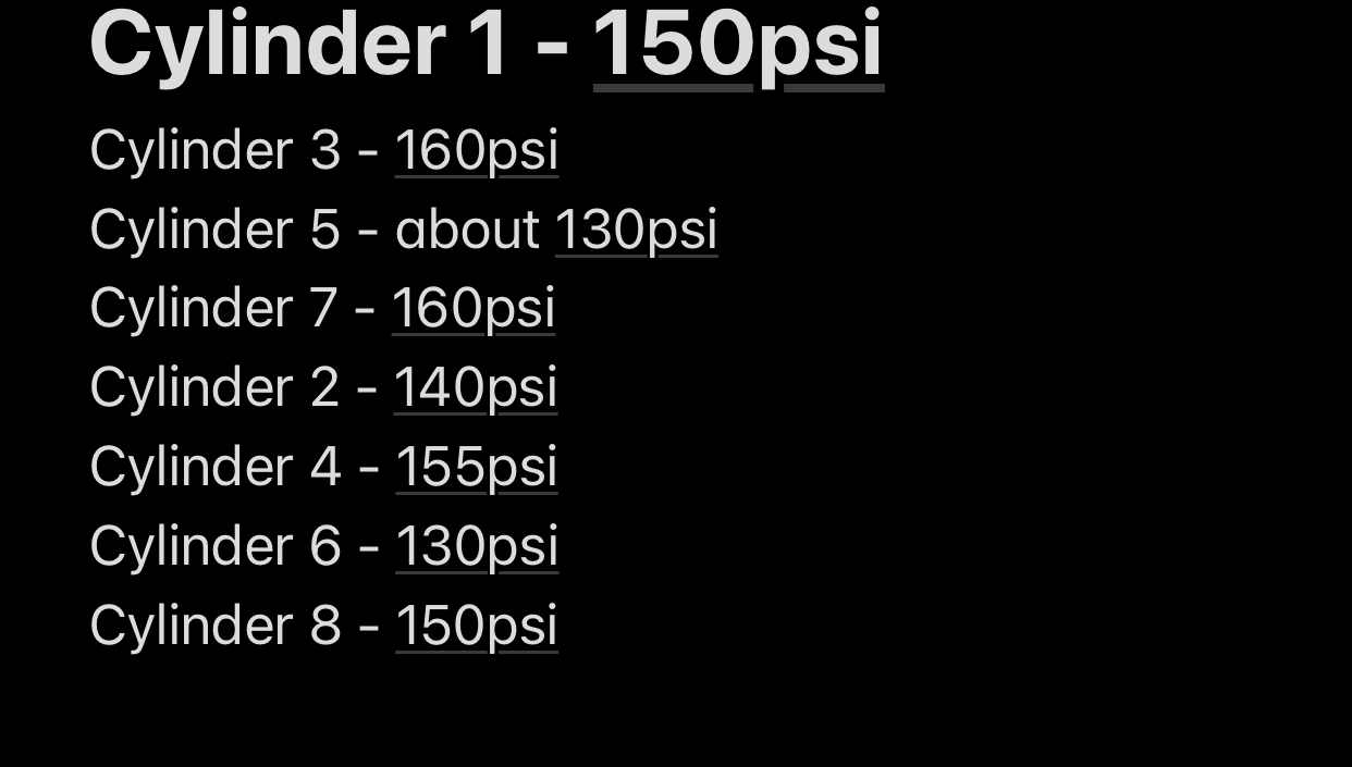

Here’s my compression test. 4 revolutions per cylinder. My cylinder 5 read 110 and then I retested and it read 130. Not sure.

Quick edit, I know I posted a lot but here is my cylinder 2 there’s something inside of it. Something yellow or something?

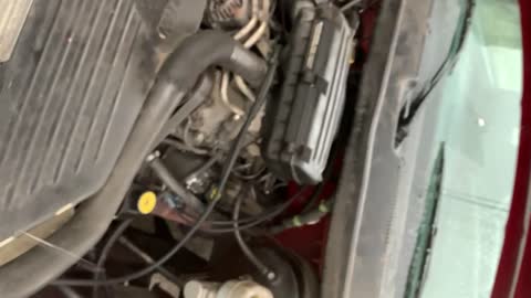

Hey, I just attempted to start my truck with 2 rounds of starter fluid. 1st round didn’t work, just some popping sounds and the 2nd time we tried, it made a big pop sound and blew flames out of the throttle body and was smoking a bit. Why’s it firing and igniting like that? I wish I got a video of it.

Thanks for the images and videos. Yep, this is a sign the firing order is incorrect, here is how the speak plug wires should be one the distributor. Check out the images (below). Please let us know what happens.

This is exactly how my distributor and plugs are set up. 100%. I did my distributor myself. Should I find TDC and set timing?

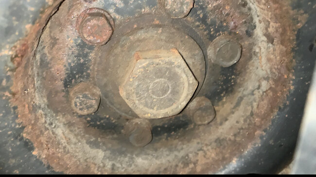

Hey, what size is this?
Oct 4, 2022 at 8:49 AM
BRENDON MISKIMON
  • 25 POSTS
Image is for the above question.
Oct 4, 2022 at 8:50 AM
  • 55,797 POSTS
It looks like one inch, but it is tough from a picture. Did you get the engine running?
Oct 5, 2022 at 9:38 AM
BRENDON MISKIMON
  • 25 POSTS
I did not. It ended up being a 1 1/4 (32mm). Me and my dad are doing the timing today when I get off of work. I pray she starts up, thank you for all your help. I’ll let you know how it goes.
