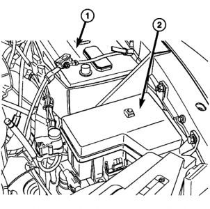

When the engine does not start while it is hot, connect a jumper wire betweenthe battery and the solenoid (S) terminals. if the engine crancks, there is a problem in the starter control circuit. if the solenoid make a clicking sound, it 's operating properly and the problem may be with the starter.if no sound is heard, the solenoid is the problem. If the solenoid is good, locate and check the relay. The starter relay is located in the Power Distribution Center (PDC). Refer to label on PDC cover for relay location. View of the battery (1) and PDC (2)
https://images.2carpros.com/forum/automotive_pictures/46384_relay_1.jpg
Disconnect and isolate negative battery cable. Remove the cover from the Power Distribution Center (PDC) for relay identification and location. Remove starter relay from PDC. Check condition of relay terminals and PDC connector terminals for damage or corrosion. Repair if necessary before installing relay keep me update.
