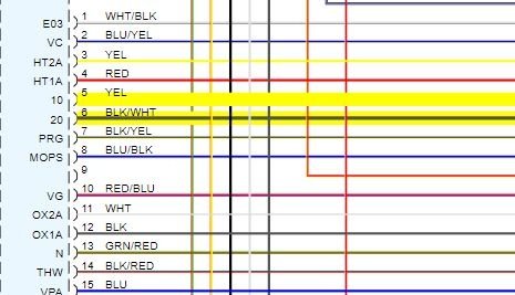

Pulling 2 codes p0110 accelerator pedal position sensor circuit a. And a p1120 manufacturer malfunction which I am unsure on what it is. But I am sure it is related to throttle-body and if I am correct that still would not cause a no start right? I am trying to just focus on one thing at a time.

Okay, so I am not seeing a flash from noid light but am getting power to black and white cable. The fuses checked out fine. I also borrowed a live data scanner from a friend but unsure how to check the crank signal on it. I will look that up now.

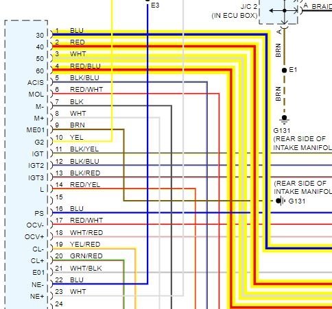

Okay, if you have power to the black and white, now you need to go to the Engine Control Module and check the connection. The ECM is on the left side of the engine compartment in the ECU box. Check pins 1 - 4 in connector E2. Also, pins 5 -6 in connector E3.
I attached schematic pictures. The highlighted wires are coming from the injectors. Now, you have power to the black and white wire. The ECM provides a ground to each injector at specific times and completes the circuit causing the injector to fire. If there are no visible problems, you will need to check the ECM for ground when cranking. If the ECM doesn't provide ground, there may still be a problem with the cam sensor or the ECM is bad,
Make sure you disconnect the battery for a few minutes before disconnecting the ECM and don't reconnect the battery until the plugs are plugged back in.
Let me know what you find.

I am sorry but I do not clearly understand the directions that you gave for testing the ECU and I don't want to mess anything up. So if you could please break it down for me one more time. I'm going to test that today and then if I can't get it going or getting results of that I'm going to go ahead and probably try to get a friend to bring a trailer and tow it to the shop. But I didn't really understand your directions how am I supposed to test it while cranking without the battery at the same time. I'm sure I just misunderstood you, but if you could please provide detailed instructions on how to test the ECU I would really appreciate it. Because I don't really understand and I do not want to mess anything up. Do I do this with a test light? If you can break it down for me with detailed directions on how to test I would appreciate it. Thanks

Hi Christa:
The battery should be disconnected prior to removing the ECM connector. Once removed, you can reconnect the battery and check the pins indicated above for ground while the engine cranks. Before you reconnect the ECM to the connector, disconnect the battery again. Basically, you don't want to connect or disconnect the ecm plug while the battery is connected.
Basically, you are checking to see if the ECM provides ground for the injectors. If you check for continuity, it should jump between an open circuit and closed (indicating ground).
Let me know if that makes sense. I wish I could be there to help.
Take care and let me know what you find.
