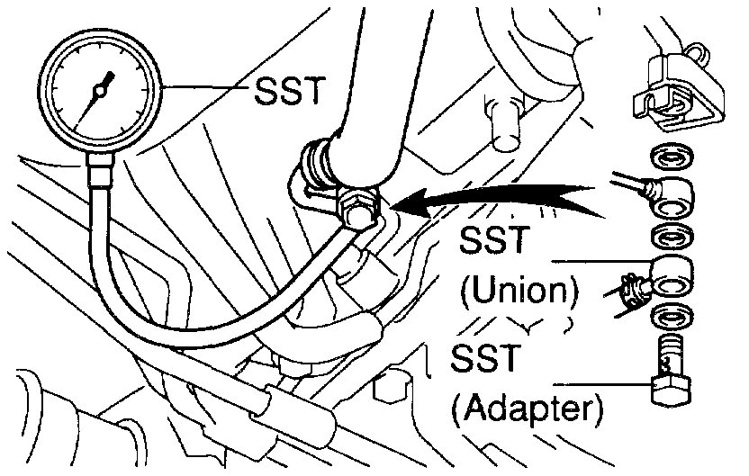

FUEL PRESSURE TEST
INSPECTION
CHECK FUEL PRESSURE
(a)Check the battery positive voltage is above 12 V.
(b)Disconnect the negative (-) terminal cable from the battery.

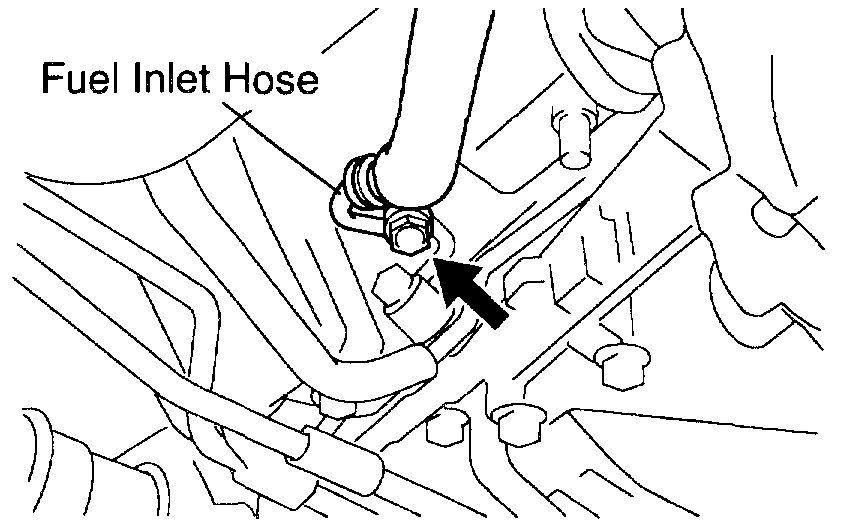

(c)Remove the union bolt and 2 gaskets, and disconnect the fuel inlet hose from the fuel pipe support.
NOTICE:
- Put a shop towel under the fuel pipe support.
- Slowly loosen the union bolt.
(d)Install the fuel inlet hose and SST (pressure gauge) to the fuel pipe support with the 3 gaskets and SST (union and adapter).
SST 09268-45014 (092684119O, 90405-06167)
Torque: 29 N.m (300 kgf.cm, 21 ft.lbf)

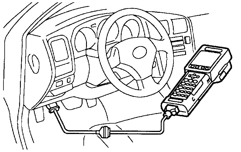

(f)Connect a LEXUS hand-held tester to the DLC3.

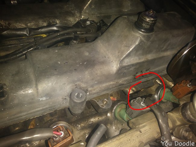

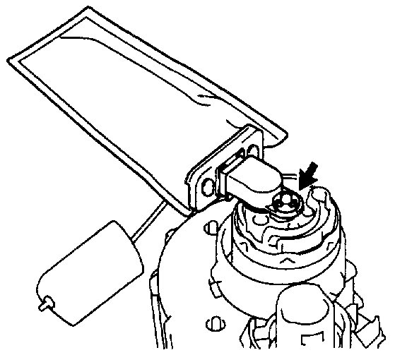

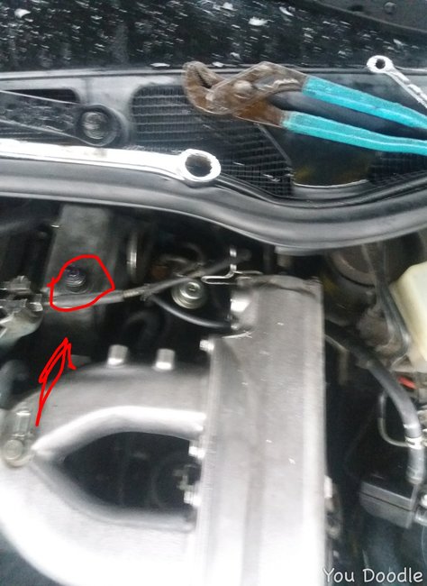

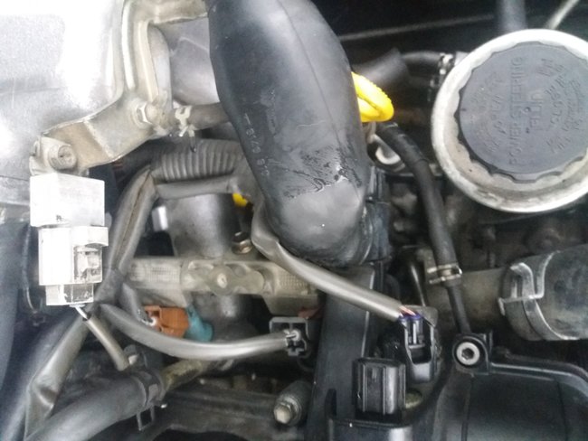

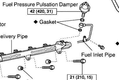

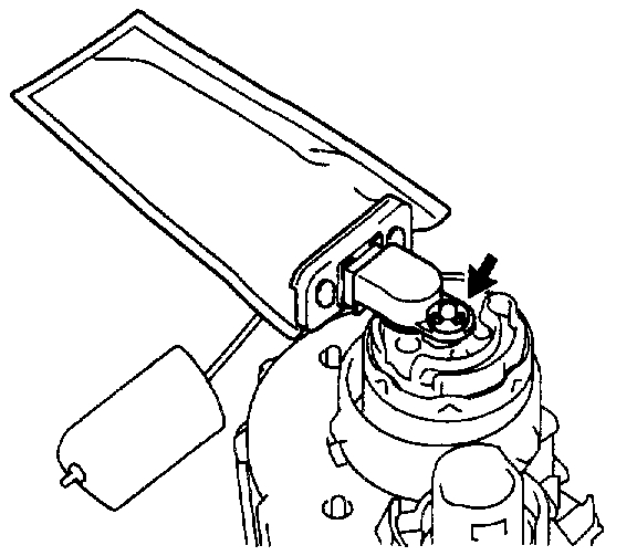

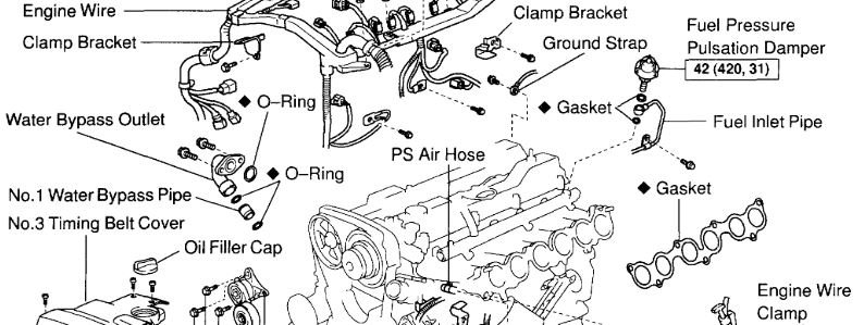

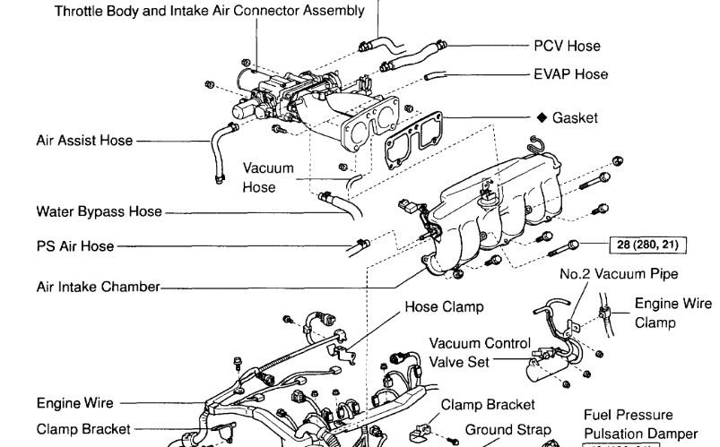

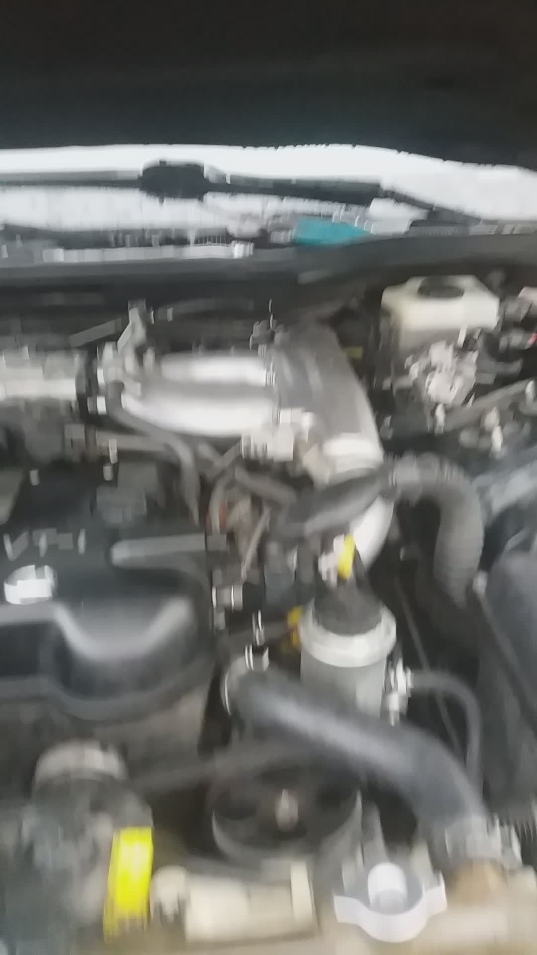

I am having a hard time finding the union bolt. Can you please explain the location and what is around it? Please
Nov 4, 2018 at 12:34 PM
  • 110,251 POSTS

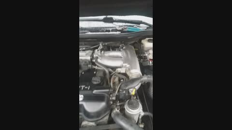

See picture 2 it shows the union. It is on the top of the engine near fuel rail.
Nov 5, 2018 at 9:21 AM
CHRISTA DICKSON
  • 150 POSTS
Okay, I am sorry I thought I found it underneath the car and a friend told me I was wrong and to hook up the gauge underneath the fuel pressure regulator is that correct? It is off the fuel rail on the top, so I am unclear on which is right. Please let me know ASAP as I have already rented the gauge. Thanks
Nov 6, 2018 at 11:55 AM
  • 110,251 POSTS
Hi again. It should be on the top.
Nov 7, 2018 at 8:03 AM
CHRISTA DICKSON
  • 150 POSTS

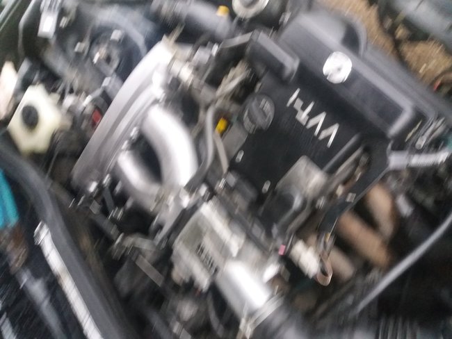

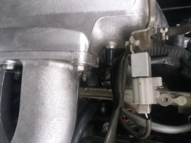

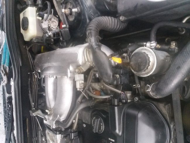

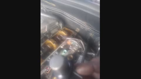

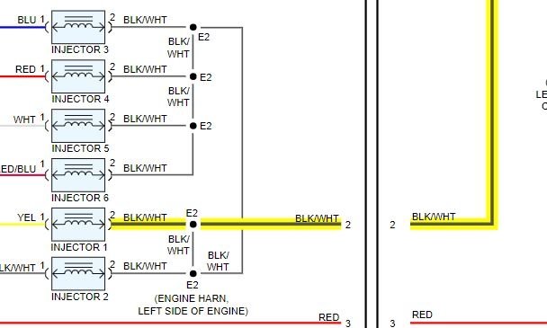

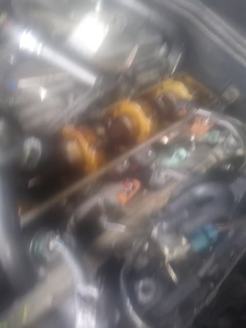

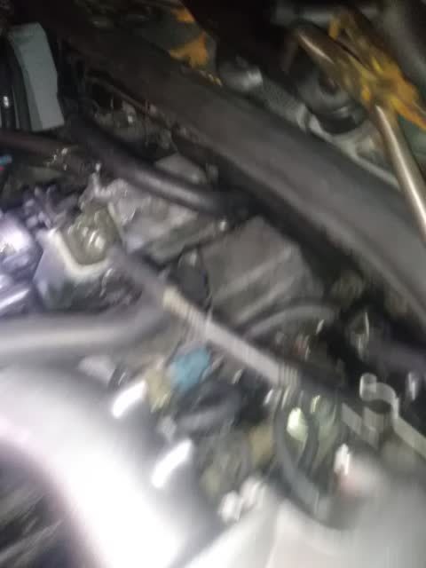

If you could possiable circle it in a photo or tell me what is around it so i can locate it correctly differnt sources keep telling me differnt things its even more confusing help would greatly be appriciated
Nov 8, 2018 at 6:00 AM
  • 110,251 POSTS

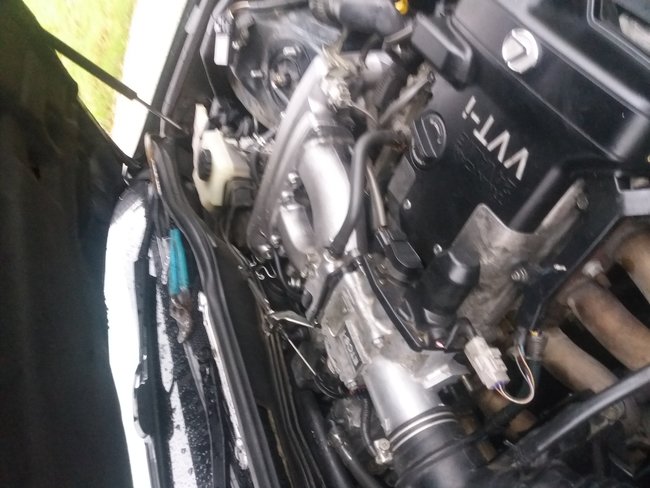

I believe I can see it in your sixth picture. It is blurry, but it appears to be on the left side. First, remove the plastic cover on top the engine. Then you will see the injector rail and the injectors. At the end of the fuel rail is where the union is located. I found a better picture. See if it helps.
Nov 8, 2018 at 11:23 AM
CHRISTA DICKSON
  • 150 POSTS
Okay, I am pretty sure your talking about underneath the damper, correct? I hooked it up there and got no reading at all . Just trying to verify I did it correctly. I know the fuel pump did work when I pulled it out and hooked up to battery. Any suggestions on where to go from here?
Nov 10, 2018 at 12:22 AM
  • 110,251 POSTS
It sounds like you did it right. If the pump did not run when you hooked it up directly to a battery, it is bad and needs replaced.

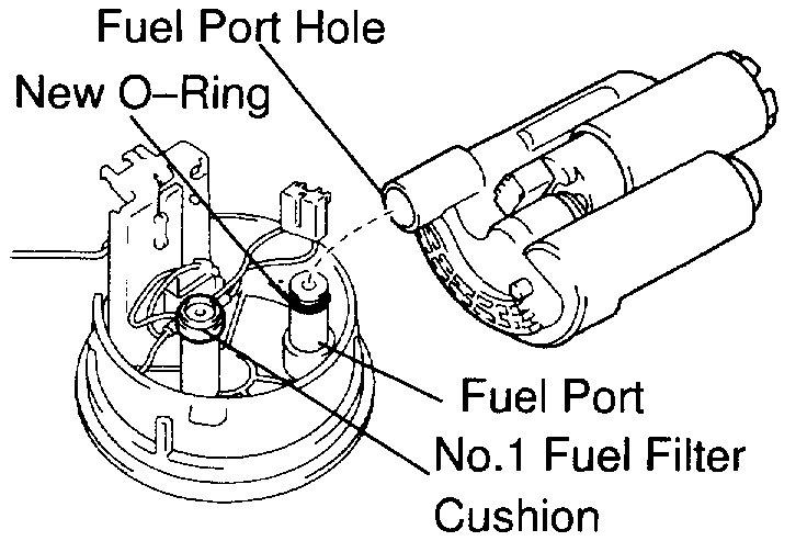

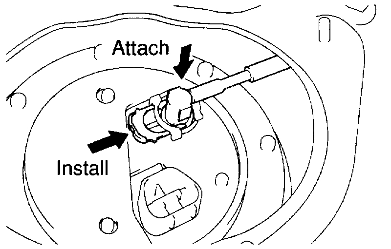

Here are the directions for removing and replacing the pump. You are lucky it has an access port. On most vehicles, the tank needs removed. All attached pictures correlate with these directions.
REMOVAL AND INSTALLATION
REMOVAL
CAUTION: Do not smoke or work near an open frame when working the fuel pump.

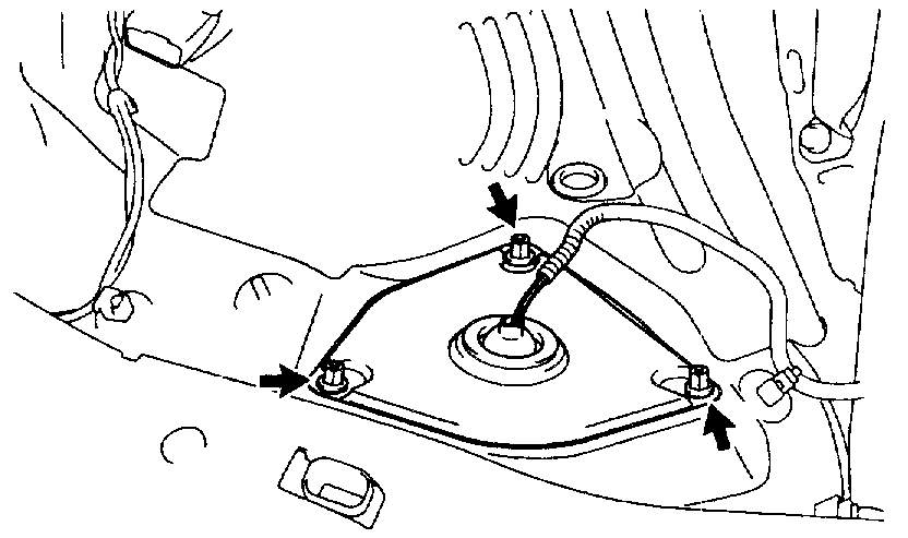

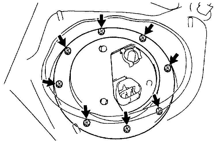

1. REMOVE REAR SEAT CUSHION
2. REMOVE FLOOR SERVICE HOLE COVER
Remove the 3 cap nuts and service hole cover.

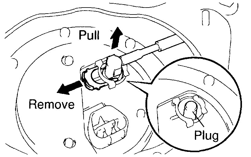

3. DISCONNECT FUEL PUMP & SENDER GAUGE CONNECTOR
4. DISCONNECT FUEL TANK MAIN TUBE (FUEL TUBE CONNECTOR) FROM FUEL SECTION PLATE
CAUTION:
- Perform disconnecting operation of the fuel tube connector (quick type) afier observing precaution.
- As there is retained pressure in the fuel line, prevent it from splashing inside the vehicle compartment.
(a)Remove the tube joint clip.
(b)Pull out the fuel main tube.
(c)Plug the port of the fuel suction plate with a clean rubber cap.
5. REMOVE FUEL PUMP AND SENDER GAUGE ASSEMBLY FROM FUEL TANK

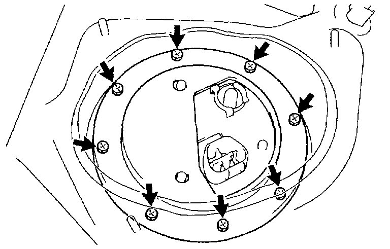

(a)Remove the 8 bolts and fuel tank vent tube set plate.

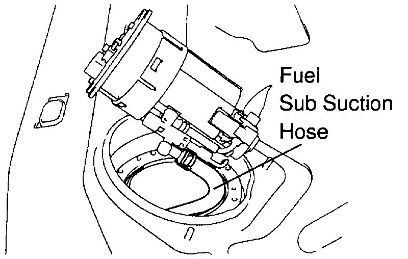

(b)Lift up the fuel pump and sender gauge assembly, and disconnect the fuel sub suction hose from the fuel return jet tube and remove the fuel pump, sender gauge assembly and gasket.
6. REMOVE NO.2 FUEL SUCTION SUPPORT
7. REMOVE FUEL PRESSURE REGULATOR AND FUEL RETURN JET TUBE ASSEMBLY
8. REMOVE FUEL SUCTION FILTER
(a)Remove the clip.
(b)Pull out the suction filter.
9. REMOVE NO.1 FUEL SUCTION SUPPORT

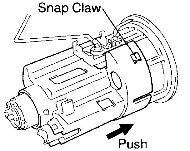

(a)Using 2 screwdrivers, disconnect the 4 snap claws from the claw holes and remove the fuel suction support.
NOTICE: Be careful not to damage the suction support and suction plate.
(b)Remove the No.2 fuel filter cushion.

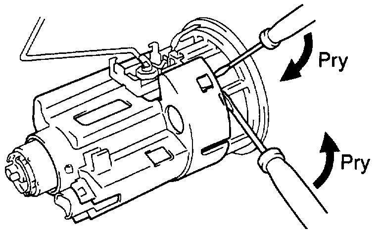

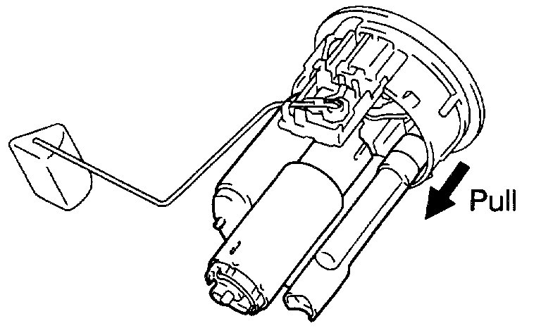

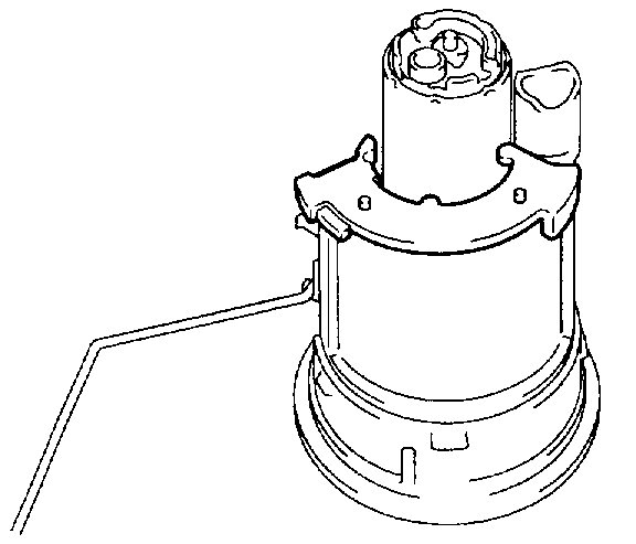

10. REMOVE FUEL FILTER AND FUEL PUMP ASSEMBLY
(a)Disconnect the fuel pump connector from the fuel pump.
(b)Pull out the fuel filter and fuel pump assembly.
(c)Remove the No.1 fuel filter cushion.
(d)Remove the O-ring from the fuel poet of the fuel suction plate.

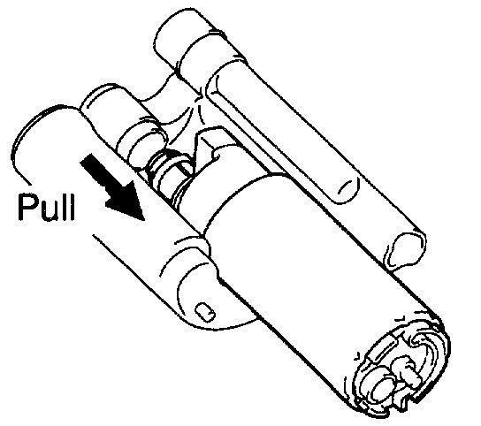

11. REMOVE FUEL PUMP FROM FUEL FILTER
Pull out the fuel pump.
INSTALLATION

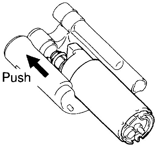

1. INSTALL FUEL PUMP TO FUEL FILTER
Push in the fuel pump.
2. INSTALL FUEL FILTER AND FUEL PUMP ASSEMBLY
(a)Install the No.1 fuel filter cushion to the fuel suction plate.
(b)Apply a light coat of gasoline to a new O-ring and install it to the fuel port of the fuel suction plate.
(c)Align the fuel port of the fuel suction plate with the fuel port hole of the fuel filter.
(d)Push in the fuel filter.
(e)Connect the fuel pump connector.
3. INSTALL NO.1 FUEL SUCTION SUPPORT
(a)Install the No.2 fuel filter cushion the fuel filter.
(b)Push the fuel suction support, and attach the 4 snap claws to the claw holes.

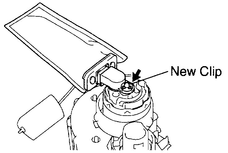

4. INSTALL FUEL SUCTION FILTER
Install the suction filter with a new clip.
5. INSTALL FUEL PRESSURE REGULATOR AND FUEL RETURN JET TUBE ASSEMBLY
6. INSTALL NO.2 FUEL SUCTION SUPPORT
7. INSTALL FUEL PUMP AND SENDER GAUGE ASSEMBLY TO FUEL TANK
(a)Install a new gasket to the fuel suction plate.
(b)Connect the fuel sub suction hose to the fuel return jet tube.
(c)Attach the fuel pump and sender gauge assembly to the fuel tank.
(d)Install the fuel tank vent tube set plate with the 8 bolts.
Torque: 3.5 N.m (36 kgf.cm, 31 in.lbf)

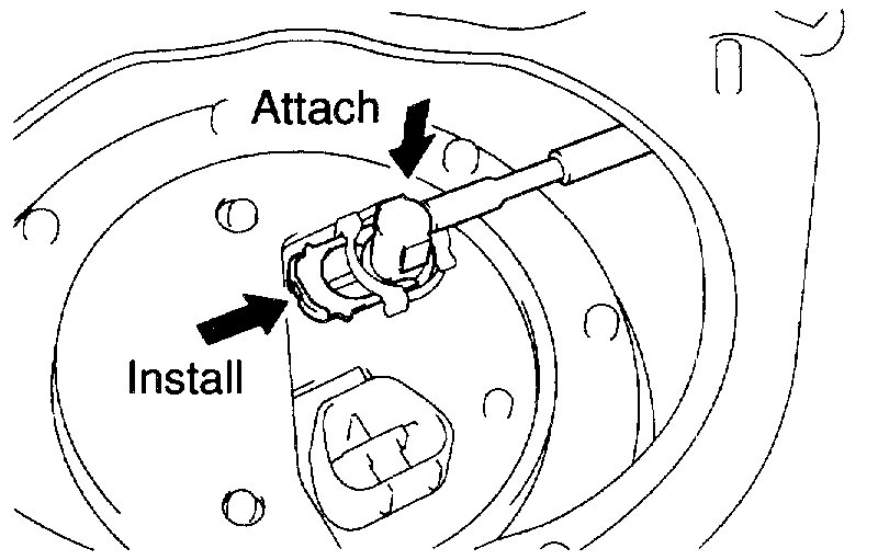

8. CONNECT FUEL TANK MAIN TUBE (FUEL TUBE CONNECTOR) TO FUEL SUCTION PLATE
(a)Attach the fuel tube connector to the port of the fuel suction plate.
(b)Install the tube joint clip.
9. CONNECT FUEL PUMP & SENDER GAUGE CONNECTOR
10. CHECK FOR FUEL LEAKS
11. INSTALL FLOOR SERVICE HOLE COVER
Install the service hole cover with the 3 cap nuts.
12. INSTALL REAR SEAT CUSHION

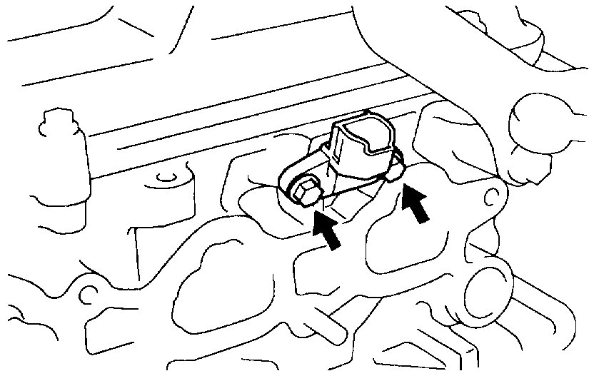

Hi and welcome back.

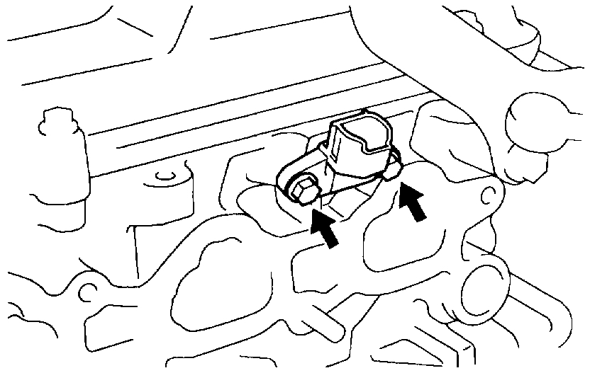

The cam sensor is held in by two bolts. Once the bolts are removed, it should pull straight out. Here are the directions specific to your vehicle:

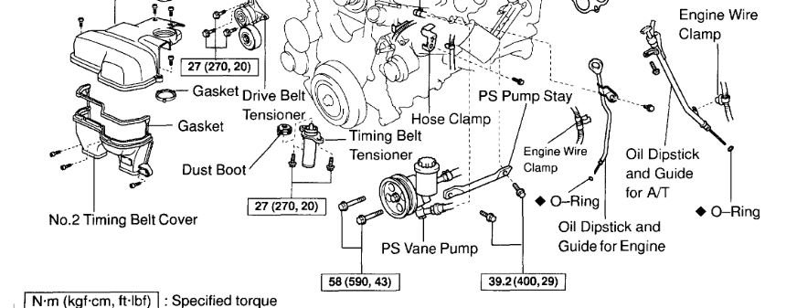

8. REMOVE FUEL PRESSURE PULSATION DAMPER
9. REMOVE PS PUMP REAR STAY
Torque: 39.2 N.m (400 kgf.cm, 29 ft.lbf)
10. REMOVE INTAKE MANIFOLD ASSEMBLY
11. REMOVE CAMSHAFT POSITION SENSOR
Remove the 2 bolts and camshaft position sensor.
Torque: 9.0 N.m (90 kgf.cm, 80 in..lbf)
INSTALLATION
Installation is in the reverse order of removal.
____________________________________

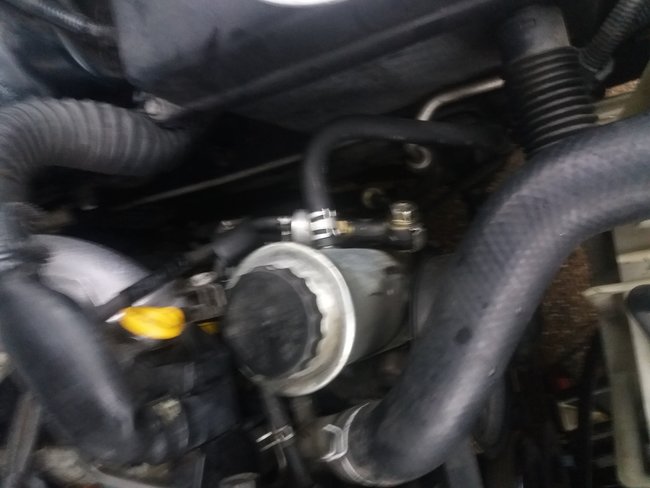

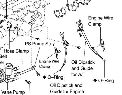

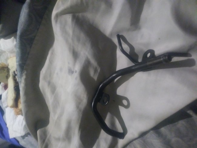

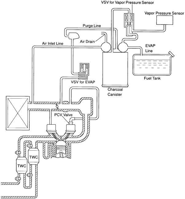

As far as picture 2, I cannot tell what I am looking at. Can you get a closer picture of the part the hose came from?

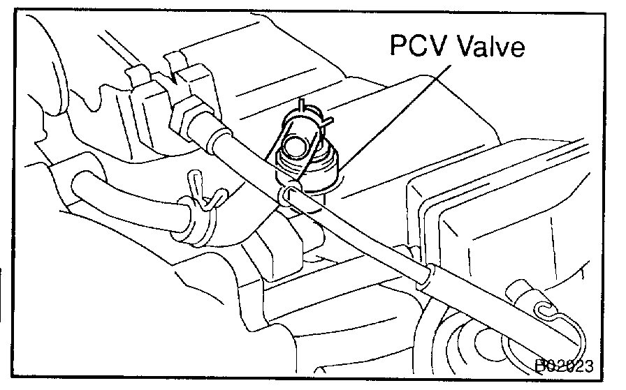

I can tell you, there is a really good chance you are referring to the positive crankcase ventilation (PCV) valve. If that hose is disconnected, you are going to have a bad vacuum leak and most likely, it will cause the engine to stall.
Look at picture 2 and see if you can tell if that is what you are referring to.
Nov 29, 2018 at 9:43 AM
CHRISTA DICKSON
  • 150 POSTS
Yes, that is it, thanks. Also if by chance you had a diagram of how to connect this part it, is under the throttle body and trying to remember how it was seated. I have to do all of that to put new cam sensor back in correctly?
Nov 29, 2018 at 10:30 AM
  • 110,251 POSTS
Hi:
I believe that is the engine oil dipstick tube. In the picture, the end that is sticking up should have an o-ring on it to prevent leaks. Make sure to lubricate the o-ring with oil prior to installing it into the engine. That end will go to the engine. The other end will bolt up top. I have attached the best picture I could find. It shows the part and has lines going to where the bolts are placed.
As far as the PCV, if you do not repair that, either the engine will not stay running or will run really bad. That is a big vacuum leak without it connected. Feel free to ask if you have questions.
Also, the directions for removing the sensor are extreme. If you are able to access it without doing one of the steps, you should be fine.
Let me know the results or if you have other questions.

Having a hard time getting this cam sensor in with out breaking. Also the metal piece goes to some hoses underneath throttle body I am just not sure exactly how.
Nov 30, 2018 at 6:41 AM
  • 110,251 POSTS
Hi:
I watched the video. It should go right in. Make sure there is nothing blocking it from seating. Also, step back and determine what is hitting that is not allowing you to get the right position. It is something stupid, I can almost guarantee it. Also, compare the new sensor to the one you replaced. Make certain it is exact.
I will be on here for awhile yet tonight, so I will keep checking for your reply. Let me know what you find.
Also, you mentioned about a hose under the intake. Can you upload which hose you are referring to?
I have to tell you. Up to this point, it looks like you have done an excellent job. I have people working for me that are not that organized and neat about things. Just do not get frustrated, try again, step back and think what could be preventing you from getting it, and I bet you figure it out. There really is no trick. When installing it, try to turn it back and forth while applying light pressure.
I will keep my eye open for your reply.

Still cannot get cam sensor all the way in. Got it almost all the way at least and the hoses under throttle body I do not think I have ran correctly because it started the rpm's surged very high then stalled, lol. I hope you can get a clear understanding if which hoses from the video. Thanks
Dec 1, 2018 at 10:53 AM
  • 110,251 POSTS
Hi Christa, it is Joe:
Your video is fine, but I cannot be sure what I am looking at. I am sorry However, lets try this a different way. Attached, I have put a total of four pictures. The first three are an exploded view of the top of the engine including the intake and all components. The last picture is of the evap system (vacuum routing). Take a look through that and see if you can identify any of the specific parts. The first three pictures are actually of the same schematic in the manual. I had to break it into there otherwise, you would not have been able to read it. I made sure to overlap each picture so you can see where it continues. If something is not clear or you need verification, let me know.
Also, did you compare the sensor to the original one? It should fully seat. Since you got it in that far, it should seat. I am questioning if it is different that the original one.

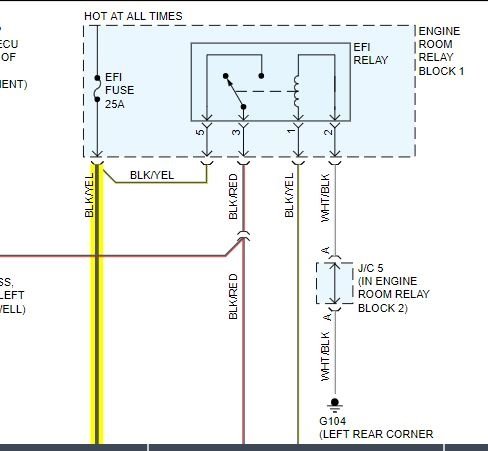

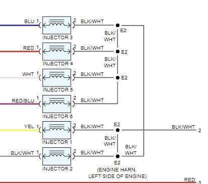

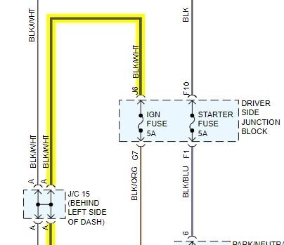

I tested a injector with noid light and got nothing. No flash. what would cause this?
Jan 12, 2019 at 6:47 AM
  • 110,251 POSTS
Hi, Christa. I feel bad you are having so much trouble. I am going to do my best at trying to explain how this works.
First, on these vehicles, there should be power to each injector at all times. If you check, you will see a black/white wire going to each. That should have power with the key on. What happens is this. The power control module (PCM) provides a ground to each injector at specific times to complete the circuit. First, check if there is power to the black/white wire. If there is, then we may have a problem with the PCM. However, if there isn't power, I recommend checking a couple fuses. There is a 5 amp fuse on the driver's side junction box for the ignition. Check that and check the 25 amp EFI fuse in the engine room relay box. I have attached pictures for you to see. Also, I did my best to highlight the wires in question.
One last thing, check to make sure the ground in the engine area (black/white) wire is good and wasn't damaged. See the last picture I attached.
Do this and let me know what is found.
Take care, Joe
Jan 12, 2019 at 7:46 AM
CHRISTA DICKSON
  • 150 POSTS
Okay, will a damaged wire to one injector cause a no start? Though i am just trying to clarify. If one injector would cause it not to start would it just run bad or not run at all? Just curious and and i will do that tomorrow. it has been pretty cold out and i do not have a garage.
Jan 12, 2019 at 8:52 AM
  • 110,251 POSTS
Welcome back:
Take a look at picture 1. Note that all the injectors are tied into the black and white wire. If the wire is damaged before it gets to the injector, none will work.
Stay warm and let me know what you find,.
Jan 12, 2019 at 2:00 PM
CHRISTA DICKSON
  • 150 POSTS
There is no picture attached?
Jan 14, 2019 at 5:40 AM
  • 110,251 POSTS
I'm sorry about that. Here it is.
Jan 14, 2019 at 9:48 AM
