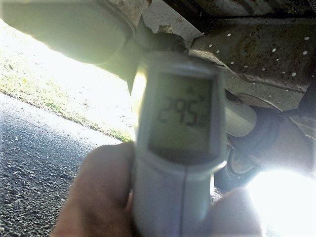

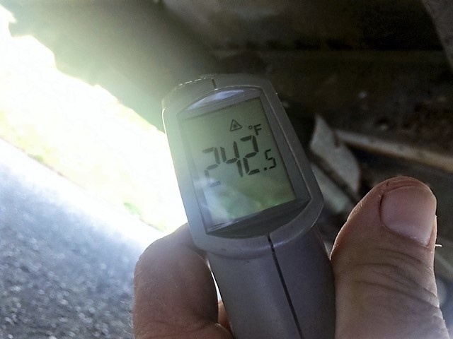

Here is the readings!

Those cat readings don't really mean much they can be as high as 1400-1600 F depending on load. 1300 is about normal. Your compression should all be with in 20% of each other with the one cylinder reading low. But okay. The wetness on plug is probably form the valve guide as they wear and with your mileage just drive it it won't hurt anything. The plugs can be wet from short drives under a mile and or starting engine and shutting it off. Also check your vacuum line going to map sensor, they get soft and suck together so map sensor doesn't work right like not allowing vehicle to start for one.

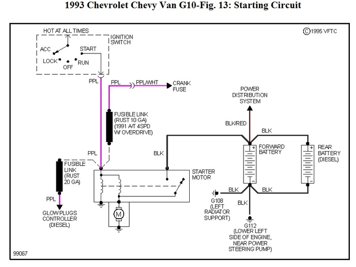

Last year during a gas stop, when I turned the key the doors automatically locked but engine would not turn over/no start. A truck jumped me and it started right up. I drove to SEARS and had battery checked. Battery was OK. They suggested a possible dead spot in starter.
Finished trip with no other starting problems. On return I took it to local repair shop. They replaced with a rebuilt starter.
Now 11 months later, it has started doing the same thing. After driving a while, stopping, it may not turn over, no noise/click, no nothing. Let it sit, say 30 min and it may then start. I had the local Chevy dealer check it out and they said replace the starter. I checked warrenty from repair shop that replaced it 11 months earlier and they said bring it back. They have had it four days and it starts every time for them. I must leave on another trip this Wed. Any ideas as to problem other than an exorcism?
Thanks very much,
Ron Evans in Garland, TX
Friday, July 24th, 2020 AT 12:23 PM (Merged)
INTERNETMECHANIC
  • 700 POSTS
This probably isn't what you want to hear, I'd have to do testing when the problem occurs. As an example, if the starter refuses to crank, with the key in the crank position, the purple wire at the starter solenoid should be hot, if it isn't, back track the circuit. Possible issue with ignition switch or wiring circuit. Your going to have to do some testing yourself, intermittent issues can be a pain. Some of the national brand autostores will test the starter for you, if you take it off and take it to them, if you want a second opinion. I'm not sure which van you have, I looked at wiring info on a G10.
