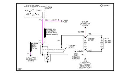

Get your battery load tested and hold key at cranking position look for power at purple wire on starter solenoid.

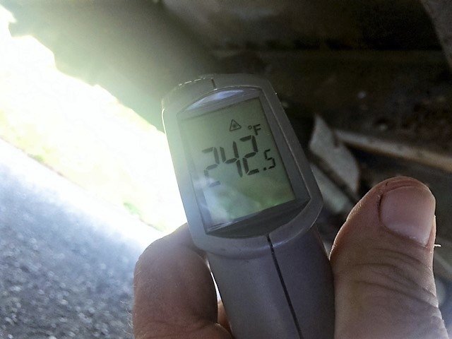

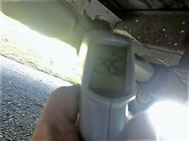

Checked the cat just now and temp is 242 degrees coming into and 295 coming out!

I have power at the purple wire. I turned on the headlights and turned the key. Nothing changed on the headdlights, they are bright.
The guy at the auto parts store suggested the starter switch, but that is not in my book. Is that the same as the ignition switch?

Power at the purple wire means the starter is defective-it should kick over when power is apllied to the solenoid

those cat readings don't really mean much they can be as high as 1400-1600 F depending on load. 1300 is about normal. your compression should all be with in 20% of each other with the one cylinder reading low. but okay. the wetness on plug is probably form the valve guide as they wear and with your mileage just drive it it won't hurt anything. the plugs can be wet from short drives under a mile and or starting engine and shutting it off. Also check your vacuum line going to map sensor, they get soft and suck together so map sensor doesn't work right like not allowing vehicle to start for one.
