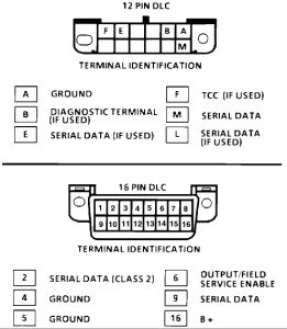

The two wires are together and no way to jump them unless I insert clip into "A" slot and then try to ground to something. Also, there is no other relay to swap the fuel pump relay with. The only other one oin the box has 4 prongs. Fuel pump relay has 5 prongs.

Well the tan wire is the one that needs to be grounded....... The black is the ground..... So you have a black and tan wire in the same clip?
Thursday, January 1st, 2009 AT 1:03 PM
BLAZER98
  • 20 POSTS
Yes, they are in the same clip
Thursday, January 1st, 2009 AT 1:06 PM
IMPALASS
  • 3,112 POSTS
Hello -
If I understood you earlier you still have on black wire sitting there in A pin... So ground that to the black/tan and see if that works.
Does that look like a dealer splice or a home one
Thursday, January 1st, 2009 AT 1:12 PM
BLAZER98
  • 20 POSTS
Looks like it is original dealer wire. No splice in wire, but everything else is messy. Not the way my dad taught me to do things
Thursday, January 1st, 2009 AT 1:14 PM
BLAZER98
  • 20 POSTS
The black wire in A pin is paired up with the tan wire, The two of them are in the A pin together with no splices anywhere. It seems to be factory, not home wired.

Looks like you have all of the goodies for the tank drop. . ..good luck on that. . .. . .. . ...
And you do have the 12 pin DLC not the 16 pin correct. . .. . .. . .
https://www.2carpros.com/forum/automotive_pictures/248015_42140733_1.jpg
I am still trying to search around to see why the wiring is that way. . .. . .
The diagrams only show4 wires. . .. . ...Black in the A pin, Gray in the D pin, Dark Green in the J pin and Tan in the M.
And there isn't any wires not really hanging but caught up in the wiring that should be in the connector?
