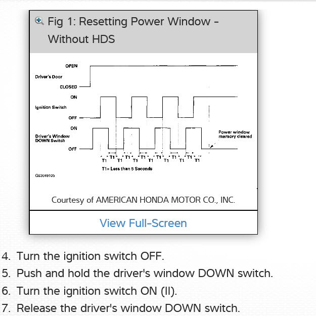

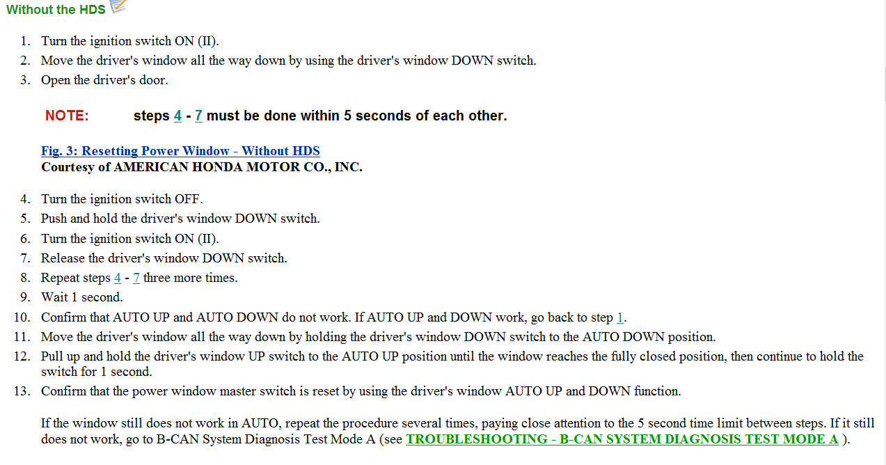

HMAC300
  • 48,601 POSTS

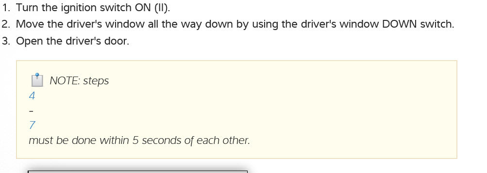

yes try to follow these steps in pics......

Oct 16, 2020 at 3:20 AM (Merged)
HMAC300
  • 48,601 POSTS
try what i'm sending in the pic first otherwise it has to have a scanner hooked to it.

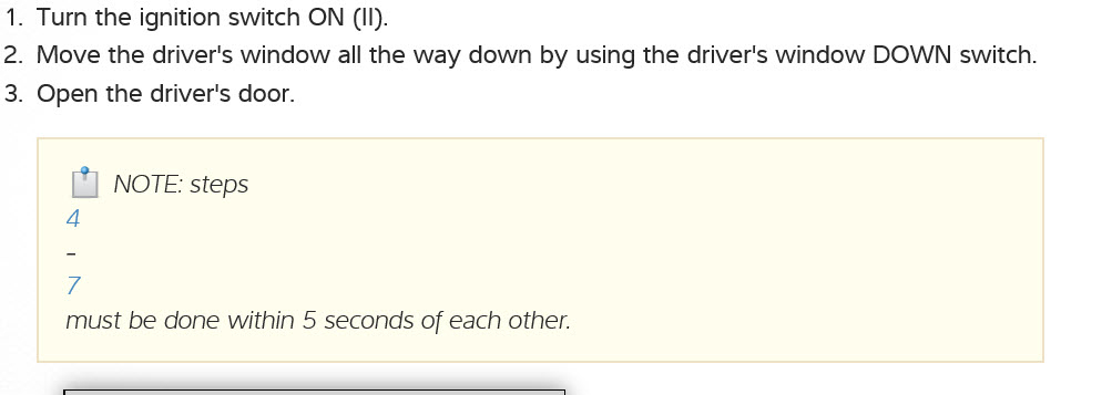

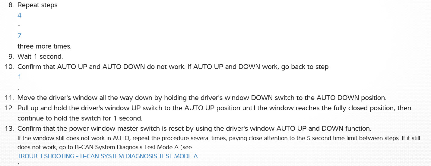

HMAC300
  • 48,601 POSTS
do like it says in the pic that I sent in previous reply if it still doesn't work then it has to go back and get module reset.
GSRK
  • 5 POSTS
In step 12, when I hold the switch to auto up position, the window does not start rolling up atleast 4-5 secs, is that the expected behavior?
And after that step 13 works fine, but still no luck with the other three windows.
If I have to get the module reset, how do I do it?

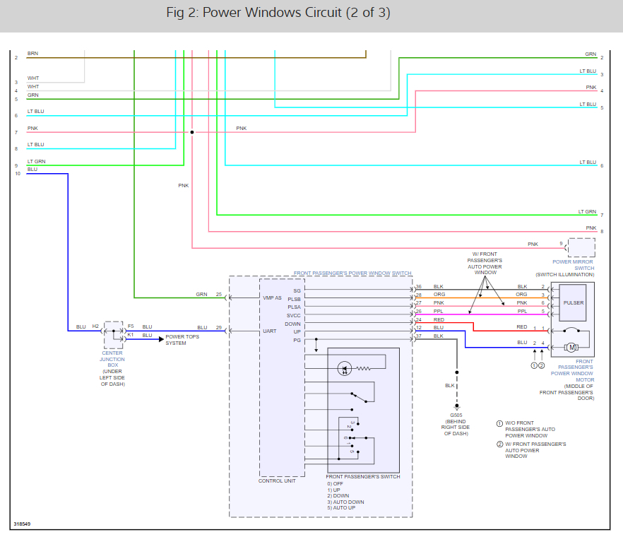

DANNY L
  • 5,648 POSTS
Hello, I'm Danny.

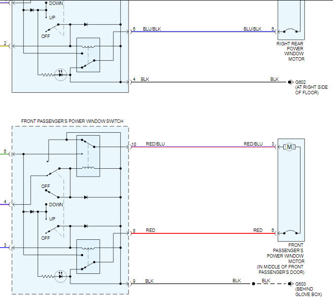

If you have access to a power probe tool you can manually charge the window motor to roll up.Most auto parts stores have tool loaner programs and can rent tools.It would be easiest to gain access to the window motor by removing the door panel.Here is a tutorial for you to view:
https://www.2carpros.com/articles/door-panel-removal
I've attached a passenger side window motor wiring diagram below.This way you can see which wires to charge to roll the window up.Hope this helps and thanks for using 2CarPros.

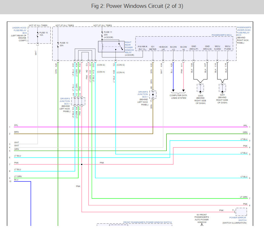

KHLOW2008
  • 41,814 POSTS

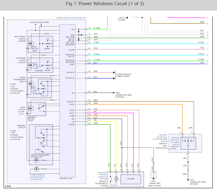

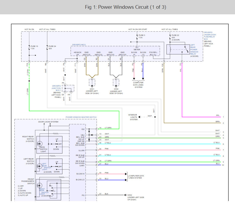

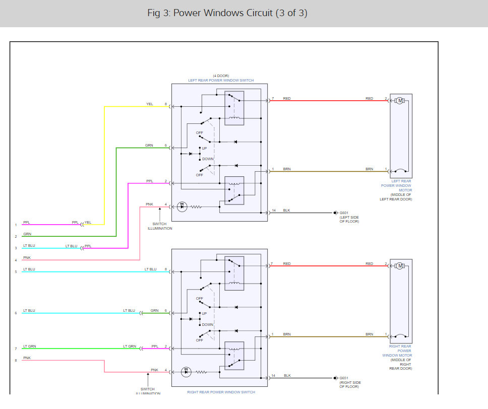

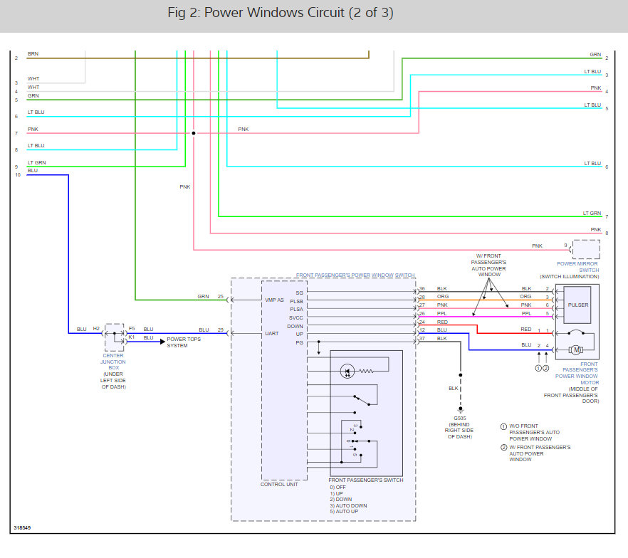

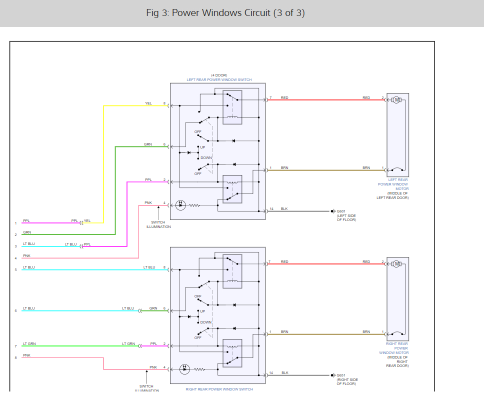

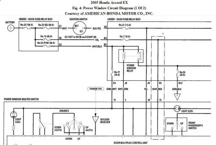

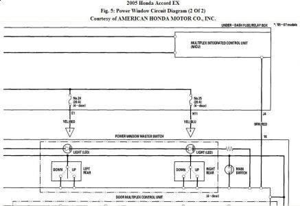

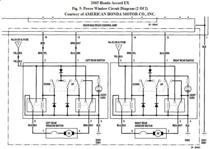

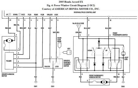

Testing of the circuits would involve use of test lamps, DVOM and removal of switches , panels etc. If the above items are available andyour are comfortable with wire circuit testing, we are set to go. From the symptoms described, it could be power is not getting to the other windows from the driver door. I have the circuit diagram here. Go thhrough them to get an understanding of the system and check the fuses and wire socket connectors, especially between doors, and see if you have ant new discovery. Any other questions, just reply to question and I will get back to you.
https://images.2carpros.com/forum/automotive_pictures/192750_PWCircuit05Accord01a_1.jpg
https://images.2carpros.com/forum/automotive_pictures/192750_PWCircuit05Accord01b_1.jpg
https://images.2carpros.com/forum/automotive_pictures/192750_PWCircuit05Accord02a_1.jpg
https://images.2carpros.com/forum/automotive_pictures/192750_PWCircuit05Accord02b_1.jpg

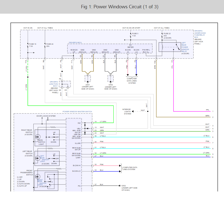

The power windows are connected to the driver door multiplex control unit and this unit seems to be the cause of the problem. Try resetting to see if it works. RESETTING THE POWER WINDOW 1. Turn the ignition switch ON (II). 2. Move the driver's window all the way down by using the driver's window DOWN switch. 3. Open the driver's door. NOTE: steps 4 - 7 must be done within 5 seconds of each other. 4. Turn the ignition switch OFF. 5. Push and hold the driver's window DOWN switch. 6. Turn the ignition switch ON (II). 7. Release the driver's window DOWN switch. 8. Repeat steps 4 - 7 three more times. 9. Wait 1 second. 10. Confirm that AUTO UP and AUTO DOWN do not work. If AUTO UP and DOWN work, go back to step 1. 11. Move the driver's window all the way down by holding the driver's window DOWN switch to the AUTO DOWN position. 12. Pull up and hold the driver's window UP switch to the AUTO UP position until the window reaches the fully closed position, then continue to hold the switch for 1 second. 13. Confirm that the power window master switch is reset by using the driver's window AUTO UP and DOWN function. If the window still does not work in AUTO, repeat the procedure several times, paying close attention to the 5 second time limit between steps. If it still does not work, go to B-CAN System Diagnosis Test Mode A.

I chased it down to the PW-relay. The relay works, the drivers master control is not telling it to activate. ran jumpers and windows work fine. Looks like I need a $280.00 control unit.

Glad that you are able to diagnose the fault.
The control unit do give way at times but it usually is due to bad contacts. If you are adventurous, try removing the unit and checking through the printed circuit board. Look out for cracked solders and resolr them if any found, you might save yourself $ 280 ;)

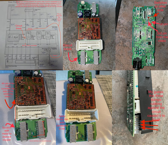

Finally after months of research I was able to to figure out what really caused the click sound. The click that we hear is basically the switch that is turning on(controlled by microcontroller) but without the power supplied by the power relay the windows don't roll down. It is caused by a broken circuit as seen in the picture.
There are basically 4 ways of fixing it. I will start with the easiest.
Method 1: buy the switch which costs $37 for the LX model from the switchdoctor.com ( does not work with EX model )
LInk: switchdoctor(dot)net/honda-accord-window-switch/honda-accord-master-power-window-switch-2003-2007/
Cons: some people have issues trying to re-program their key.
Method 2: short the 1st (black) and 3rd (green) wire just like the people in this post did. It is extremely easy. ( link: youtube(dot)com/watch?v=Q52Hea4-MrU)
Cons: shorting this wire actually completes the power relay circuit by connecting the power relay to the ground(shown in the picture) . This however removes the control from the microcontroller( 4th pin) to turn on/off the power relay . The microcontroller is designed to turn on the power relay only when the switches are pressed . But without this control the switch has power all the time which is causing the power drain reported by multiple people on this page. Explained in this video (link: youtube(dot)com/watch?v=6RTKsTAU4bs)
Method 3: soldering the 3rd pin(from the second method) and the 4th pin of the microcontroller. This restores the connection of the power relay to the microcontroller allowing the microcontroller to control the switch. This 3rd pin is the same pin that eventually connects to the black wire( from the 2nd method) .
This video explains how to disassemble the entire switch and how to solder the wire. ( link: youtube(dot)com/watch?v=hotWhazi5PE)
Cons: using this method skips over a resistor( black one) . To be honest i don't know what it basically does.
Method 4: try this only if you are really confident and know about circuits
The circuit is broken as seen in the second picture. This can be fixed with the use of a conductive ink pen which is $6 on amazon (link: amazon(dot)com/dp/B00OZATJ3A ) .
This however is a little difficult and should be done carefully. The red line that you see in the pictures is the circuit that follows the 3rd pin to the 4th pin of the microcontroller. If you see that the circuit is broken like mine(2nd pic) use this method.
step1: use the video from the 3rd method to remove the circuit board from the main switch board.
step 2: figure out if there is a break in the circuit as seen in the pic
step 3: there is a plastic coating on the circuit which needs to be removed to expose the copper wire, this can be done by slowly scratching the outer plastic with the help of a small screwdriver. The copper wire can be seen in the 5th pic.
step 4: use the conductive ink pen to carefully draw a line connecting them. Complete the broken circuit as seen in the 6th pic and do not connect it to any other circuit.
step 5: use an insulating tape to cover the line that you drew so that the problem doesn't resurface in the future and to remove the possibility that the line that you drew connecting to any other circuits in the future.
Cons: you will need a steady hand to draw a line to re-connect the circuit. If the line gets messed up use a slightly wet paper towel to rub it off and then follow up with a dry paper to remove all the moisture. Also there is a possibility that in the future the line that you drew could disconnect.
DISCLAIMER: I'm not a professional and the methods that have been described are my personal experience. Please use at your own risk.
and finally the reason why we all had to go through this trouble.
I think the 3 bumps (6th pic) that you see on the plastic shell that covers the circuit board rubbed against the board and overtime eventually rubbed off the entire circuit including the plastic coating and the copper.
