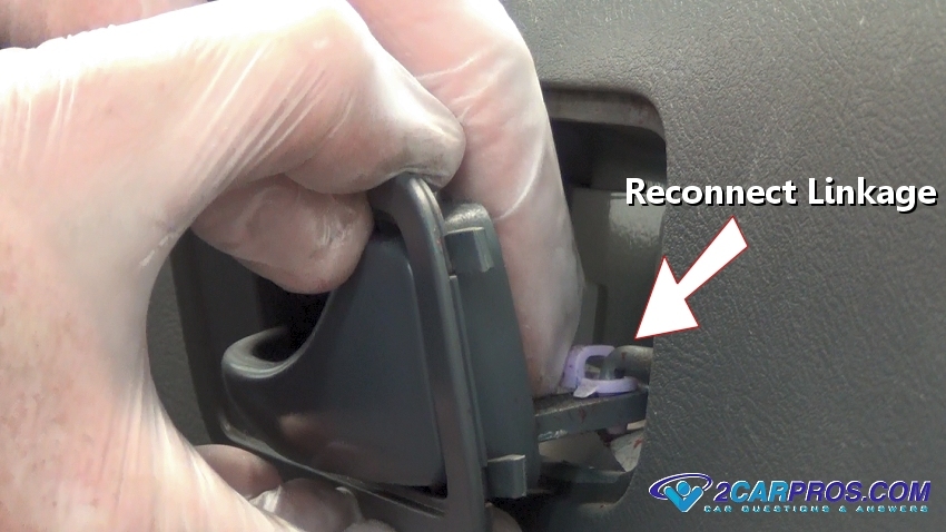

3. Remove Door Handle
Remove any screws holding the inner door handle. Grasp the handle and remove it by pulling upward. Be cautious of the linkage attached to the handle as not to bend or break it.
remove door handle
Use a small screwdriver to push the plastic clip over the linkage and release it from the handle.
disconnect door handle linkage

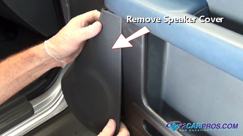

4. Remove Door Speaker
Some car door panels are equipped with a speaker which will need to be removed before the panel can be taken off in some cases. Grasp the speaker cover and gently pull outward to unclip the cover to access the speaker screws.
remove speaker cover

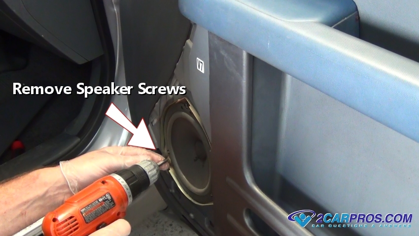

Remove speaker mounting screws to remove the speaker. Be careful not to puncher the speaker cone with the tool.
remove speaker screws

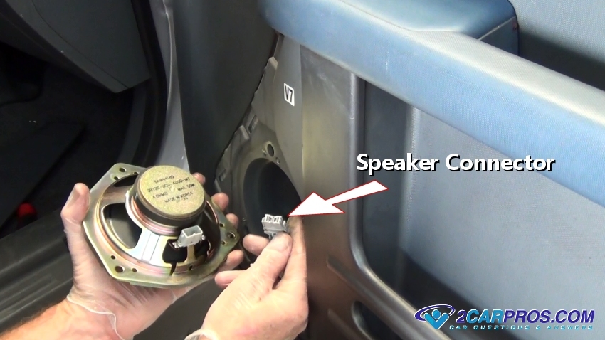

Once the speaker is loose disconnect the wire harness connector by releasing the wiring connector safety clips.
disconnect speaker wiring connector

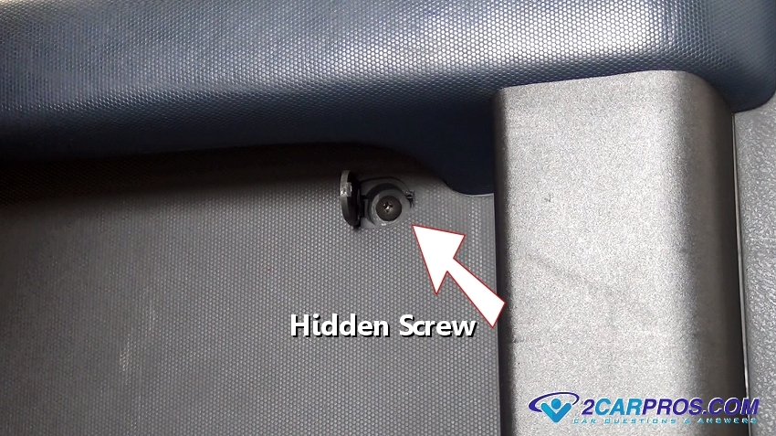

Check that all mounting hardware and small hidden doors have been opened. Some screws can be well hidden as in the image below.
hidden screw door panel

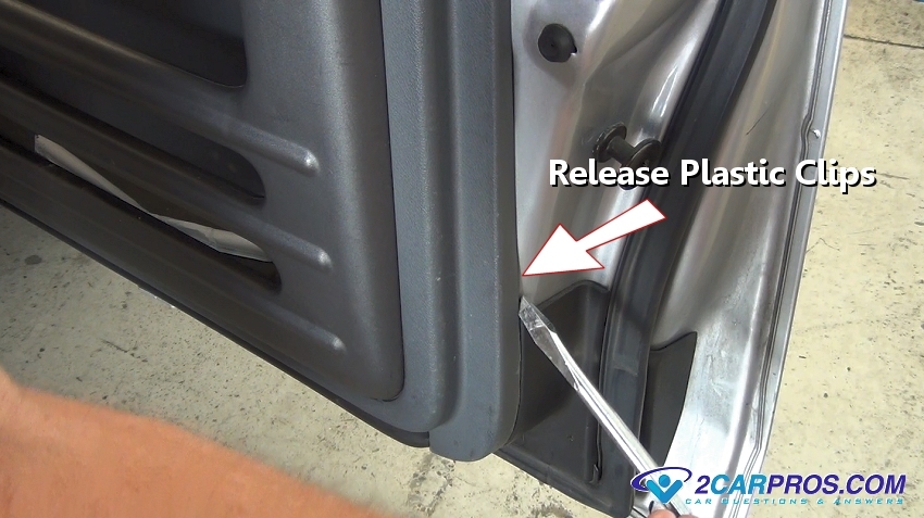

Use a screwdriver or door panel removal tool and wedge it in-between the panel and the door. This will release (pop) the plastic clips holding the panel to the door. Follow this action around the bottom of the door until completely released.
release door panel clips

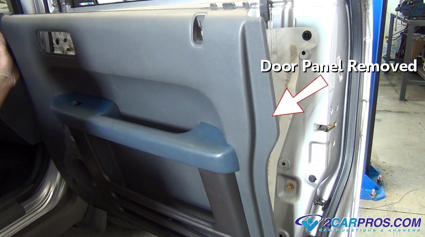

7. Finish Removing the Door Panel
Once the electrical connector has been released the door panel will become free from the door. Remove it and gently place it away from the work area to keep it free from dirt and grease.
door panel removed

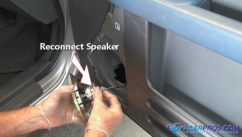

9. Reinstall Speaker
Hold the speaker while reconnecting the electrical connector and then set the speaker back into place.
reconnect speaker wiring

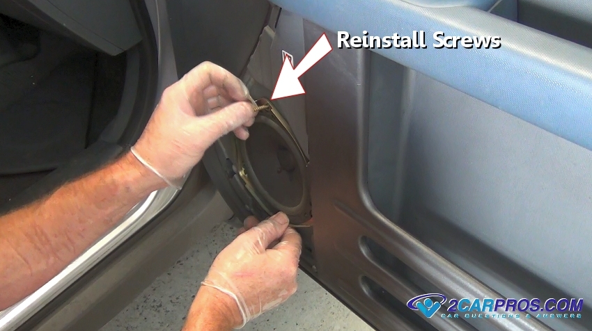

Reinsert and tighten speaker mounting bolts and reinstall the cover.
reinstall speaker screws
10. Install Inner Door Handle
While holding the door handle reattach the door handle linkage by popping the plastic clip over the control rod.
reconnect door handle linkage
Snap the door handle back into place while ensuring the linkage can move freely.
install door handle

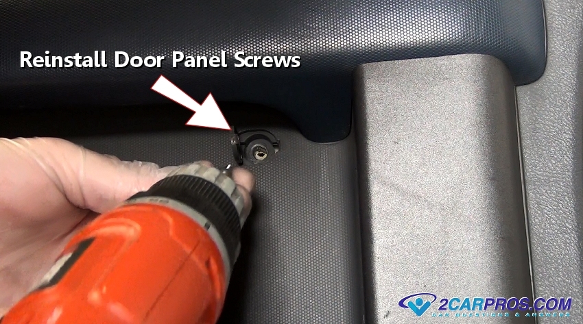

11. Reinstall Door Panel Mounting Screws
Reinstall all door panel screws or bolts and recover them with the small hidden plastic panels or doors.
