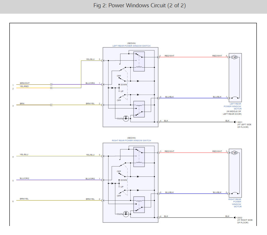

MMPRINCE4000
  • 8,548 POSTS
One of the window switches is broke/stuck, either the master control on the drivers side or the one controlling the window in question.
Remove rear switch, disconnect it, short wires with some wire to raise. If it goes back down, then the master control switch is bad. Here is a guide to help test to for power with the window wiring diagrams below to show you how the system works.

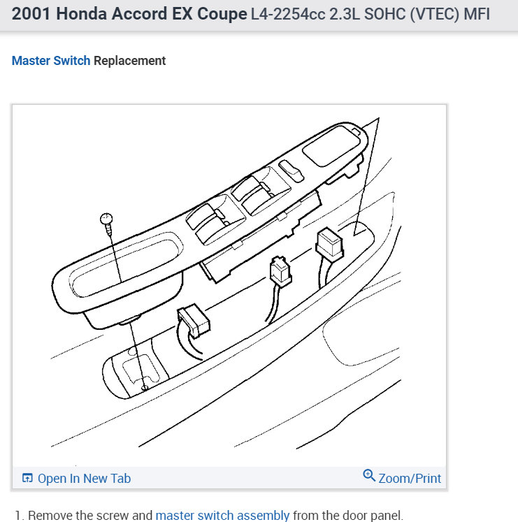

My passenger side power window stopped functioning a couple weeks ago, fortunately in the up position. I could use the slave or master switch and there was absolutely no sound from the motor. I took apart the door and ran a line from the battery to the motor and I was able to move the window up and down. Now when I test across each switch with my circuit tester, I register a complete circuit. This has me completely stumped, as I'm now wondering what could be wrong... the driver's window is fine, so it isn't the fuse. If it were either switch, then they should've give good circuit results. The wire from the slave to the actuator also tests out as OK. Could I have an issue with my wiring harness?
Thanks,
SPL
Jan 4, 2021 at 1:01 PM (Merged)

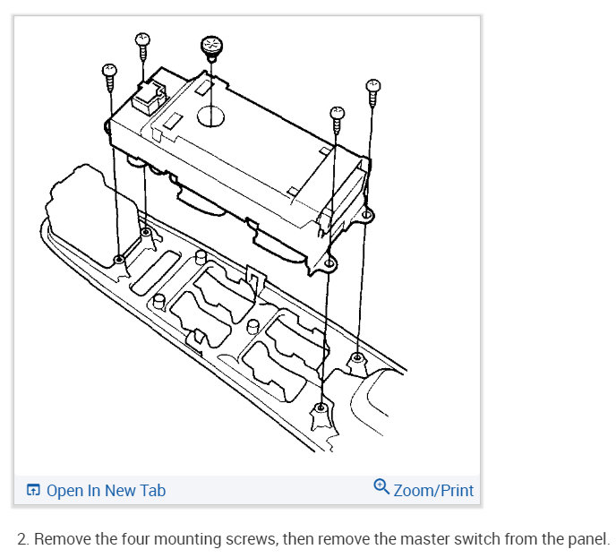

KHLOW2008
  • 41,814 POSTS
Hi soparklion,
It sounds like the master switch has gone out which controls the power and ground to the passengers side window. Here is a guide to help test it to confirm the issue and diagrams below to show you how to change the switch out.
https://www.2carpros.com/articles/electric-window-repair

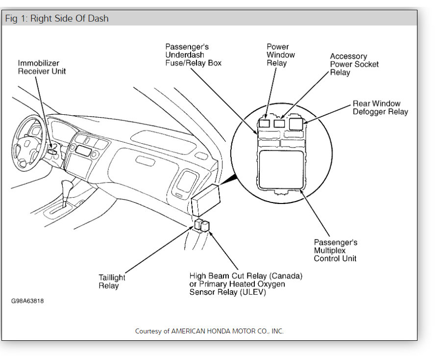

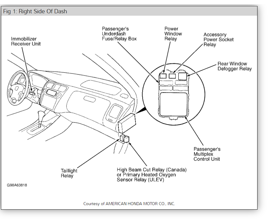

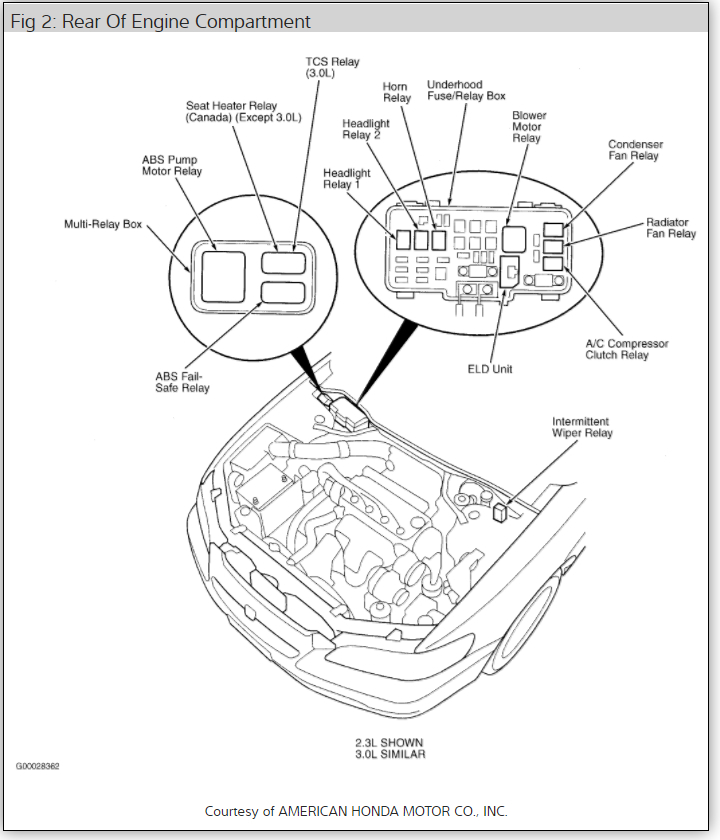

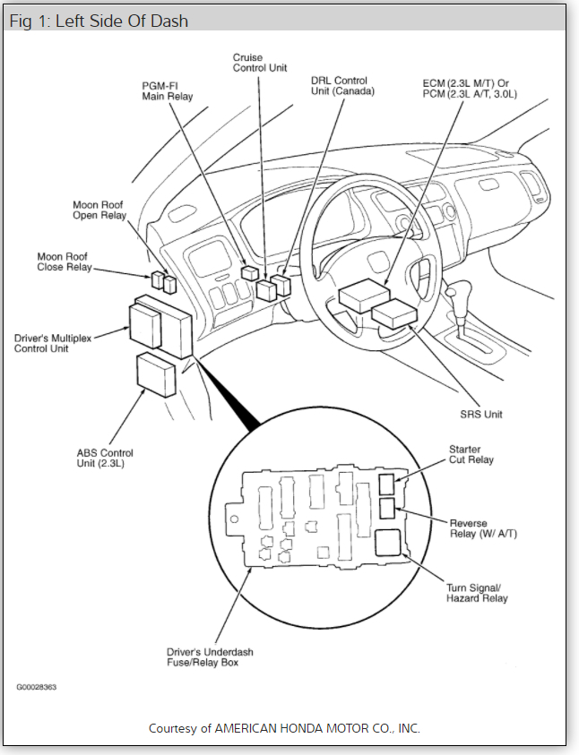

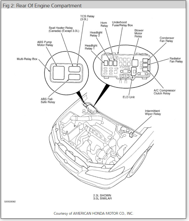

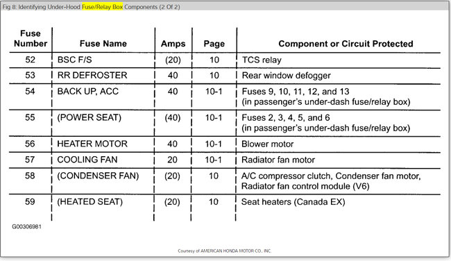

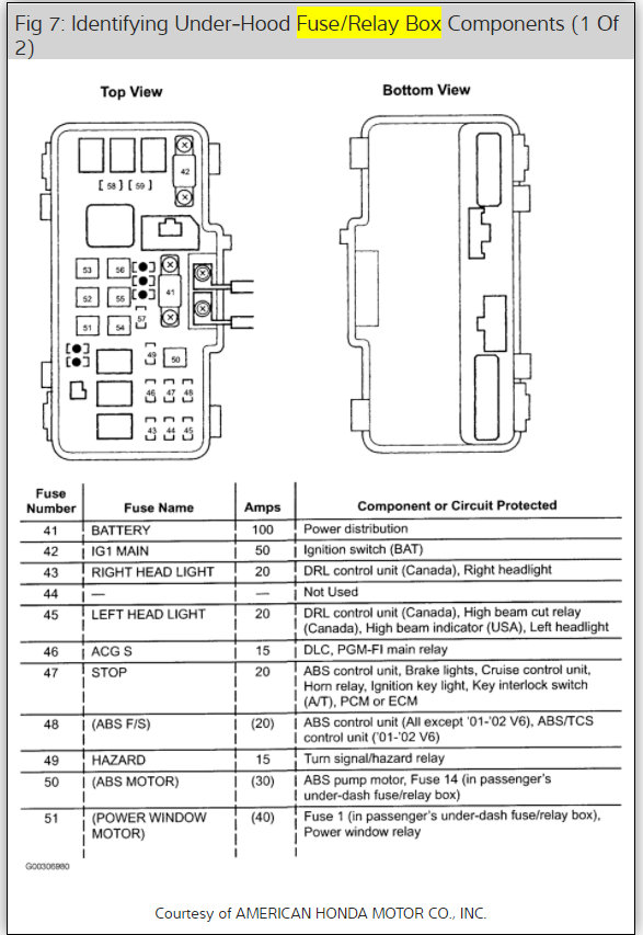

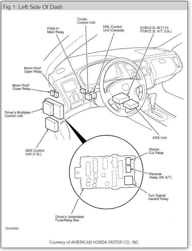

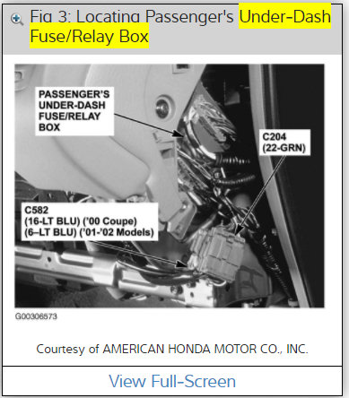

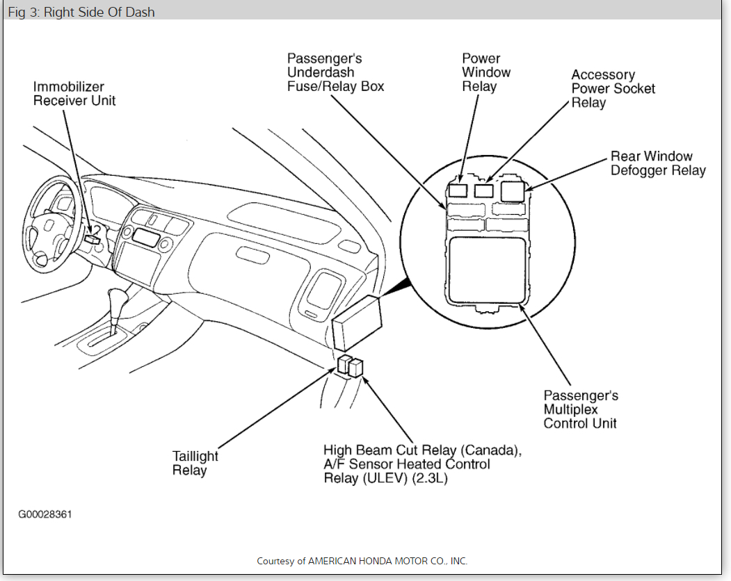

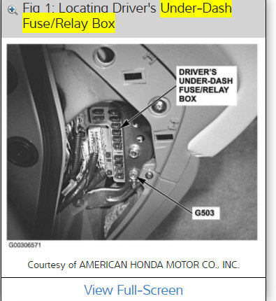

MJEAN
I removed negative cable to check alternator. (Oops) kept running but sluggish so tapped gas pedal (double oops) the moment I tapped gas pedal, the heater fan came on full blast and won’t turn off unless relay removed. Temperature control works. Also the passenger windows and rear driver side window and sunroof stopped working at same time. Replaced alternator and battery. New ones bad now. Where do I start?
  • 54,840 POSTS
Yep, you can't do that. It sounds like the passengers side multiplex is out, but I would check all the fuses. here is a guide and the fuse locations below along with the multiplex location for replacement if the fuses are okay.

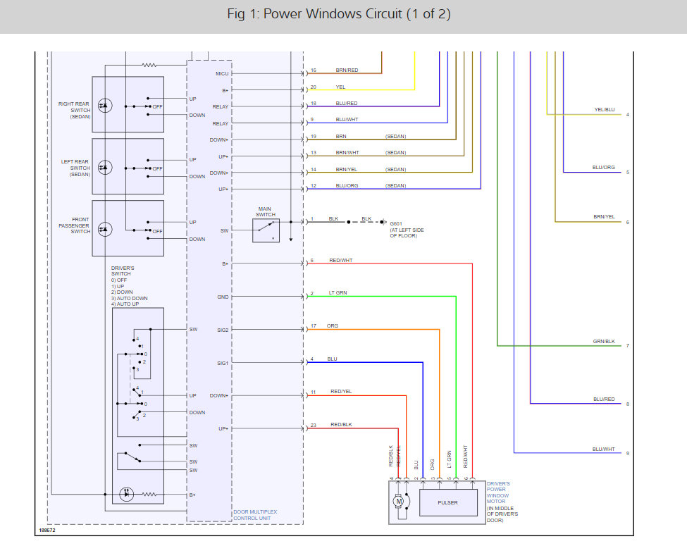

HUSSEIN ESM
So my drivers side window will not go up or down. Every other window works properly when using the respective switch. A friend tested the electrical output (?) of the plug attaching to the driver' side window motor and claimed that there was no power. What is a possible diagnosis? Any help, please.
MHPAUTOS
  • 31,937 POSTS
Often you get a break in the loom where it passes from the frame to the door, with the flexing each time the door is opened and closed you can get a failure in the wires here. i would start looking here first.

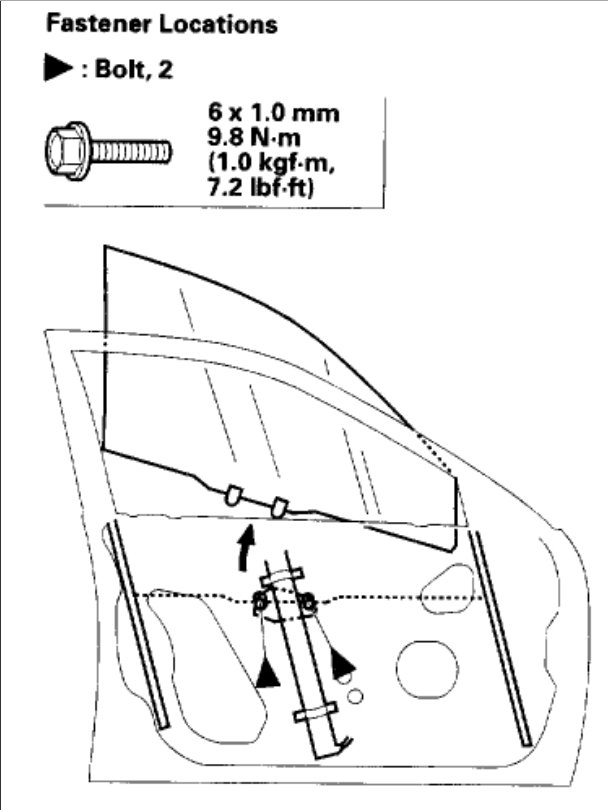

my automatic windows will not go up all the way, they have dropped about an inch in to the doors.
HONDAMIKE
  • 71 POSTS
Sounds like your window regulator (the "scissor" arms that move the glass up and down in the door) needs replaced.
Another possibility is that a bolt that attaches the glass to the regulator may have worked loose. You will need to remove the door panel and the plastic cover to see inside the door.
  • 110,194 POSTS
You need to remove the door panel and check to see what has come apart. Chances are the regulator is bad.

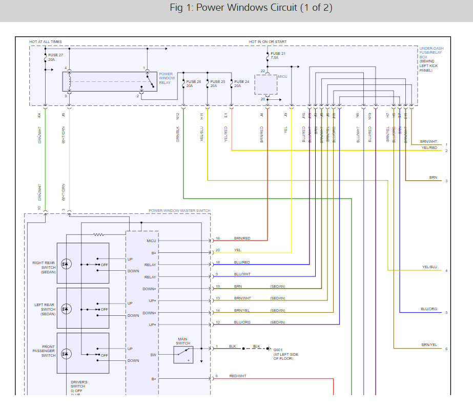

BUSCHY
I own a 2001 honda accord 4 door. recently, when it started to get warmer, my front drivers side window stopped working. at first it was spuradic, on a hot humid day, it would stop working. later at night when it cooled off and was less humid it would start working again. now in the hot and humid chicago summer, it doesnt work at all anymore. since it stated off as spuradic, i assume it has something to do with the actual swith on my door. I have tried replacing the fuses just incase that was the problem, but nothing has fixed it. should i look into buying a new power window switch assembly or is the problem more complicated? Please help!
CARADIODOC
  • 34,321 POSTS
Hi buschy. Welcome to the forum. How about we diagnose this puppy instead of blindly throwing parts at it? It could be the switch, but it could also be broken wires between the door hinges or a dead motor.
First of all, where are the switches, in the door or in the center console? Do the other windows work? If the other windows do not work, suspect broken wires between the driver's door hinges. If the switches are in the center console, it is possible for any one window to not work due to broken wires in that door.
A simple trick that might help narrow down the cause is to watch the dome light very closely when you press the window switch. The engine must be not running but the ignition switch must be in the run position. If you see the dome light dim just the very tiniest amount when you press the window switch, the wiring and switch are most likely ok, and the motor is drawing current and trying to run. See if the window will move when you try to help it. If it moves but slowly, there are two common possibilities. There may be a thermal cutout inside the motor that has pitted contacts. The cutouts cause more problems than they prevent. The second possibility is the rubber channels are gummed up and the window is sticking. Spray Silicone Spray Lube inside those channels and let it wash down along the edges of the glass. It will evaporate and leave a slippery film behind.
If you don't see the dome light dim at all when you press the window switch, suspect broken wires again between the hinges, or it is possible, but not common, that the switch itself is defective. GM has a lot trouble with window switches, but not most other manufacturers.

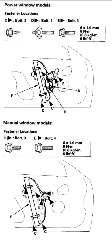

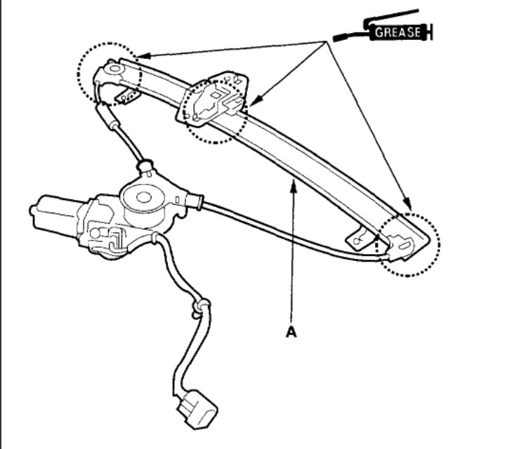

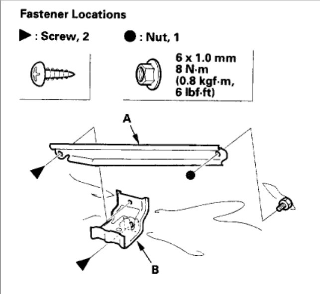

JFRAYSSE
My car is the two door model. The driver's side window just started chattering at the top of its travel and will not close completely. so rain, cold air and wind noise are a problem. The window has to be manually pulled into the correct "up", and completely closed, position. Very annoying! Is there a limit switch somewhere that might be failing? If so, is this an easy fix or do a have to replace the entire power window mechanism and drive motor? Please advise and thanks!
Jan 4, 2021 at 1:02 PM (Merged)
MHPAUTOS
  • 31,937 POSTS
You will have to pull the door trim off and inspect the regulator, the teeth on the driven arm may be worn away and the chattering is the drive gear skipping, if so a replacement regulator is required.
JFRAYSSE
Hi MHPAUTOS: Thanks, this is what I suspected as well, but I was hoping that there was a limit switch that needed re-positioning or something. :D Thank you for your time and your expertise!
  • 54,840 POSTS
If I am add here is a guide that will give you an idea of what you are in for when doing the job.
https://www.2carpros.com/articles/how-to-check-and-replace-a-electric-power-window-motor
