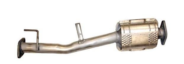

Should be a bolt up catalytic converter, not a big job. Even if it is a unit catalytic converter it still will be a bolt up. May be get a specialist exhaust repairer to investigate the catalytic converter and exhaust first and get a quote.
